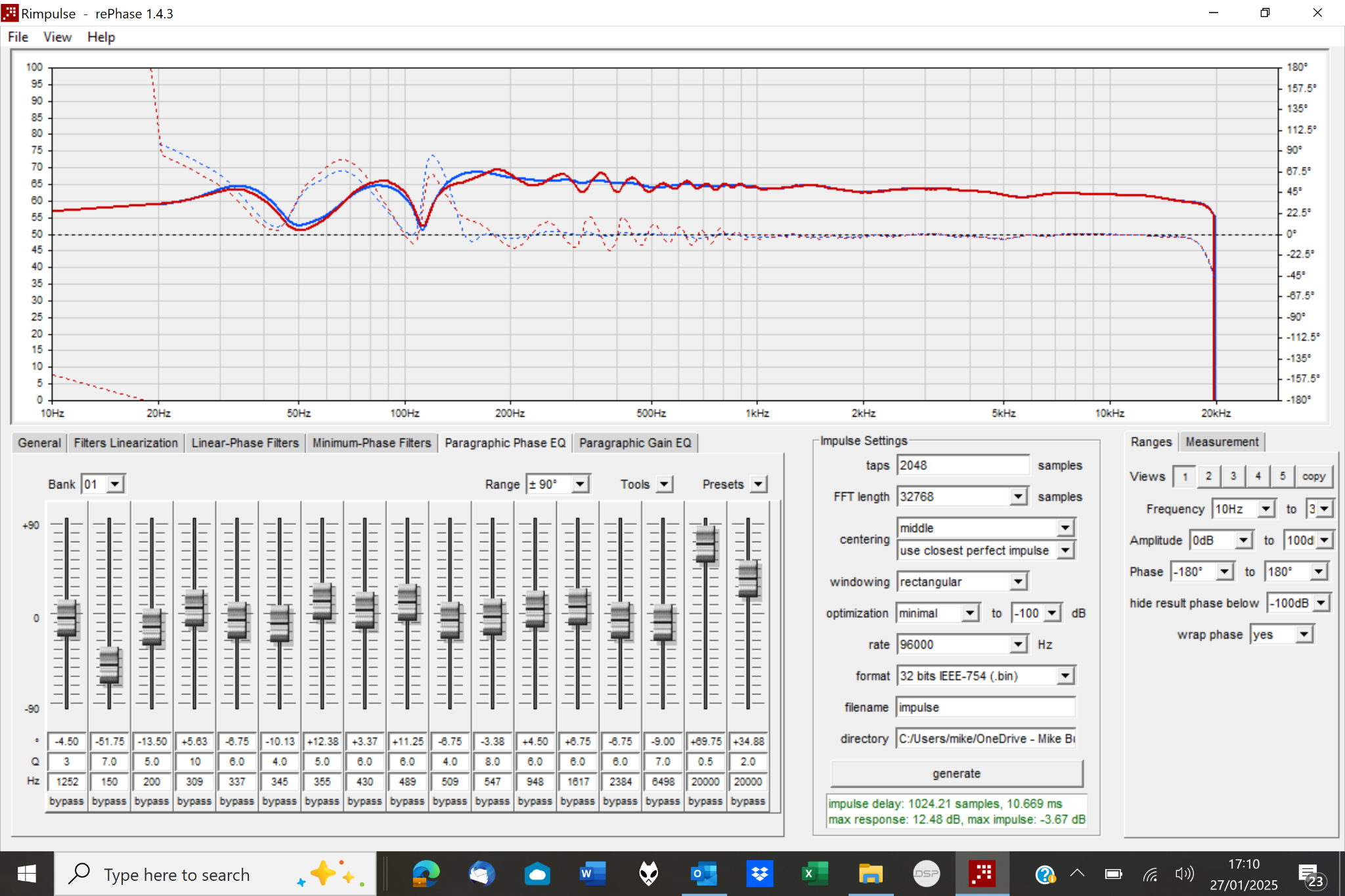

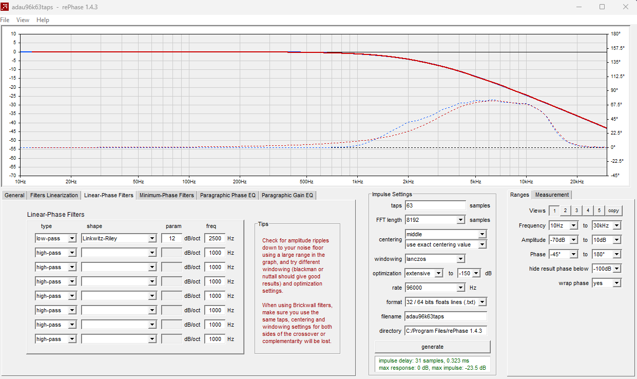

Possible bug?
When I make both a phase eq and a linear phase filter, the phase dips down in HF -180 deg at 18kHz in the ADAU FIR filter i have. Seperately I get the expected result . It also works fine if I use both phase eq and linear phase gain EQ.
This is what I expect from Rephase.

You should not correct phase like that. Export excess phase of a response from REW and try to fix that in rePhase using "filter linearization tools"

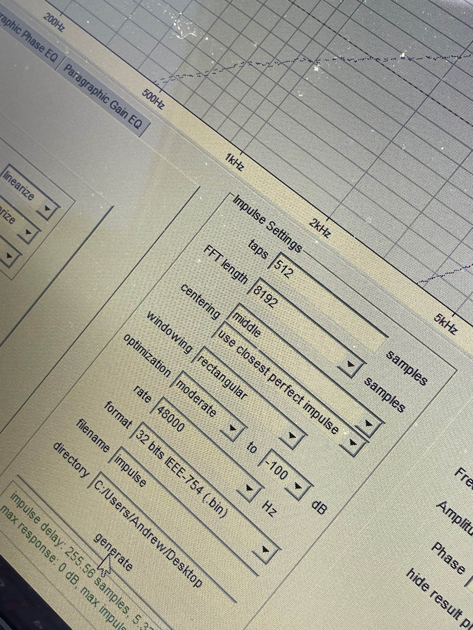

Good morning all.
I had used RePhase a couple of times successfully exporting.bin files for my MiniDSP Flex, however i now cannot save successfully in that format, it always wants to save as .Rephase which the Flex wont recognise.
Can anyone help please, a screenshot of settings attached
M
When you want to produce a filter from rePhase you need to press "Generate" button but first setup your desired output format using the "format" drop down menu item above.
"Save" is to keep a certain configuration of it all for a later session...

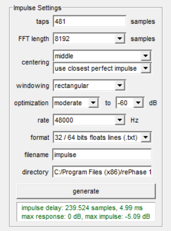

Hello all.
RePhase is an impressive piece of software.
I am trying to make a FIR for filter phase linearization of a 3-way horn system. The crossover itself is done with IIR dsp, with 48LR (measured) filter slopes and crossover frequencies of 300 and 6000 Hz. The filter delay should be no more than 5 mS.
I admit to being a bit bewildered by the many options in the Impulse Settings window, and do not really understand what they all do.
What would be the "best" settings for windowing, centering and optimization?
Does this look usable?
Thanks!
So you’ll want to use about 500 taps to stay under 5ms latency at 48k which should be plenty
Idk why such short filter is required, I have the full 64ms latency on my home theatre and there is no video synchronize issues at all….
But that should do it , 512taps should be about 5.3ms , you may use a windowing option and could get a little more taps with low latency also , start with rectangular , then move down the list till it works , I like the Hahn window if there is a low pass on your top horn , otherwise just try them
Good luck sounds like a cool setup can you share a pic or two
Thanks for answering.
The system will be used in live (club) settings, so low latency is paramount for DJ-ing.
Guess my problem is that I don't really understand the differences between the windowing options, or the finer points in centering.
I can always use trial and error till I find something that works, but I feel that some real understanding also will be good 🙂
BTW: the system is a large horn system, with B&C DCX464 coax driver in a large horn, horn-loaded 15" PHL midrange, and 2x 21" Eighteensound in bass horns.
Wow that’s a big horn , and a big bass driver , should sound pretty sweet …
If it’s for live sound then yes what I would do is use a 512 tap filter, and use a Hann window. Use default, centering, closest perfect example.
I would not try and linearize anything below 200 Hz because the latency will creep up on you. You could probably get away with 100 Hz if you’re OK with about 12 ms of latency but to keep it at five about 200 hz and above would be all the correction power that you’re really gonna be able to have with that short of a filter
It looks like 300-6000 rectangular window with moderate optimization, 512taps is 5.32ms at 48k
So I corrected myself I think the rectangular window is gonna work the best for you with that lower of a tap count….
If you can use 24 DB/oct slopes instead you won’t need optimization and there will be less ripple…. But it can still be done using the 48.
