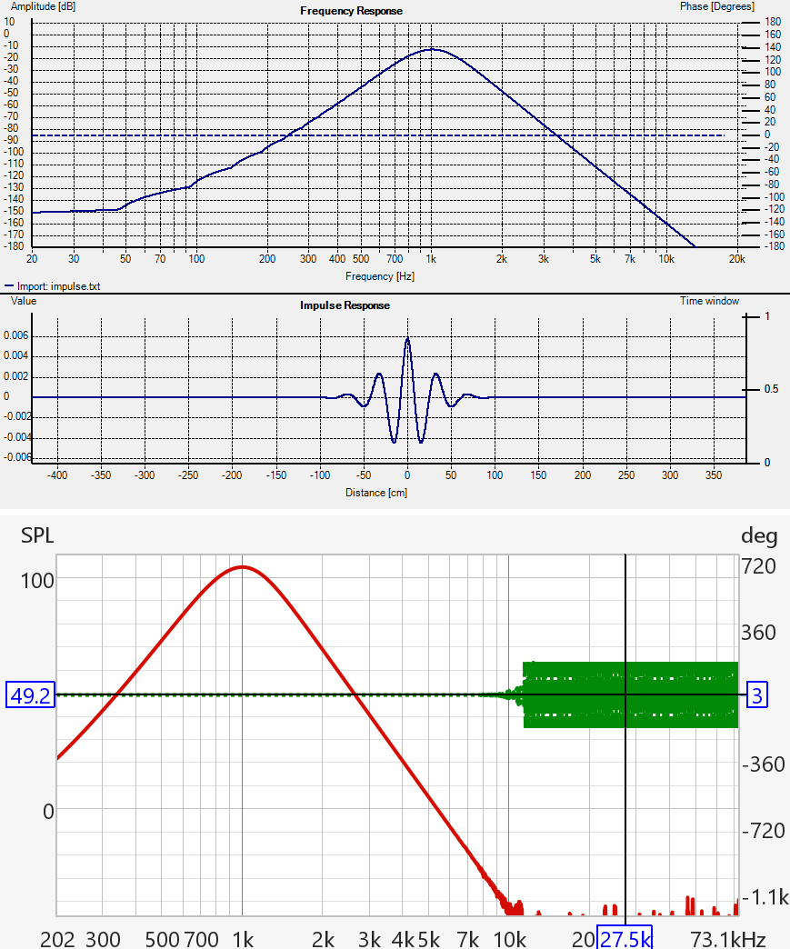

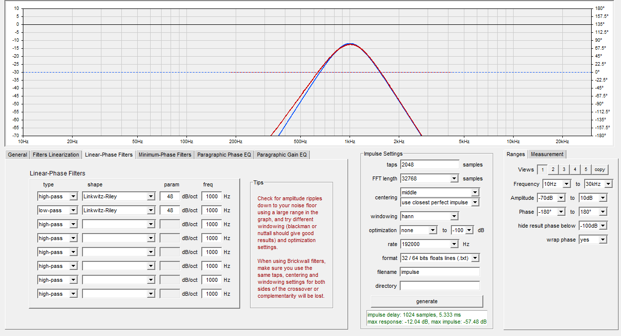

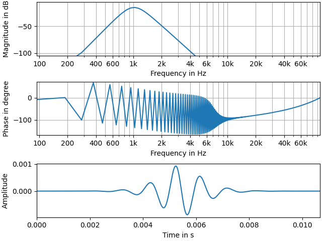

I'm trying to create a linear phase filter with rePhase, then export the coefficients and plot them in another piece of software.
Attachment #1 shows the filter in rePhase, with linear phase.
Attachment #2 shows the the outcome of plotting the coefficients using a Python audio processing library. This time, see how the phase is all over the place.
I raised the issue with the Python library here, and the decision is that the library is correctly plotting the inputs it was given.
So I'm not sure where the discrepancy lies. Surely rePhase IS correctly producing a filter with linear phase because otherwise everyone would be seeing incorrect measurements in REW... Anyone have any thoughts?
The filter you are making does not match the target that closely. If you increase the number of taps or reduce the sampling frequency the red and blue lines will overlay more closely.
The impulse is not symmetric which suggests it is not linear phase.
Is the fixed delay to make the filter causal being removed in the plotting of the phase?
Leaving the time delay in makes phase plot like that.
Reactions: wesayso
I hadn't accounted for the delay originally, but the results are still similarly "wrong" with the following code in my script:
import matplotlib.pyplot as plt
import pyfar as pf
import pyfar.classes.filter as pff
import pyfar.plot as pfp
# create an impulse against which to apply the filter
i = pf.signals.impulse(n_samples=4096, sampling_rate=192000, delay=1024)
# create an FIR filter object
fir_filter = pff.FilterFIR(coeffs, sampling_rate=192000)
# process the impulse signal against the FIR filter
filtered_signal = fir_filter.process(i)
# <-- code to plot the filtered signal -->
Setting the impulse delay to 0 or 1024 (the delay given by rePhase) both comes out wrong, still.
Without an image it is hard to see what changed, but probably both are correct for the filter you made, just not what you expected.
Maybe try a simpler filter like a 3K high pass LR24 to start with to work out any kinks with the settings in the program.
REW can plot rephase filters with no problem when the correct impulse start is chosen, and when the rephase settings are chosen properly the expected result is seen. Check the impulse to see if it is symmetric.
Was the largest peak centered at 0 when you used the 1024 delay? Like in the pictures of pos.
If not, play with delay until it does and figure out the why later 😉.
You might have to move it to the left, so -1024 would make sense. Your picture shows the impulse peak at 5.33 ms, just like predicted by RePhase.
