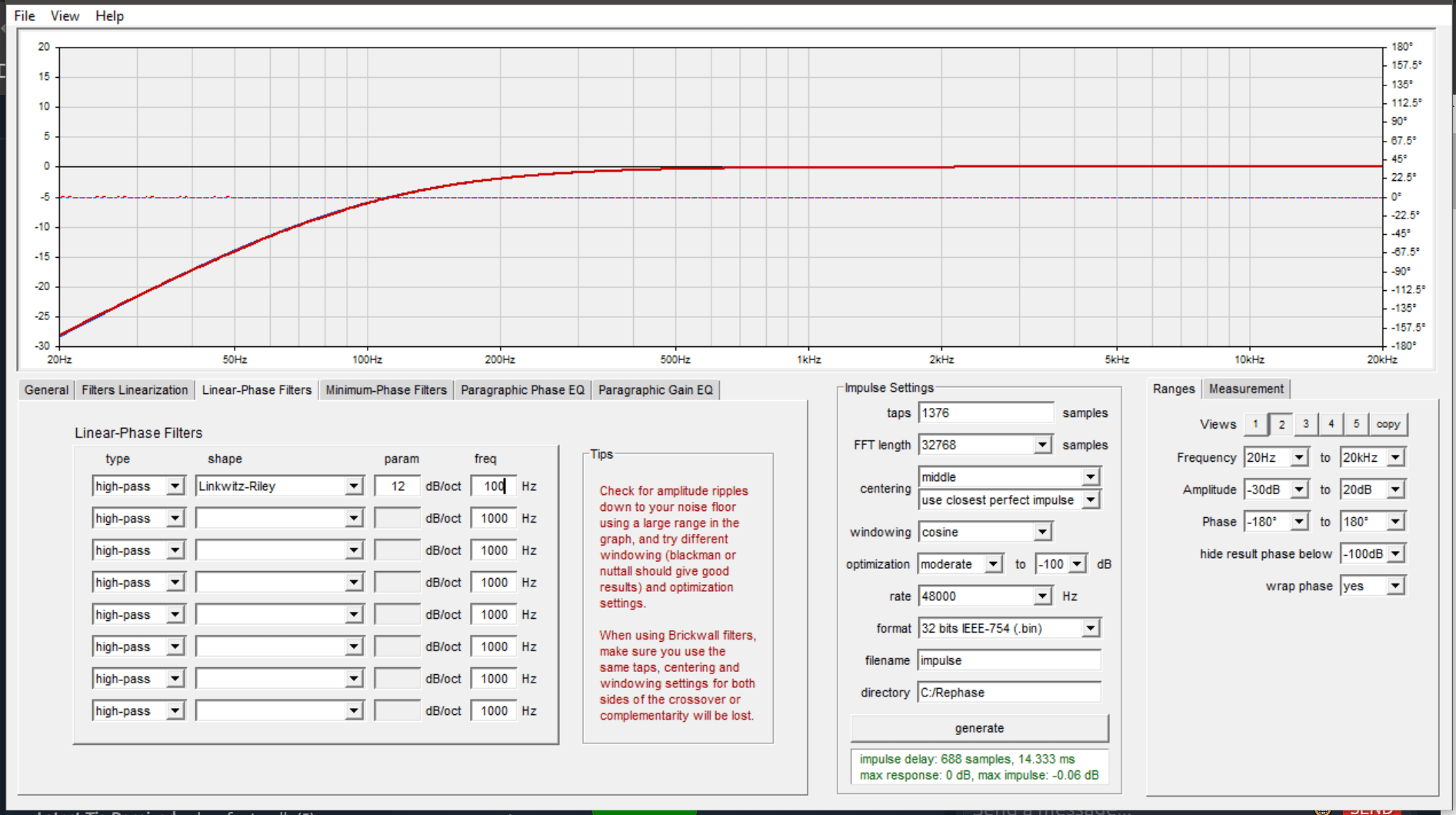

I use only linear filters in a 6 way and convolve to 10hz
The only problem with doing convolution below 100hz is most these usb mics can’t measure that low….
Example the Dayton umm6 has a huge peak at 23hz
Also , you don’t want to linearize the system High-pass, so everything above that is fair game as long as your microphone is up to the task. A good half inch condensers should give you no problems! Or an earthworks (which I use)
The low frequency is where all the phase is, YES we want control over that especially!!! That where things make the most difference.
Some really tiny rooms (like cars) have so much room gain in the subsonics there is no system high pass. So I just leave the last little phase rise below 30hz alone ….or I’ll use a system wide 20hz minimum phase subsonic filter which cleans up the sub simultaneously and leave the added phase
It doesn’t cause pre ringing arbitrarily.

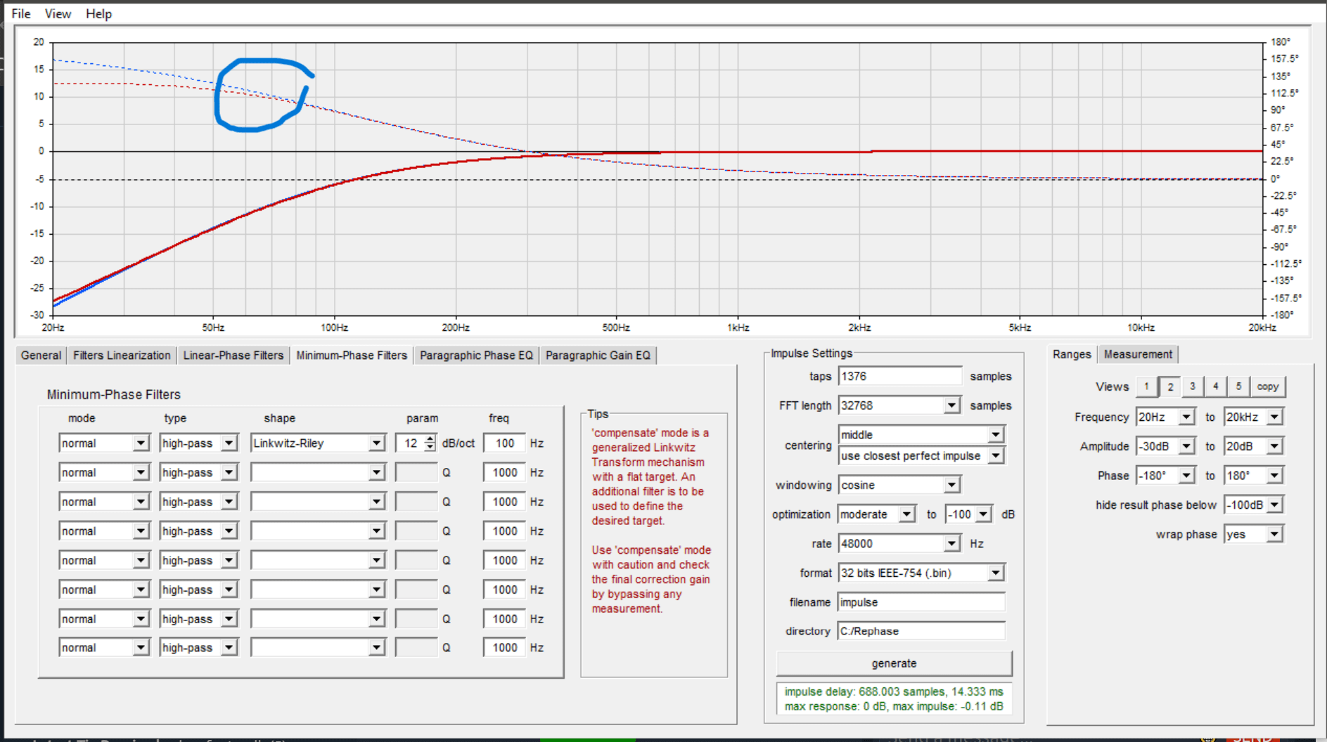

Now it comes with a caveat, sometimes a minimum phase crossover works better in LF . As long as all the phase is tracking the same direction on all drivers you can’t really sense it , but a phase rise below 100hz can sound more natural.
The biggest difference my FIRs make is getting relative polarity to work better between left and right and removing crossovers phase….. down in the sub bass, it isn’t very much noticed unless there multiple subs or multiple speakers trying to play and lots of different room issues, then an fir can be very powerful.

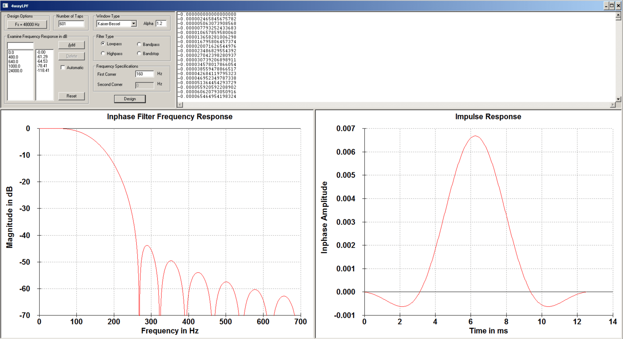

Pretty much, if you're not equalizing the drivers. I like making a highpass filter by subtracting a delayed impulse from an inversion of the corresponding low pass filter; you get both HPF and LPF for the price of one, and by inspection it becomes obvious the ringing of both filters cancels itself out on axis. Off axis is a different story, of course, so that's why I also like using filters as short as possible, such as this one:
A filter length of (SampleRate * 2 / CornerFrequency) + 1 has weights of zero at the beginning and end so ugly windowing artifacts are minimized.
