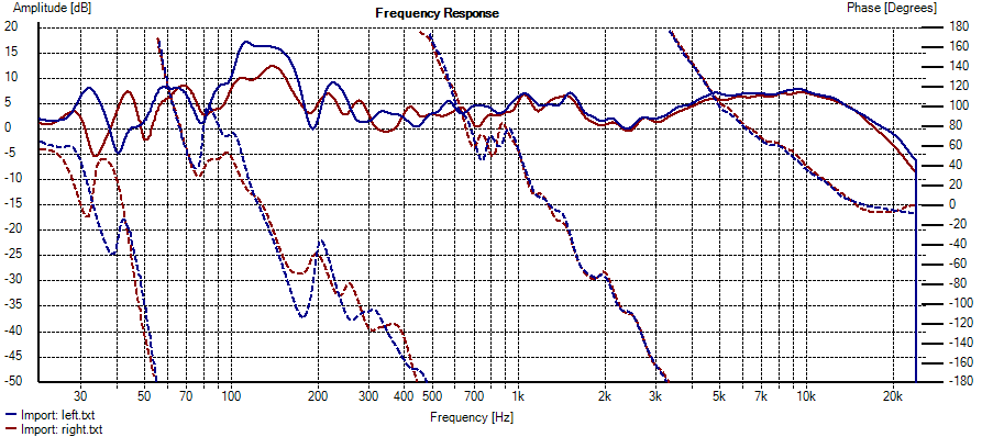

I have 3 ways LS with crossovers at 350 and 4000 Hz.
I have first applied amplitude EQ, then a sub freq rejection linear filter and filters with 24db/oct to linearize crossovers.
After that, remaining phase still is quite messy.
If I try to EQ phase to zero from that, I have massive pre-ringing.
If I try to align remaining phase with minimal phase, I have perfect time alignment of speakers and no pre-ringing.
What am I doing wrong ?
It appears the polarity of these measurements is reversed (first peak is negative).
Once turned to normal and some simple smoothing applied (after playing with the gating function to see what effect reflections do have on the curve), here are the responses:
attachment.php
It looks like you have a 24dB/oct acoustical crossover around 3.5kHz, and another one around 400Hz (difficult to precisely judge at that distance, and also with the box rolloff adding its own phase shift to the mix). That look pretty textbook and should be easy to correct.
As for the EQ, I don't know how this dip around 2.5kHz (or broad bump around 8kHz depending on how you look at it and how the LF part is balanced) should be addressed. Shooting for a flat on axis response might not necessary be a good solution with this loudspeaker. Some off-axis measurements are in order 🙂
You also seem to already have some HF preringing in these measurements, probably coming from a heavy-handed linear-phase antialiasing filter somewhere.

Could you just precise for which reasons you were reluctant to the fact that I was manually adjusting the remaining phase curve to the minimal phase of the system ?
Is there any inconvenient to do that or is it just purely because it would not normally be necessary ?
Thank you.
Hi Swissbear,
Yes, sorry I have been so insistent on that subject 😛
Fact is you can get to the same result (ie mag/phase+delay curves) using different paths. For example one can use linear phase EQ and then phase EQ, or do it the other way around, or use minimum-phase EQ, etc.
Different tools for different scenarios and approaches, and a generic tool such as rephase shall not impose one.
I just fail to understand why you would be pulled away from a minimum-phase / causal system in your situation (beside the linear-phase subsonic, that is), but you certainly seem to know what you are doing, and you are the one taking and analyzing the measurements, so it is about time I stop grumbling now 😉
