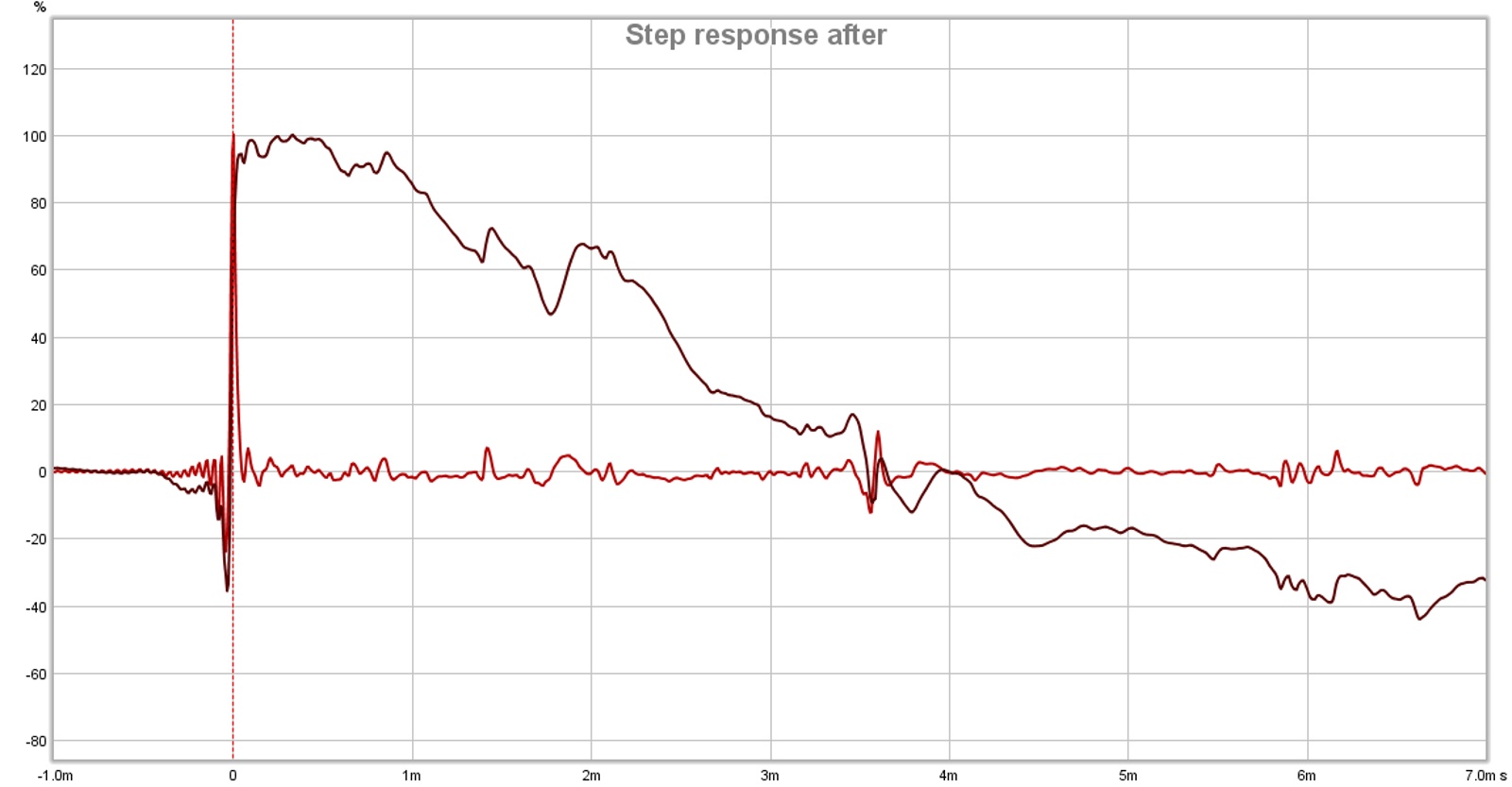

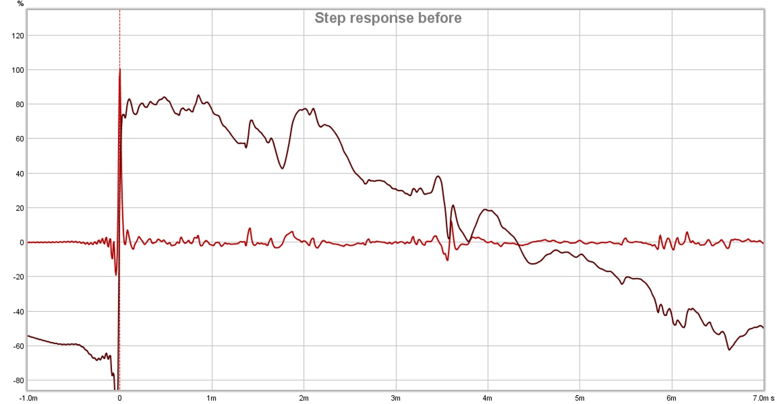

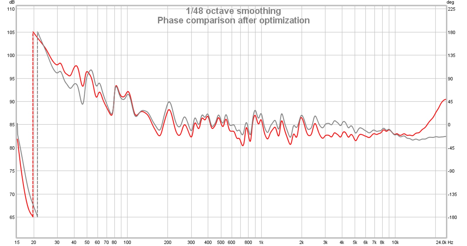

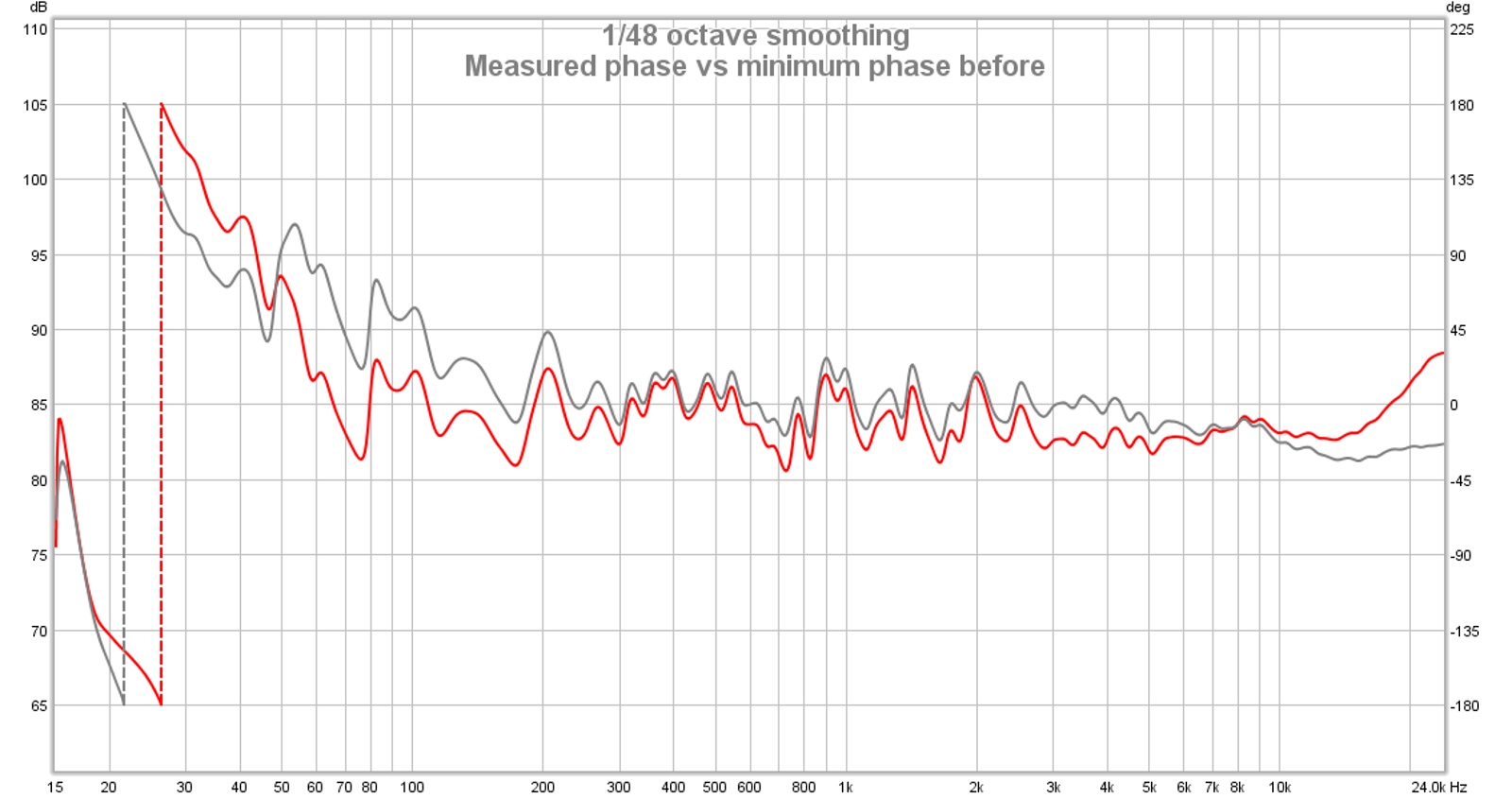

A quick illustration of the importance of sticking to the minimum phase in the low range to limit pre-ringing:
- two graphs before optimizing the phase response in the low range: the pre-ringing is quite substantial
- two graphs after optimizing the phase response to stick to the minimum phase curve: the pre-ringing has massively decreased
All charts with the same amplitude curve.
What remains to be sorted out is the divergence with minimum phase in the high frequencies range. May be related to the absence of mic phase calibration. Any suggestions welcome.

Hi SwissBear,
Thank you for the suggestions!
The filename should not either, but it is, for historical reasons... 😱
I will probably try to rework all this in a future release, and have the user choose a destination file *after* the generation process.
I would have to rethink a few things about the ergonomic principles at play though, as right now not only the filename but also the format is part of the settings, and that can be convenient at time.
The "noise floor" of the result curves also shows the real noise floor implied by the output format...
Well, I will have to think about all this some more.
This could be addressed by the above suggestion, if the user can save a given FIR several time, choosing a different format each time.
AFAIK there are several "profiles" to choose from in REW when generating the automated EQs, encompassing a number of usable EQ points, types (shelving, constant Q, etc.), parameters (BW vs Q, etc.) and limits (dB range).
When I looked into this a few months ago I found one "profile" that was close enough (17 EQ points max, only EQ, ideal to fit one paragraphic EQ bank).
I will have to look it up again. The ideal solution would be for REW to implement a rePhase profile 😀
Extracting an accurate full range minimum-phase curve is not as easy as it looks. And once you have it why not simply automatically apply the phase correction? 😉
I don't think I will implement this feature, as you should not really need it if you start with minimum-phase EQs, adressing both magnitude and phase linearization, and then only apply phase linearization (preferably from the filter linearization tab) for the crossover points (not the system's high and low pass filters).
You should play with measurement time offset to get a proper phase there, and not try to linearize anything that is outside of the scope of a crossover point.
Regarding the phase response of your mic, if it is not included in the calibration file you can try to "resynthesize" it using the measurement "compensate" (soon to be called "invert") functionality as explained above.
I did so with mine (coming from cross spectrum with no phase info) and I found it worked pretty well.

- finally, I have considerably reduced the pre-ringing of my correction impulses trying to stick to the minimum phase curve related to the amplitude. Would it be possible to have the option to display this minimum phase curve in real time inside rePhase, to help this manual tuning ?
Thanks 🙂
