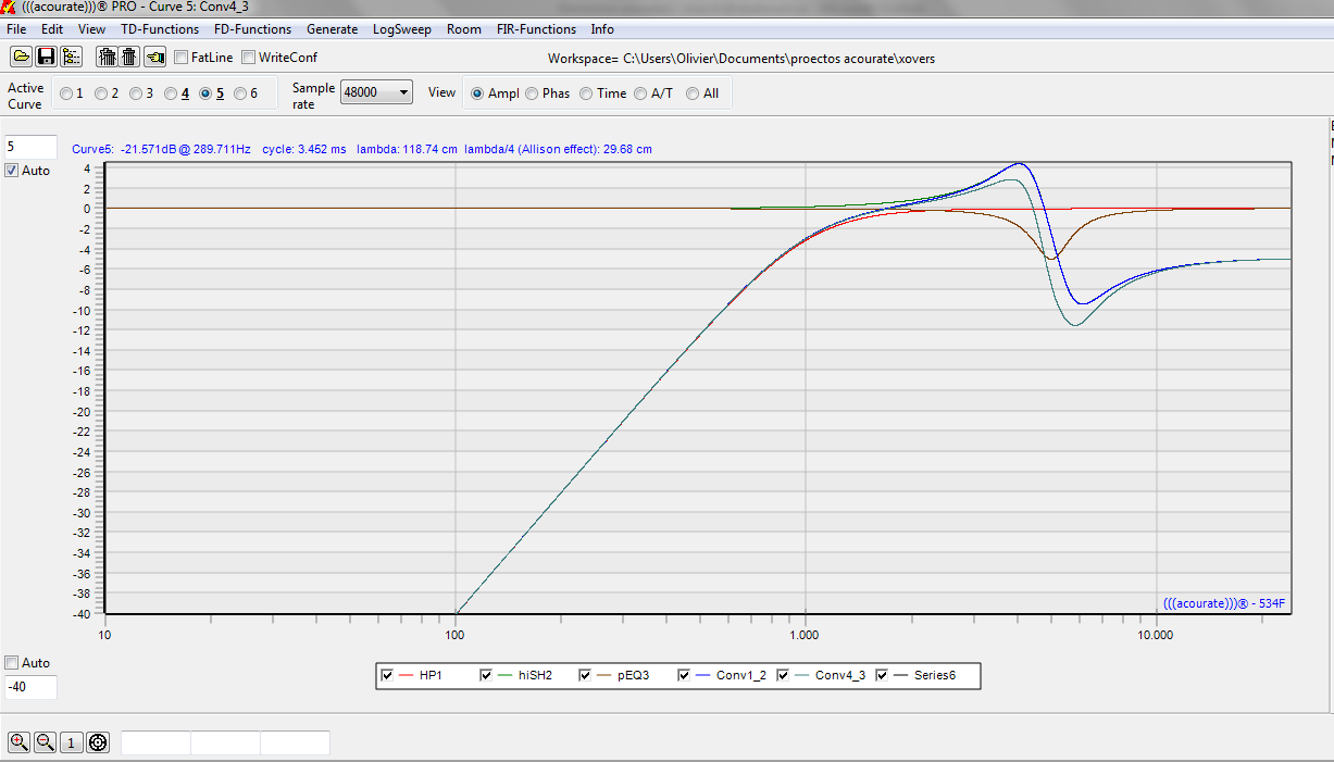

Holmimpulse allows convolutions too, but impulses need to be imported in frd format. Praxis also allows many manips. But as i got tired of messing with free soft which partly allowed to get things done, i finally invested some pocket money into Acourate which, way beyond a mere DRC solution , is a perfect fir pocket calculator.
