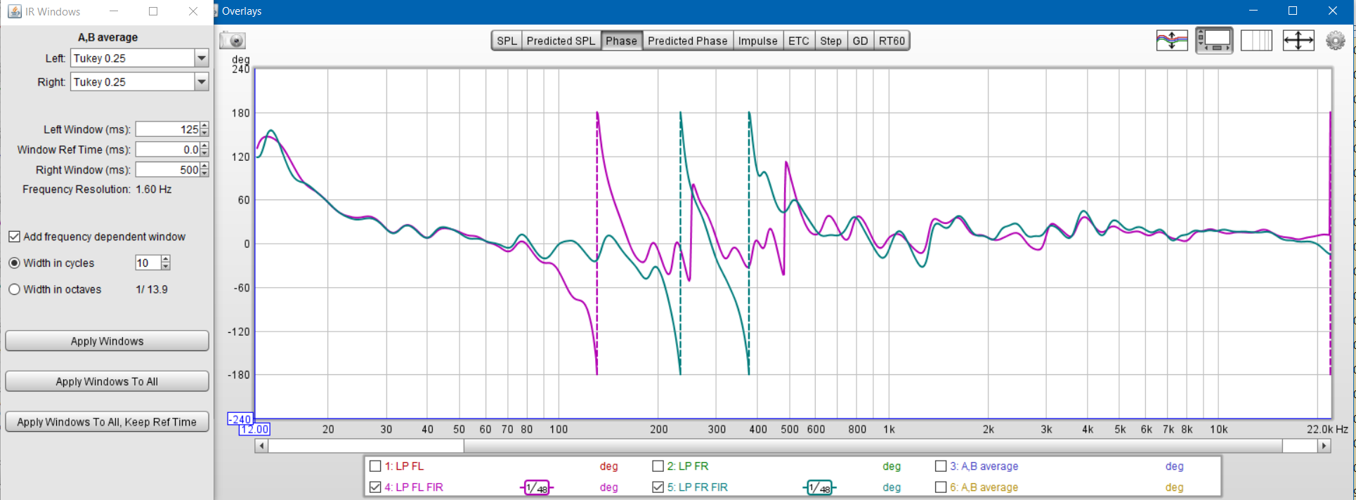

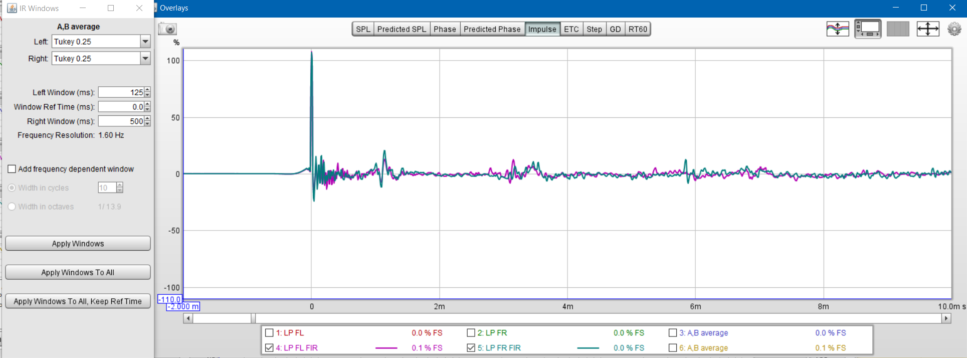

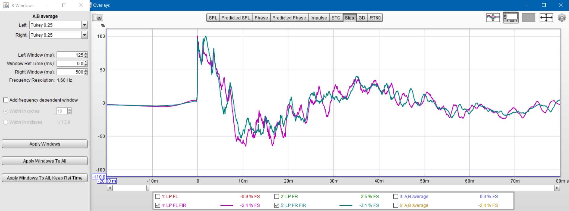

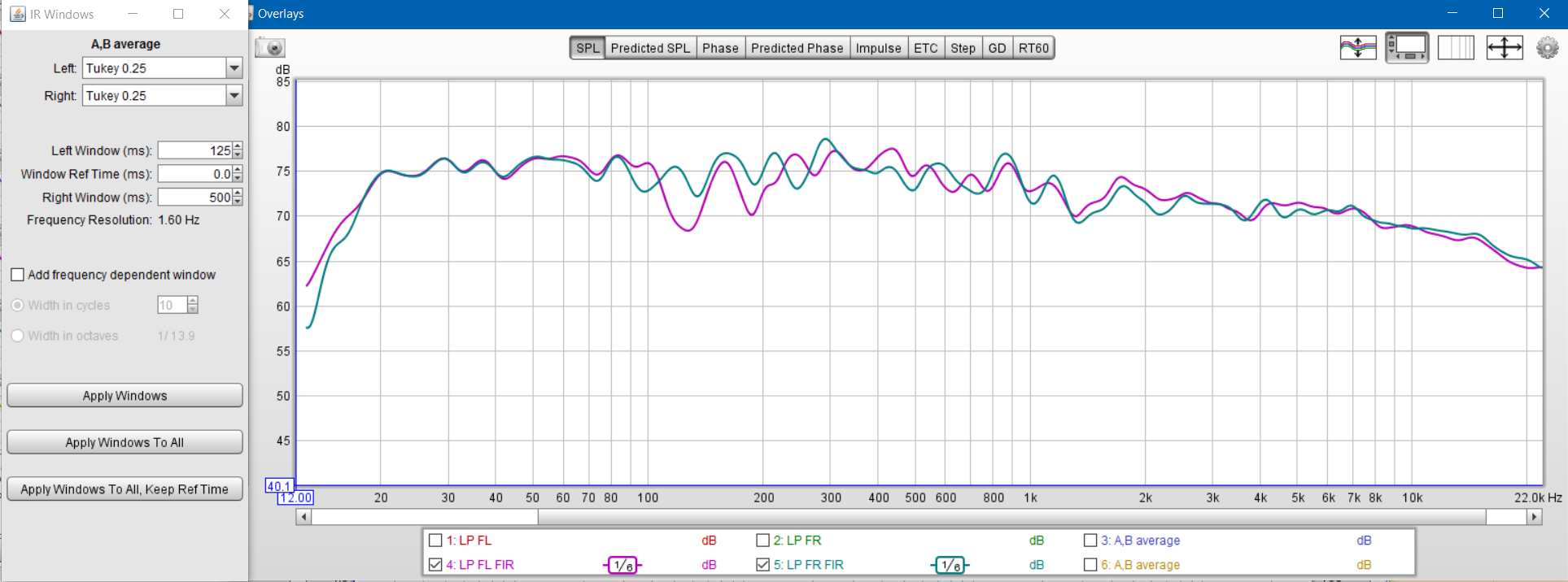

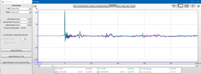

I’m a hobbyist that has investigated the REW Step Response (SR) subject. When using REW SR charts it’s helpful to be aware that the REW Step Response (SR) chart does not correct for the soundcard and mic calibrations. Thus the SR chart looks identical whether the 2 correction files are used or not. The SR chart will always reflect the impact of the LF and HF roll-off of the measuring setup as well as the audio measurement. If an audio measurement looks ideal, then there is a deviation from true ideal. The REW SPL and phase charts are properly corrected of course.
A discrepancy in the REW SR chart can thus be misleading. It is helpful to view the SR of a loopback of the measuring system given the same sweep range as will be used for the sound measurements. This may provide a better comfort level regarding some the preringing seen in the sound measurements. If the 2 SR’s look identical then the SR is in reality Ideal, no matter the appearance.
I have observed that using a measurement setup that utilizes a 96k sample rate and wide band response capability of all components in the setup does help to mitigate SR chart discrepancies by moving the low-pass filters further away from the range under test.
Below is my left and right channels at a 4 m listening position using a 96 kHz sample rate. When using a 44.1 or 48 kHz sample rate for measuring, the SR looked more similar to that shown above in Post 1145 (the rePhase trace that was indicated to have excessive preringing). [A 10-cycle FDW is applied to the phase chart below in order to reduce much of the impact of the room.] My near-field measurements (not shown) are as expected with smooth SPL and flat phase including close phase tracking through the 2 kHz and 100 Hz XO’s. [Now if I could just improve my 200-600 Hz room issues. ]
I have concluded that a careful calibration of the entire measuring system allows us to rely on the SPL and phase charts for the proper response. We should not be too concerned if the REW SR chart has apparent preringing. I think this is in support of a comment pos made above.

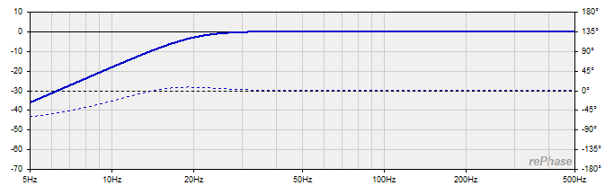

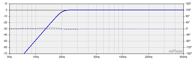

Hello Pos,
I noticed strange results in rePhase when simulating a général 2nd order low (or high pass) minimum phase filter, defined with (F, Q ) when using low values for Q :
Screen for the low pass, phi at Fc is no longer constent at -90° if Q < 0,5 ?????
cdt
cdt

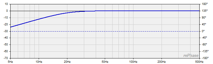

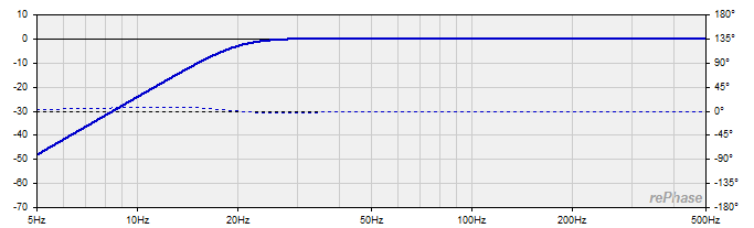

That one is not a bug, but an actual (undocumented) feature
Beside the Butt 12dB/oct one, all subsonic filter linearization functions are approximations made to use less taps in this taps-hungry LF range, while still being accurate where it matters. They are not supposed to be used for other purpose than subsonic filter linearization.
Here are some illustrations with an actual Butterworth minimum-phase filter at 20Hz and the associated subsonic linearization function.
Subsonic butt 12dB/oct corresponds to an actual But 12dB/oct, no surprise there:
Subsonic Butt 24dB/oct and 48dB/oct correspond to a Butt that smoothly transition to a LR below fs:
Subsonic Butt 18dB/oct is the trickiest one, as you noted. A "real" butt 18dB/oct linearization would require a phase shift that does not reach a 180° multiple towards DC (270°), and that kind of target would require a huge amount of taps to approach. So it is considered as a LR 24dB/oct with a fs set to fs/sqrt(2) :
