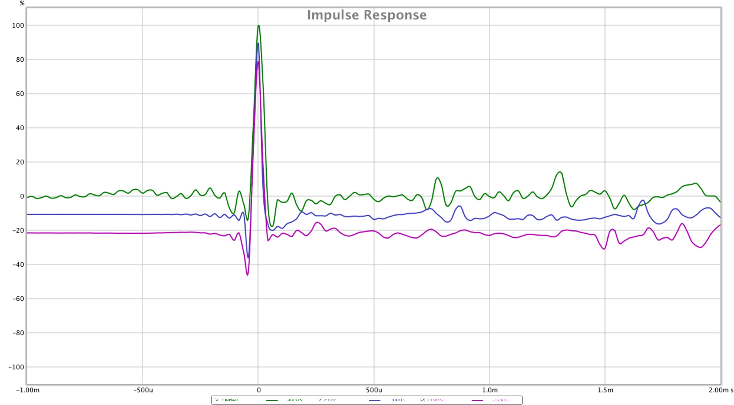

When comparing the impulse generated with RePhase to impulses generated with other 'room correction' systems (Dirac and Trinnov) we have noticed that there is some significant pre-ringing in the RePhase impulse (see attached). Is there any way to limit this pre-ringing ?
Thanks.

Regarding preringing, it comes from phase linearization of the low or high pass of the system. If you don't correct them you should not get any preringing (ie purely causal, phase-minimum system).
Not correcting the high pass will avoid low frequency preringing (that mainly shows on the step), while not correcting the low pass will avoid high frequency one (that mainly shows on the impulse).
Linearizing the phase of the high pass (BR, sealed, etc.) is a matter of taste, but in practice you never wants to correct the low pass as it will cause visible (audible?) preringing for no audible (visible?) benefit.
A wrong centering of the impulse might result in unwanted correction of the low pass: you want to get the polarity right and center of the first peak as a first approximation to get a phase that asymptotically reach 0° at Nyquist. You might then need to slightly adjust the time offset within rephase (or in the measurement software) in order to get something that looks correct (eg if the level drop in the UHF phase info is probably not usable there, and you want to rely on the phase behavior of the HF to assert that asymptotic behavior).
Then while you start applying filter linearization (first thing to do before touching phase EQ) you might need to adjust time offset further, always with that asymptotical target in mind).
Doing so you in fact make the phase behavior of the low pass "disappear", but it is obviously still there and you can get it back by playing with the time offset to get a causal impulse.
Also note that low pass pre ringing can also come from the antialiasing linear-phase filter of the DAC.
Hope this all makes sense 😛

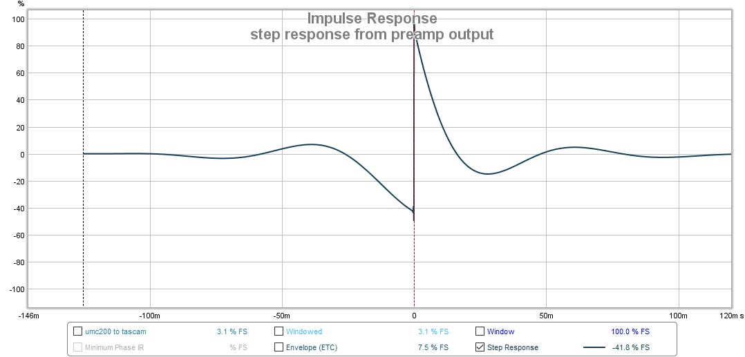

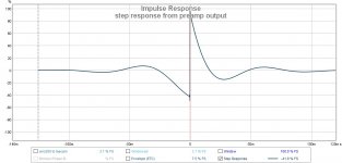

hi,technically rephase has the step response thats closest to an actual "flat" response as measured straight out of the preamp
