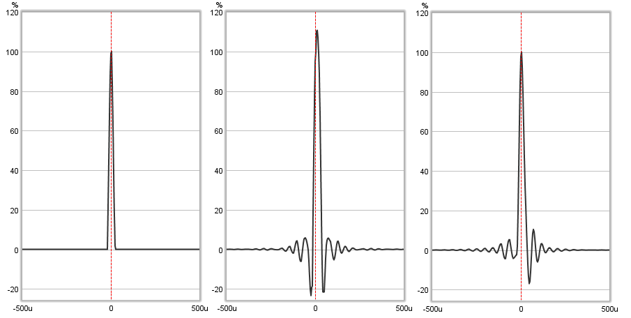

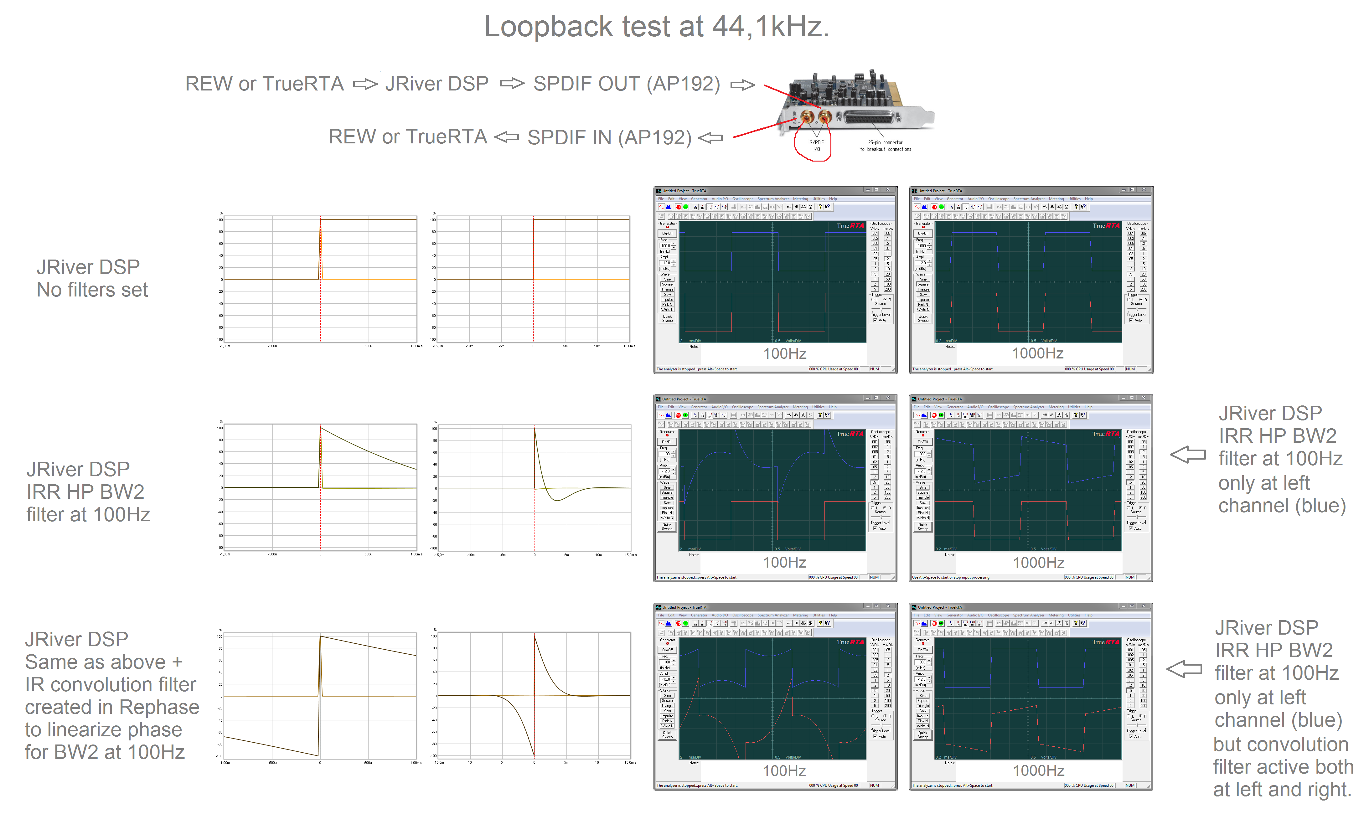

.....I've looked at the LS1 (which seems to be a very well-designed speaker by the way) and their step response actually does show some minor pre-ringing (see page 6: http://www.grimmaudio.com/site/assets/files/1088/speakers.pdf). Probably inconsequential, but it is there. I have always thought that pre-ringing was an inevitable result of correcting crossover phase and that its inevitability could be proven mathematically. Are you sure that is not the case? Intuitively to me it makes sense there has to be some pre-ringing, because when you visually inspect the filter it appears to be doing things well before the actual peak. But I guess I need to educate myself on the matter 😱.
Guess whatever small pre ringing in LS1 paper is their ADC/DAC's or sample rate conversion, about math behind myself got curious and did a small live study. IR in third plot is pretty clean so filters math seems okay and think if reality show other it must be other components in chain or use of wrong filters. In live study use SPDIF loop to rule out distortion from ADC/DAC chain.

Hi BYRTT,
Problem with the step response graphic is the DC component.
(as shown with corrected signal)
step response is the integral of the impulse.(1 ---> 1/s)
Dirac function (or delta func.) include large amount of very low frequency (see DC component).
The use of soundcard (spdif or other way) is limiting the bandwidth.(transformer or serie capacitor).and of course missing components
Can get a try with a scopemeter.(step response or square wave).

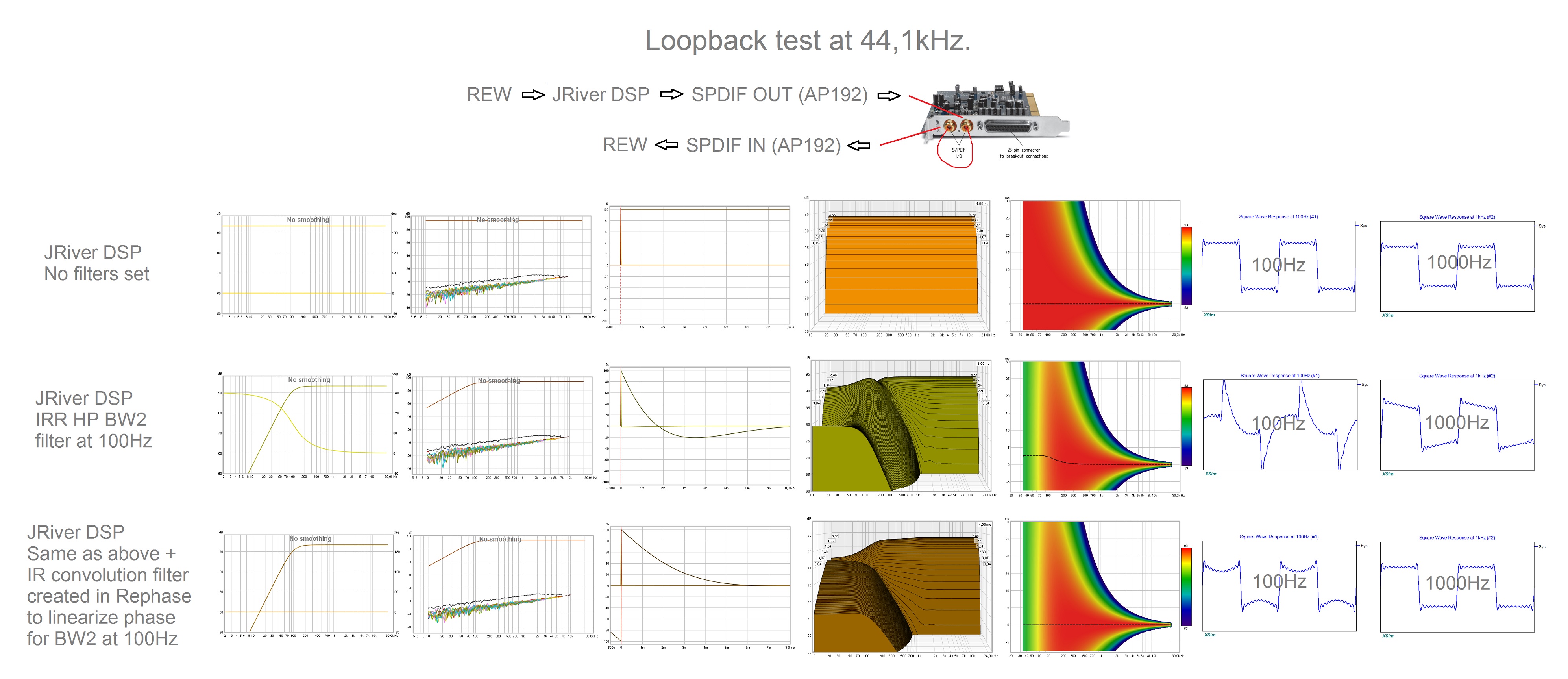

Hi thierry38,
Thanks input unfortunate not shure i understand 100% other than agree amplitude energy (DC component) is missing in the one with IRR BW2 HP filter plus FIR phase convolution correction. You mention squarewave find it visualized below in a live run including REW IR/SR windows from previous run but this time presented with other X/Y scale settings.
Think study, in its a real live run via SPDIF show that math behind which keiser was questioning do not add that small pre ringing we happen see for some, also in that IRR filter is programmed by JRiver company and convolution filter is programmed by pos show us there filters is precise and working as they should : )

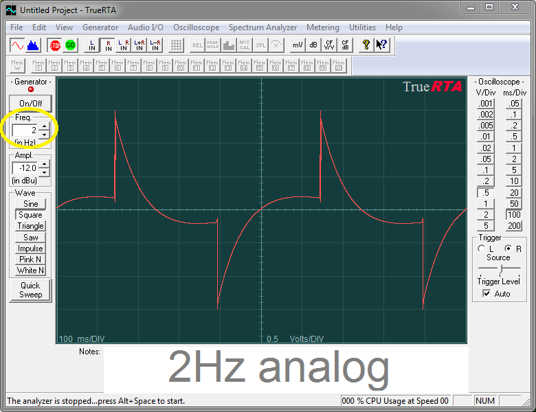

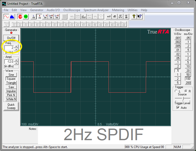

.....The use of soundcard (spdif or other way) is limiting the bandwidth.(transformer or serie capacitor).and of course missing components...
SPDIF code seems have instructions for DC component no matter transformer or capacitor in the interface, AP192 have 4 channels two of them SPIDIF and two normal analog, see below when they looped a 2Hz squarewave : )
