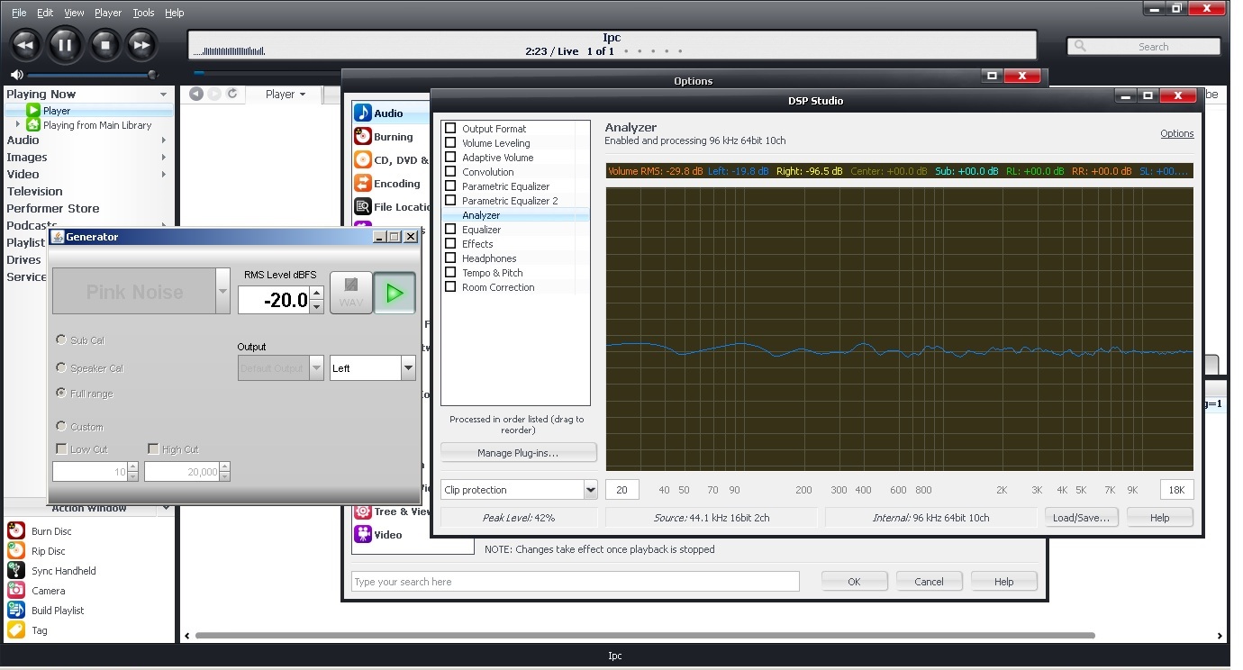

With everything disabled in the DSP stack i still see the -10db different on the pink noise. Something is amiss, havent found it yet
Does that include the (internal) volume setting of -12 dB?
Strange thing is the internal volume slider doesnt seem to make a difference to the level displayed on the analyzer

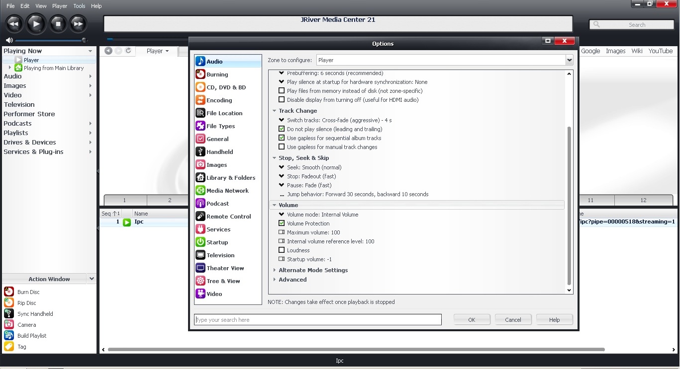

Just tried this in my setup by playing a random song and looking at the analyzer. It perfectly lines up with the internal volume control, drop the volume and the graph in Analyzer drops as well. I guess we'd need to see more settings to get this sorted out. It would be strange (to me) to drop internal volume by 12 dB only to later raise that volume level in another DSP section by 9 dB.
Something is off here... Could you make a screen-grab of the Options -> Audio that includes the volume settings?
Isn't this one doing exactly what you want?
What you show here is a left channel -20 dB signal source playing and in the analyzer it is showing -19.8 dB for that left channel. With the internal volume set at 100% it all seems to fit rather well. A leak signal is seen in the right channel of -96.5 dB. The rest of them are silent.
Not sure what is wrong here, seems quite alright to me.

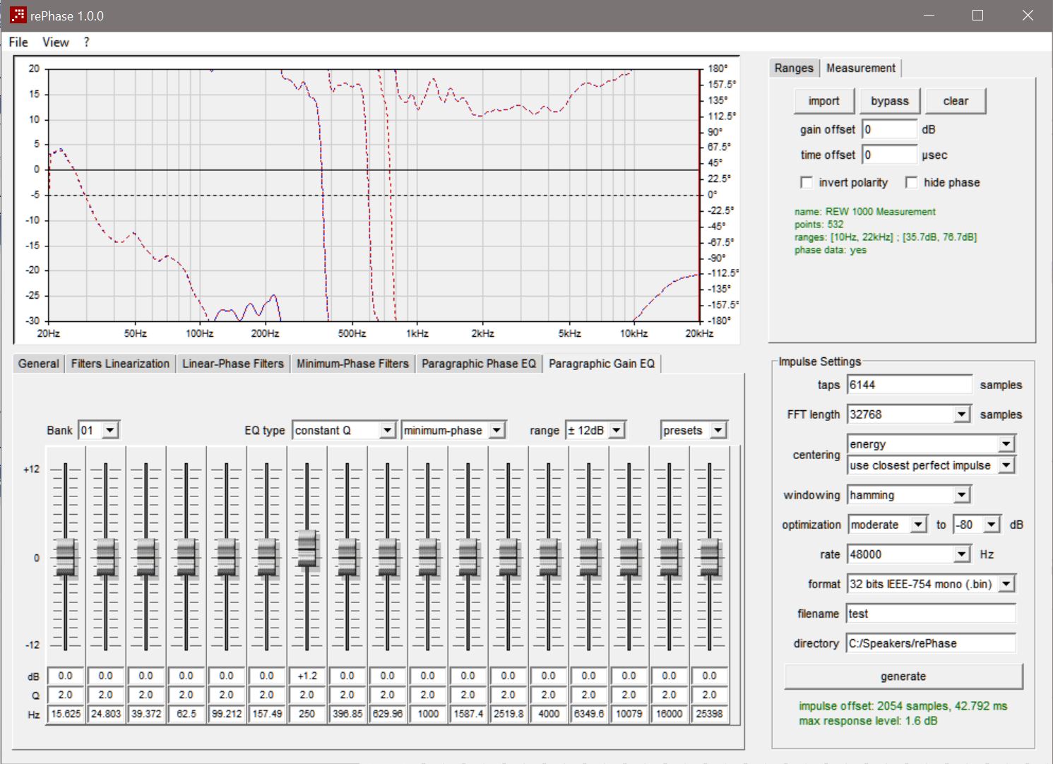

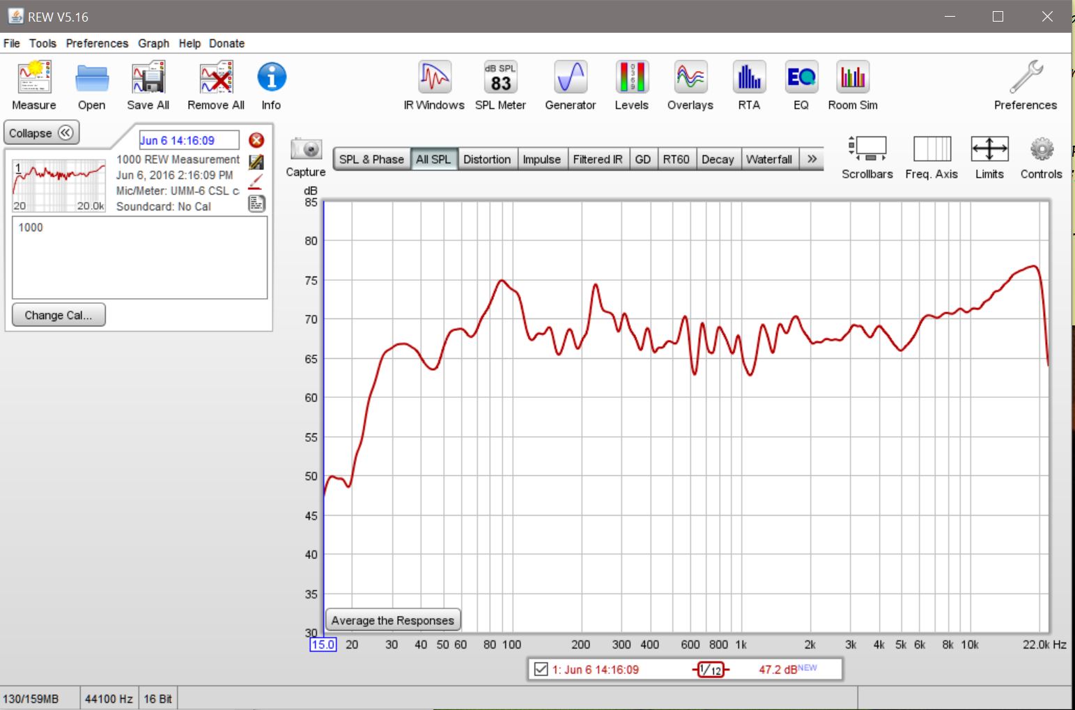

Is this where I should ask? In rephase, I cannot see any FR plotted after I "import" a measurement from REW, I just see the phase plotted. I tried following here: https://www.minidsp.com/applications/advanced-tools/rephase-fir-tool
Any suggestions? Should I make a new thread instead, or could someone point me to where this discussion has been gone over previously? (I didn't find)

.....In rephase, I cannot see any FR plotted after I "import" a measurement from REW.....
Looks in your REW plot measured frq response dynamic range is within +47dB to +77dB and into Rephase visible range is set to -30dB to +20dB. In Rephase at "Ranges" tab you can change the scale so frq trace get visible or into REW before export then offset measurement to zero dB area.
Yes, you can use the "gain offset" setting in the measurement import tab.
The array keys will let you quickly lower the value until the magnitude graph becomes visible.
When your finished with your correction don't forget to use the bypass button to make sure correction levels are in check.
