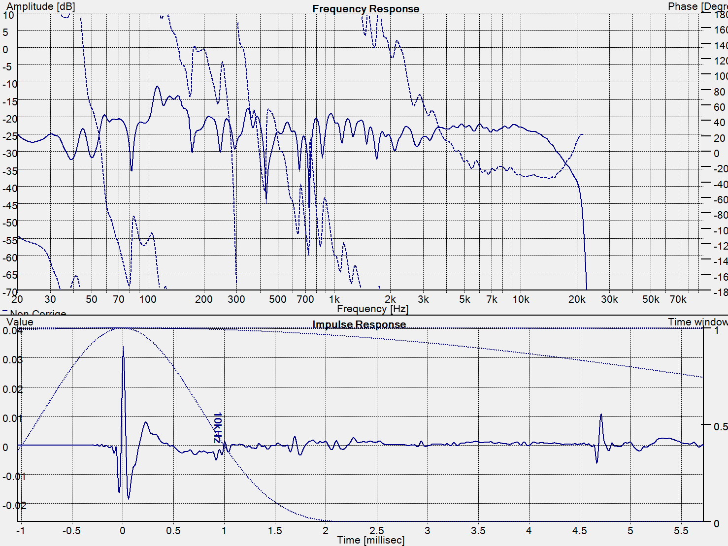

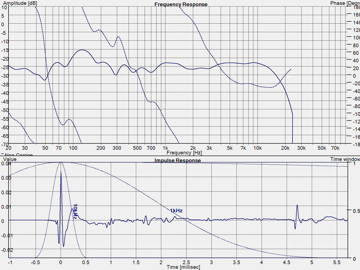

One more question which was a matter of debate was the appropriate window of measure prior to using RePhase. I kind of found out that using HOLMImpulse with the 'Frequency response smoothing' and the 'Complex Smoothing' was the most appropriate way to capture the best information to feed into RePhase and get the most linear phase through the whole frequency range. Would you agree or would you have any better suggestion, using REW for instance ?
There is no ideal measurement window (or distance, or technique) that will work all the time. It depends on the distance/position (mic, loudspeaker, boundaries), the number of ways, the frequency range, the things you are trying to correct, etc...
For example for phase-only corrections, you don't need high frequency resolution but you need to avoid reflections as much as you can, so manual gating is a good solution most of the time.
The lower you want to measure (ie longer gating) the closer you need to get from the loudspeakers, and as a consequence the less accurate you will be for HF and phase relation between ways.
So for a fullrange correction you will most likely need several measurements at different distances and gating length to get an accurate picture.

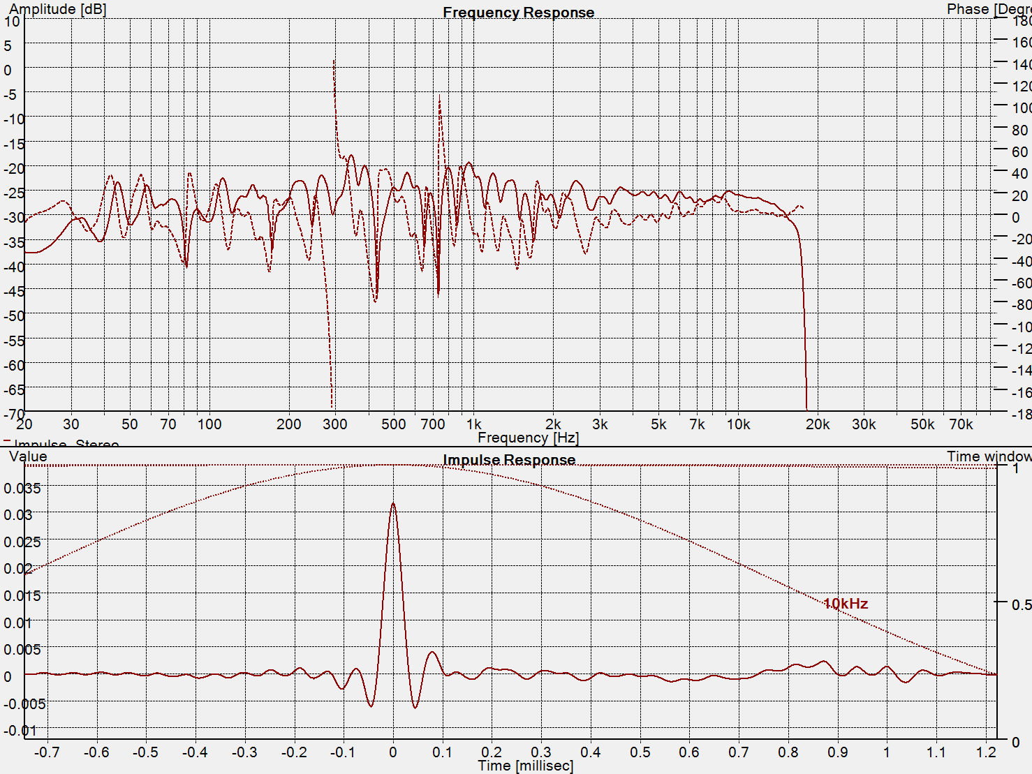

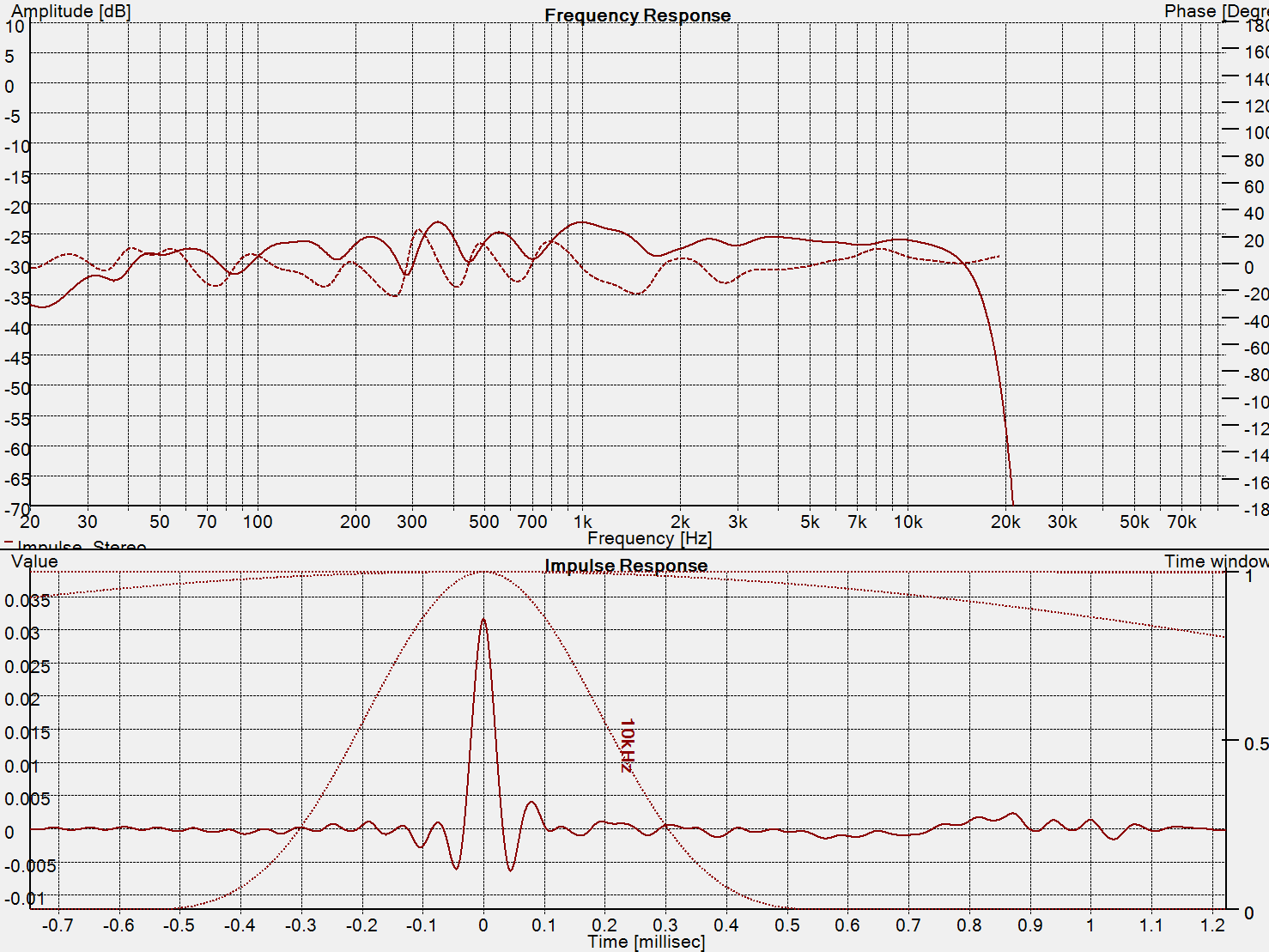

Something I found interesting using RePhase is the apparent decrease of the impact of reflections. Not only is the impulse much cleaner in the very few ms after t=0,
Without correction:
[image]Image:1.5ms_Impulse_wp_RePhase|none[/image]
With correction:
[image]Image:1.5ms Impulse with RePhase|none[/image]
but the relative importance of reflections seems to be reduced in % in the ms after the impulse:
Without correction:
[image]Image:15ms Impulse wo RePhase|none[/image]
With correction:
[image]Image:15ms Impulse with RePhase|none[/image]
Without correction:
With correction:
Without correction:
With correction:
Also from a listening perspective, I found the sound stage incredibly better defined and deeper. I also had the impression that the loudspeakers had kind of vanished leaving only the music. Very impressive 😉

Hi Pos, It seems that, when digging deeper into the details, ie going from a smoothing freq of 1/3rd oct to 1/12th, some non-linearities of phase (phase rotation) surface which were hidden before. Would you recommend to process them ? What tools in your toolbox would you recommend to achieve this ? Thanks in advance.
