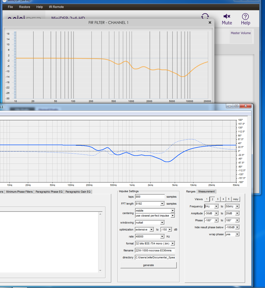

I would think it is because you need a 96kHz sample rate filter, presumably it doesn't do a sample rate conversion for you.
Wow, thanks for the fast reply. I hadn't thought of that wrongly assuming it would be a standard 48KHz sample-rate (the rephase screenshot on the miniDSP website shows 48KHz). With the IIR filters the manual says to use a 96KHz program to build biquads, nothing about sample-rate with FIR filters. But somewhere all the way in the back of the manual there is this:
Audio resolution
24-bit input and output, 96 kHz internal sample rate (depending on plugin)
Doesn't seem like there is any way to change it. 4K taps on 4 channels isn't that much if you have to use 96KHz :-(
Audio resolution

Hello,
Trying to évaluate the phase response of a miniDSP Umik, with rePhase "invert" fonction, gives that curve:
meaning the phase measurement / correction error, using a calibration mic file without phase informations,
may be around 60° at low and high end.
