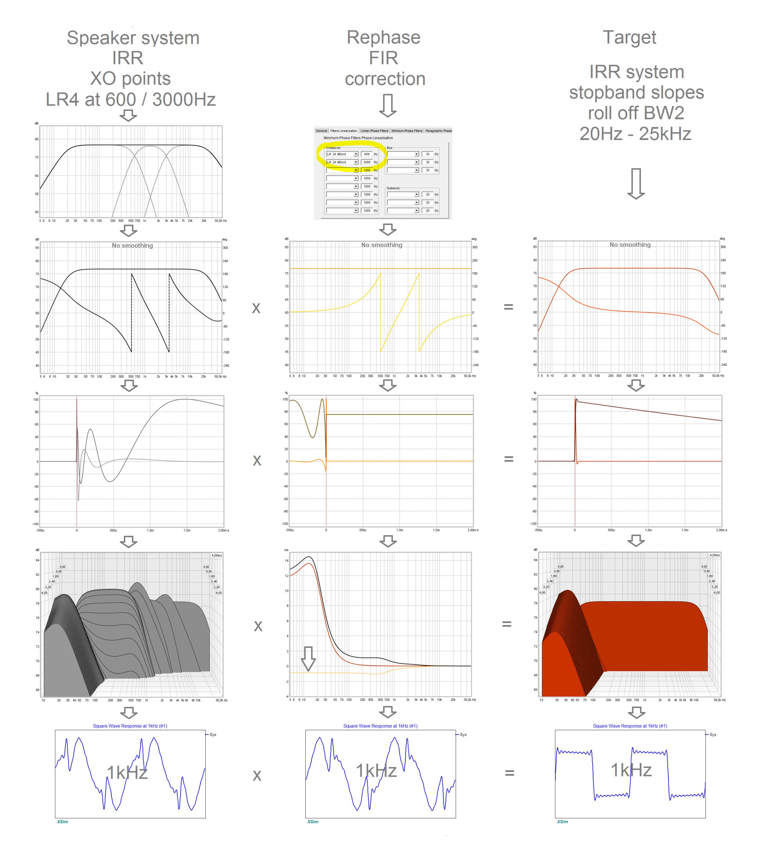

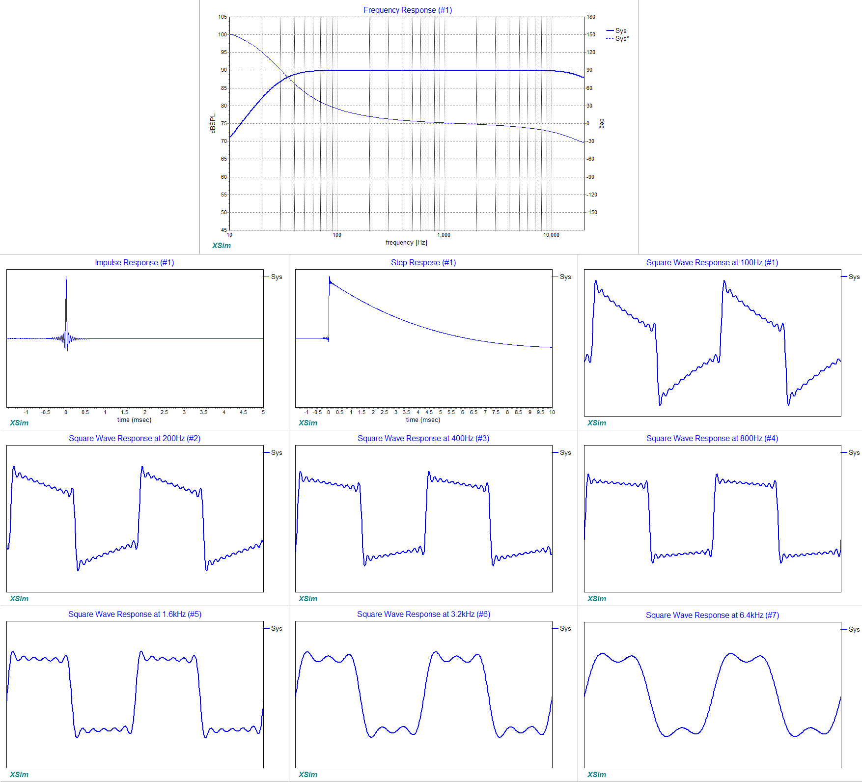

Mitch,
- You have mentioned the subjects of pre-post ringing earlier. Bohdan who is active on this thread has published an interesting paper on this: http://www.bodziosoftware.com.au/pre_post_ringing_ir_and_pulses.pdf
I would be interested if you could elaborate on best practices to avoid pitfalls in this respect and how to chose between min-phase and linear phase filters in various occasions
- You quickly touched 'beamforming' (https://www.researchgate.net/public...esponse_measurement_using_beamforming_methods) as a way to average measures and get rid of room influence to reach close to anechoic measurement in your e-book.
A famous provider in the industry in promoting 9 measurements at the edges of a cube+center. This does, according to my experience, provide together with REW pulse algebra, quite interesting inputs for REW/rePhase usage. I would be interested if you could dig into this kind of direction in order to provide more robust measurement strategies.
Thanks in advance,
Kind regards,
Pierre

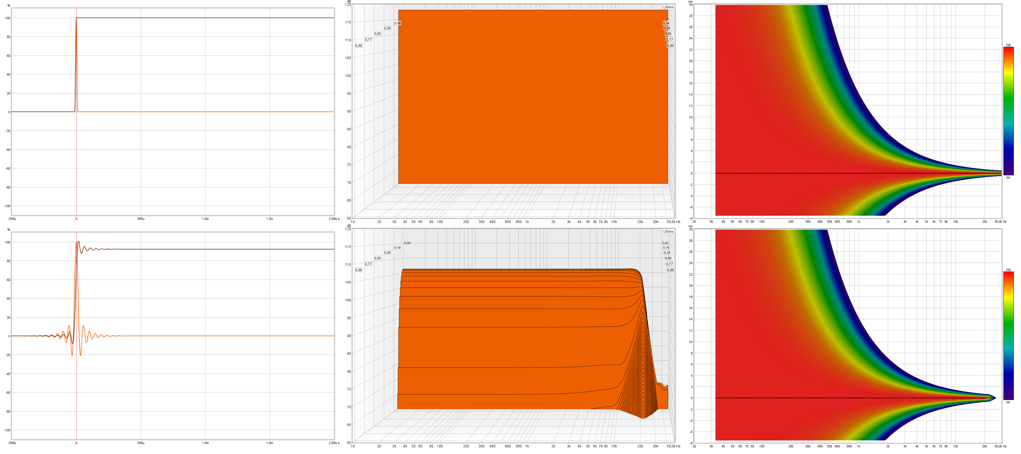

For my current project I would like to use a lowpass filter at 22 kHz to prevent that the 28 kHz resonance of the tweeter modulates into the lower frequencies and increases multisine distortion.
For this I plan to create an linear phase FIR filter with rePhase but I am not sure, how steep this can be without causing any problems. I created this filter with 400 taps at 96 kHz and 192 dB / octave.
Can such filters cause any audible problems like pre-ringing or something else? I changed the scaling to 50 kHz and -150dB and the rolloff was totally smooth.

Hello
In your situation adding a brickwall-like linear-phase filter around 22kHz is not much different that having a sampling rate converter to 48kHz or the like.
These things are everywere in digital devices, and imply antialiasing filters.
Some are linear-phase, some are minimum-phase, with different possible slopes and imply different trade offs between stop band rejection and impulse ringing.
Many DACs will let you choose between several of them (eg ESS), and some (audiophile) people have expressed preferences for one or another type (minimum-phase and/or gentle slopes, most of the time).
That said industrial guys often add these option to give the user (or integrator to be more precise) the option of reducing the delay (minimum-phase implies a shorter delay), not really for sonic qualities...
Both pre and post ringing are probably not audible at these frequencies (what is? 😀), and phase shifts in these HF frequencies is also not something to worry about, so... But when you need to integrate a DAC the delay it implies or the phase shifts it will add are something you might want to be able to modify.
With rephase you can generate any filter you want: linear or minimum phase, or a mix of the two, and with any slope. This is what soekris did for his DAC.
I would recommend using a brickwall filter and then play with the different Albrecht windowing algorithms in rephase: the more terms you use the deeper the noise floor (up to 290dB for the 11-term variant when applied on a brickwall filter (which is a worst case scenario)), and the gentler the slope (which you can increase by adding more taps). I really like these Albrecht windowing functions!
You can also combine a linear-phase filter and a minimum-phase one, possibly at different frequencies, to get a tradeoff between preringing, phase behavior and rejection. In this case you do not want the windowing function to dictate the slope.
Regarding your specific case, with the 28kHz breakups and peak, you should also consider the fact that even if you remove the offending frequencies from the input signal by filtering or EQing it, distortion products from the lower range might still trigger the peak (eg 3rd harmonic distortion generated at 9kHz). Active filtering cannot do anything to address this, and all you can do is either use acoustic filtering (eg reticulated foam) to reduce the output of the driver (in opposition to reducing the input), or EQ/filter you input and the address the distortion problem by using current drive (a simple resistor inline with the tweeter will do the job) to reduce the 3rd distortion generated at 9kHz.

Hi ustas,
Not sure what you expect. The process is straightforward. Here is an oversight: Using REW and rephase to generate amplitude and time domain corrections
From REW:
- take both channels measurements, with Psycho smoothing and no FDW, go to 'EQ' tag, select rePhase as your EQ, and generate your filters according to your prefs. Save filters to .xml files
- export both measurements with full time window (no FDW) and higher resolution (1/12th octave) to text files
- export both measurements with 6 cycles FDW to text files
In rePhase:
- draw one measurement in full time window onto the interface of rePhase. Use Gain EQ and import the filters from REW. Make further adjustments
- draw the measurement with 6 cycles onto rePhase interface and adjust phase. If you do not know the crossover frequencies of your LS, make a 10cm measurement of each driver and superimpose in REW. This will give you a good approximation.
- linearize the crossovers with appropriate function (try various slopes)
- gently adjust phase near crossover frequencies with phase EQ.
You can add a subsonic filter (high-pass filter). You can choose from min-phase (no pre-ringing but more post-ringing) or lin-phase (a little bit of pre-ringing, not audible).
And you are all set.
