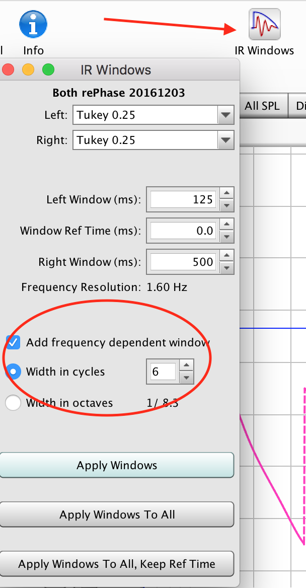

Question: What is it "measurements with 6 cycles FDW"?

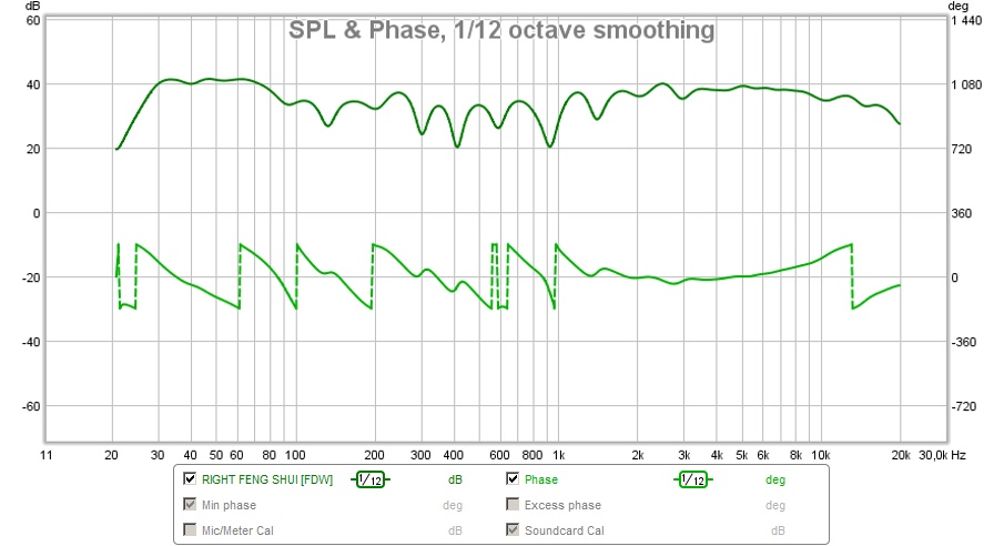

So, I also have a strange phase in my system, what wrong with it?
FDW is Frequency Dependent Window: see attached example.
Please post your phase measurement as an image attached to your post.

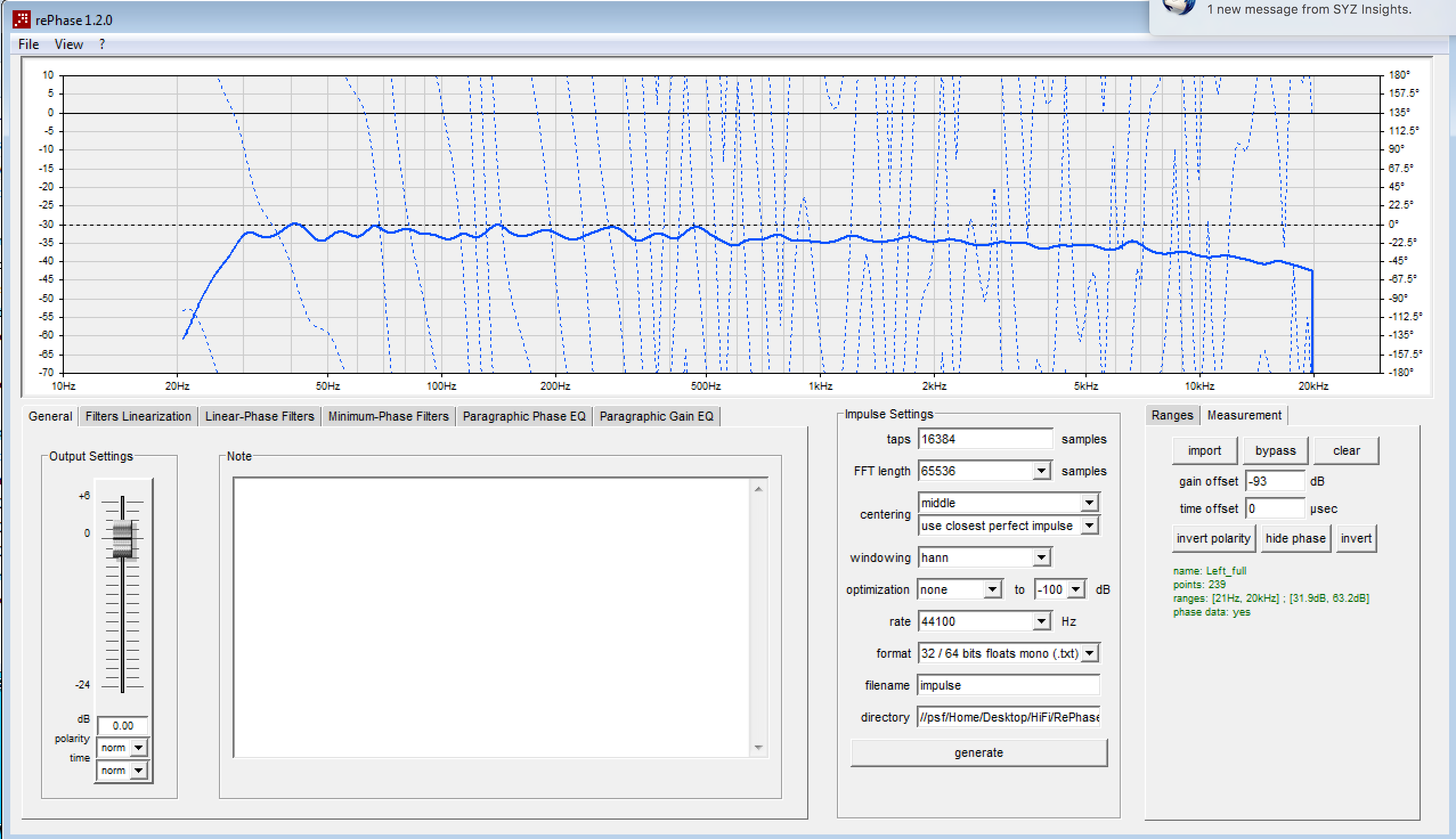

Thank you! System is 4-way NanoDIGI.
IIR XO points are:
LF - 144Hz 18db BW XO (vented box)
MB - 144Hz 18BW >>>> 1500HZ 24LR (closed box)
Mid - 1500Hz 24LR >>>> 7000Hz 18BW (waveguide)
High - 7000Hz 18BW >>>>> (waveguide)

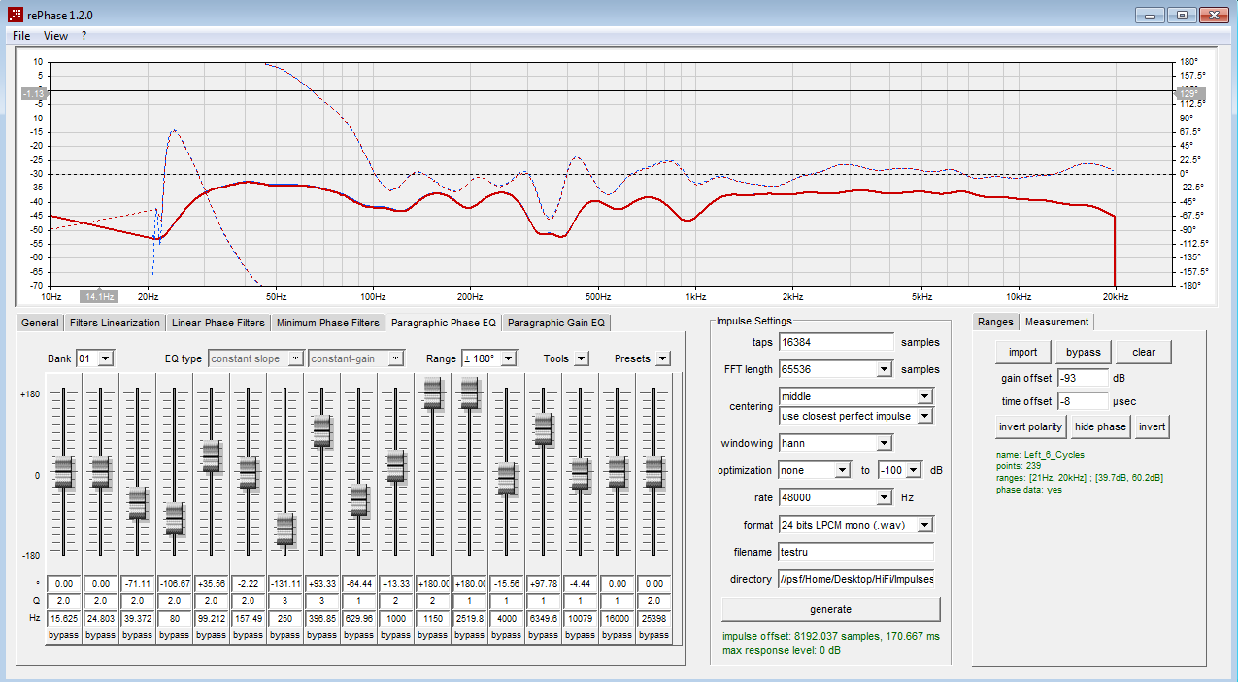

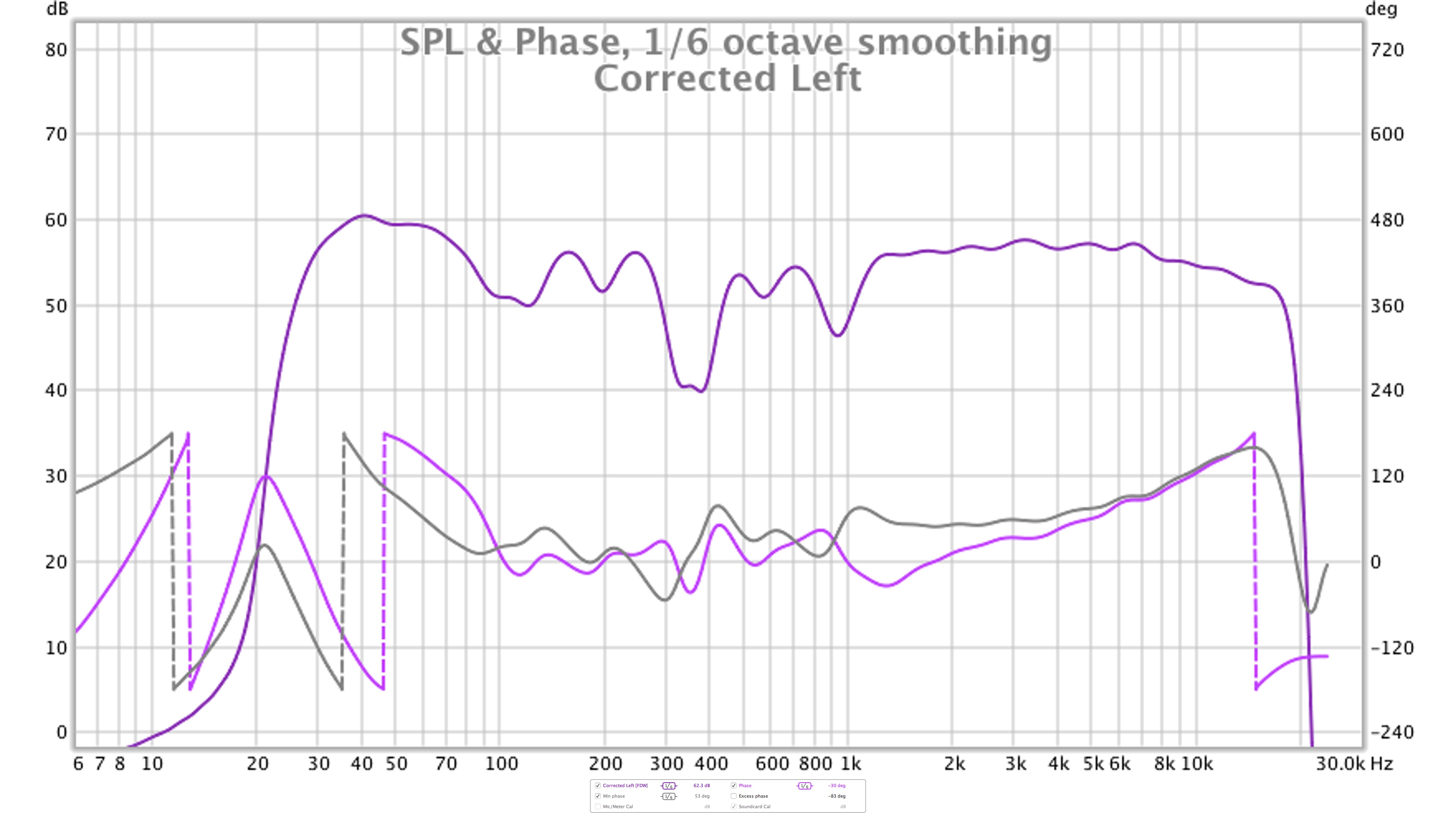

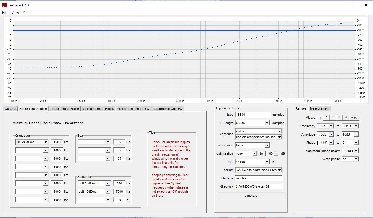

OK. I had a look.
SPL is super clean and does not need any adjustment IMHO.
As far as phase is concerned, I am not a specialist, but I could not find any 'academic' way to solve the pb.
I used following settings to reach a phase which is not too far from minimum phase. This solution produces pre-ringing, but this should not be audible.
Once again, there are probably much better solutions.
May be Pos or one of the seniors here have an idea ?

Hello,
SwissBear, that is a big amount of phase correction you proposed!
Imho, this measurement is not so reliable to base a phase correction on it,
probably too much reflected sound creating "virtual" phase wrapping,
i'd try with a measurement at shorter distance to mainly reflect loudspeakers.

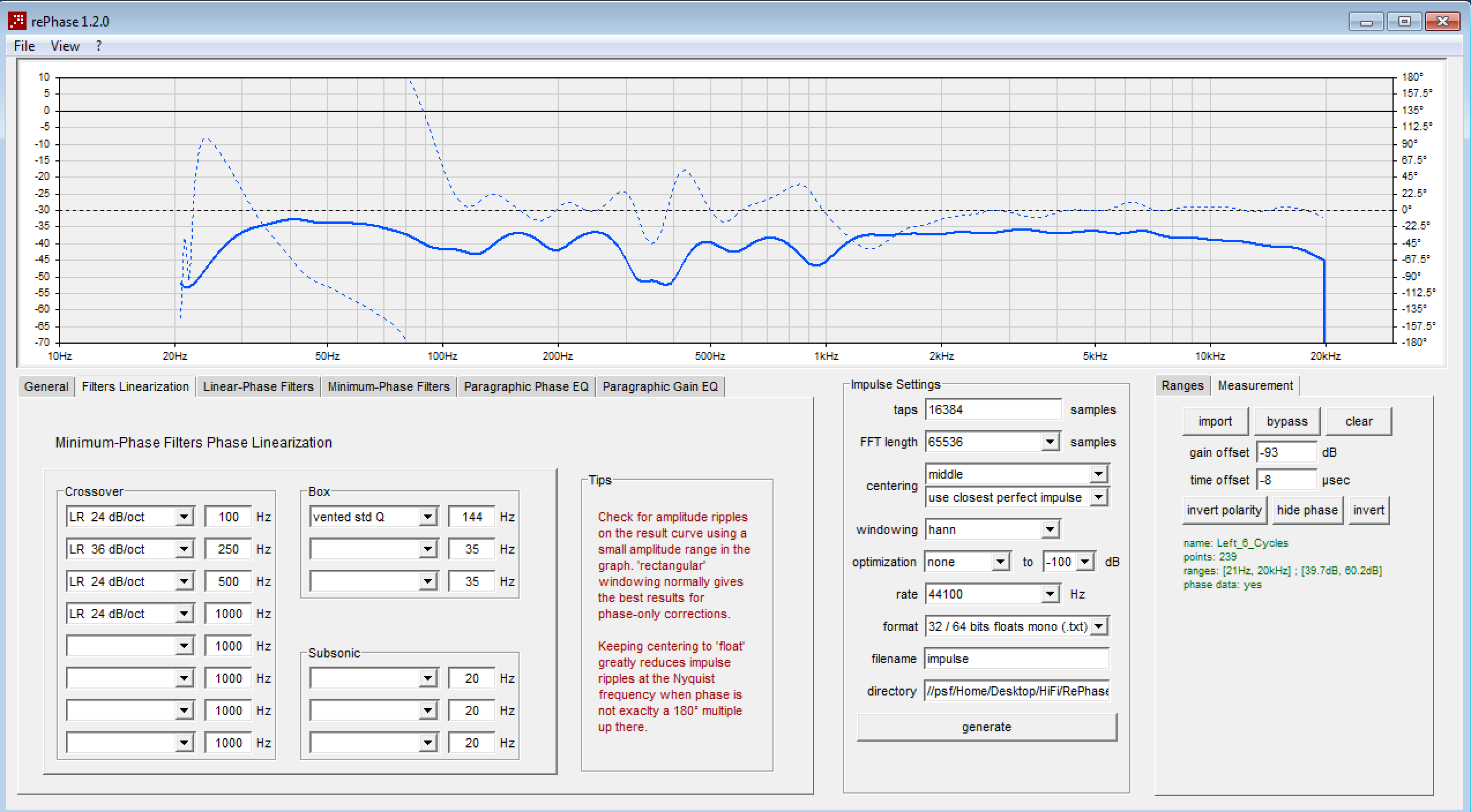

Hi, I have no idea if this will help with all your phase rotation across the spectrum, because most of my experience in correcting phase is driver by driver.
But my first step is to try Filters Linearization against whatever Minimum-Phase Filters I'm using. So the attached would be my first poke at it..
Your two 18BW @ 270 deg rotation each, and one 24LR @ 360 deg should add up to 900 degrees, which at least totals correctly against the attached..
Any particular reason you're using 18BW instead of say 24 LR?

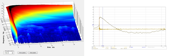

Look at the IR first, are there early reflections? If there are, all bets are off. Phase will change due to these early reflections. REW can tell you when. Look at that phase while setting it to one cycle frequency dependent window, two cycles and then three and so on, Look for changes in FR and phase. Connect reflections to that change and you learn when a reflection eats away at the frequency curve and where.
Reflections change geometrically when you change position. It's better to solve those with damping, speaker placement or diffusion. If you EQ it out, it will make a change for the worse once you move a little. Get rid of the reflection and the FR will clean up even without EQ.
Another helper: look at a wavelet to confirm what you saw with the frequency depended window and see that wave develop by scrolling the though the window size in milliseconds. Reflections don't happen at the start of that wave front (unless they are really really early, -> See IR) if you see a dent at the start of the wave front, you probably can fix it. If you see a sort of hole in the wavelet graph, it's most probably something room related, meaning you shouldn't want to fix it with phase EQ. You can still cover it up some in the frequency graph, check for trends with multiple measurements.
If the IR is clean, and the filtered IR shows the reflections are down by ~-20 dB, EQ the frequency response based on the method in the post above from BYRTT, 1/6 window or 5-6 cycles. If you do it in REW you can either have the IR or the early waterfall on the bottom window. You can actually see the waterfall clean up with PEQ cuts. Small cuts usually drop ridges seen in the waterfall by more dB than the negative PEQ gain you use. Get the FR back in shape with a more broad Q (wider area) boost.
At least, that's about what I would recommend. Believe me, getting that IR /filtered IR as clean as possible first is mandatory. Unless you want to listen with your head locked at one spot. I don't want that, do you?

Hi, ALL, and thanks a lot for all people who try to help me.
The biggest problem of my system is my listening room, sure. It's is 5,80m x 5,85 x 2,90m with two non symmetrical windows. Speakers placed in the corners of room (WAF🙂), listening position (LP) in front of a wall of speakers (near wall).
LF speakers, Aurasound 1808 in a modded "Jensen Corner Cabinets" (BTW this is BLH). How and where can measure response of that in near field I don't know.
MB speakers 14L. closed box with JBL2012.
Major sound problem was 80-200Hz area. For example: 120Hz : +6dB, 125Hz : -12dB, if inverting polarity of one speaker vice versa: 120Hz : -12dB, 125 : +6dB. This is because absolutely incomprehensible phases unevenness from BLH.
Just with 18BW XO I can reach current FR. Тhe measurement is made in LP (one point).
Today I did as SwissBear said.... Result is WOW!!! I found THE MID-BASS!!!!
Here files of FR and RePhase corrections: download

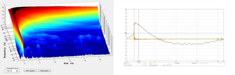

In fact, it would be safer in your case to reduce the size of the FDW down to 3 cycles.
The larger the window, the more rooms reflections you include. In my environment, I usually find 6 cycles appropriate. But at Jmbee underlined, this is leading to a lot of phase adjustment. May be too much.
With rePhase, like with Acourate, you need to find a balance and judge with your ears what is best in your environment.
So try with 3 cycles just to judge how you feel about it.

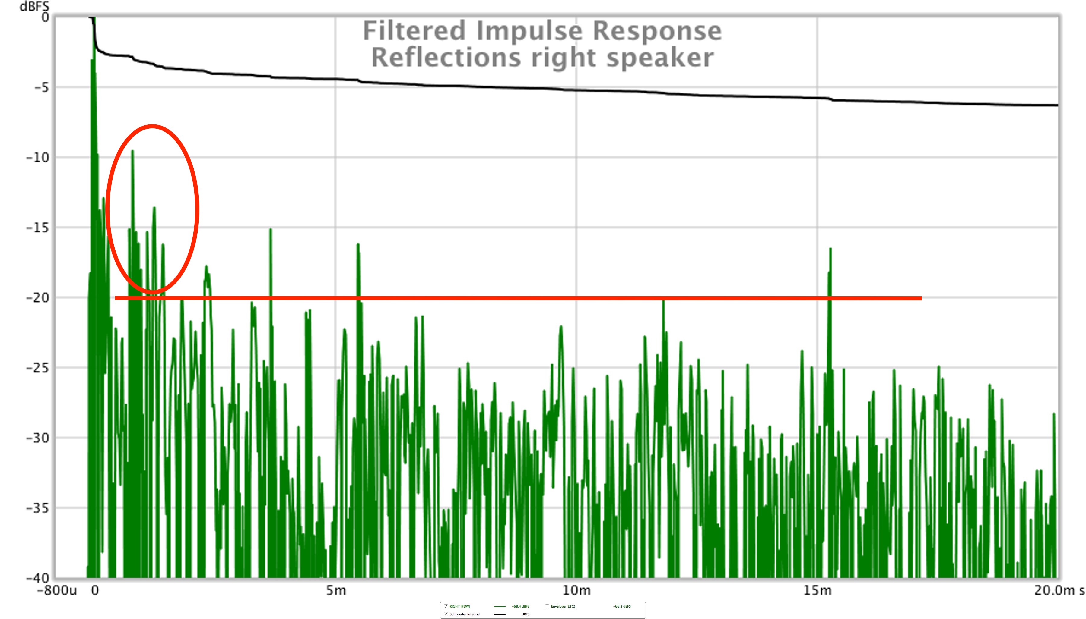

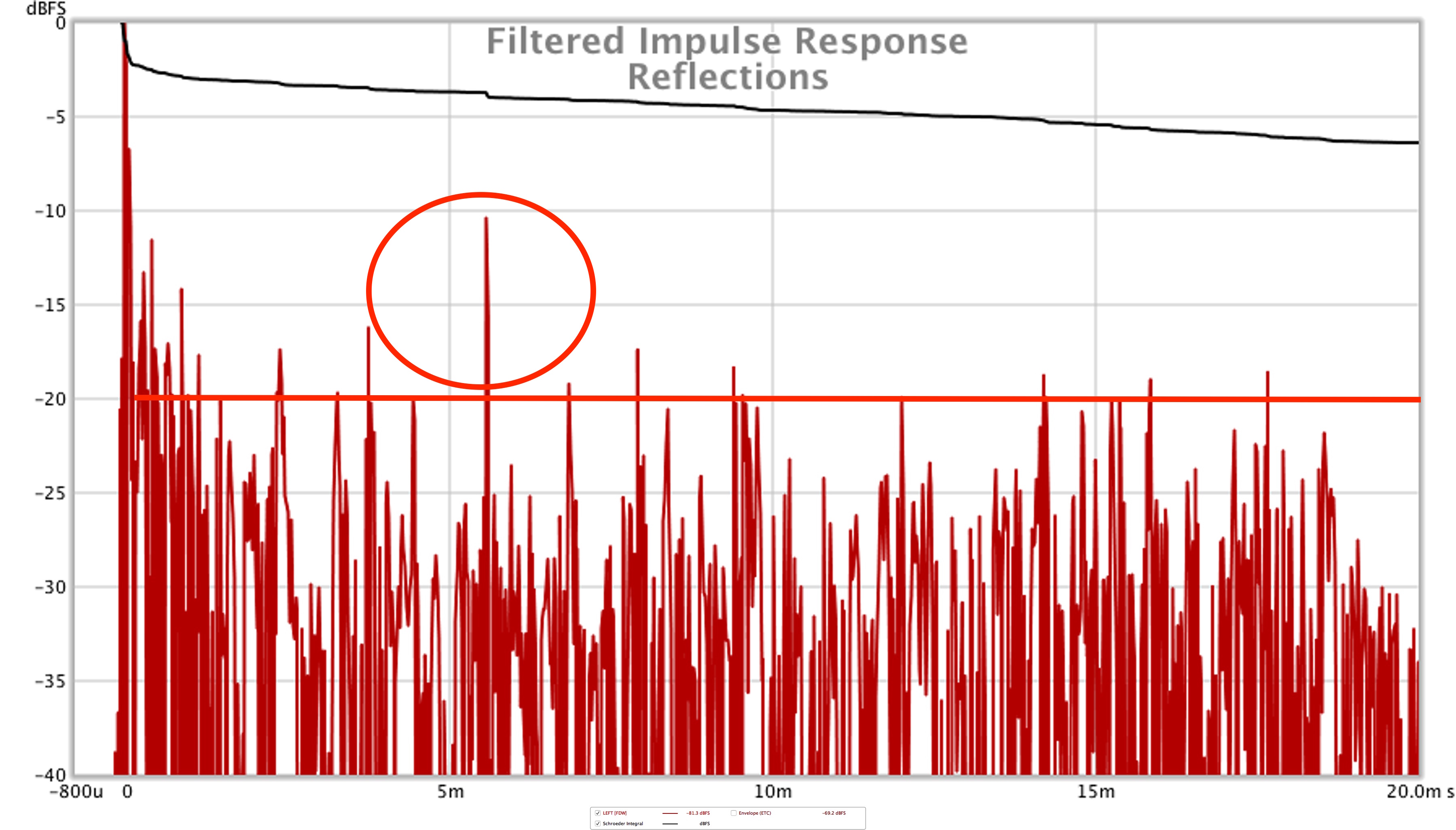

Also, you could have a look at the reflections in your room. See attached graph of your left speaker. You have something potentially noisy at 5ms, which is 5x0.34 = 1.7m additional distance from your speaker to the listening position. This might be your roof or something else which is worth treating with a panel.
Please note that the right speaker shows reflection at different times. This is something you might want to sort out in order to improve your listening. You will also probably notice that rooms correction with rePhase does have positive influence on reflections. In my room, they are decreased by 5db when correcting with rePhase.

I think Swissbear was referring to the large peak, as seen in the filtered IR plots. Not an actual noise source. A relative empty room will have more "room effect" than one filled with absorbing and/or diffusive elements, for example a filled bookcase.
