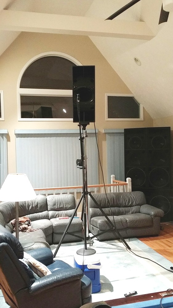

The speaker is on a stand about 9 ft off the ground, in a room with a 16 ft vaulted ceiling. Room is about 26' x 17'. So there's a little breathing room before reflections.
Mic is about 8' off floor and 4-5ft from the speaker which tilts down a little to aim at mic.

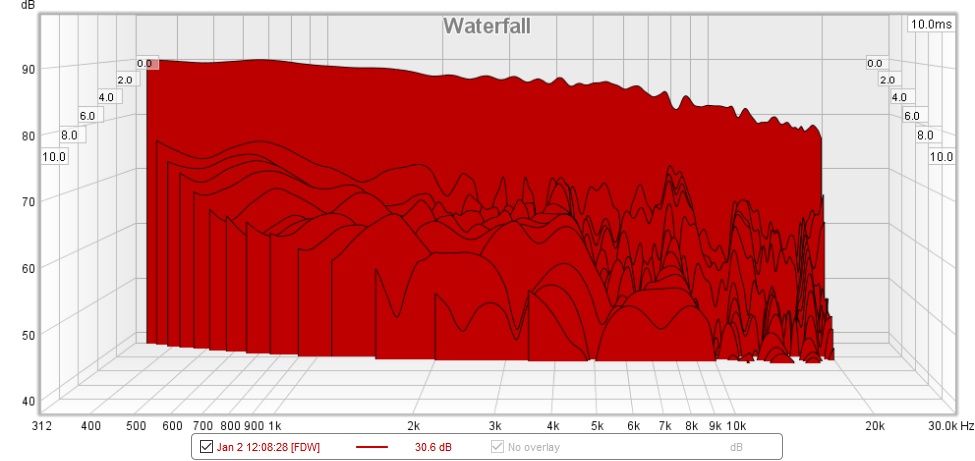

As we see the initial peak overshoot the zero point something doesn't line up in REW. As you are using loop back it should know as it would compare the time of travel to that input loopback signal. I haven't used loopback in my measurements so I can't be of any help there. Usually people with loop back have the impulse start right at the measured delay, at least that's how I've seen it. Hope someone with loop back experience can help.
I've read some of that thread over on Soundforums, quite the company is involved there, I saw Raimonds Skuruls from APL post there too. And some familiar names from this forum. It made me say up way too late! 😱
I was thinking about the wiggles, could be a number of things.(*) If you're relying on REW's auto EQ, you may be able to do better with some manual tweaks. On the EQ tab make sure to see the impulse or an early waterfall plot on the bottom graph. That will give you a visual queue of what's happening.
Talking about early waterfall graphs, they might show the reason for the wiggles. Look at the very early signal to maybe get a clue of what's happening.
Something like these settings:
I wouldn't know for sure, but I'd suspect some vibration of something in the enclosure might be causing wiggles that early. Could be the horn body, did you damp it?
If not, I'd isolate the horn body from the rigid enclosure with neoprene, sorbothane or butylrope. Place rubber rings under the screws that hold it. Cover the body of that horn with some automotive damping material, the good stuff using butyl and a thin alu layer. I use Silent Coat 4 mm but that's because it's more local over here. Lots of brands, though not all brands have the same results. I guess Dynamatt should be ok. Lots of info on diymobileaudio.com.
But I'm assuming here, lets first see the early waterfall plot.
If I did see your graphs in the Soundforums, you've had a bottom end under it with phase correction down to the low numbers, how did that sound? Did you listen to Stereo that way?
(*) if the actual peak isn't aligned at zero, the wiggles will change a bit.
Yep, you no doubt found me on soundforums. It's been a very fun project...and like here, the guys are great in helping. Heaven knows I've needed help !
I've built both versions, the 60 degree and the 90 degree. It's the 60 degree I'm working on here.
The waterfall is with the settings you gave. Are the ridges in the higher frequencies, particularly at around 8kHz, the possible root of the wiggles?
It would be great if HF horn resonances, or maybe even CD driver to horn throat mismatches, are the cause, as these might be fixable. I'll work on dampening the horn, an eighteen sound XT1464. The horns throat is also a slight bit larger in diameter than the CD exit. I haven't really figured out how to smooth that out other than a lame attempt with some beeswax.
It would be great because if it's not the high end, and the wiggles are due to the low end, I doubt anything can be done? The folded-horn low end is simply going to have ripples I think...?
I guess that's the price of so much power in a relatively small box. Did you see the sensitivity post I put up? 😀 https://soundforums.net/forum/low-e...2390-60-degree-diy-mid-hi?p=203758#post203758
Yes, I've been trying to get phase flat as low as possible...still trying lol...I need miniDSP to allow an openDRC to use all of its 12288 taps in mono !
So far, I've gotten fairly flat to maybe 40 Hz, and what I've heard stereo indoors is promising. Bass almost sounds like there is less bass, until I realize I'm hearing a clearer more dynamic sound...and still feeling all the vibration I'm used to. But I really won't know until I can set up outside for some extended comparing to a more traditional IIR group delay...
I do already believe though, that at least the subs electrical bandpass filters should be linearized... I mean, why not, what's to lose?
I expect those ripples at 8 KHz is what you're seeing in the IR. The cause of that? some form of vibration maybe, but this plot is pretty clean already. Some manual EQ tweaks might bring down those ridges. It would be immediately evident in the IR and Waterfall.

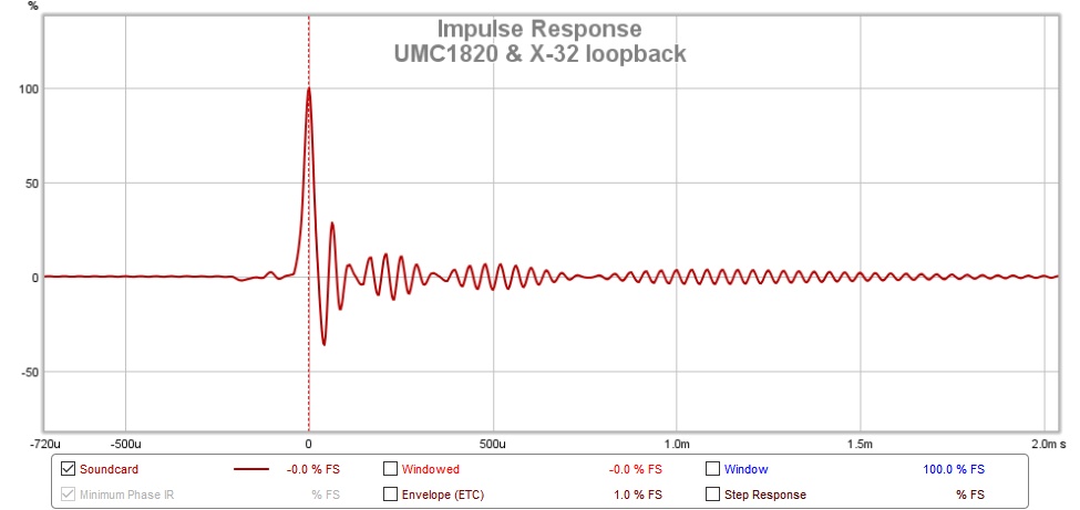

Wesayso, of course.... is there a way to attach a mdat file? or rather how do i get it to you?
I ordered a pack of Silent Coat 4mm that I found over here...been meaning to try this on the XT1464 forever....
I see what you and jtalden are saying regarding sound card ripple..
Jtalden, many thanks for the reply. I've attached an impulse of the soundcard & mixer calibration file that I'm using. Wow, I never dreamed it would be so wiggly. I guess I need to get used used to peering in closely in time. (Both soundcard and mixer are running at 48 kHz.)

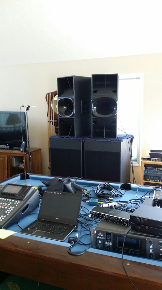

I've attached a couple of photos, but with some concern for veering off topic from rePhase...which by the way POS, thanks so much for the EQ implementation with REW, and also for the EQ bypasses and reordering...it REALLY helps, with manual EQ especially.
First pict is current measurement setup, second is a better pict of the DIY60's, and is one from the set of "And I wonder why she left me?" 🙄

A mismatch between software and hardware can give strange results. Setting everything to the same 48 KHz may help, but not if you want to play 44.100 files.
I've managed to clean up my IR, there's still some small ripple above the hearing threshold.
Yours looks like a mismatch between 44.1 and 48 somewhere in the chain.
I need to get to where I fully understand how REW estimates delay.
I know Smaart has some algorithm for finding frequency of peak energy, signal A vs signal B, and pins delay there.
I think REW does the same thing, but instead of doing a straight A to B comparison, REW does it A against a calculated minimum phase B. I'm fishing here....😕
AIUI the "Estimate IR Delay" button in REW is calculated from a cross correlation of the measurement against the minimum phase version of the measured response. This option is available whether you've used any form of loopback or not.
If you use a loopback (whether using the acoustic timing reference option or via a physical or electronic loopback of the measurement signal) then the impulse will be placed relative to that reference signal.
It sounds like your setup is the latter but you are talking in terms of the former.

Thanks!! That confirms what I thought, that "Estimate IR delay" is against a calculated minimum phase curve.
...I've attached an impulse of the soundcard & mixer calibration file that I'm using. Wow, I never dreamed it would be so wiggly. I guess I need to get used used to peering in closely in time. (Both soundcard and mixer are running at 48 kHz.)...
Its F-word irritating with those ringing bells, well sometimes i suspect its because all new silicon is so wideband and real good than to distinguish their cheap products from expensive products they by purpose makes those flawing filters. Had not all my tests at hand at this moment but the ones i found you see below and heck why could they in past make normal good filters on the ones in middle. The two modern ones at top are only looking clean or normal up at 192kHz which means if we lock them there other tricks when playing with lower resolution tracks needs to be executed. All tests are ASIO (except UCA222) clean loopback with no other devices in chain but admit we can't know if ringing is input or output or a combination of the two.
