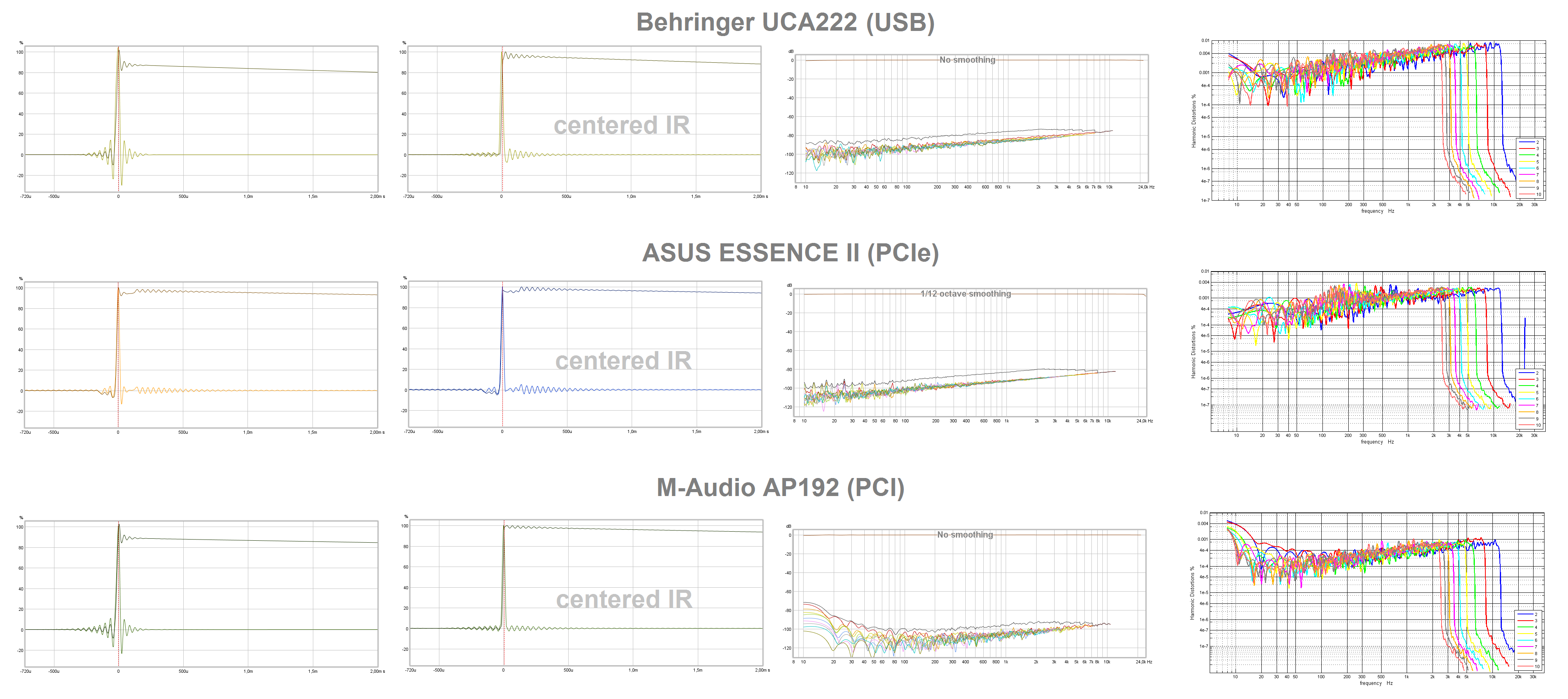

16 bit Behringer UCA222/UCA202 think is great value and probably good enough as measurement interface as seen below at 48kHz.

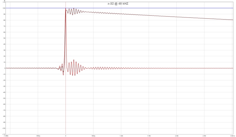

After measuring the three alternatives at my disposal... behringer UMC404, UMC1820, and X-32...I've decided the x-32 is the cleanest.
Hopefully will post new speaker measurements that include the sound card's starting (negative) contribution, later today.

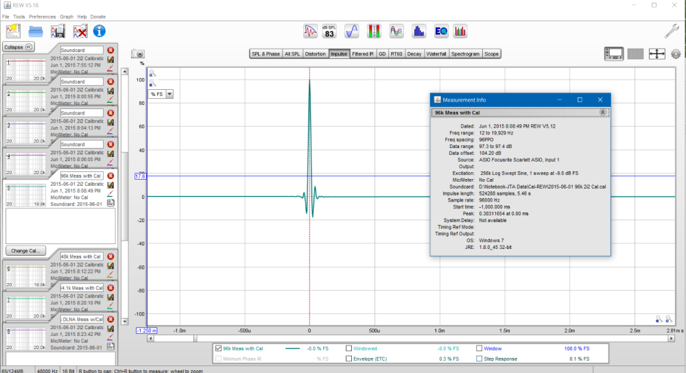

Mark100, My 2i2 is similar to the 6i6 above at 41.1, 48 and 96 kHz. The IR is clean at 96 kHz however when using a 96 kHz sample rate if the sweeps are limited to the audio range. That way there is no signal around the Nyquist frequency to feed the ringing. Possibly your current soundcard and mixing board will behave in the same manner if you can use a 96k rate.
My only pause with the 2i2 is that there is significant HF crosstalk between channels. This has been no practical issue for any of my sound measurements however.
