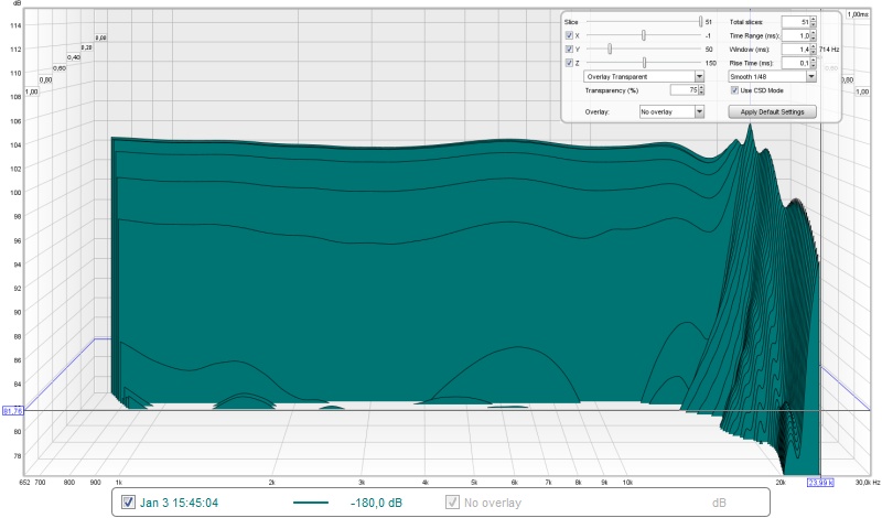

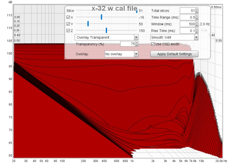

Here's a water fall of the x-32. I'm not sure how to set time settings for best look, so they are shown for redirection....
And I don't know what to look for in terms of HF ringing...sorry to be such a noob here...

This is what I think I am seeing as the ringing in your IR:
Peak of ringing at 24 KHz.
Just load an EQ tab in REW, have the IR plot show in bottom window and add a low pass filter at 22 KHz, it will cut the amount of ringing in half. This isn't a proposed solution, just trying to show this is the actual cause of those ripples.
The low pass only removed some ringing and created lesser new ones at a lower frequency (the new cut-off). So it's the filter at the top end as BYRTT said. Better filters will show less ringing.
Meaning jtalden's way may be an excellent trick to get rid of it in measurements. Set it at 96 KHz, and the ringing will move up. As long as your speaker doesn't have output all the way up there the measurement will be free from the ringing coming from the sound card. At least I'd expect it to be.

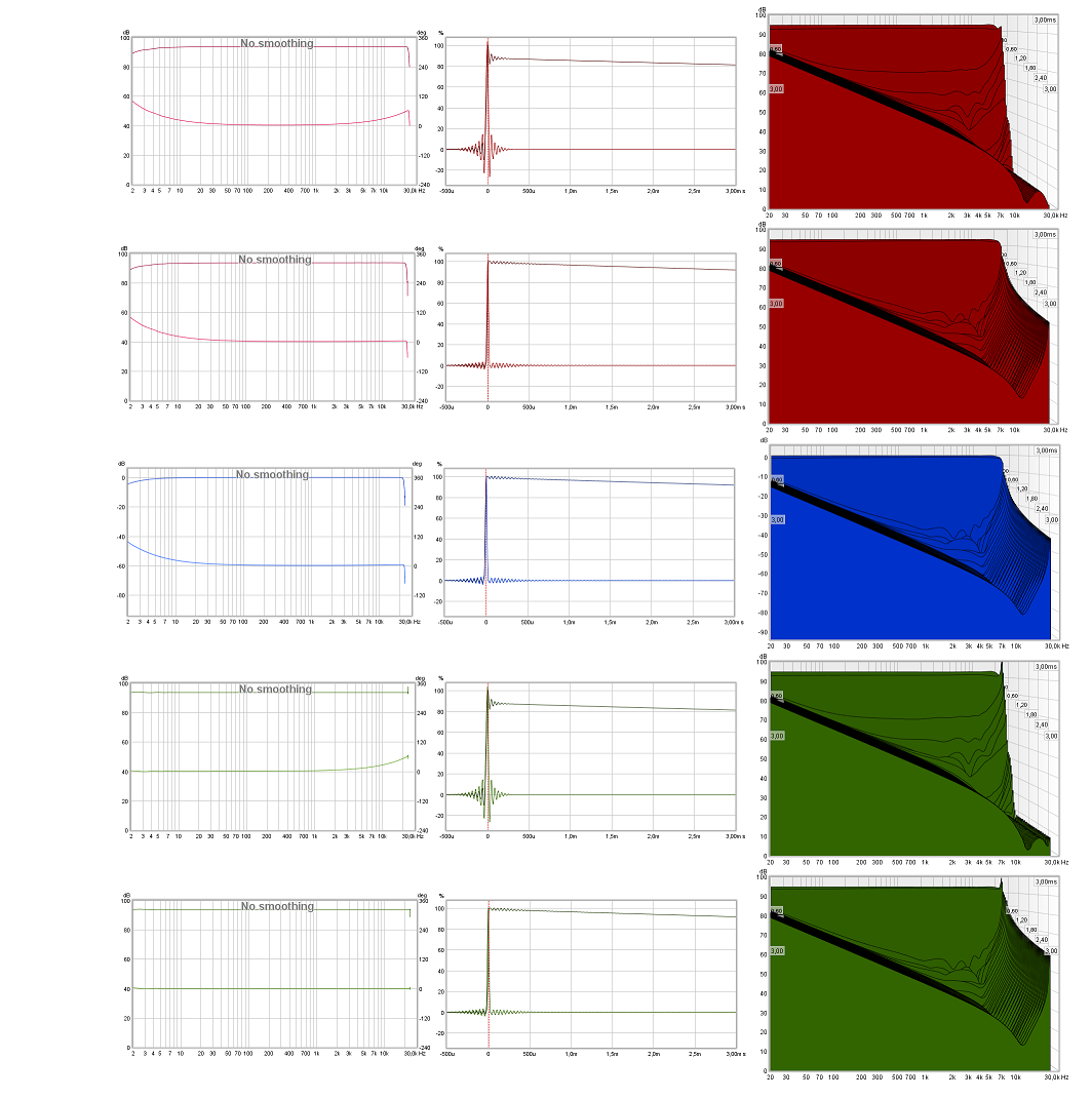

Think below is interesting loop tests run with AP192 at 48kHz (for info phase shift at low end is approximate a 2,4Hz 2. order HP).
1. is raw soundcard without any calibration.
2. is same as point 1 with IR centered commanding "Estimate IR delay".
3. is soundcard calibration and looks exactly same as point 2 except amplitude is shifted down to zero dB.
4. is with calibration file loaded.
5. is same as point 4 with IR centered commanding "Estimate IR delay".
Haha with full calibration and centered IR at HF stopband waterfall gets worst tail of them all probably because the higher order a filter gets the more it rings and with calibration everything is pure flat up to kind of brickwall cut.
Comments ? 🙂
Attachments is same (50% and full resolution)
Why look at such large window settings if you want to see the ringing?
Set rise time to 0.1 and window to ~1.5 and move a bit up and down in that window time.
Time range can be 3 ms. See it ring if you move trough time of the window 1,5 to 1,6 etc? Move down in time to 0.5 ms too, You'll notice it will stop ringing and stay there at an early point.
Now start the EQ tab, set a low pass on one of the worst looking pulses. Cut it below the ringing top end, Does the IR in the preview window below look better?

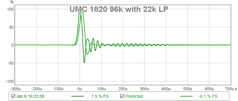

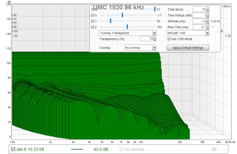

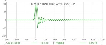

Ok, after looking at the x-32's waterfalls and impulse with a 22k Hz LP in place as shown, I decided to re-measure my three sound-card alternatives.
The x-32 is 48k max. It definitely had the messiest looking waterfall, all compared at 48k.
The UMC 404 and 1820, go to 96k.
I think 96kHz waterfalls looked much cleaner on both of these than their 48kHz rates, so jtalden's method is looking good 🙂
Waterfalls at 96k didn't change much with the addition of the 22k LP, but predicted impulse response did.
Does it make sense to add a FIR LP filter at 22kHz? (or what Hz?)

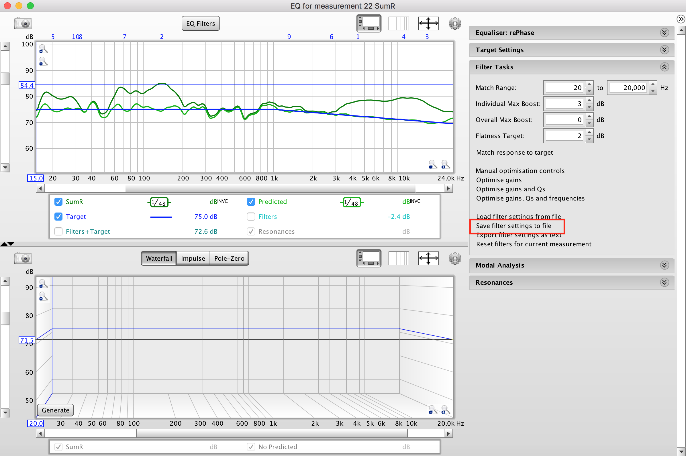

I can't seem to load an REW filter file into rePhase 2.1.0. Can someone help spot the problem?
The REW txt file contains 15 filters in the format of Post 1278. In rePhase I selected 'tools/Import REW filter settings' and then selected the .txt file. rePhase reports: 'failed to load REW Filter Settings: text export format not supported'.
I tried converting the file to xml format using MSWord but that xml file didn't load either: 'failed to load REW Filter Settings: wrong format'.
