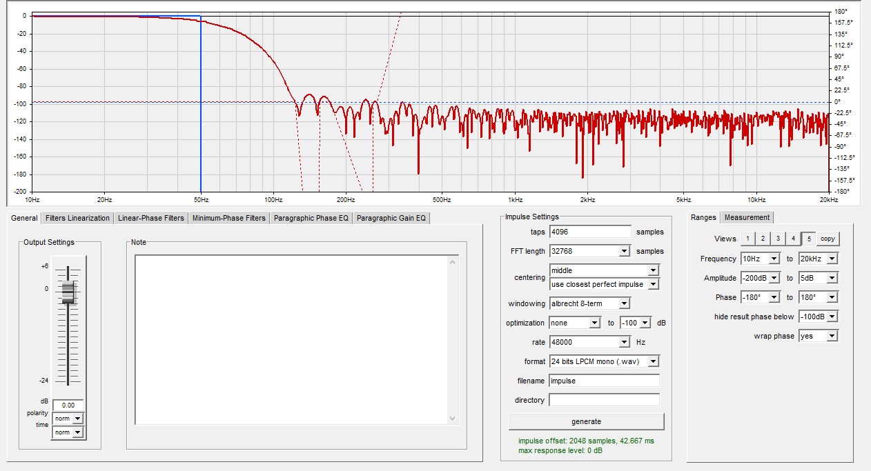

Hi,The APL1S is a very interesting box, with versatile (and probably very good quality) I/Os and 4096 taps at hand (vs 6144 for the openDRC).
My biggest grip with it is the fact that the convolution is done with 24bit fixed points FIRs. This is fine for speaker correction (the intended target of the box) but can be a problem with filtering.

I just feel float arithmetic would have been a better choice for filtering (which, again, is not the intended purpose of your box if I understand correctly).
The curves in the post above are what happens with a 1kHz filter and 0dBFS passband.
The stopband level will be higher with a lower crossover point and/or with attenuation.

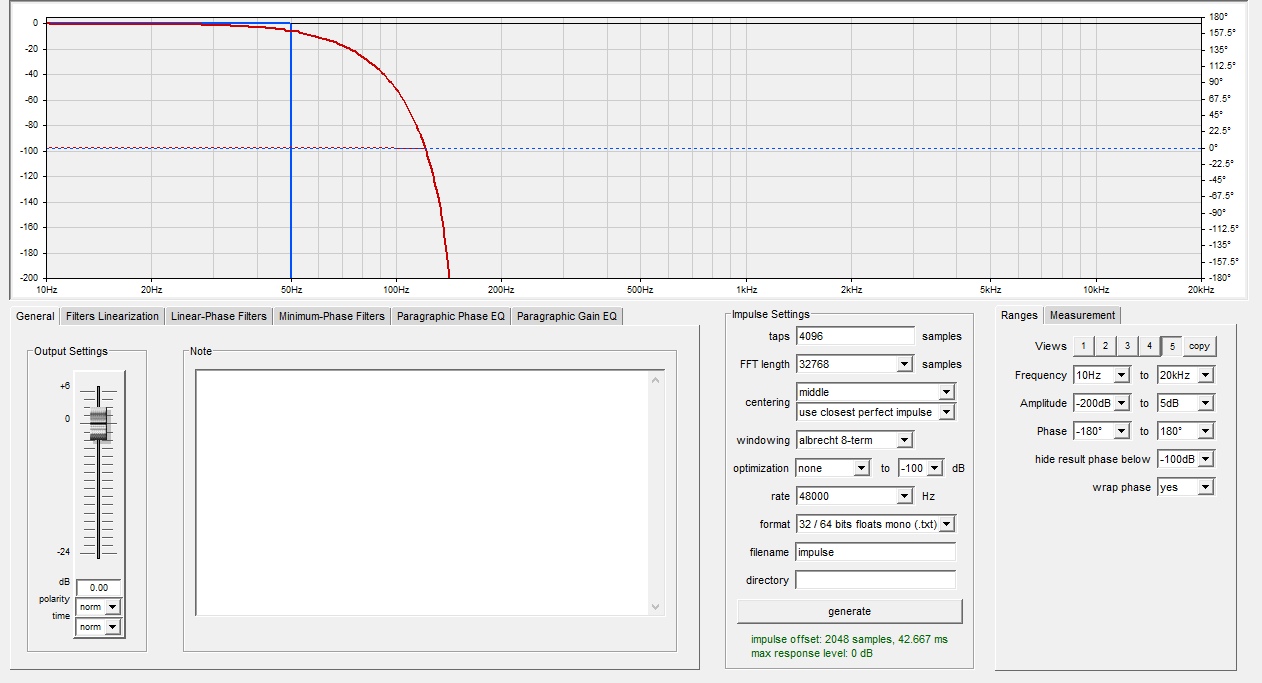

Very high stopband rejection can be obtained with a good choice of windowing algorithm, independently of the number of taps :
4096 taps @ 48kHz, Albrecht 8-term window, 32 bits float:
4096 taps @ 48kHz, Albrecht 8-term window, 24 bits fixed:

I am not sure I follow your argument here: are you implying that your unit does not have enough taps to do filtering with more than -90dB rejection, and that an analog device is a better choice?...
That 50Hz low-pass filter shown here is around 36dB/oct up to -20dB, then 48dB/oct up to -40db, and keeps increasing in slope after that. Quite usable I would say, and with linear phase
But that is beyond the point: 24bit fixed is enough for EQs, and that is what you do, apparently with great success.
32bit float is IMO a better choice when filtering is involved.
