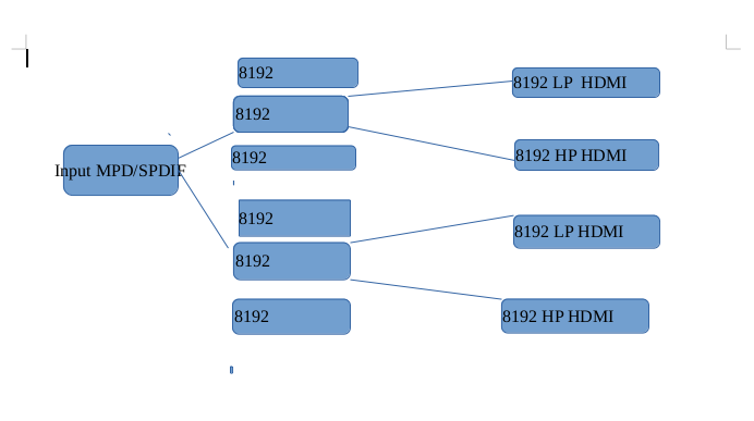

My "smallest" Convolver is a Raspberry Pi B (SingleCore) together with a Wolfson Audio Card.
I am using a modified Kernel to get Mutichannel Out via HDMI using an Onkyo AVR as Multichannel Amp. The Pi is light overclocked.
The System is running headless, Brutefir is used as Convolver.
The SingleCore Pi is capable of running 2 Channels Input and 4 Channel Output. 8192 Taps are used for an overall Frequency Correction and 8192 are used as Crossover. (44.1 / 48 kHz HP and LP Filters are the same on both Stereo Channels, that is a bit confusing on the drawing)
The overall Frequency Correction can be changed ( i can choose between 3 Filters) Filters are changed via CLI with LIRC Scripts.
Music is coming in via SPDIF (Wolfson Card) or MPD running on the same Machine. CPU load is about 90% running rock stable for Hours.

I was hoping a Raspberry Pi 3 would be powerful enough for time-domain convolution, but it looks like it will be difficult.
Keep in Mind that i am running this System on a SingleCore Raspi...
I think the RPi 3 should be powerful enough, the above described System running on a RPI 2 (QuadCore), is using 20% Load on two Cores. ( with MPD as Input)
