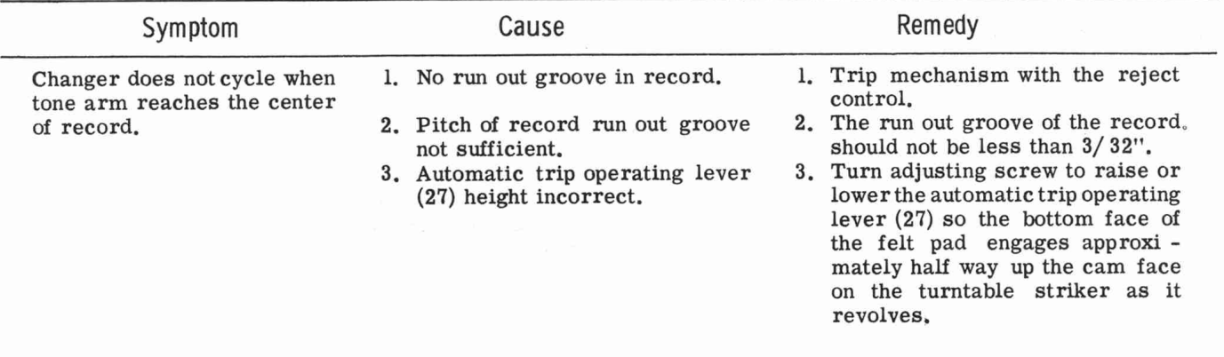

Clutching at straws I've been looking at other possible causes and found this (No. 3) in the Garrard Service Sheet which may be a red herring.:-

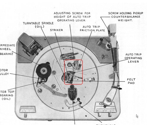

'And, I presume the top motor bearing has also been lubricated!'
A couple of drops of sewing machine oil on the motor spindle from the top underneath the idler wheel pully or do I have to disassemble the motor?
No sideways play in the motor spindle whatsoever, so that's good news?
You may expect to feel some play, it would only be a problem if you could actually see the spindle movng from side to side.
I direct the oil into the top bearing by trickling it down the narrow shaft of a screwdriver - no need to dismantle anything.
This annotated image of a Garrard Type A deck may help you locate the height adjusting screw mentioned in the remedy.

Those little 'tags' to which you referred in post #68 are called 'strikers'.
Turning the screw that raises and lowers the trip lever is all you need to do.

One of the things I did learn was the point you make about ensuring that the '... trip lever and associated sliding parts must be dry - no oil or grease to restrict movement.'
I located the height adjusting screw and moved the lever up very slightly and this has certainly improved things with the auto-changer cycle.

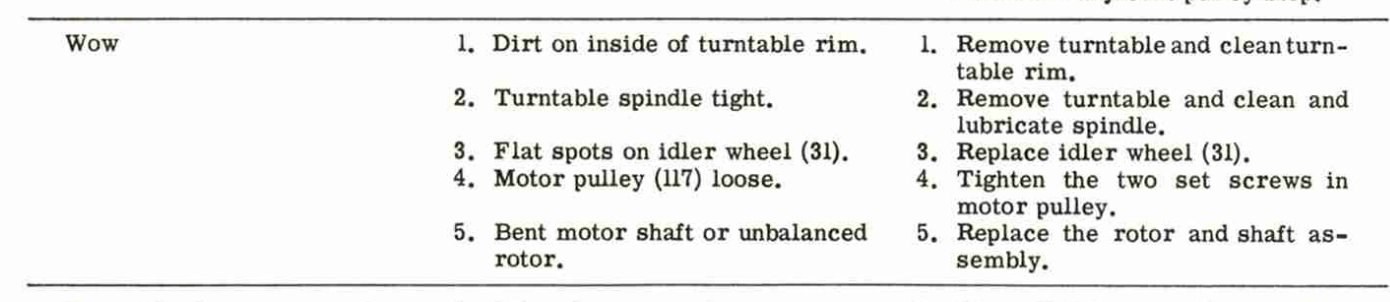

If you are using the RPM iPhone app, then your wow readings will be unweighted values that will look high.
However, I would aim for readings that are no more than one tenth of those you are reporting.

Readings are indeed from my RPM iPhone app and the wow/flutter is clearly audible, even with no amp or speakers attached!
I wonder to what extent the weight of the iPhone on one side of the platter makes things unbalanced?

1, 2 and 3 should be eliminated by inspection (I'm sure you will have lubricated the spindle with oil).
I made sure I checked 4 when I was renovating my SP25 MkIII.
Regarding 5, a bent motor spindle should be obvious to the eye and an unbalanced rotor probably means a noisy motor.
Not to the level of the things you are reporting!
