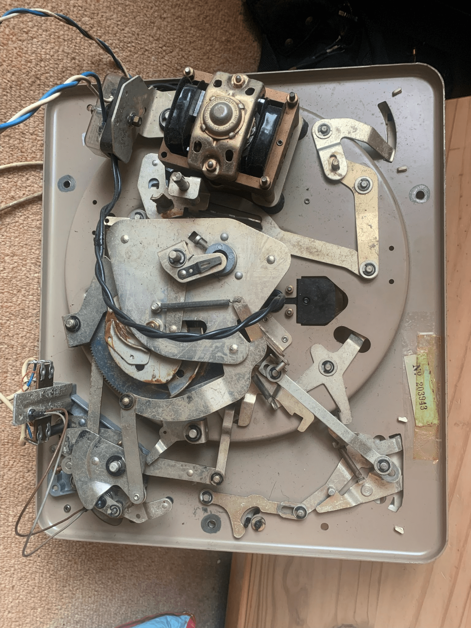

Thought I'd finished but the auto-changer is playing up again! 😡
When in Manual the motor and turntable spin correctly - speeds checked again.
When I switch to Automatic the turntable stops spinning and the tonearm doesn't lift? If I manually rotate the turntable several times it seems to re-engage with the auto-changer cycle, a record drops and the tonearm swings into position and plays the record. At the end, however, the same thing seems to happen and the turntable stops spinning, the tonearm lifts but doesn't move back. Manual intervention finishes off the auto-changer cycle, the tonearm returns to the rest position and it turns off.
Perhaps the motor is transferring insufficient torque to the platter when the extra load of the autochange mechanism is engaged.

I roughened the surface of the idler wheel with fine emery paper but that made no difference?
I understand that the motor could be 'transferring insufficient torque when the extra load of the autochange mechanism is engaged' but as the auto-changer mechanism sticks at both ends of the cycle, start and finish, then I'm at a loss to understand what is happening, or not!

As I'm really struggling could you highlight or point to the sliding arm you refer to - thanks.

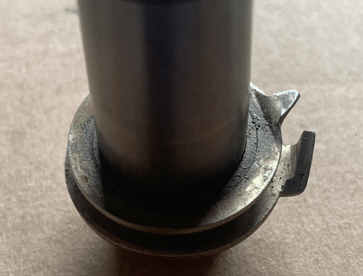

I'm further confused by the role of these two 'tags' shown here on the right hand side of the turntable (platter) unit?
What are these for as they don't appear to engage with anything?
I'm not familiar with this particular vintage mechanism and can't identify a sliding lever like the more modern one of which I speak.
However the operation is similar to more modern mechanisms in that the cam gear must engage with the turntable hub gear in order to drive the auto cycle. This should be instigated by the movement of the auto select lever or the movement of the pickup arm.

Re 'tags': Where are these located precisely? Zoom out for me.
As you know it's extremely challenging to view the operation of the auto-changer mechanism from beneath!

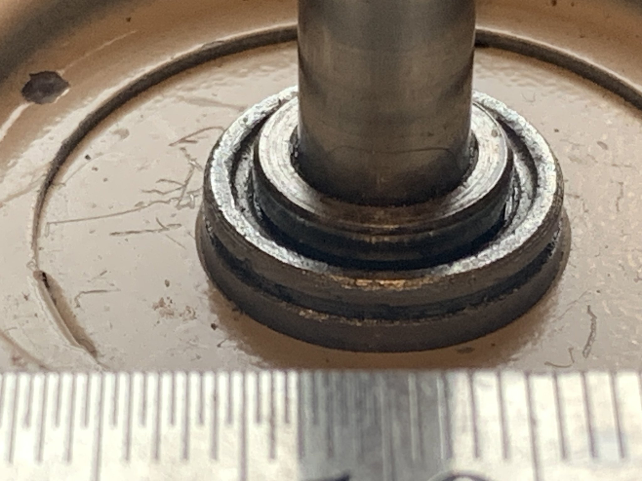

Also check that the idler wheel is correctly riding in the centre of the 33 rpm and 45 rpm sections of the motor pulley and not rubbing on the shoulders of the stepped pulley.
When you give the motor spindle a quick turn by hand it does about 2-3 revolutions before coming to a stop?
The idler wheel wasn't correctly positioned so I moved the pulley up a fraction so that it now runs exactly in the centre of the 33 rpm and 45 rpm sections of the motor pulley.
