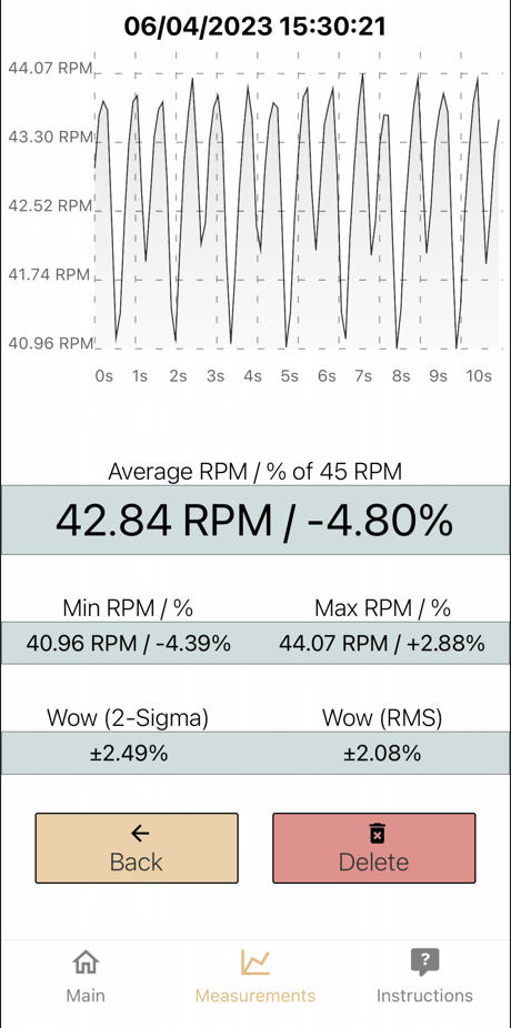

Thanks Chris - good to still have you on board. I used some 2000 grit wet and dry paper as I'm a bit cautious of making things worse. This brought about a slight improvement in the speed and wow - see below and note the regular speed variation which no doubt is coming form the idler wheel. When I spin up the motor with no idler wheel it is virtually silent but I do hear a very faint regular noise when the idler wheel is engaged.

You say, "Note the regular speed variation which no doubt is coming from the idler wheel."
Hardened idler rubber results in two issues: slippage and the transmission of motor noise to the platter
A flat on the rubber will produce a regular 'thump' as the idler wheel rotates.
However, a slight lack of concentricity of the idler rubber surface should not affect the speed as long as positive contact between motor pulley and platter is being maintained.

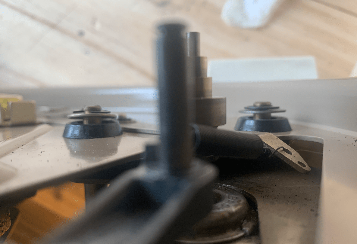

I can certainly strip down, clean and lubricate the man bearing again but how do I check the motor?
And of course checking the condition of the rubber motor mounting grommets will be subjective based on experience? Where would I find suitable replacements?

If the rubber grommets have gone hard, they are in need of replacement.
The grommets should provide a tight but resilient grip which reduces the transmission of motor vibration to the chassis while holding the motor pulley securely in position. The free vertical movement you show is likely the result of the rubber shrinking and losing its grip.
The frequency of the speed variation may provide a clue as to its source.
Ebay is one source of replacement grommets and it's just possible that you can find a set that measures up to your requirements.
Without measurements, it is impossible to say that the Dansette grommets to which you link would fit.
The Voice of Music site may be helpful in relation to measuring the size: https://thevoiceofmusic.com/catalog/part_detail.asp?PNumberBase=M2

'The frequency of the speed variation may provide a clue as to its source.'
Looking at the graph in Post #103 above the pattern repeats about every 1.3-1.4 seconds (~44 rpm) - not sure what that tells me?
