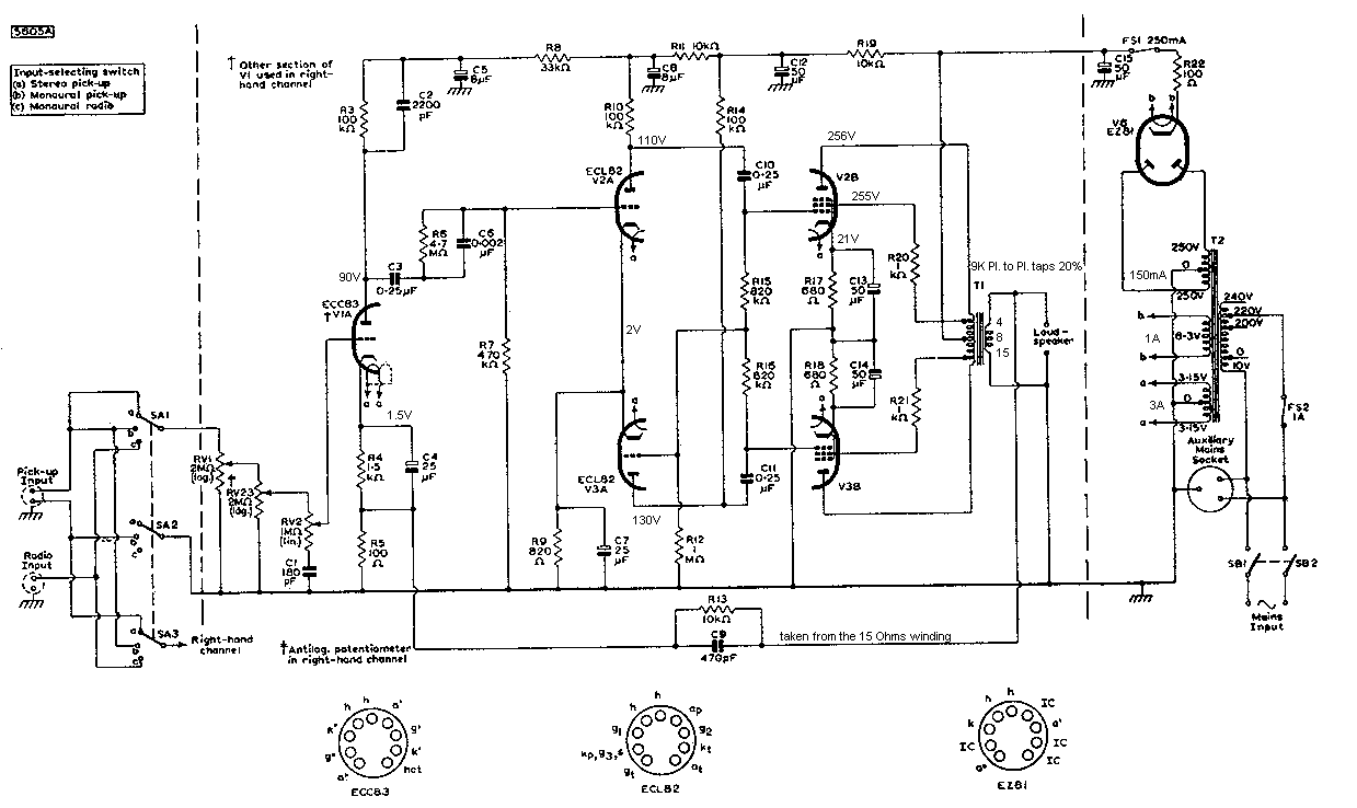

However, for expert opinion, are you able to post the schematic of the amplifier?
I've attached a typical ECL82 PP amplifier circuit to be getting on with!

The hum would indicate that the power amp section is OK and that the fault probably lies in the preamp section.
Perhaps rather obvious, but the ECC83 could be bad, so you could try a substitute.
The ECC83 section may not be receiving power so check the series dropping resistor in the bypass network leading to its anode, as well as checking/substituting the associated bypass capacitor. I know you've already replaced resistors and dodgy caps, so perhaps you need to look for a bad solder joint?
That's about the limit of my meagre knowledge, so hopefully an expert will chime in. You could try injecting a signal at the input to the phase splitter to confirm that the power amp stage is working.
P.S. And, of course, my schematic shows the typical voltages you should be finding at various points in the circuit.

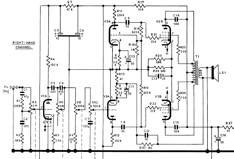

I've attached the schematic for part of the Pye G63 right hand channel and as you can see there are several components between the PU input and the volume control (R3):-
All these will be checked again but I can't get access to the stereogram until Friday of this week so no hurry.
I'm assuming that '... the series dropping resistor in the bypass network leading to its anode ...' is R4 in my schematic while the ' ... the associated bypass capacitor ... ' would be C3?
I thought about injecting a signal as you suggest but wasn't sure exactly where the 'the input to the phase splitter' was on the schematic?
We're talking R7 as the series dropping resistor. C5 and C6 should be checked in association with R7.
R4 is the anode resistor similar to the one that went open circuit in my amp.
The input to the phase splitter is the grid of V3A fed by the wiper of R10.
(To be clear: V1A is the pre-amp, V2A & V3A form the phase splitter, while V2B & V3B form the PP ouput stage.)

The Pye stereogram is at a friend's place so I'm not going to be able to test using my signal generator and 'scope.
Best I can do is to take my Velleman signal tracer/injector and DMM which are just two tools from my arsenal that I use for testing vintage valve radios.
The Velleman injects a tone that can be heard at the speaker assuming all is well and I normally start at the wiper of the volume control.
Looking again at the schematic in Post #7 above can, I use my Velleman in a similar way on the wiper of R3 and then progressing through the circuit to Pin 2 of V1A, the wipers of R6, R8 and R10 to Pin 1 of V3A - or is that too simplistic an approach?

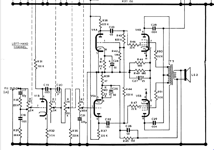

So this tends to confirm that the problem may lie in the output stages and not the pre-amp stage or the controls?
Moving on to the output stages and I carefully measured all the pin voltages for the ECL82s :-
PYE G63 – ECL82 Pin Voltages
Pin 2

Once again most readings are bit high as I am using a DMM but we have a clear issue at Pin 8 and Pin 9 of V5A!
Swapped over V4 and V5 just to test the valves but the outcome remained the same - the problem still lies with V5A with Pin 8 being the cathode and Pin 9 the anode.
First question is whether or not the high voltages above would lead to the loss of the Left-Hand channel and poor response at the slider of the volume control R30?
I had a quick check on the components associated with V5A but nothing seemed untoward - I will check again of course but not sure which ones would cause this problem. As I said in my OP 'This is my first foray into push-pull, phase splitter valve technology ...'. I think I've found the location of the fault but not sure about its cause so any help would be appreciated.
Thanks Chris for your ongoing support - the pin voltages for the output pentode section of V5 i.e. V5B seem ok so it's just the triode section i.e. V5A where we have a problem?
I'll recheck all my solder joints and measure R37, R38 and R39 again. Both C22and C25 (electrolytic) will also be checked.
Anything else I need to check?
