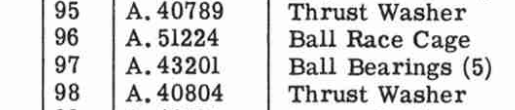

Please see pages 6-7 of the attached PDF.

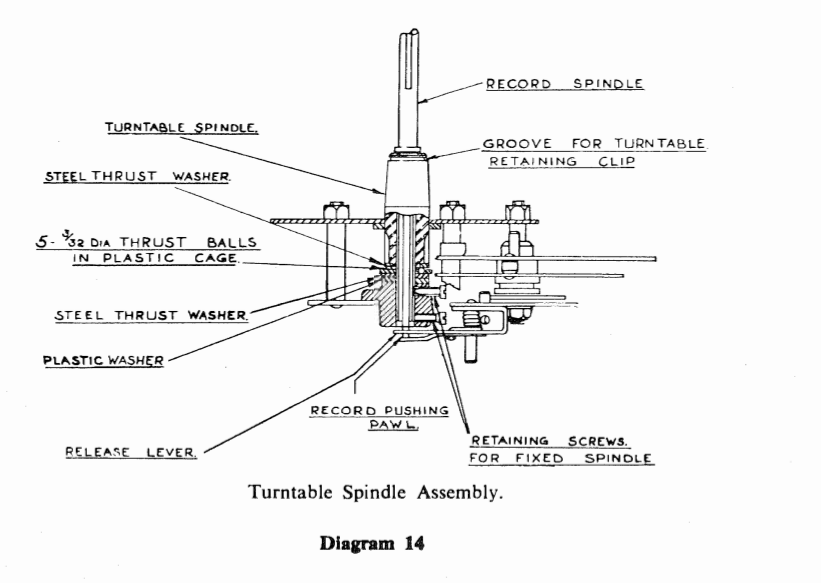

Note that only the two metal thrust washers are shown but not the plastic washer.

I hope those ballbearings in the platter bearing are not worn or differing in diameter.
Try removing the plastic washer, but I don't see that it would cause a rotational problem.

I'll try removing the plastic washer but do feel that I'm clutching at straws - this diagram from the other Service Sheet shows the plastic washer:-

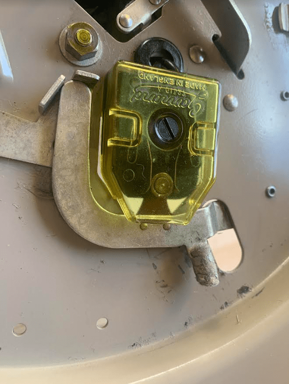

2. I have the usual loud 'pop' when the auto-changer turns off due to the contacts arcing. I intend to fit a suitable X2 capacitor to help fix this but wondered where is the best place - either across the mains tags on the on/off pot or across the switch under the platter?
Adding a resistor in series with the capacitor is even more effective.

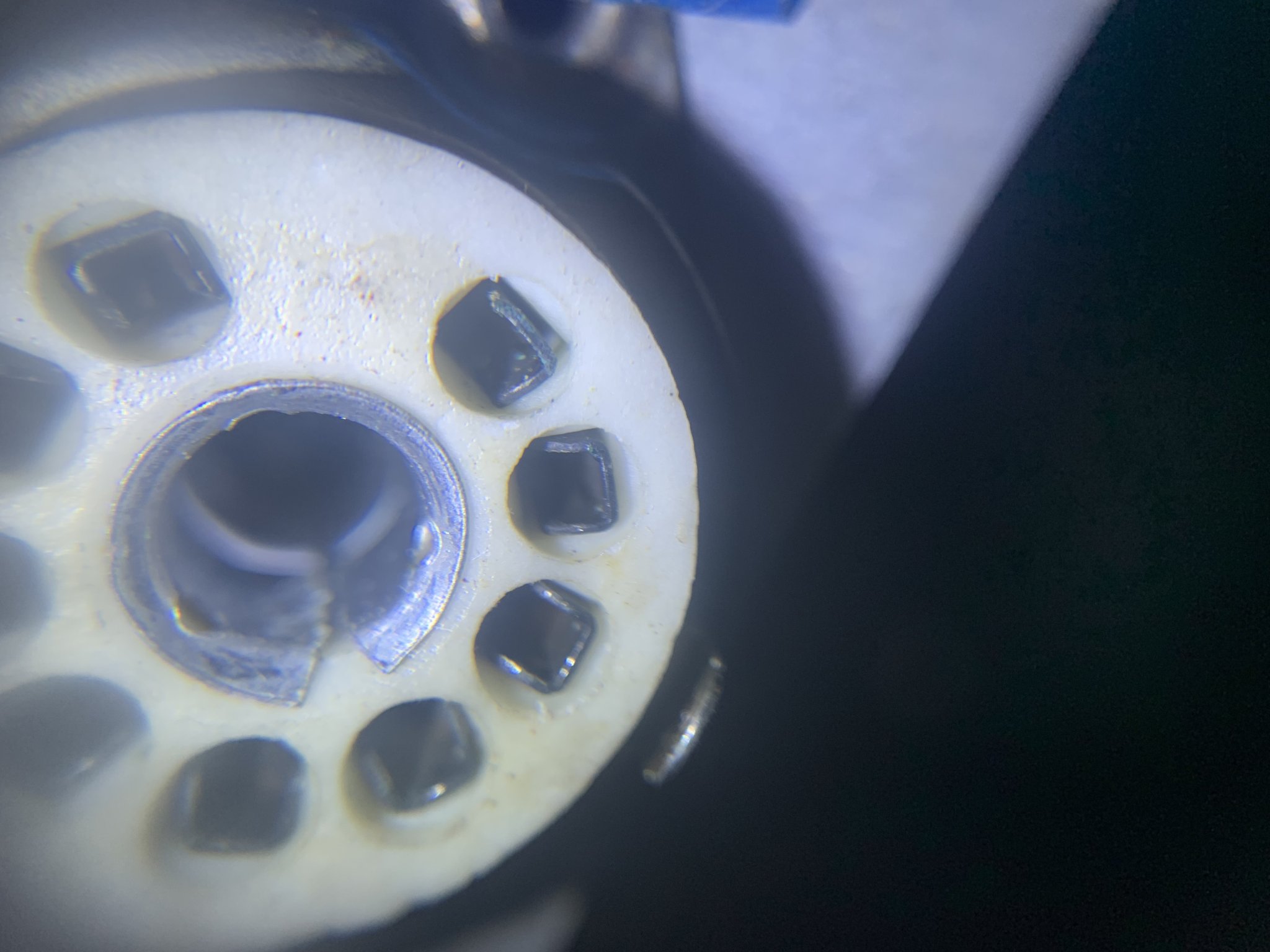

I've now got an answer to my question of whether the heater lights up. ;)
Yer gonna need a new valve base. Will this adventure never end!

I know about heaters which are wired in series or parallel but not sure about the centre tap?
Any implications for associated components if we have a fault here? Can I bodge it just to confirm that this is the problem??
Of course the B9A valve base is riveted just to make things more challenging - now where did I put my Dremel!
The RH channel schematic shows only half of the heater filament connected to the heater supply, i.e., pins 4 and 9 used.
A dotted line shows pin 5 connected to pin 4 which would put the two halves of the winding in parallel.
Either way, the ECC83 would be configured for 6.3 V operation.
(By connecting the two heater halves in series the valve can be configured for 12.6 V operation, i.e., pin 9 not used.)
There should be no implication for associated components due to the disconnected heater.
Regarding bodging, I suppose you could insert a piece of copper wire into the broken socket in an attempt to make it grip the valve pin.

I temporarily bodged a piece of copper wire into the Pin 9 valve socket and everything seemed to be working again! When I have time I’ll recheck all valve pin voltages and confirm again that the Balance issue is resolved by fitting the replacement ECC83.
Need to order up a new B9A valve base and do the job properly.

Instead of replacing the valve base which would have been quite a challenge I managed to transpose an unused valve pin socket from the rectifier. Although this amp module has 6 x 9 pin valves i.e. 54 valve pin sockets, only two of those are unused!
