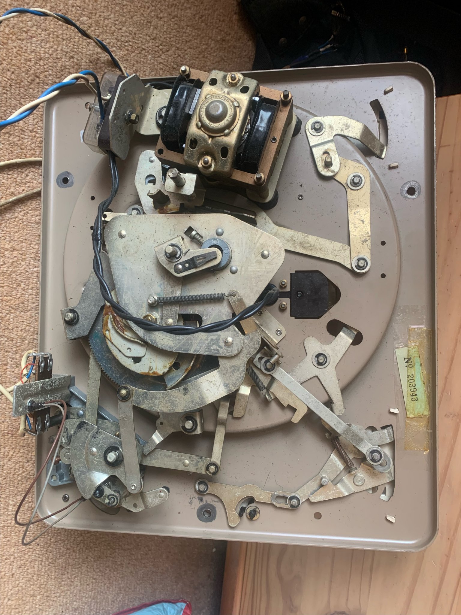

The cam gear doesn't seem to engage at all with any levers when Auto is chosen so I'm assuming that this is seized up? Not sure which levers are involved in activating the cam gear from the control lever unit?
My main problem here is in trying to reconcile what I have with what is shown on page 34 of the Service Sheet - attached to Post #40 above.
The picture below is before extensive degreasing:-
As the cam assembly (35) is below the bridge sub assembly (36) I need to somehow gain access - lots of rivets but very few bolts?

In your underside view, I can see a hex nut (partially obscured by the black wires) which may be retaining the bottom of the cam gear shaft.
Can you locate the corresponding hex nut on the topside view which may be be retaining the top of the cam gear shaft?
If these do prove to be the shaft retaining nuts, then the post by A70BBen in the following link begins to make some sense:

Undid the shaft retaining nuts and heated the shaft with my hot air gun but it won't come out - it rotates and moves up and down a few clicks but that's it!

...it (the shaft) rotates and moves up and down a few clicks but that's it!
I presume the cam gear is rotating along with the shaft.
I've found this description (edited) of what to do after removing the hex nuts:
You may find at this point that that the shaft rotates along with the cam gear! Now, with a small propane torch, from the bottom of the chassis, heat the centre of the cam gear, with the shaft inside. When you get the shaft hot enough, you will be able to push it out from the top, perhaps needing to grip it from below with pliers and pull it out. It might even drop out of its own accord under gravity. The linkages and associated parts will keep the main gear/cam in position.
More information can be found in post #9 of this link: https://www.vintage-radio.net/forum/showthread.php?t=64247
Note there is a presumption that the 210 cam gear arrangement is similar to that of the Type A described in the link(s).

Well no - the shaft rotates independently of the cam gear - good/bad??
I can wiggle it about and it feels as if the thread of the shaft may be trapped by the cam gear/levers?

If the loosened shaft is rotating fully through 360 degrees and independently of the cam gear, I would interpret that as "good".
However, I'm not sure I understand your final sentence which implies that the shaft is trapped.
It's hard to diagnose from a distance. One has really got to study the workings of the mechanism first hand to see what it is trying to do and what it is not actually achieving. The way the cam gear assembly is intended to operate is described in the Garrard 210 Manual, a pdf of which I include here for anyone who would care to join in. https://www.kevinchant.com/uploads/7/1/0/8/7108231/garrard_210.pdf

The shaft rotates a full 360 degrees but only moves up and down by about 1-2 mm - that's what I meant by 'trapped'.
This afternoon I'm going to attack the cam gear shaft once again with my hot air de-soldering station at 400 degrees - it has a small nozzle that should be able to get between the levers. Failing that I'm going to try Brake and Clutch Cleaner which I've used previously in other projects to remove oil, grease and dust!

Provided I am interpreting the information correctly, if the shaft is rotating independently of the cam gear then the cam is not seized to the shaft. In that case, wouldn't the problem lie elsewhere? As I said, difficult to diagnose at a distance.
Through extensive and repeated application of hot air and grease remover we have finally managed to free up the cam gear and have partial success with the auto-changer mechanism - hurrah! Everything has been reassembled with new ball bearings and a light application of moly grease around the bearing thrust washers, plastic washer and ball cage.
