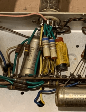

Here's a picture of the underside of V5 before I started work - I'm hopeful that I may have transposed a connection or two here:-

Looking at your photograph prompts me to ask the obvious question - did the amplifier work on both channels before you started renewing components?

P.S. It's certainly busy around that valve base - good to have the working channel for comparison!

I suspect you may have made a positional error when you earlier replaced some "dodgy" components.
You're in the fortunate position of having a working right channel, so do some resistance comparisons along the lines of OldHector's sage advice.

As we suspected Galu I had indeed made a small positional error and transposed two components on the underside of V5A - not bad considering 99% of the other components were connected up correctly and I was doing it blind so to speak!
Good news is that I now have two working channels and the voltages on all four ECL82s are roughly matching! There is probably some more fine tuning I can do to match up both channels but for now I was happy to play 'Apache' by The Shadows which brightened up my day! What this does demonstrate, however, is the importance of taking detailed before and after pictures!

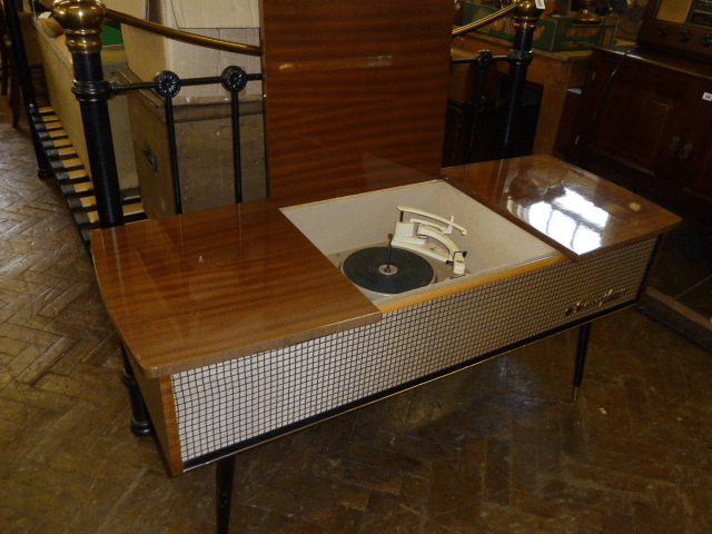

The Garrard 210 is a classic autochanger, as seen in this stock image of another Pye G63.

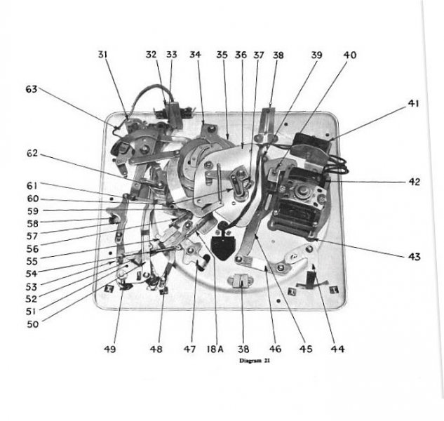

Now that we have the amp module up and working to a satisfactory level it's now time to turn our attention to the Garrard Model 210 auto-changer.
All the moving parts on both sides of the Garrard were thoroughly degreased as there were known issues with the auto-changer mechanism failing to engage at start-up! Speed selector mechanism including the idler wheel, step lever and motor bearings were also treated and these know work ok.
The centre spindle was removed to enable access to the ball race to replace the missing ball bearing and the metal thrust washers, plastic washer and ball cage/bearings were lubricated with thin machine oil before reassembly as per the Service Sheet.
I do, however, still have the auto-changer start up problems even after re-lubricating all moving levers (grease) and bearings (oil)? The Garrard plays fine on manual but simply fails to engage on Auto? There is no sign of any remaining hardened grease so I'm a bit unsure as to where the problem lies?
Anyone done a Garrard Model 210 disassembly or have any experience of the problems I am describing?

Failure of an autochanger mechanism to engage is usually traceable to a siezed up cam gear.
The mechanism of the 210 is more complex than that of the later Garrard autochangers - if it were an AT60 I would know how to free the cam!
Freeing the cam gear may not be straightforward on this model.
What does the 210 service manual have to say about servicing the cam gear?
