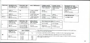

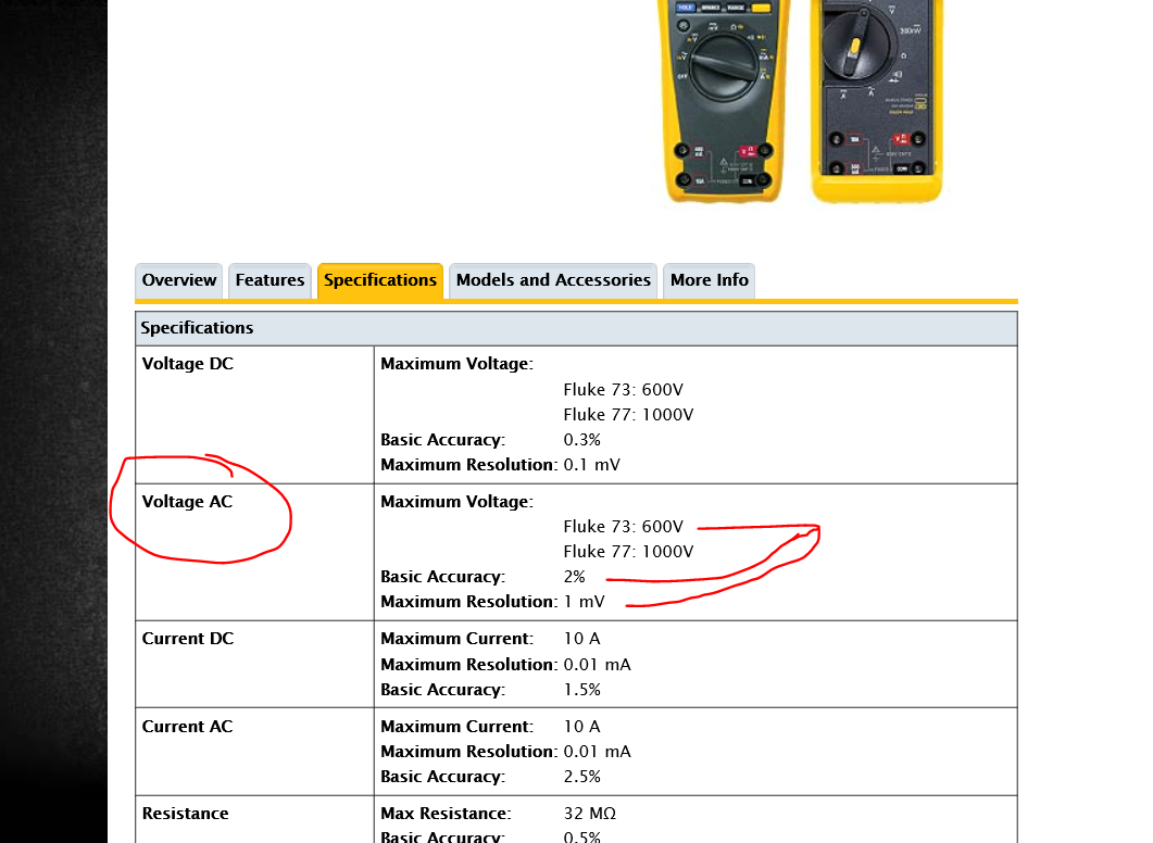

I do have a Fluke 73; I thought you were inquiring about a meter that would buss on low voltages, the new meter will buss on and above 110+v, I realise now this is not what you meant, my Fluke should do if the reading is above mV it should then follow-on and read volts. My Philips CD 751 player is an old one before mp3’s came out.

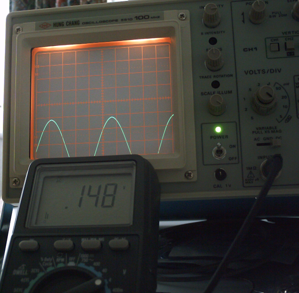

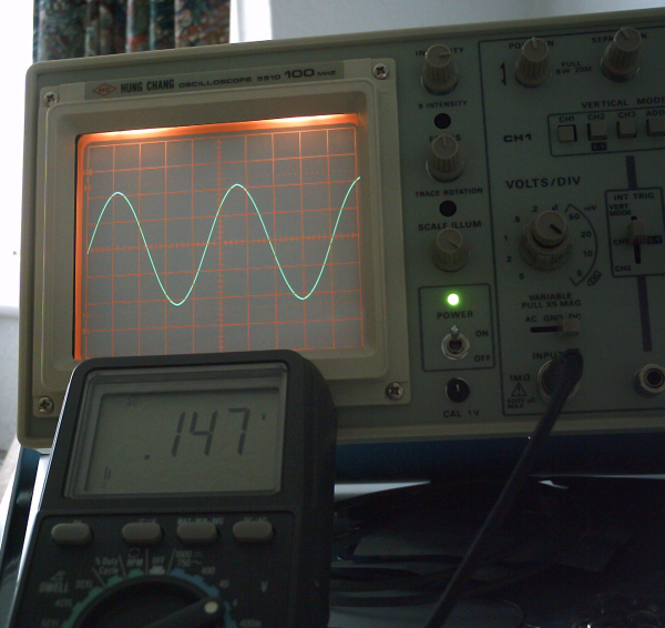

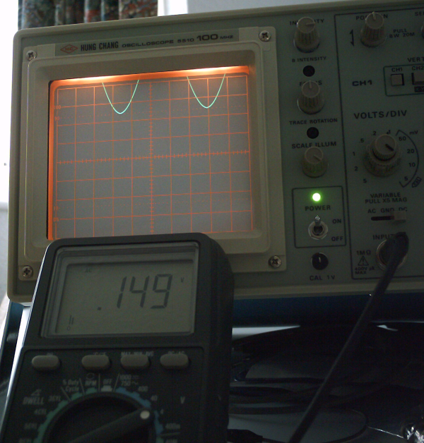

I thought I better just 'prove' that an ordinary DVM would work for this 🙂
Here is 440Hz tone displayed on the scope and on the meter together with a DC offset of positive an negative voltage (last two shots). Surprisingly the meter (this one at least) was not fazed by the DC which means that in this case no series cap would be needed.
The values of DVM measured signal and the scope agree. 149 millivolts RMS reading on the meter is corresponding the 420 millivolts peak to peak displayed on the scope.

Thank you for posting the images showing the usefulness of the DVM and that there would be no need to use an add-on capacitor; I am assuming that this test would need the pre-amp, cd player rigging to this speaker and with it all connected and playing the cd, start to take voltage readings and then we have to do individual tests?

I looked up the Fluke the other day, that's where I got those figures from on its sensitivity.

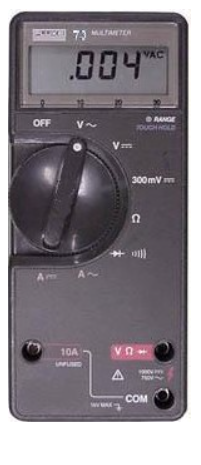

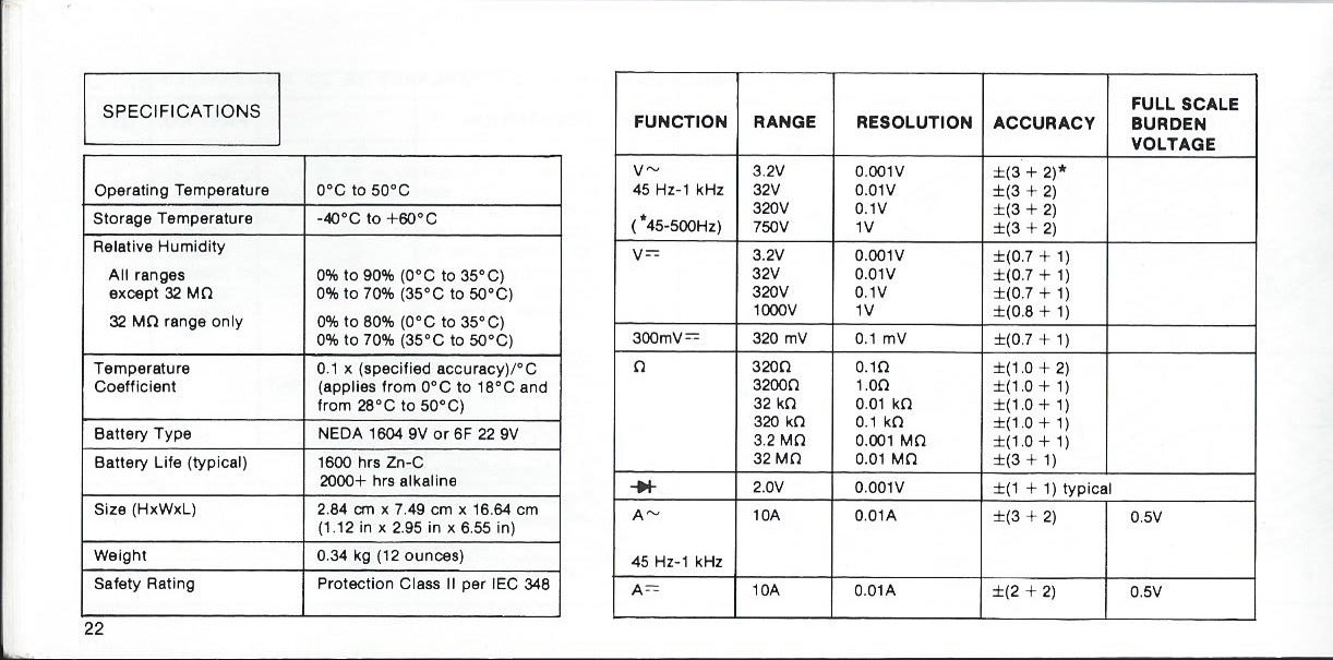

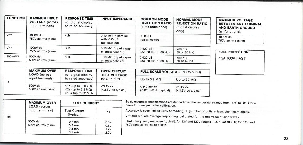

Attached Fluke 73 specifications; yes mine looks like your picture.

Yes, AC volts. The Fluke is auto ranging and should select the correct range automatically when it sees the voltage.

The 73 can however be forced into a user selected voltage range. Years ago I fitted mine with the knob of the 75 which has a selector-switch built in... works like a dream. These knobs are available as a replacement part from Fluke.The Fluke is auto ranging and should select the correct range automatically when it sees the voltage. 🙂
A long time since I've used a Fluke. You mean a range hold facility to stop it jumping between ranges ?
yes, but you can use that facility also to select a range by just pushing the button.A long time since I've used a Fluke. You mean a range hold facility to stop it jumping between ranges ?
Keep the button pressed for a second to return to auto-mode.
