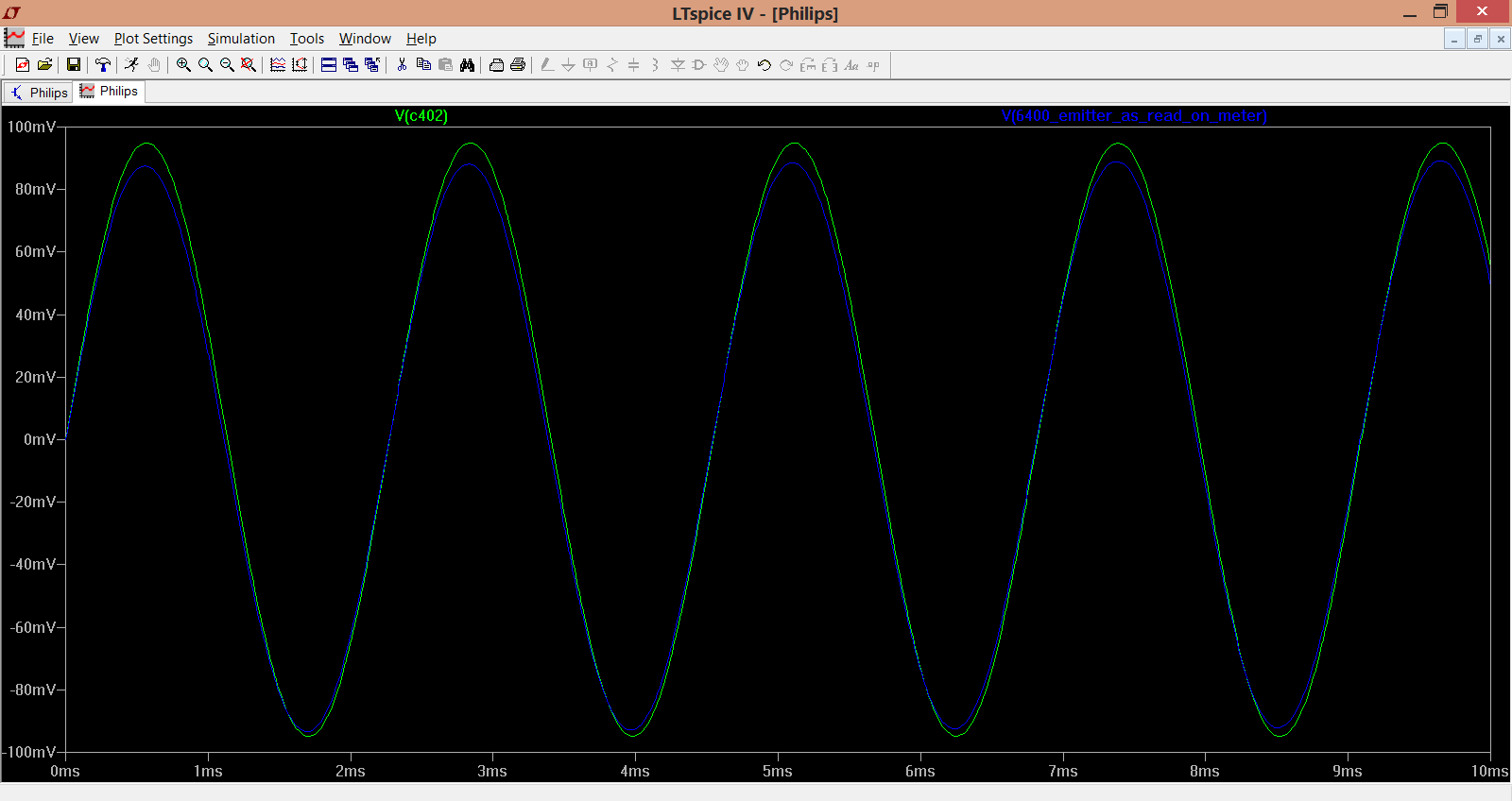

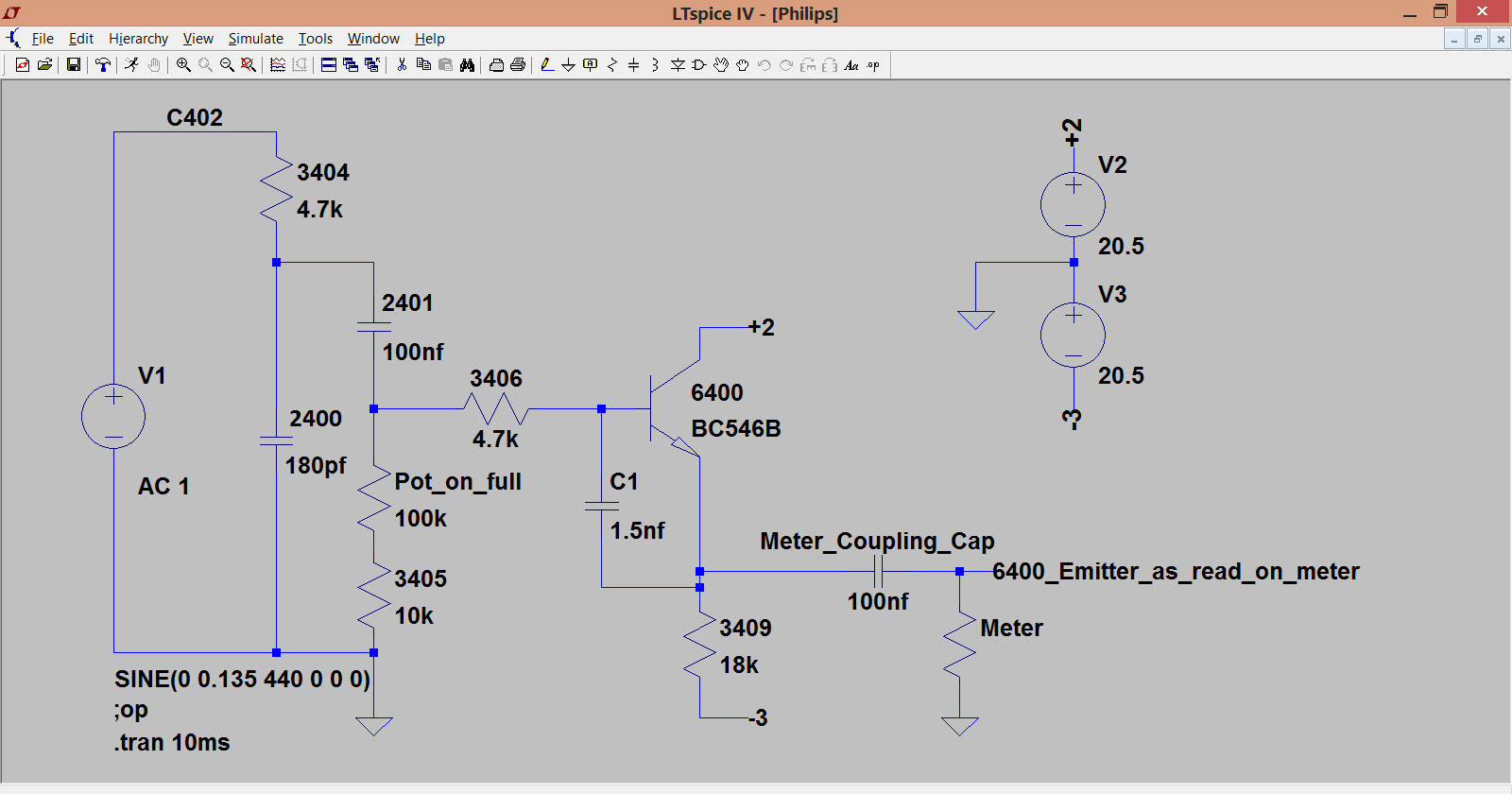

This is just for information so you can see what we should be registering on the meter. The diagram (its actually a working simulation) shows the input stage of the Philips and I've marked the parts up with the same numbers for easy reference.
The pot is on full which means 3406 connects directly to cap 2401.
At the right is a cap connecting to 'your meter'. That's just to remove the DC from the simulation so that the traces line up and can be compared... your meter should be doing this already.
You can see the input voltage (Green trace C402) and the voltage on the transistor (Blue trace marked 6400_Emitter_as_read_on_meter) should be virtually identical signal wise and yours are not.
This limits our search at this stage to the pot (remember I said it should really be removed to preclude the possibility of some weird internal short), and to capacitor 2400 (it could be leaky and pulling the signal down) or something odd around the transistor.
Easiest ways to find out:
Isolate cap 2400. If its the cause the level will come up on the transistors.
If that is no good then if you isolate 3406 then you should read the full signal voltage on pin 2 of the pot (its middle leg). If you do then the problem is around the first transistor. If you don't then the problem is most likely the pot and it needs to be removed to prove it.
(why 3401 and 3403 are not in the simulation... because they can only interact with the preamp side of things and we know by measurement the signal is present on C402)
