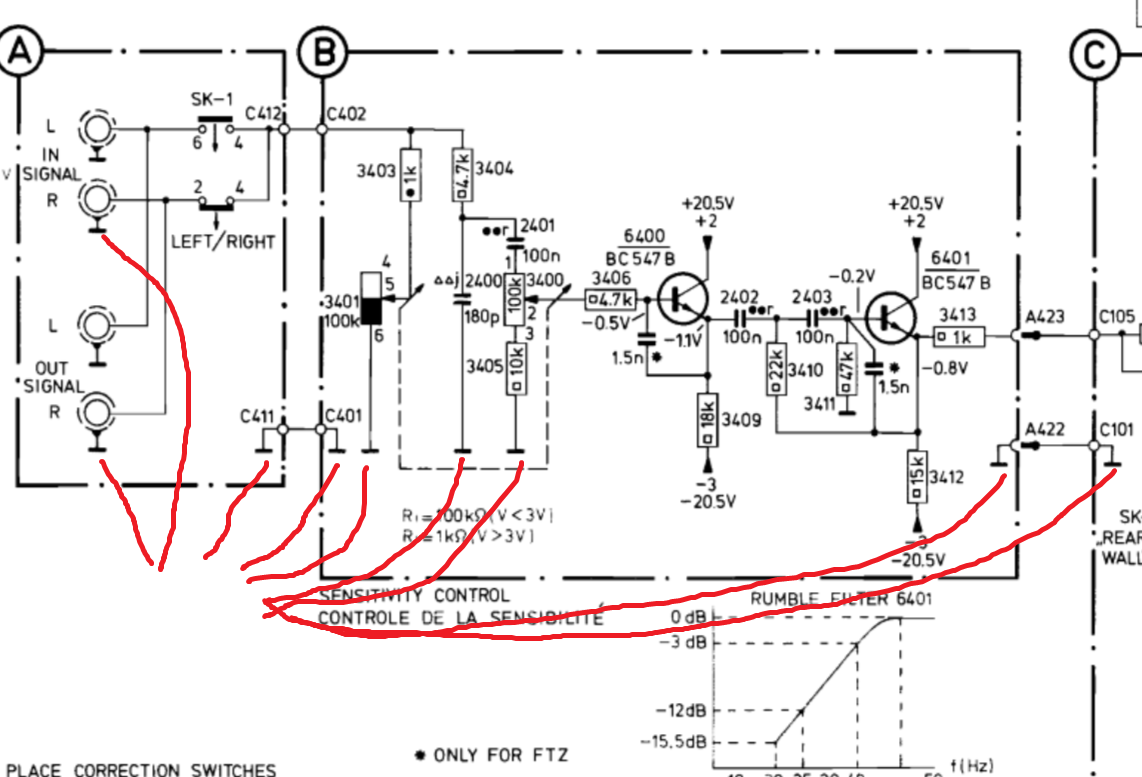

440 Hz test tone Sensitive control to full on pre-amp, 6404 collector .009 vac,
The 440 Hz test tone Sensitive control to full on pre-amp, 6404 emitter .002 vac, is this way too low/bad?

Quote: my submitted readings below they don't match the collector of 6404!
Retest 440 Hz test tone Sensitive control to full on pre-amp, C402 .036 vac, 6400 emitter .032 vac, 6401 emitter .032 vac.

So lets check the stage around 6404. What is going into that stage which is either end of cap 2409 ?

440 Hz test tone Sensitive control to full on pre-amp, 2409 either side; to A42/5 = .010 vac, to 3418 = .010 vac. how does this add up?
That is in the right sort of region for that stage. I can prove that with a simulation of the circuit.

New test 440 Hz test tone sensitive control to full on pre-amp, C402 1.029vac (approx.), then connect power to speaker unit and turn on C402 voltage rapidly decreases to .029vac (approx.) isn’t this the problem 😎
Just explain slowly what you are seeing 🙂 and yes, if it is dropping to just 29 millivolts we appear to have a problem.

When you measure 1.029 vac on C402 what single step do you take that then causes that to fall to 0.029 vac ?
You say 'then connect power to speaker unit and turn on C402 voltage rapidly decreases to .029vac' .
If that is the only action you are taking i.e. switching the speaker on, then something is very wrong around that area.
1. The volume on the pre-amp is set at normal.
2. The voltage rapidly decreases when connecting the power to speaker unit and turn on; as simple as that.
That is very very odd in that case, and I'll be honest, that doesn't really make sense however we must work with your measured result and observations and pursue it.
1/ Just confirm that when the meter is showing 1.029 vac that if you then 'pause' or 'stop' the CD player that the meter then shows zero. (It has to do because you are removing the signal). Use the same measurement locations as you did before... keep everything the same.
Assuming the above is OK then I can't see any logical way that simply powering up the speaker can drop the signal at the input by the amount it is doing. There are a couple of weird scenarios that could do something like that so lets check those out.
2/ Without disturbing anything put your meter on 'ohms' and check that there is direct continuity from the outer part of the input sockets to resistor 3405 and cap 2400. That is just to make certain the ground continuity is good. All the ground points on board B should be in direct contact with the input grounds as shown here. So all the grounds should be continuous C411, C401, A422 and C101 they all should read directly one to another and all should read directly to the input sockets.
If all that is OK then its getting really bizarre. We would then simply remove resistor 3406 to remove the possibility of anything happening on the input circuitry reflecting back and doing something strange. If something was reflecting back then the 1.029 vac should re-appear.
These checks have got to show a discrepancy somewhere. It can't pass these steps... it has to fall down at one of these.

What about this one; 2400 is an 180p capacitor (does p stand for plate?); Resistance test, once leads were connected a reading started to be displayed then went on to display 0.L (for none Fluke readers this means nothing being detected). Capacitance test; 00.35nf.
I made sure no volts were present before taking the latter test, is it a none polarized component?

So the 1.029 vac dropped to zero when you stopped the CD
The continuity of grounds and signal feed were confirmed good
You removed resistor 3406. Did the signal now re-appear back again at 1.029 vac ? or did it still fall to nearly nothing when you powered it up ?
Michael, you say the other checks were good and yet it just has to fall down at some point during those steps.
[/B]
This is what you said about the Setup 🙂
