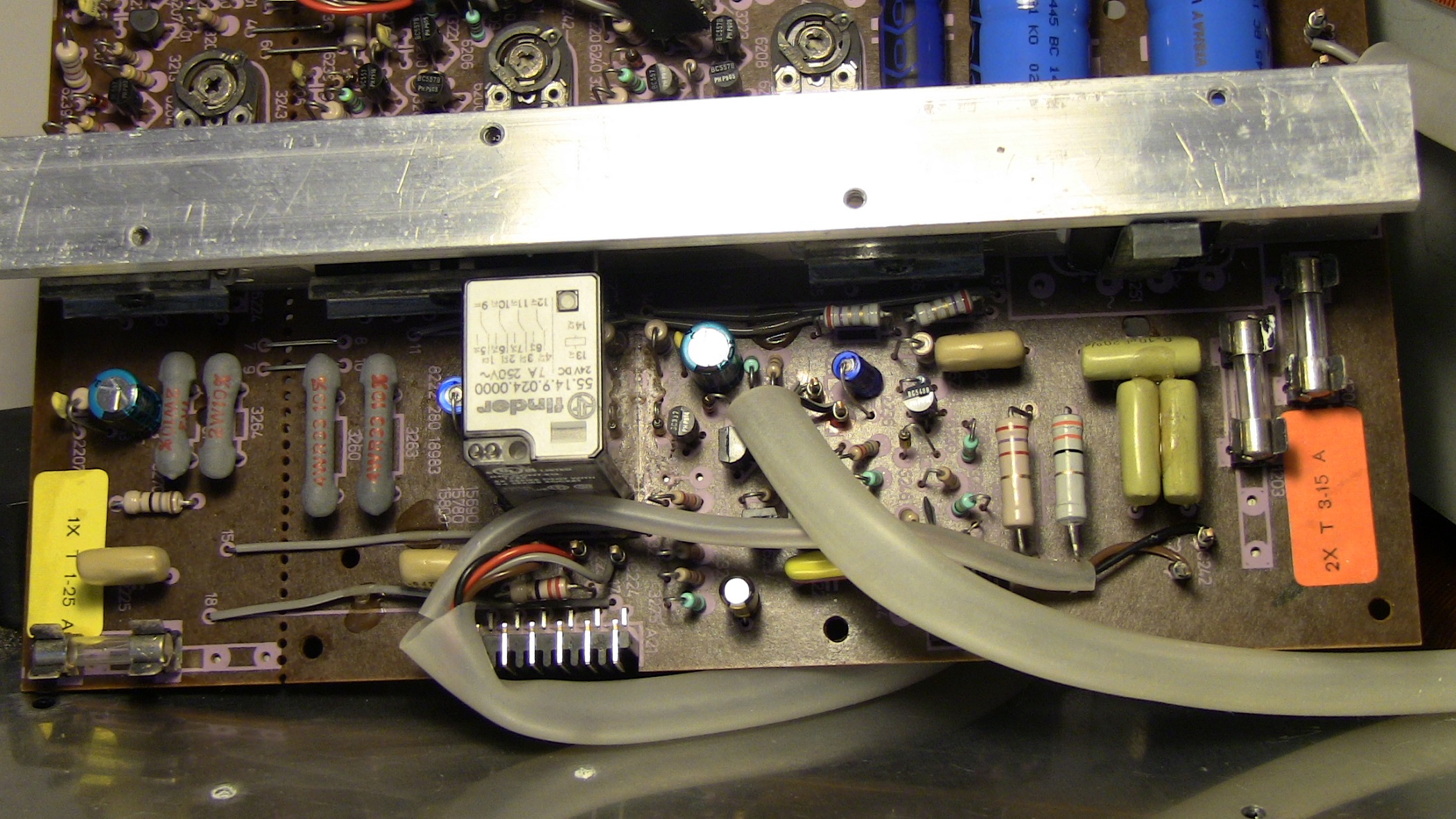

Yes you were right the results from connecting to c402 are just the same.
I have expanded on the sensitive control to help; it is set on full speaker-amp, the pre-amp balance control is full over to this speaker, this is to prevent my eardrums from bursting from the other speaker, then turn up the volume to full on the pre-amp, the sound is still the same very much lower than the pre-amp side of the control.
I agree with only your last Para about the sensitive control.
I must persist with telling you of my experience of the sensitive control, which differs from what you say, I am only doing this to help, give more understanding as the user.
When the speaker was working correctly; this is what I experienced with the sensitive control, whilst setting these speakers up from new, this is the time to find out what does what from the controls.
With music playing (not loud), turning from pre-amp to speaker-amp the sound level was unnoticeably different in volume, I remember this, and as this speaker is positioned further away from the other and difficult to gain access to alter this control, I always had this one set full on speaker-amp leaving the other speaker the one to set the balance correctly (which would be fine-tuned by turning down) when listening from my seated position (the volume setting on the pre-amp would be approx. mid-way) once this was set, you just forget about that control because it is set.
I've read what you have said several times to try and understand how you use this...
This bit puzzles me,
Are you saying that on this speaker that the sensitivity control never had much effect ? but on the other speaker it did ?
Also (and this is very very important)... when we injected the signal direct into C402 as now or particularly when it is was injected direct into 2402 and then 2401 in the previous steps... if you then turned the volume on the main preamp up toward full, was it as loud as it should be ?
In other words could you drive the speaker to full volume levels and beyond?
That is a crucial point to understanding this.

With the sensitive control on speaker-amp no.
I had hoped my previous post was simple to understand; it is very difficult trying to get the message across.
I need to understand that part of the drawing on the audio input going through to the main amplifier, how it works, but not today, I need a rest from this, it is very frustrating for me, maybe you too?
The problem with this speaker is there is no amplification produced when the sensitive control is turned to full on speaker-amp; if we can sort this out then it will be working.
With the sensitive control on pre-amp the speaker works fine in that mode.
I'll explain how it works later... I'll try and make it easy to understand 🙂
Off the wall thought 😱 because you say the speaker works fine in 'pre amp' mode. That all sounds fine to me (and I know from looking at the circuit it is fine).
Don't shout 😉 Could the other speaker be the faulty one ? and not behaving correctly ??? Could that speaker be the one that is to loud in comparison to this one ??
Something easy to try without dismantling or altering anything.. and I don't think we've done this...
With both speakers OFF just try measuring the resistance between C401 (ground) and C402 and compare the result between speakers. You can do that from the preamp leads if you want because they go to the same point. Just compare the two readings with the pot at each setting. They should be the same of course between speakers.
When its all explained you'll see how it works and why I think this one is behaving correctly.
Thank you for your willingness to explain to me about understand that part of the drawing on the audio input going through to the main amplifier, how it works, it could be better for me to ask the questions to gain this understanding, I need to think how’s the best way to achieve this.
The problem with this speaker is there is very little amplification when the sensitive control is on speaker-amp setting; we need to find this fault.
Please note; that the sensitive control has been left set on full speaker-amp setting and it has worked well for 30 years, and then it lost almost all amplification, meaning you had to put your ear to the speaker to hear sound.
