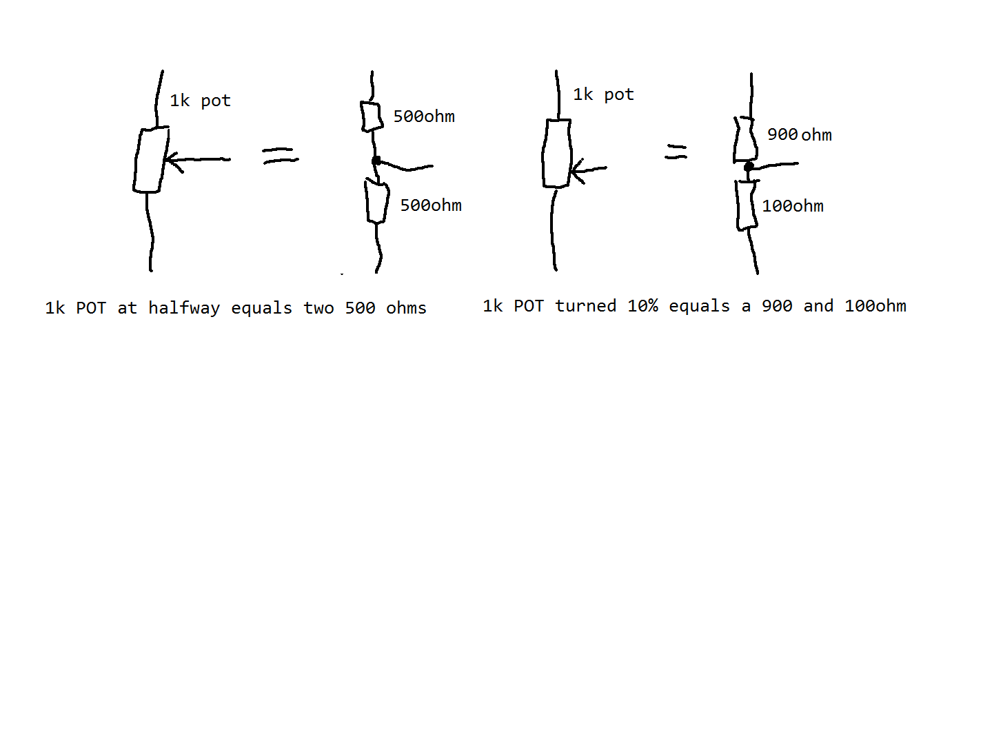

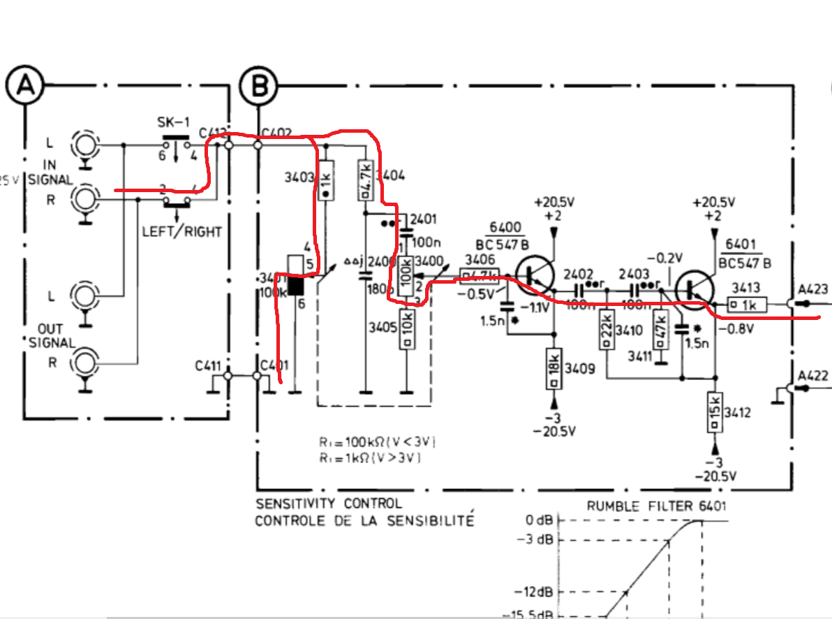

To explain this you first of all need to understand the basics of ohms law and how variable controls such as the pot work.
The pot (any pot, or any small preset trimmer pot is the same) is simply a resistive track of carbon with two fixed contacts at each end together with a third moving contact that can run the length of the track.
Example... imagine a pencil lead in front of you. Pencil leads are poor conductors having the property of resistance. Lets say you measured the resistance of it from end to end on your meter and found it read 1000 ohms. So far so good. We can now use ohms law to calculate all kinds of things knowing just that.
If you connected a 10 volt battery across the pencil lead then a current of I=V/R or 10/1000 would flow. Thats a current of 0.01 amps or 10 milliamps if you prefer.
If you now moved one of the meter leads from the end of the pencil lead and slid it up and down the pencil lead then you would see the voltage change. This is what the middle wiper leg of the pot does. It is just a moving contact along the resistive track. If you placed it half way along then you would measure 5 volts, move it 80 % of the way along and you read 8 volts and so on. In the half way position it is the equivalent of two 500 ohms in series with the wiper being the junction of the two resistors. Each resistor drops 5 volts, and the total drop of the two together is 10 volts, our applied voltage. If you moved the pot 10 % of the way around then the wiper is 10% of the way along the track. So the equivalent for that would be two resistors, one of 900 ohms and one of 100 ohms. See diagram attached.
So in summary... it is how far round the pot is turned that determines what percentage of the applied voltage appears on the wiper. Its infinitely variable from zero to 100% of the applied voltage.

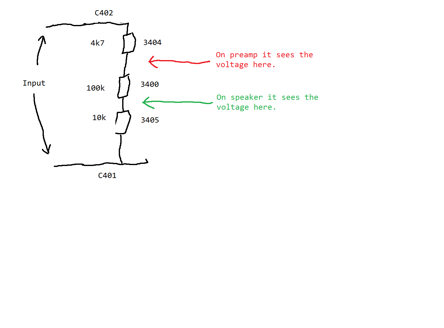

So lets try and explain the input stage of the speaker. The equivalent circuit is shown below and consists of 3404, 3400 and 3405 effectively appearing in series. The cap 2401 appears as a short circuit to the wanted signal. The tiny 180 pf cap is to small to affect the audio frequencies... its just to filter radio interference and the like. So both caps can be ignored. We could calculate their equivalent resistances an inculde them in the calculation but there is no point, one appears as a short circuit and one appears as open circuit.
The three resistors in series add up to 114700 ohms. I know yours measure a bit different, that doesn't matter as you will see.
We can look for real at what happens using two examples, one with the pot on preamp and one on speaker. The other section of the pot 3401 I will explain in a moment... it doesn't alter anything that happens here.
Pot on 'preamp'setting. This has the wiper turned up full so that it contacts 3404 (the cap appears as a short for audio remember). So I can put imaginary but realistic numbers in for signal level. We'll say the preamp is putting out 1 volt. The current is I=V/R which is 1/114700 which is 8.7 micro amps. Now we can work out the voltage at each point in that chain. Volts is equal to current times resistance and so the 10k sees 87 millivolts across it. The 100k pot sees 870 millivolts and the 4k7 sees 41 millivolts. Add those up as a check and we get back to our applied 1 volt.
So I know by looking at the circuit that with the pot on full you will get 957 millivolts (the 87 + 870 across the 10k and pot) for every volt applied.
With the pot on minimum (speaker setting) it will see just the 87 millivolts that is across the 10k.
These are the signal levels that are applied to the circuit and so with the pot on 'speaker' it cuts the applied level down from nearly the full 1 volt right down to just 87 millivolts.
The whole point of the control is to allow you to apply a signal that has already been amplified, a signal that could be in the 10 to 30 volt range.
Applying 10 volts with the pot on 'speaker' would work a follows. Current is 10/114700 which is 0.087 milliamps. Voltage across the 10k lower resistor would be 870 millivolts. Thats in the correct sort of range for the circuitry. First example had 1 volt from the preamp, second example had 10 volts from an external power amplifier applied.
So its correct that the pot should only work with the preamp when its in the preamp position Honest. When its in the speaker position it will attenuate the signal drastically.
Ok, so what about the other section of the pot. Well that doesn't alter anything explained above. All the second section of the pot can do is add a load to the preamplifier which can alter the applied voltage yes, but it doesn't alter the way the main section of the control works.
So how does it alter the applied voltage...
Well it can only do so by interaction with the unknown value of the output resistance of the preamp. So I can see you thinking 'well is there something going on there then ?' ad the answer has to be no, simply because you have proved by swapping feeds around that the preamp ouput on that channel is good.

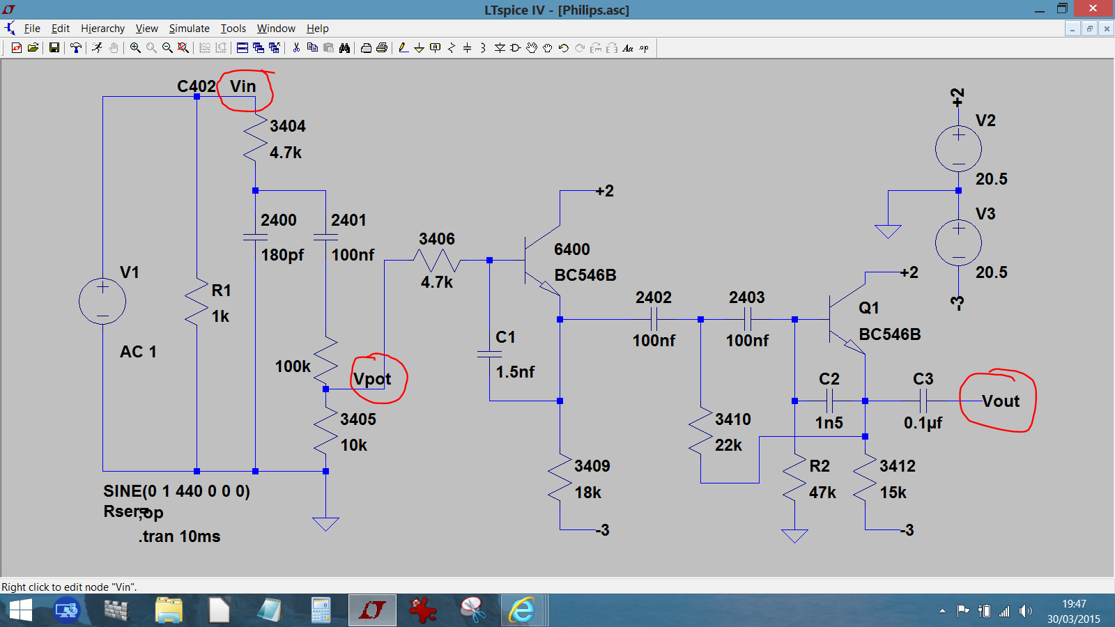

Signal flow is a progression from left to right but there is more to it than that.
So to answer your question... the red line shows the signal flow when the pot is in the speaker position.

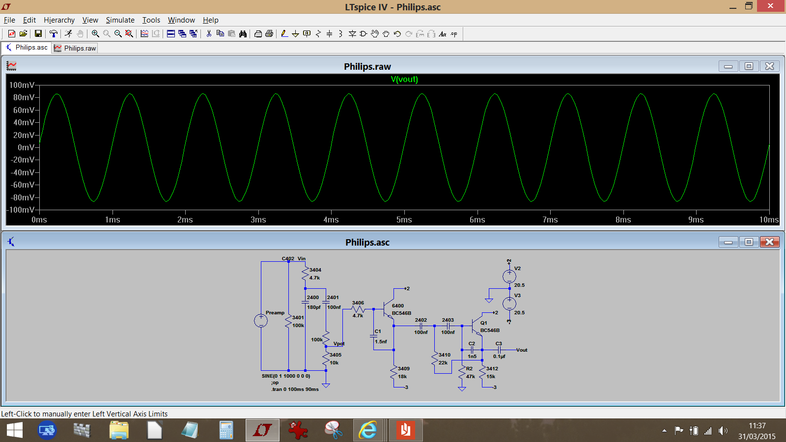

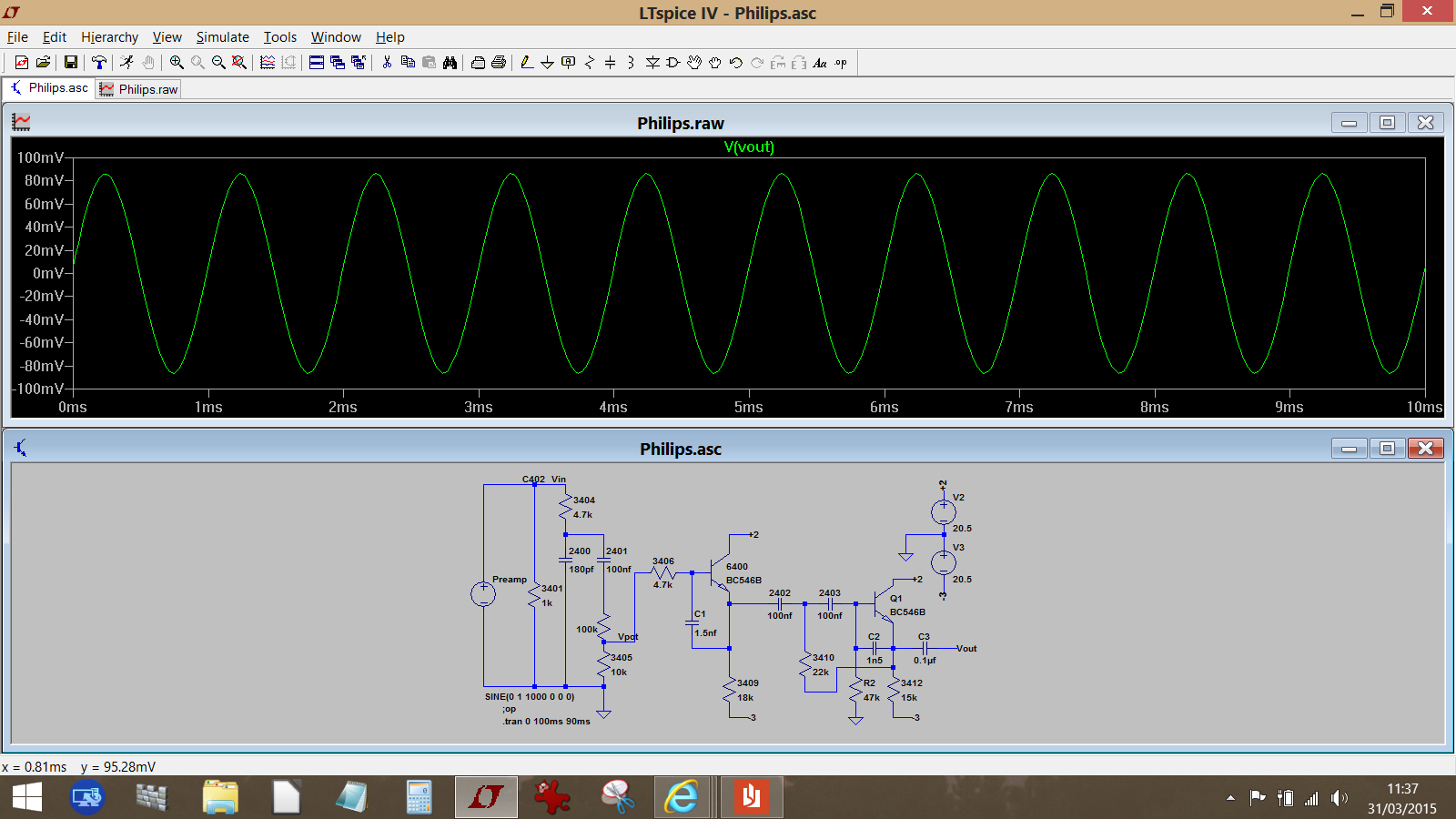

The next image shows the circuit in a simulator.

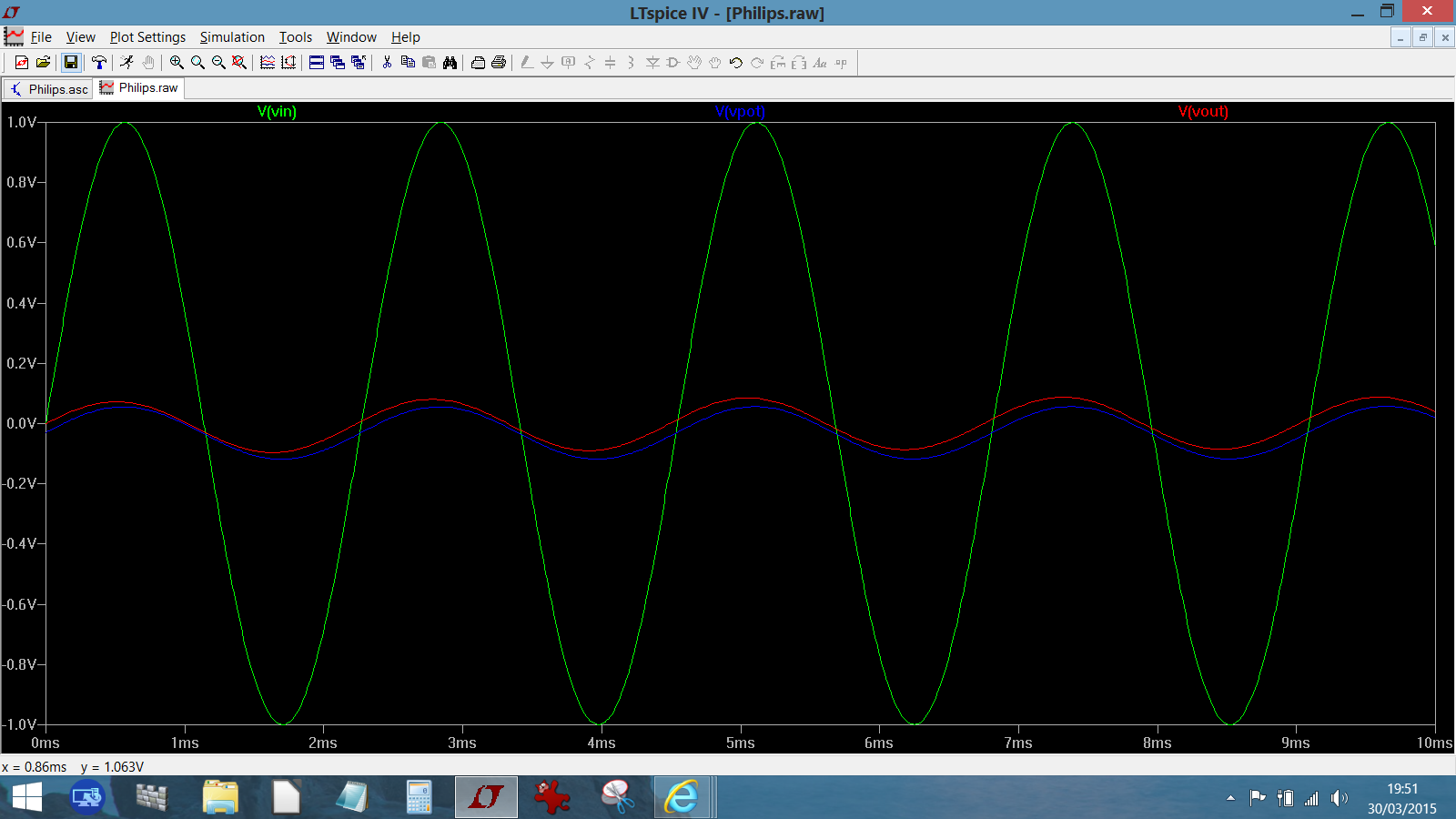

We then have a graph showing the signal levels. The pot is at the speaker/amp position and there are three voltages being measured. First is Vin which is set to 1 volt peak of signal. This is the voltage your preamp puts out. Second is 'Vpot' which is the signal voltage as measured on the pot wiper and finally is Vout which is the final signal output from this stage.
So that shows the signal path and levels in speaker/amp position of the pot.

Thank you Mooly, the red line was helpful in your first image; I have updated both drawings with questions to find more understanding.

To answer your questions.
The audio signal arrives 3400\1 and 3401\5 at the same time this is correct, yes?
Yes it does.
3401 there is a 100k resistor built-in to this pot; on the line drawing shows the lower half from connections 5 to 6 filled in what does this indicate; that the wiper has no contact in this area?
This is the bit we are not sure of. Its not drawn as a standard component. If you do the DC resistance check I keep mentioning and also by comparison to the other unit we would get a better idea. I'm guessing that with the pot on 'preamp' it reads either open circuit or 100k and with the pot on 'speaker' that it reads 1k. That's the resistance measured across the input sockets.
I know that is the opposite of what I stated at the beginning... it just makes more sense that its sole function is to provide a DC path for an AC coupled power amplifier that might get connected to it rather than a variable load on the preamp output. You'll have to take on trust that either version wouldn't alter what happens when its connected to just the preamp.
And that being related to the Sensitive Control moving off 4 to 5 or 5 to 6 has an effect on the audio signal?
6 is connected to ground, and 4 is just a connection going nowhere, it’s only purpose that I can see is providing a test point, to test this 100k you would then think to test this resistor, connect to 4 and 6?
No, this half of the control (3401) doesn't affect the gain at all. I can demonstrate that very easily in the simulation.
This shows 3401 set as 100k and as 1k. 3400 remains in 'Speaker' position. I know you can't turn them independently but this will show that 3401 has no effect on the gain.
We are applying 1 volt to the input. The output of the complete stage is just over 80 millivolts because 3400 is set to attenuate fully.
The simulation confirms the long hand method I used to calculate it all earlier was correct.
3401 resistance test results; (test a) on 4 and 6 gives 0.L (no reading).
Sensitive Control on pre-amp, (test b) on 4 and 5 gives 00.2Ω, and (test c) on 5 and 6 gives 0.L.
Sensitive Control on speaker-amp, (test d) on 4 and 5 gives 0.L (test e) on 5 and 6 gives 00.2Ω.
We cannot move on from this point; there should be a reading of 100k showing. Note when this fault occurred it was sudden not gradual.
Another interesting point that I have just seen now I have the red arrows to follow is; and I can see both drawings at once; this audio (1 of 2) coming from c402 arrives at 5 and finds its way internally to 2; it is the broken line (I referred to this in post 98 page 10) we haven’t done any resistance checks on 2 and 5?
Before I mentioned; on the line drawing shows the lower half from connections 5 to 6 filled in; I am still thinking that the wiper has or has no contact in this area.
I’m just thinking aloud here ok; with the Sensitive Control over to one side, the audio signal goes through 5 and then 2. With the Sensitive Control over to the other side the audio signal goes through 1 and then 2. This would dropout some of the components from being activated?
I think you may well have something with what you said earlier quote:
“In fact I've thought more on this aspect because its just so weird a feature (that first gang of the pot and what it does) and I've revised my thinking in that it might simply place resistor 3403 in circuit when in 'speaker/amp mode' purely to account for the fact that some amplifiers may well be AC coupled at their outputs and so need a resistive path like this to quickly charge that coupling capacitor. It would make more sense for it to operate like this than how I previously suggested.”
The other speaker, hmmm, well you did ask, please read post 4.
You can compare the result with the other speaker just by measuring across the leads to the preamp. Switch both speakers off first though. This is what I keep wanting you to do.
Just measure the resistance at both extremes of the pot setting for both speakers.
You see, no matter what that section of the pot does, it can only add 1k or higher loading to the preamp (resistor 3403) and so that gang of the control has no effect on the preamp output.
