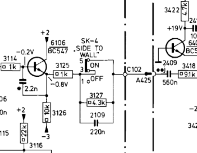

Yes, Mark is correct on the sensitivity thing. The most sensitive setting is for using the preamp. The least sensitive is when you want to feed it from a high level input such as from another power amplifier output.
There is information in section 3 which seems to be misinterpreted, but by whom? this is section 3 in full.
Turning the sensitive control from full on speaker-amp to pre-amp the sound is slightly higher and a little clearer, (less muffled) whether this is still the case after removing the above links, is to be seen.
Below elaborating on this section.
The volume should decrease when turning the sensitive control to pre-amp (and this is because you are leaving the speaker-amp and coming on to the pre-amp, the pre-amp is just a small amp) not increase and the quality should be there either way when you turn this. END.

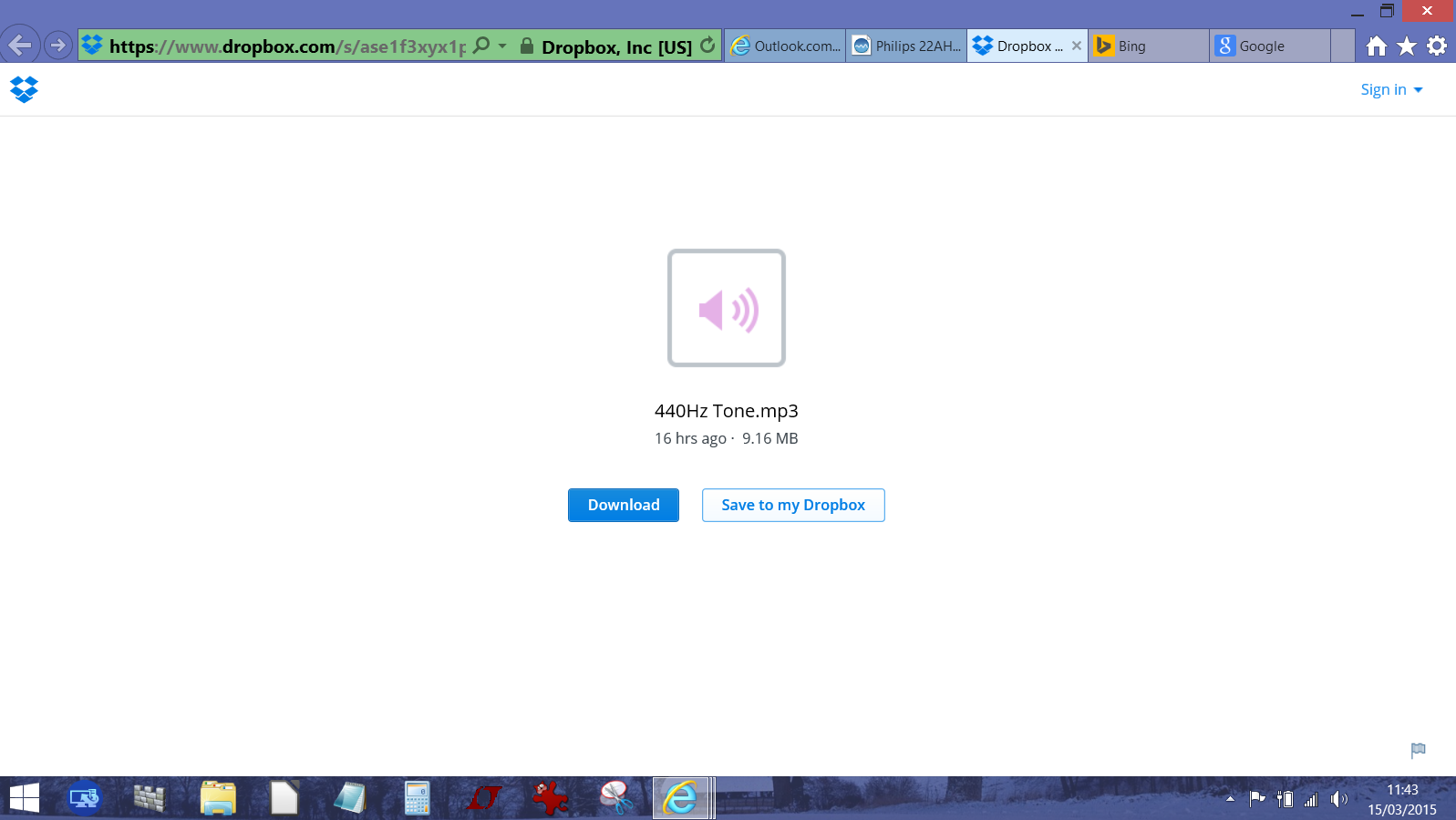

Here is a 440Hz pure sine test tone as an MP3 file. It plays for 10 minutes and fades in and out at beginning and end. Treat it just like a music file and either burn to CDR or put it on an MP3 player so that you can use that as a source.
https://www.dropbox.com/s/ase1f3xyx1pogli/440Hz Tone.mp3?dl=0
Your meter looks OK as it lists both a 200mv and 2 volt AC voltage range. How the meter reacts to an AC voltage superimposed on a DC value is an unknown and so I would advise just having a small capacitor in series with the red meter lead to block any DC. Cap 2109 is the obvious choice to use because the switch marked 'Side to wall' shorts this cap out anyway if set to the position shown here.

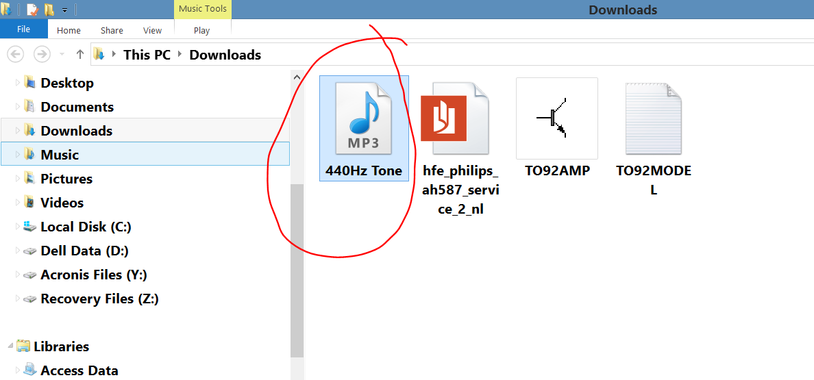

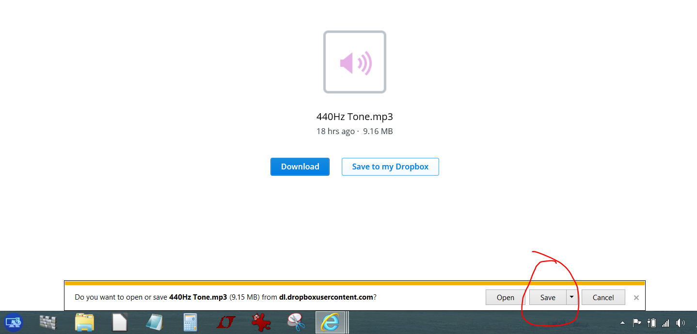

password-wall.... 🙁Here is a 440Hz pure sine test tone as an MP3 file. It plays for 10 minutes and fades in and out at beginning and end. Treat it just like a music file and either burn to CDR or put it on an MP3 player so that you can use that as a source.
https://www.dropbox.com/s/ase1f3xyx1pogli/440Hz%20Tone.mp3?dl=0
I hate the cloud!
password-wall.... 🙁
I hate the cloud!
Don't understand 🙂 I'm on a pc now that has no knowledge of Dropbox or my account with Dropbox and it opens just fine.
