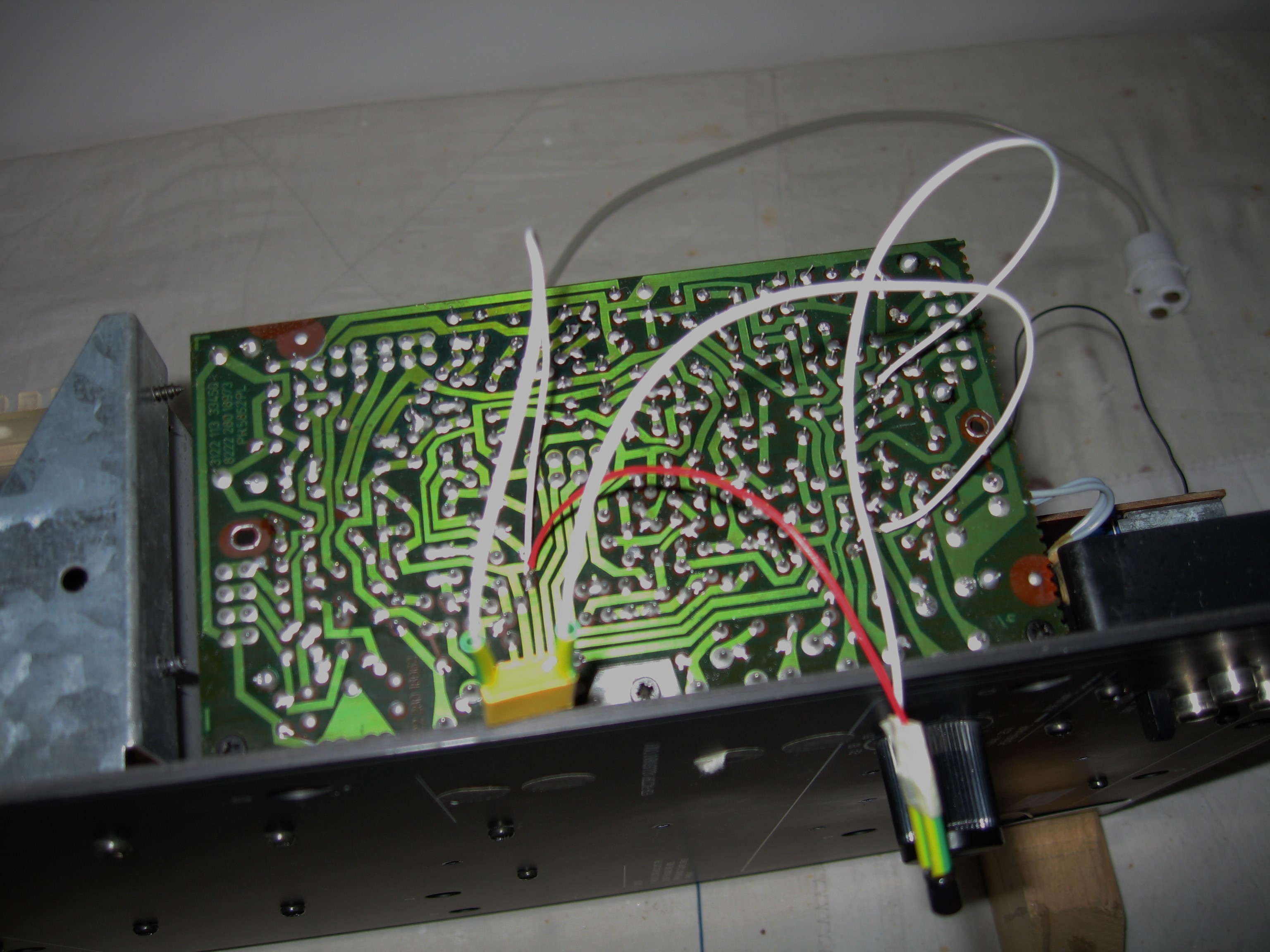

Have submitted photo showing the flying leads, sorry the focus is a bit out, you can still see. The attached PDF shows and gives this information, I need to know about the flying lead from c402 see the PDF. It is quite a tight fit when refitting the back leaving little room to add components, hence having to pack them to the inside of the board 😕

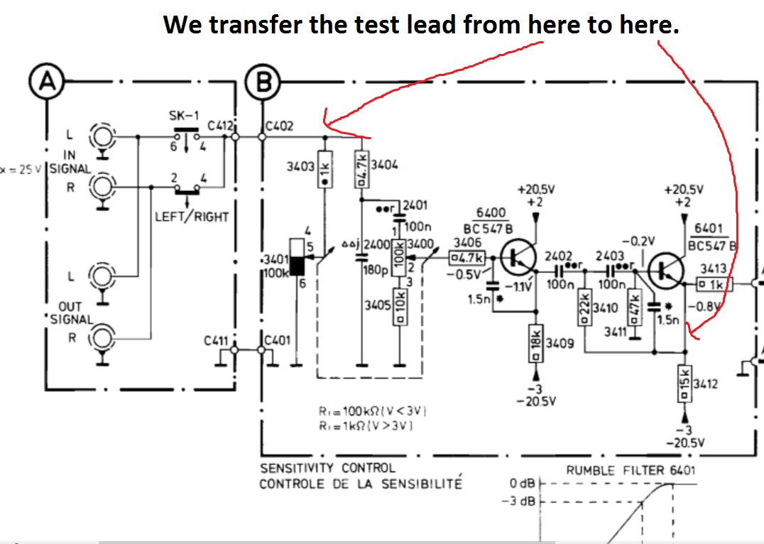

Just to recap, when you had audio working in the previous test it was with a lead from C402 direct to 2426. And it worked.
All you do now is transfer the test lead from C402 to your point 'B' on the pdf. That point is the emitter of transistor 6401. As you have the extra cap still in the test lead it can remain.
Just make sure that all parts in this box (B) are fitted.

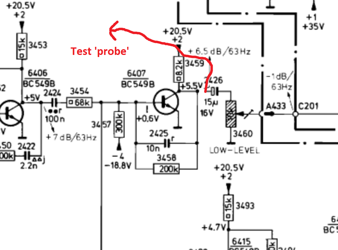

I had the flying leads fitted to lower connection of 2426 leading to 3460, the other lead connected to c402, with c2426 fitted within the flying lead, and it worked.

Fit a flying lead from c402 D to B does it need a component fitting on this lead?
Quote “Just make sure that all parts in this box (B) are fitted” are you saying replace 3403 and 3406? This would just leave 2426 and 2409 removed.

Yes, replace 3403 and 3406. 2429 and 2409 stay removed for now. The test lead should be in the same place on 2426 as in the previous test when it all worked.
We could bypass the control now but I just feel we need to be logical and also not run the risk of anything going amiss or being missed. We have it in a state that works. Lets not risk confusing things 🙂
So it will either work or not at this next stage and that can only be either the control or that two transistor front end.

Your test lead is currently on the emitter of 6401. Simply transfer it from there and connect it to the emitter of 6106. You should still have audio.

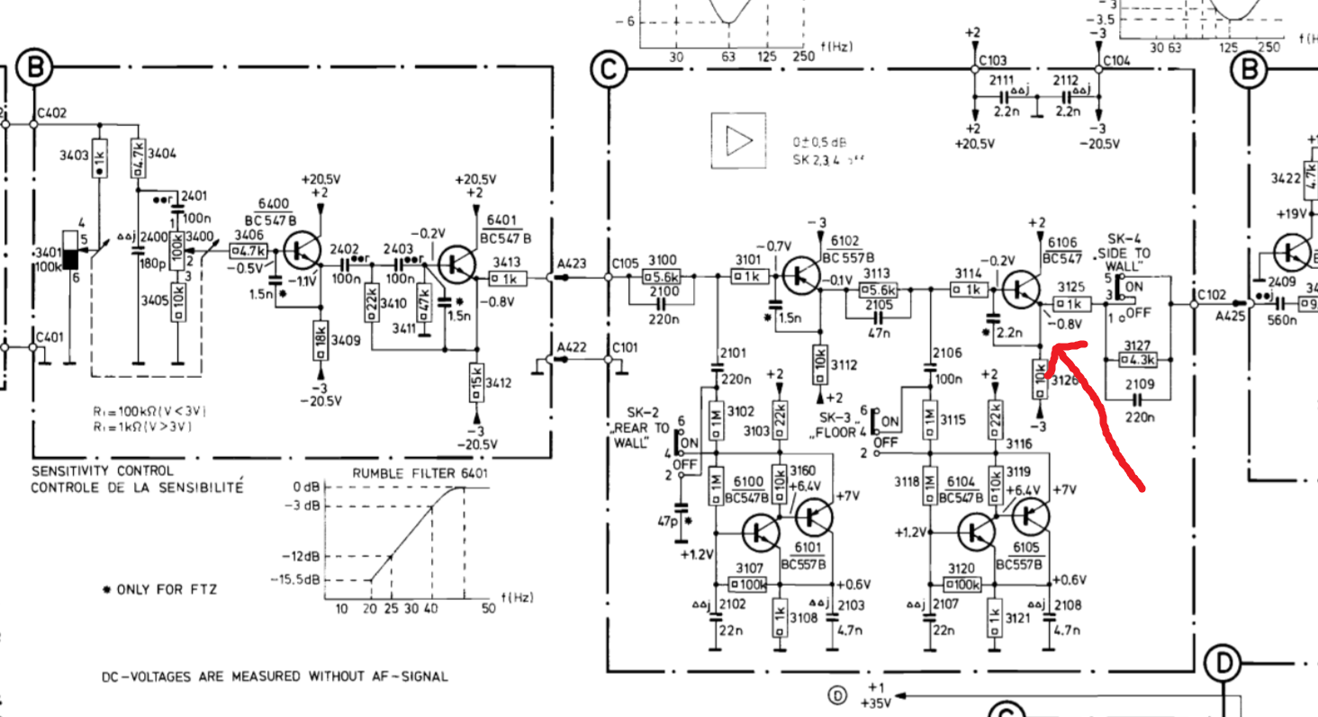

Next step is as in the picture above and is just to transfer the test lead from 6401 to 6106... or have you done that ?

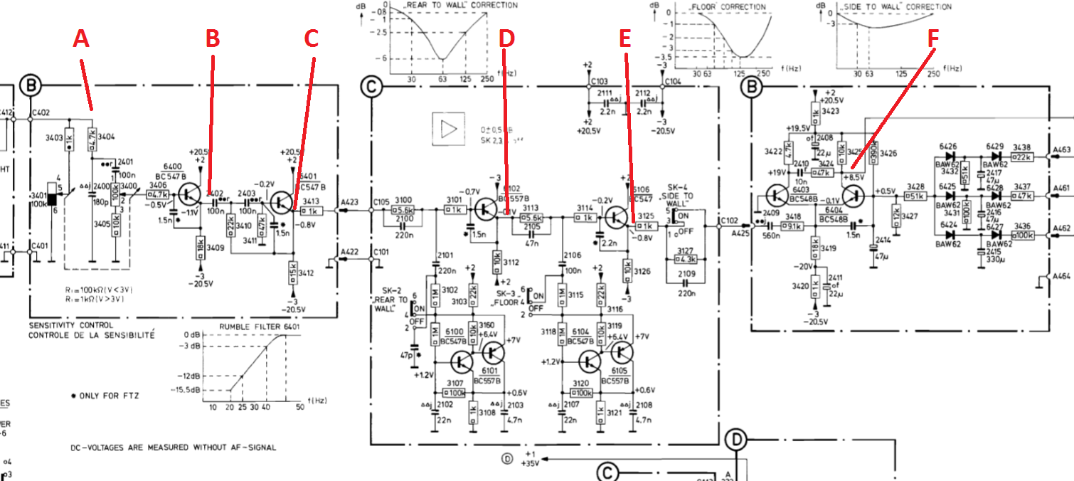

Another thought to make it easier to understand and fault find on is this which will give you something to work to without keep needing to ask each step of the way 🙂 The audio has a straightforward progression from left to right, yes the levels at each point vary somewhat but at no point should it suddenly drop out.
If you keep the polarity of cap 2426 as it is on the diagram then it will be OK for all the test points. Refit cap 2109 before you start.
You have rigged the bass amp up with a wire that can be used to probe the signal along its path as shown here. We know that works as you mentioned having loud audio in a previous test. Preset 3460 acts as the volume control in conjunction with the main level control.
The audio should be present at all these points marked A through to F. All you need do is work through and see if the signal 'disappears' at any point.
