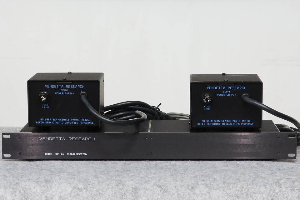

Strictly speaking the Vendetta was a four chassis solution.The Vendetta Research SCP-2 moving coil preamp (1988) was a two chassis solution.

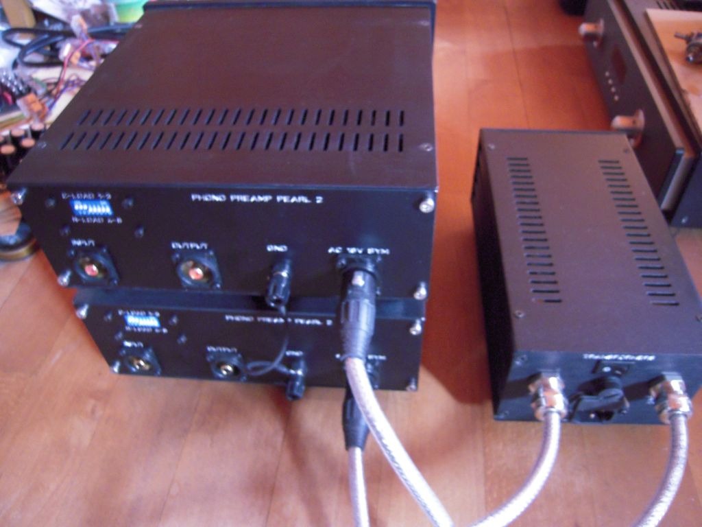

Yes, I know that generally PSU in its own chassis is a better solution. I use that for many of my amps. E.g. the Lazy Singing Bush where PSU's are placed 0.5 - 1m away from amps to avoid magnetic fields. Also VFET Kit amp uses this, ACA etc.The question isn’t will the two-chassis be better, it of course will, but instead will the one-chassis be quiet enough.
That’s what I’m testing.
When I looked at the two chassis solution I had in my mind that many people will probably stack them. Doing that and if chassis are aluminium rather than steel the PSU magnetic field may come closer to the P3 boards than in the one chassis solution. Also if the splitter in the one chassis solution is steel and you cover the PSU part with e.g. mu-metal I was thinking that maybe the one chassis solution could be as good as a two chassis solution (also that the PSU in such an amp has much less fields but then the circuit is a lot more sensitive so probably "same same" compared to the power amps).
I will probably go with a two chassis solution and ensure the PSU chassis is at a good distance from the P3 chassis. Unless some measurement was made that showed that the two solutions were equally quiet. It may also depend of how large the "one chassis" is 🙂 .....but the pictured is less than 1m wide 🙂
Is is a nice thing that the regulators are placed at the P3 board. Then longer wires to it is not that critical.

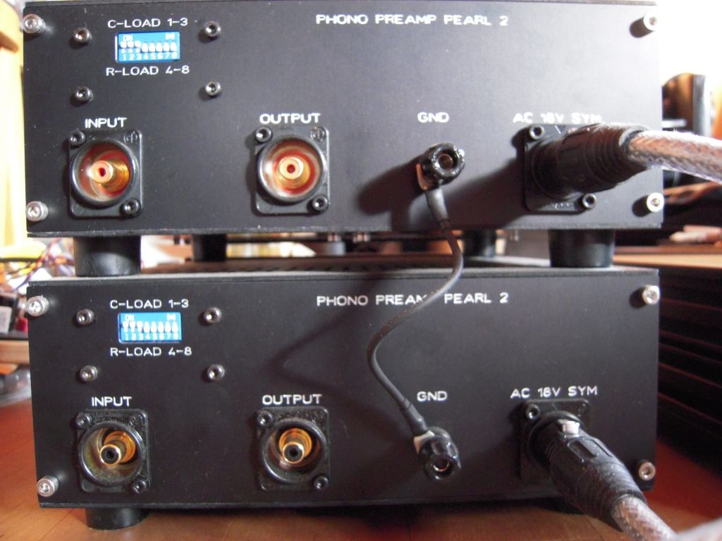

Hello PEARL 3 - builders,
very nice work from all!
This is my chassis-solution I did some years ago with my PEARL 2 (3 chassis). I will do something similar with the PEARL 3.
Have fun with this project!
I wish you all a nice weekend
Dirk 🙂

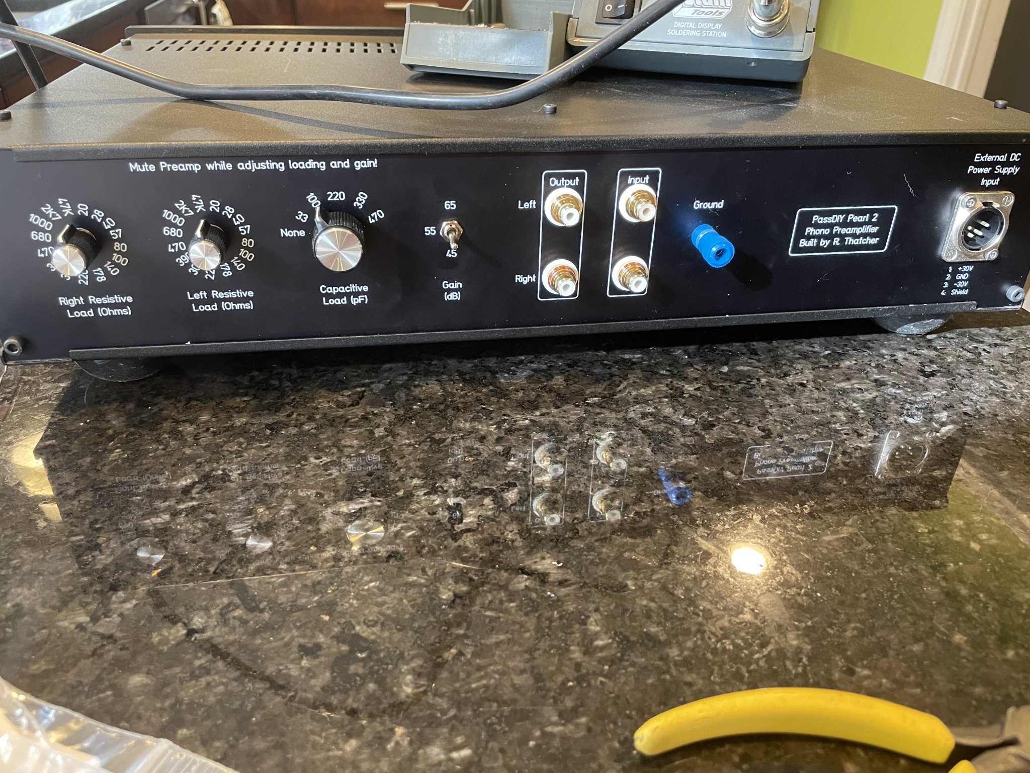

Dirk, do you have more pix of your dip switch setup on your P2? Including internal pix?
My Pearl 2 is a 2 box solution with adjustments on the back using knobs and a gain switch. I now know the settings of my carts, so the P3 will be a “set and forget” philosophy for me.

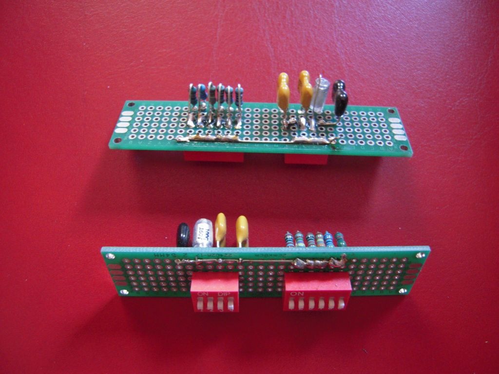

Hello Randy (i hope your name is right?),
I was also thinking about a rotary switch solution. Can be done very nicely from the frontpanel or from the backpanel - question of taste for me.
Rotary switches can be expensive...
I have used simple dip - switches and a small selfmade pcb. I have a paper note (anywhere), where I wrote down the R- and C- values and the values if you switch the Rs or Cs in parallel.
I will find it. Please, give me some time.
I have a foto of the prototypes (input R-/C-load) on protoboard.
Cheers
Dirk
