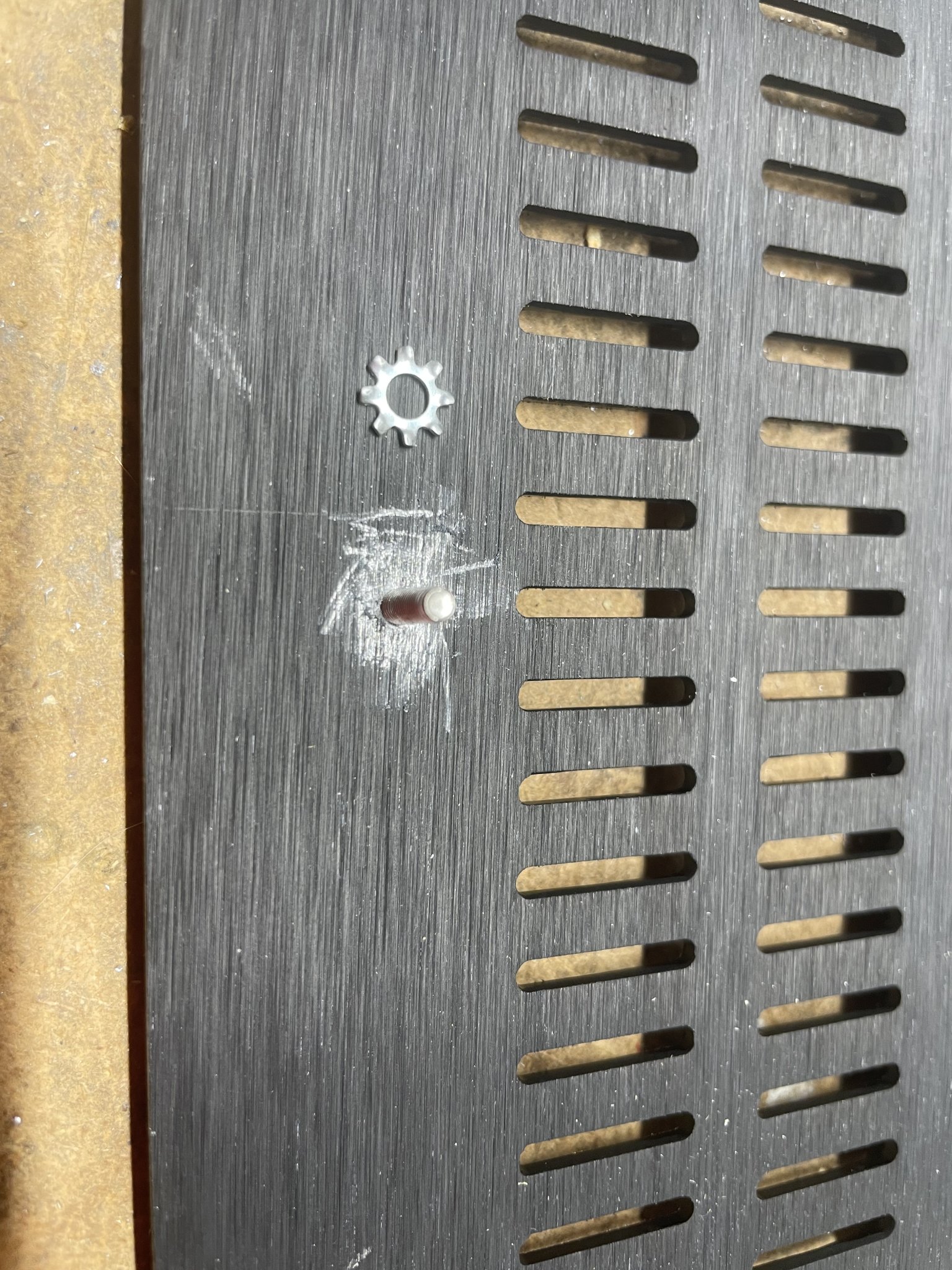

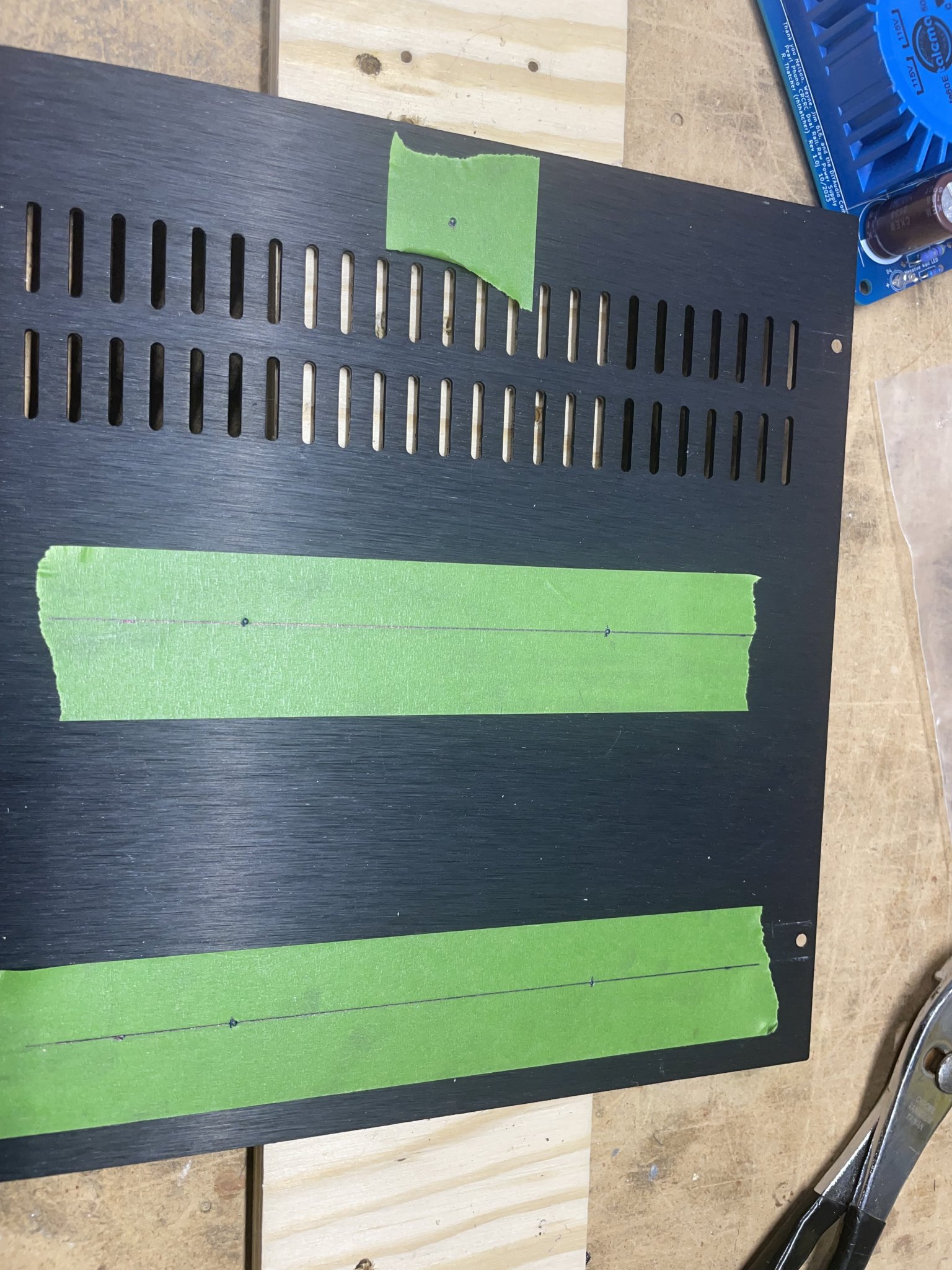

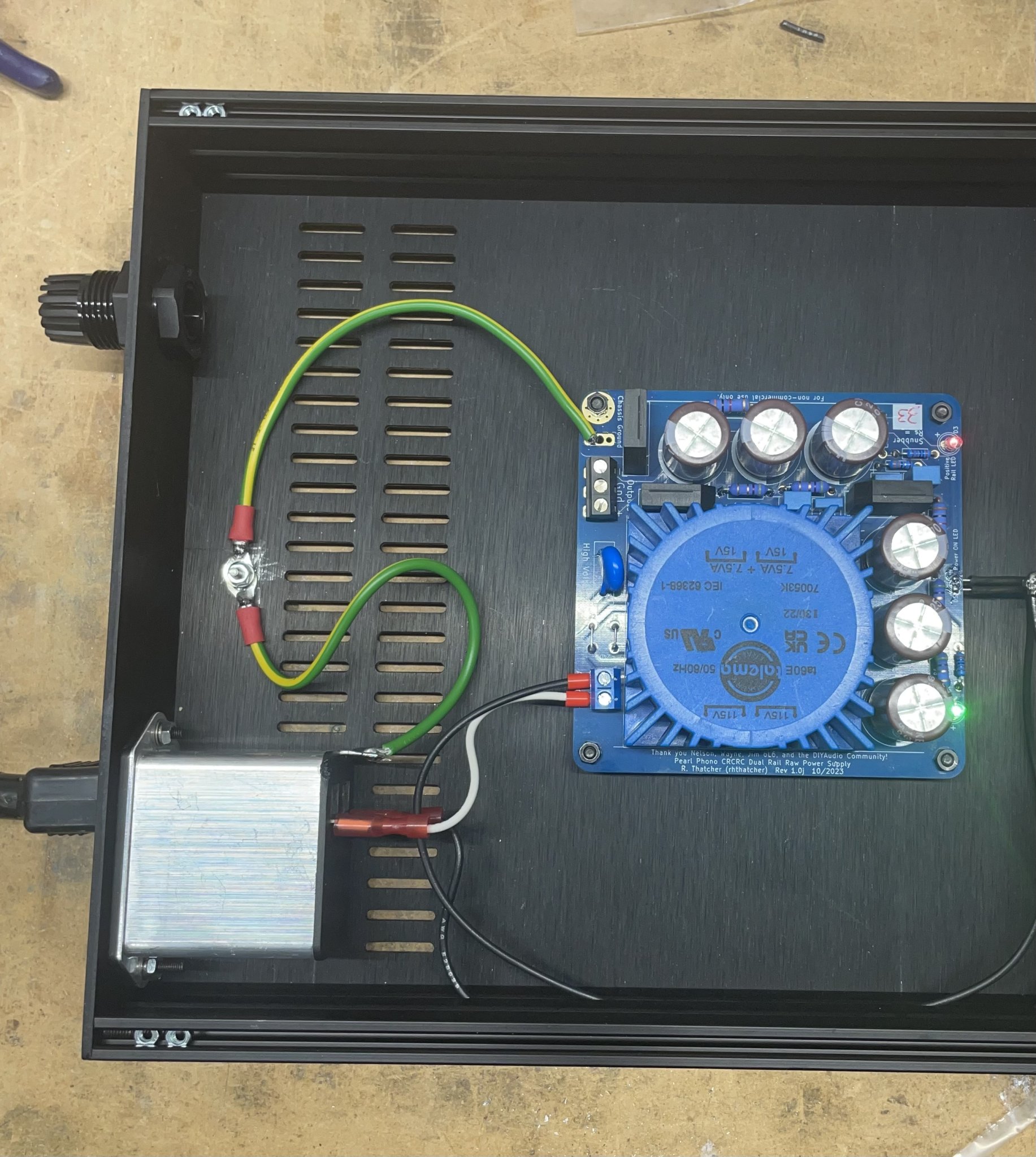

Power supply box is assembled and working.
Tomorrow I plan to prepare the umbilical cable and then the main box.
I did a little drill work on the bottom plate. We may go for pre drilled on the production boxes. You can see a little scraping and a star washer to ensure a good connection for the chassis / earth ground point.
IEC is a filtered and fused unit from Schurter.
