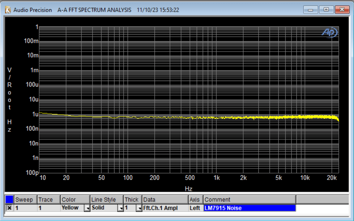

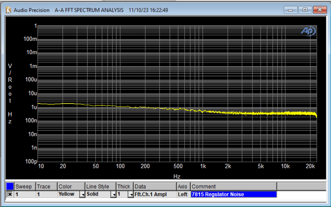

Here's a snapshot of the 7915 regulator (MC7915AC) with the two 10uF capacitors. The noise is less than that specified in the Texas Instruments data sheet (125uV 10Hz - 100kHz) It's a rather ancient 7915 -- has the Motorola (not OnSemi) trademark!
Would it help to lower the ripple from the input?
E.g. if you used a 7918 so a regulated 18 VDC was used as input to the 7915 would that lower the noise?
Also interesting if there is a special brand that has lower noise than other.
Now only a small part of the 125 uV noise will be present at the output of the P3.

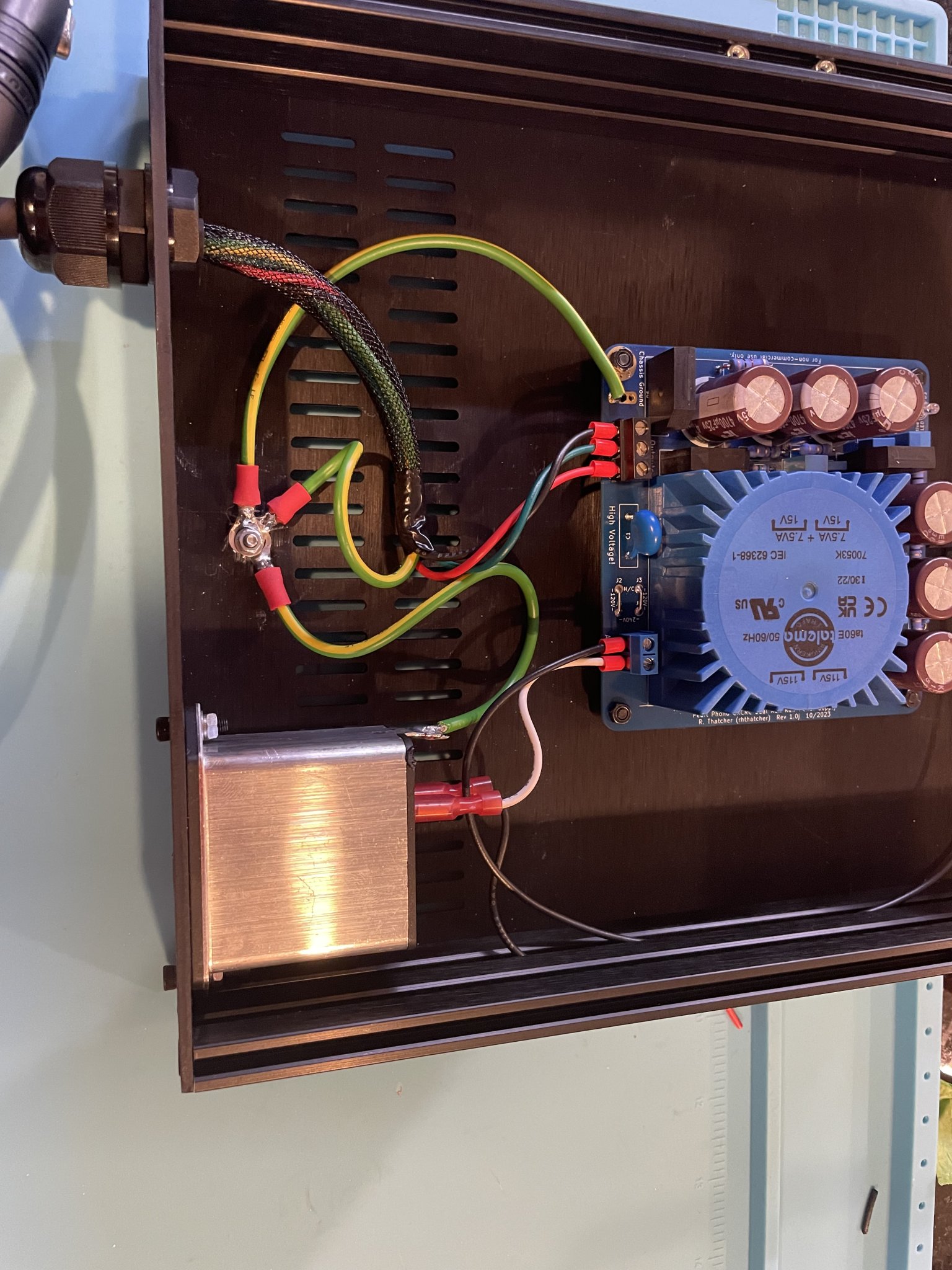

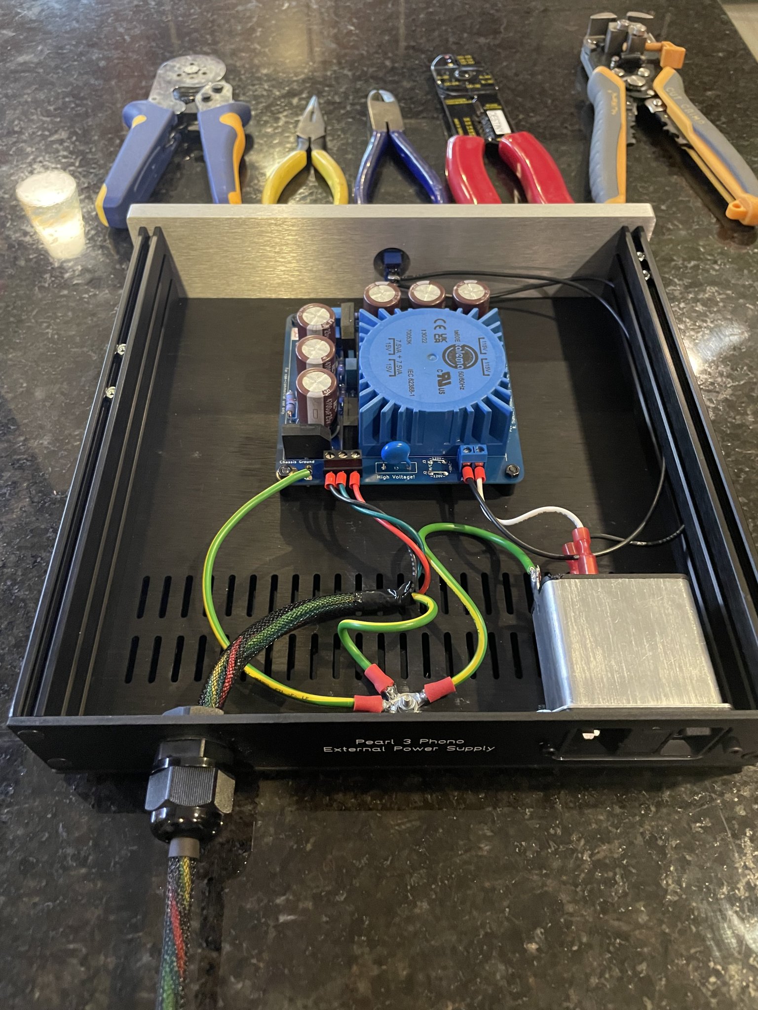

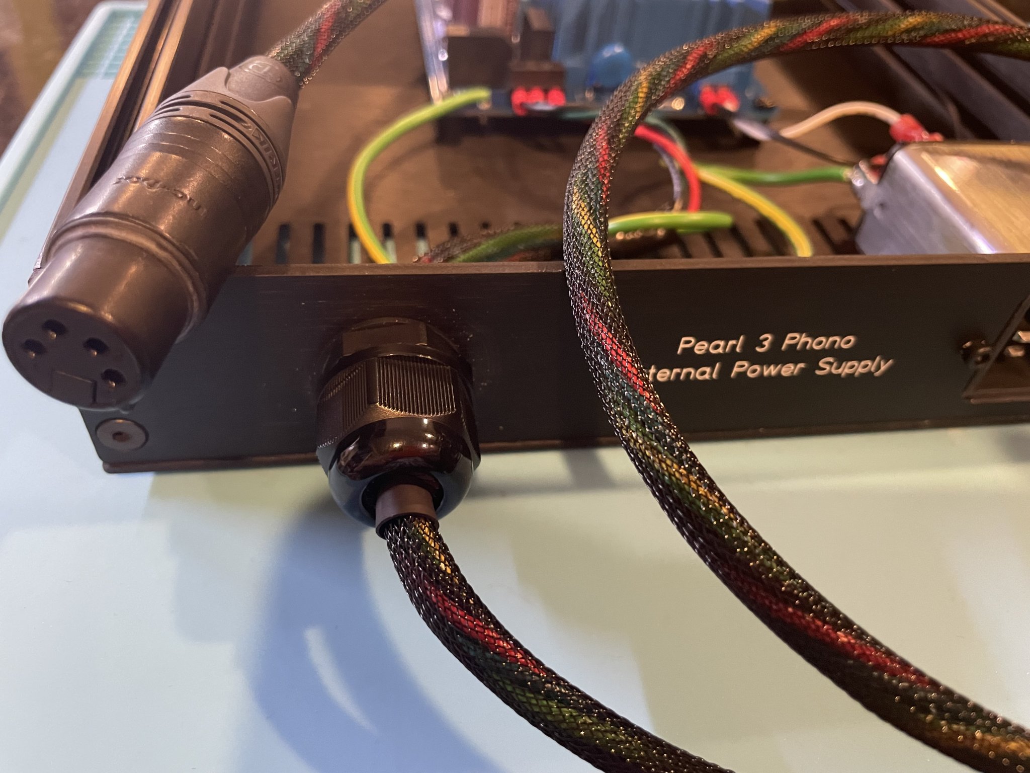

Power supply is done. I’m using twisted 18ga wire for positive, negative, and audio ground. I ran a green/yellow earth ground in the bundle, too. We’ll see if I terminate the earth ground on the other end. I may swap this out for some shielded cable later.
Umbilical is wrapped in techflex. I have some heat shrink on the tech flex at the PSU box cable gland. You can see ferrules for wire terminations into the PCB screw block connectors. The umbilical is appx. 1.3m long.
Connector is a 4 pin neutrik xlr. It’s 4 pins to eliminate the possibility of connecting power to an audio signal jack.

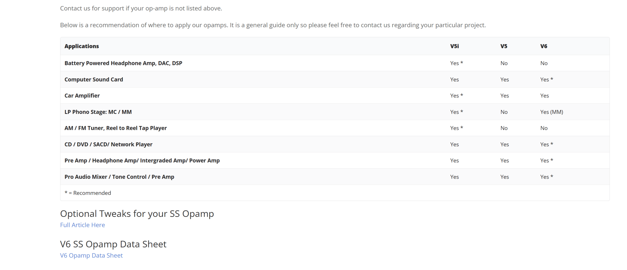

They only recommend the V6 for MM cartridge. I assume it is because of the noise figure?
As far as I can see they don't specify noise in their datasheet?
https://drive.google.com/file/d/1JyV88oA-33QHSHbGYF16A3FRW1mDRV1N/view

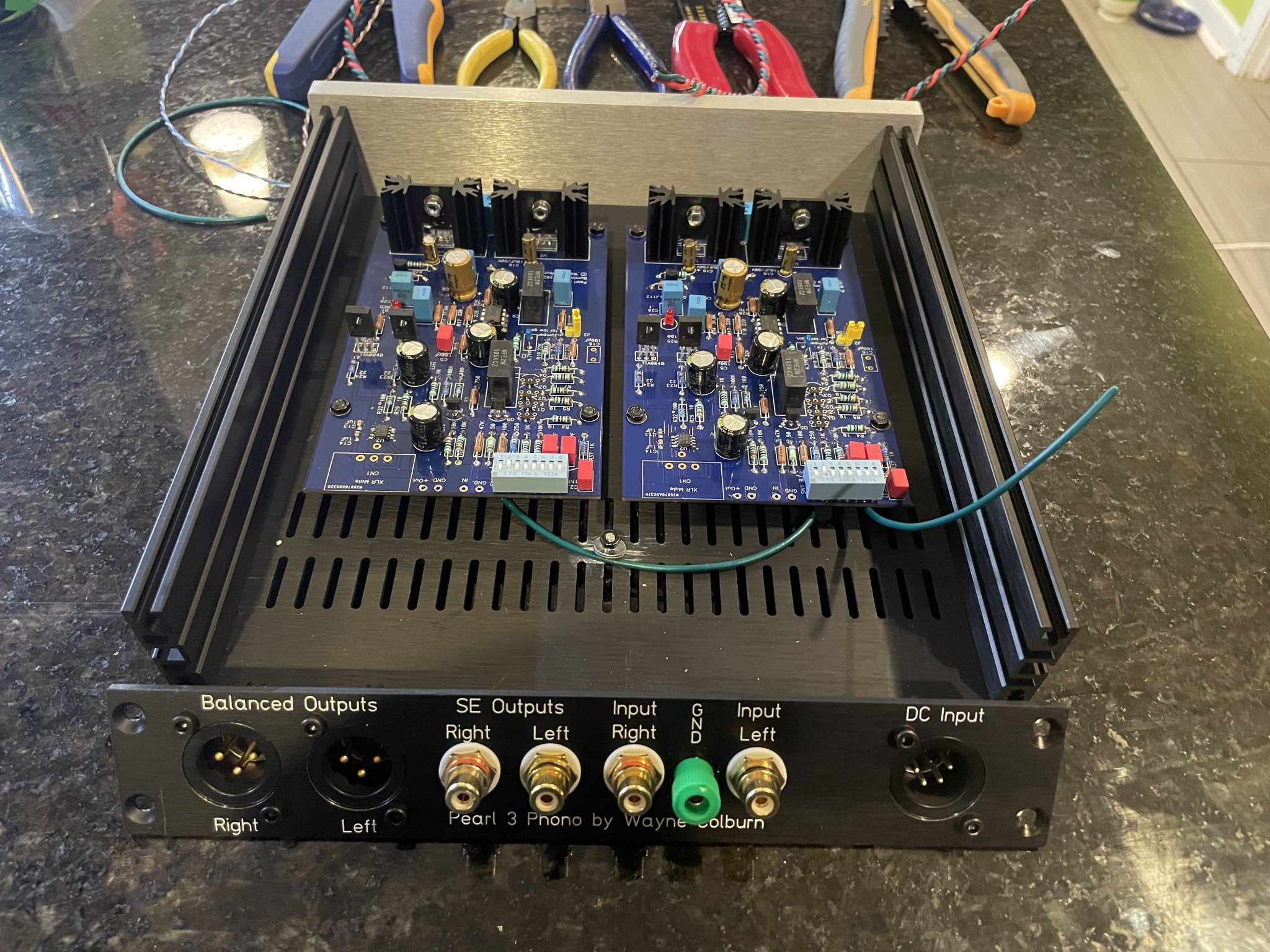

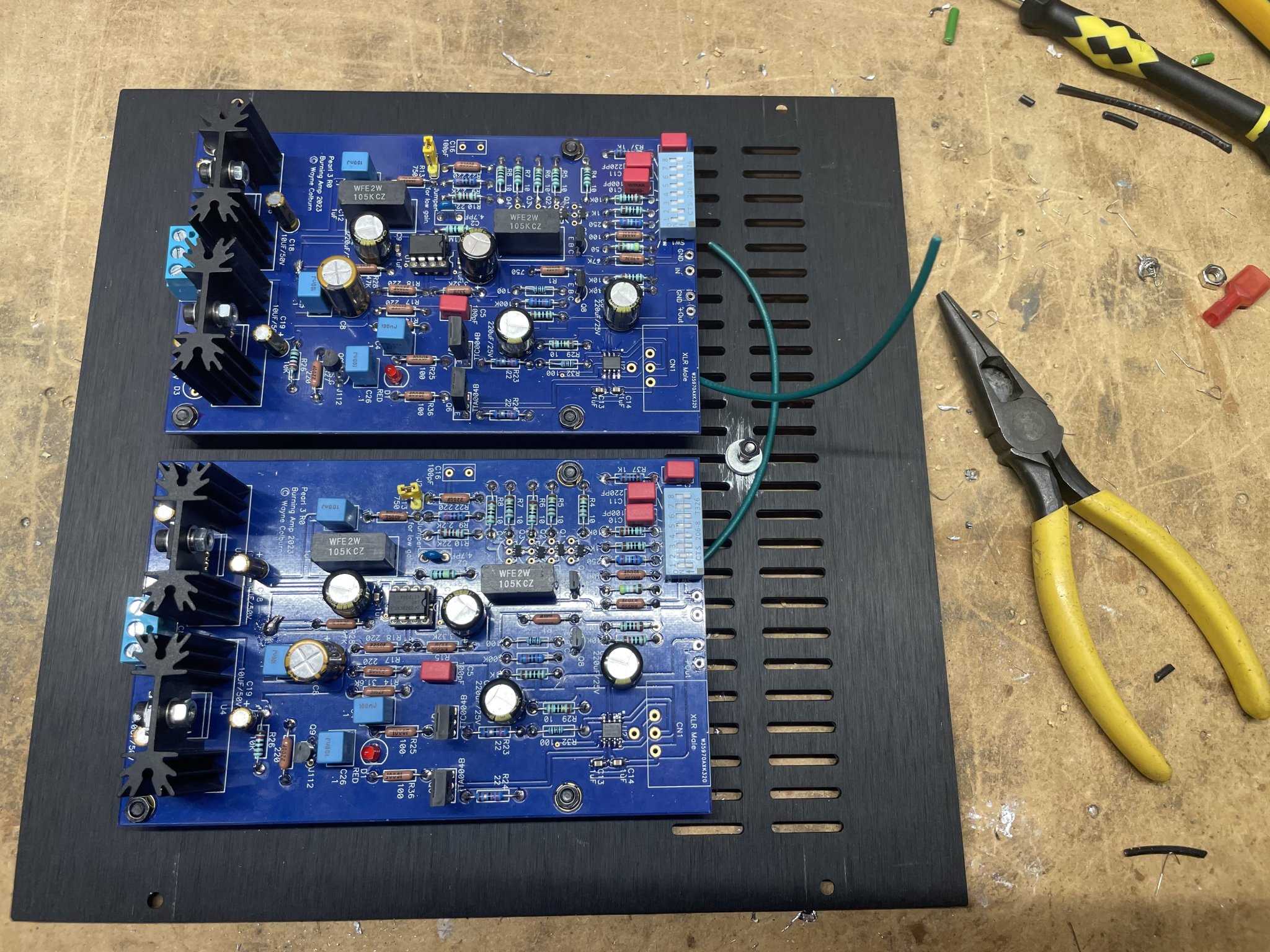

Final pix for the day. I need to wire up the phono chassis, then test, then listen.
These boxes are prototypes that will be available in the near future from Gianluca at Modushop / Hifi2000. More news on that will come soon.
Good eye, MEPER. I’m using LME49720. No better reason than I have a bunch of them in my parts stash.
Soooo looking forward to getting mine. Then I can see the front panels instead of just the cad drawings… which looked wonderful.

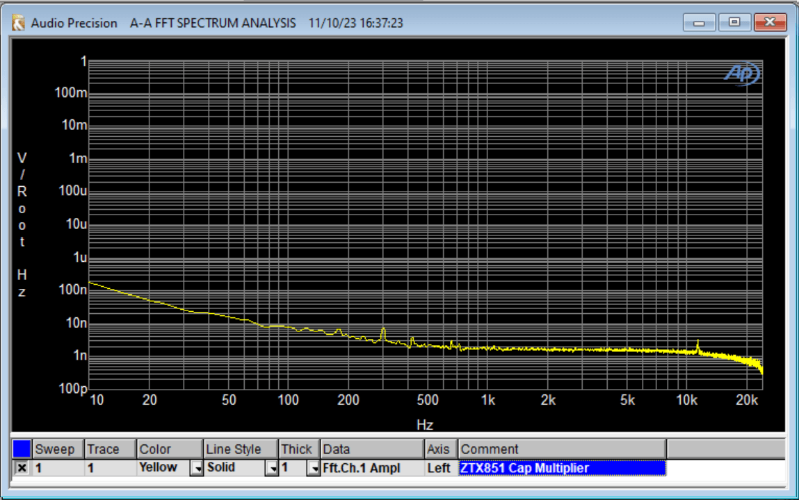

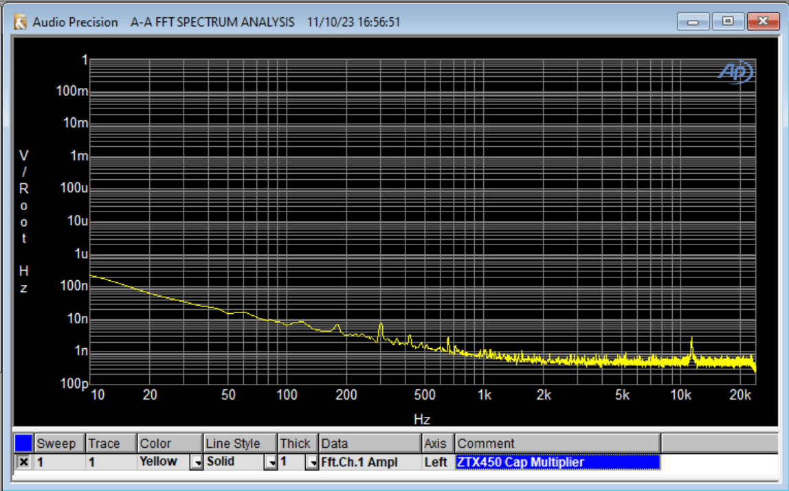

In case anyone is interested or paying attention, the difference between ZTX450 and ZTX851 in the cap multiplier is negligible. Remember that your ears are most sensitive to noise in the region around 6kHz. In the days to come, I will review more readily available transistors.
The measurement amplifier I am using is one of Gerhard's designs and has a lower threshold in the vicinity of 300pV/RtHz above 500Hz. (Oh, I am also powering it with Jan's "Silent Switcher").
Does it matter? Will see on the quiet passages of some LP's.
