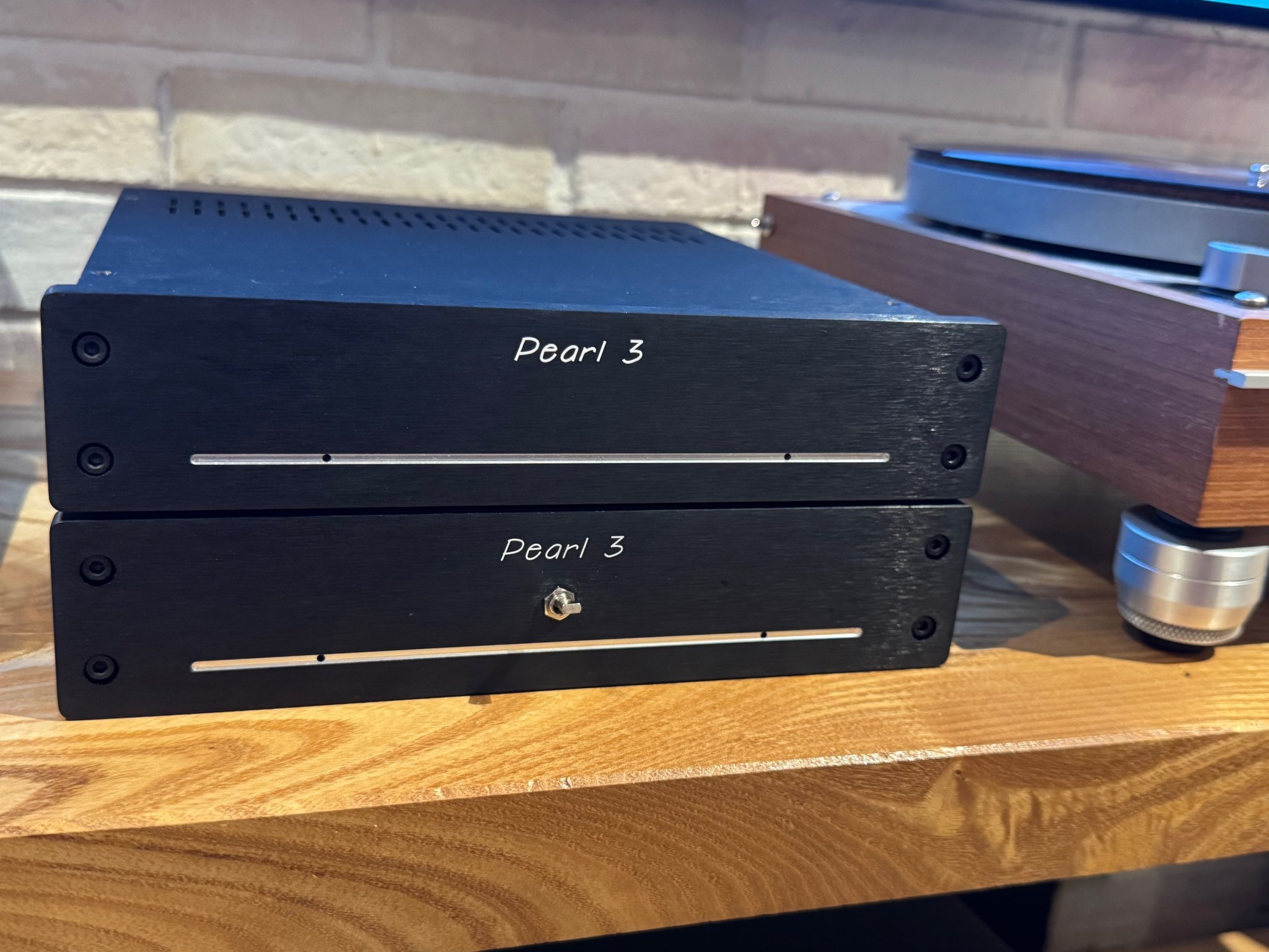

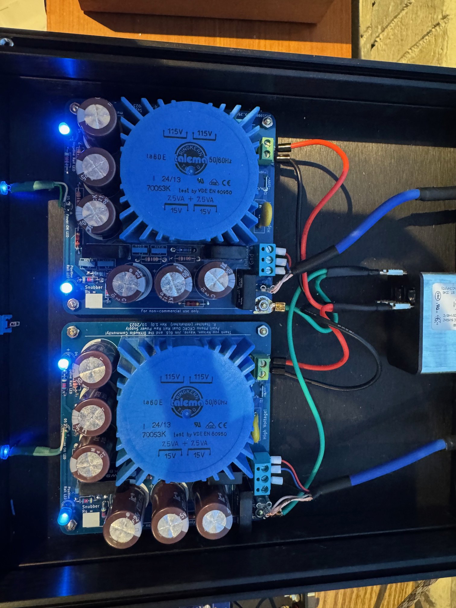

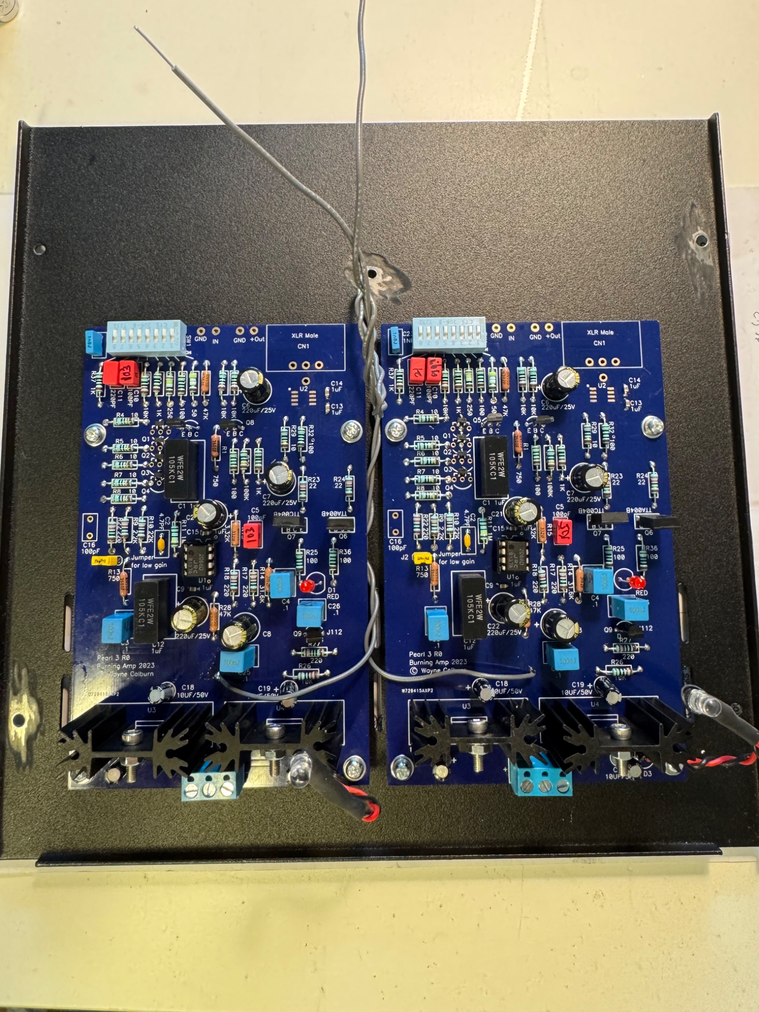

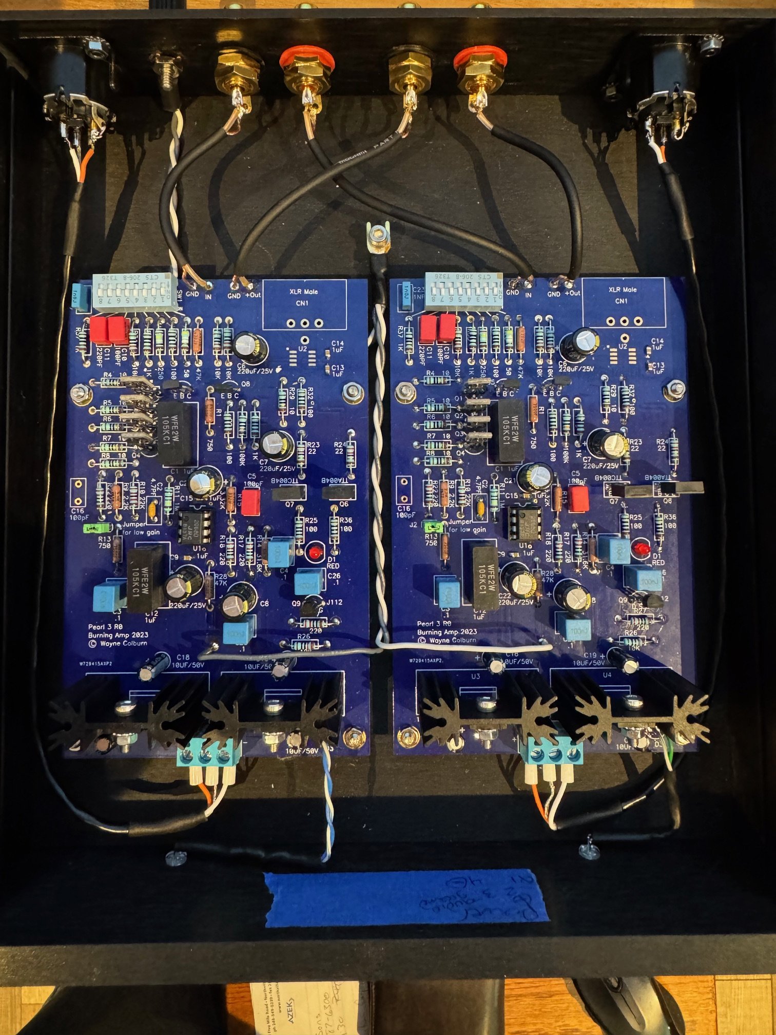

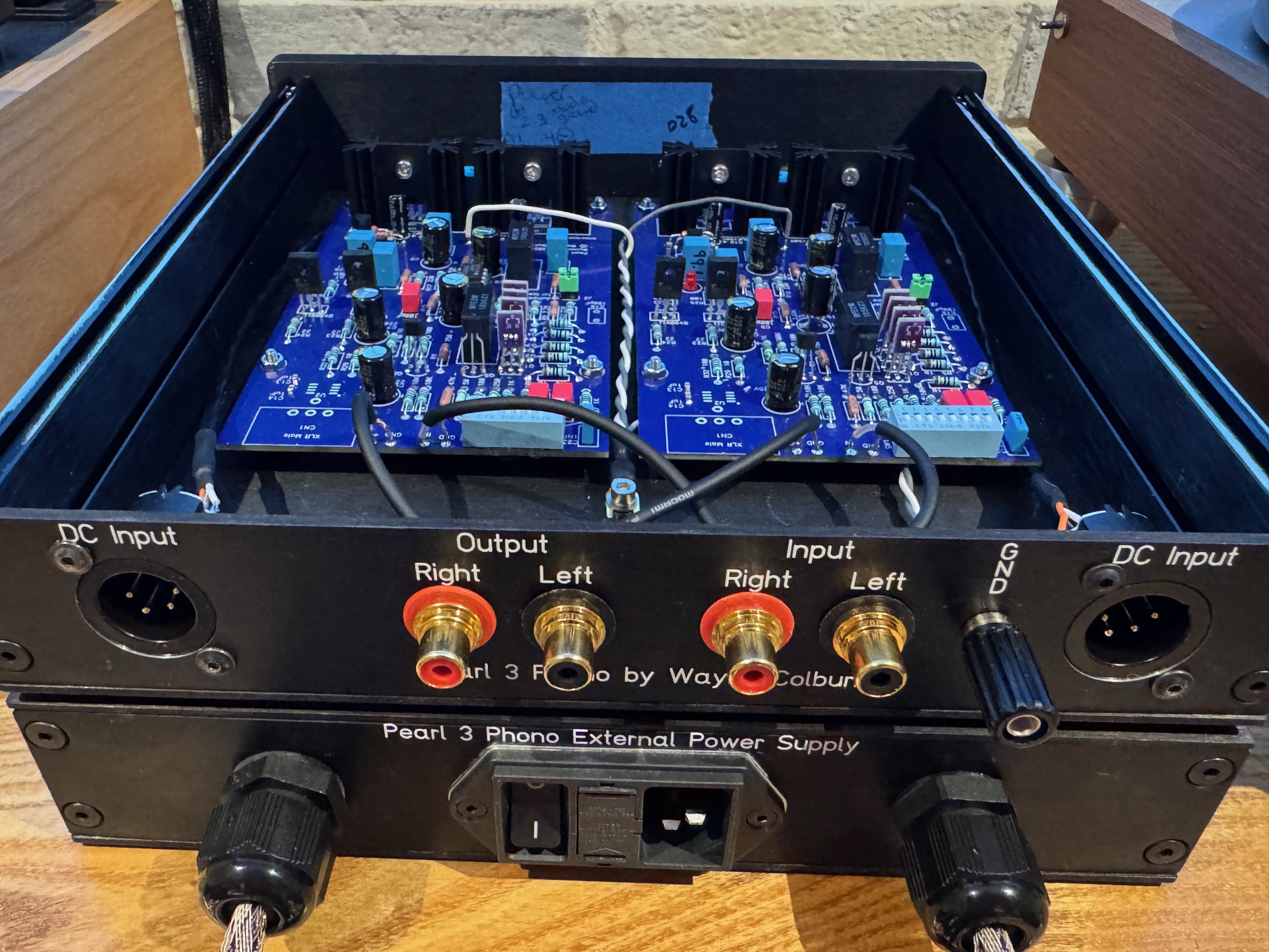

Hey everyone - just finished up my Pearl 3 build - duel mono power with sweet murdered out black chassis from modushop.

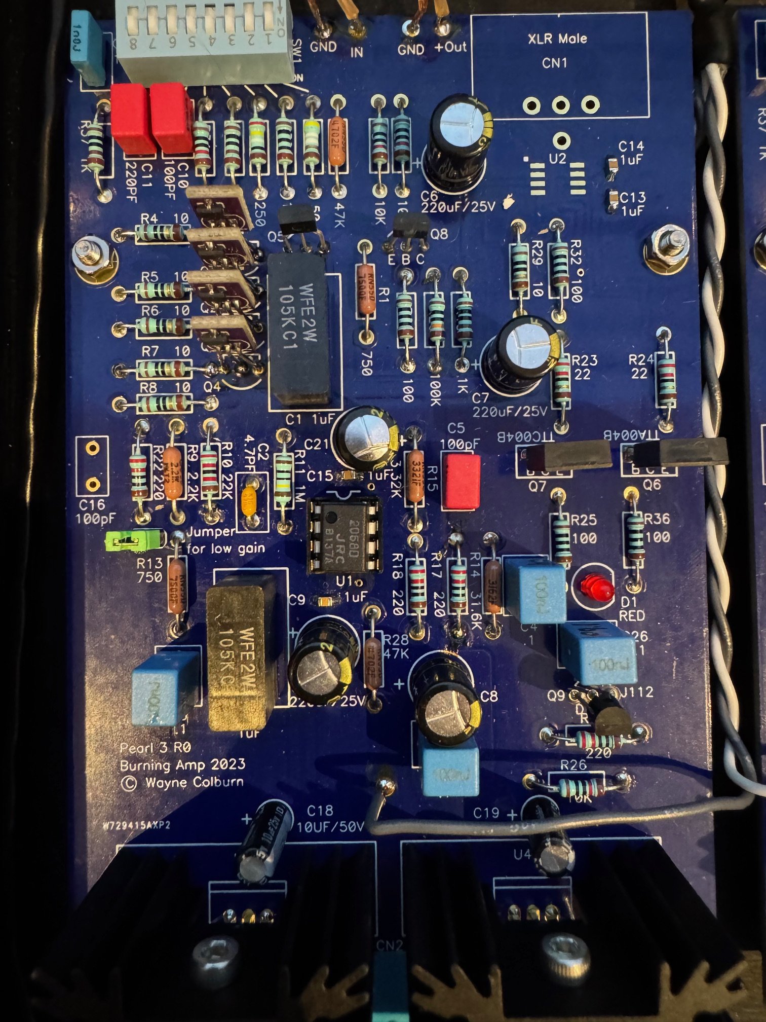

Fired up power supply, had 24.8v on both sides. Power umbilical showed same. Plugged into Pearl amp chassis and turned on - Right channel showed 24 V at power block and for some reason Left only showed about 9 or 10V. Before I could scratch my head I heard a hiss and Cap 21 let the smoke out with a nice POP. The cap is a bulging for sure but everything else seems fine. Do you guys see anything fishy here or did I just have a bad cap? Measuring across L side R27 was 2.8 V so that's within spec at least.
The only thing I didn't do yet was wire up the front switch - the power inlet is switched for the time being but I'll do the front eventually.
Thoughts?
Well, it's all happy now! Ended up bumping R27 to a 820R to get 3.46mA and dang those LEDs are bright so went with 30k and might even go up to a 50k before its all said and done. My first attempt at a custom chassis. Nothing too crazy, just tweaked the original pearl3 chassis to be duel mono power and delete the bal outputs. Thanks again @Gianluca for the help and crazy fast turn around time!
So yeah, this thing sounds wonderful! @6L6 you were right . . . best phonostage I've heard! Even after just 1 record, the details and that "i've never heard that before" stuff was nuts! Thanks everyone for the encouragement, help and amazing generosity! And thanks @GKTAUDIO for the matched / modded 209's! Your boards are very slick, put together beautifully and worked perfectly!
With family away for the weekend there was plenty of time for P3 building (single psu).
Still waiting on Mouser order with back panel parts, so no final wiring done.
I used mogami w2893 for the umbilical in the psu chassis and plan to use same for power in the P3 chassis pulling 2 of the 4 wires together as the ground.
If using 3 twisted wires as per the online guide is a much better way to go for power in P3 chassis please let me know.
Thanks in advance.

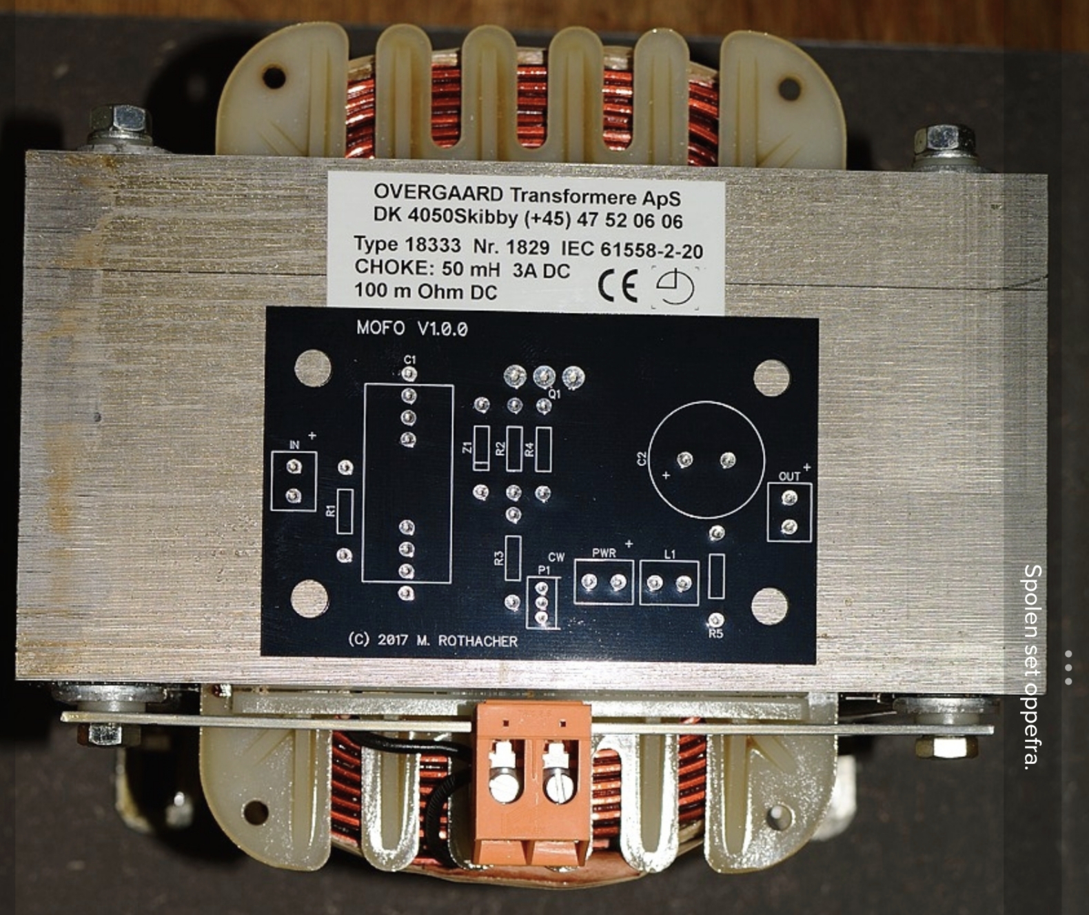

Speaking of ac suppression... I just bought theese two bad boys..
50mh..3A.. roughly 20 kilo each.View attachment 1466580
They are still in my cellar room 🙂
They were used back in the "Mofo-days".
Probably a bit overkill for the P3 PSU filtering. They should be good for +20A DC without core saturation.
Induction is just measured at 3A DC (50 mH at factory). The person making the inductors was able to go a bit below 100 mOhm (73 mOhm).

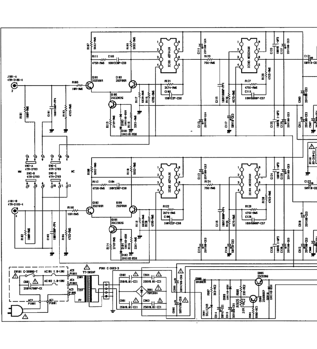

As mentioned on here, I'm planning on using the chassi of a Rotel RQ970BX and retaining the current power stage in the Rotel (with a steel divider installed) which gives +/- 17VDC. I'm wondering where best to pick up the VDC and remove the rest of the PCB? (Please see the schematic of the power stage)
