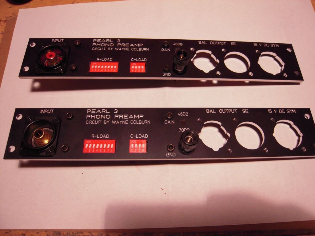

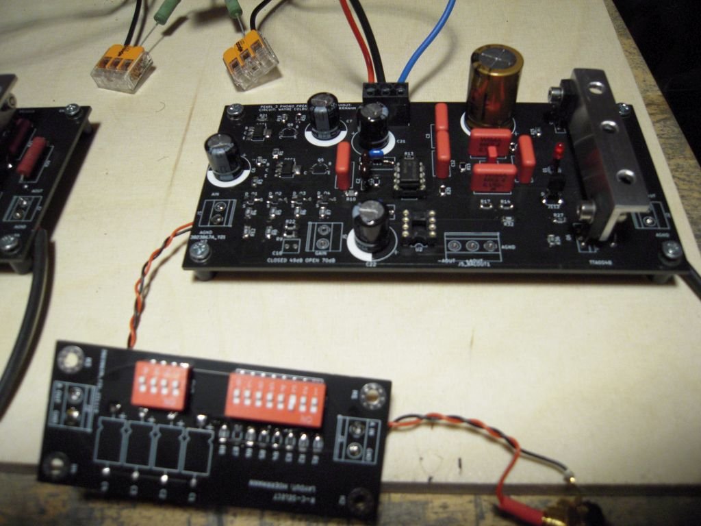

Sure:

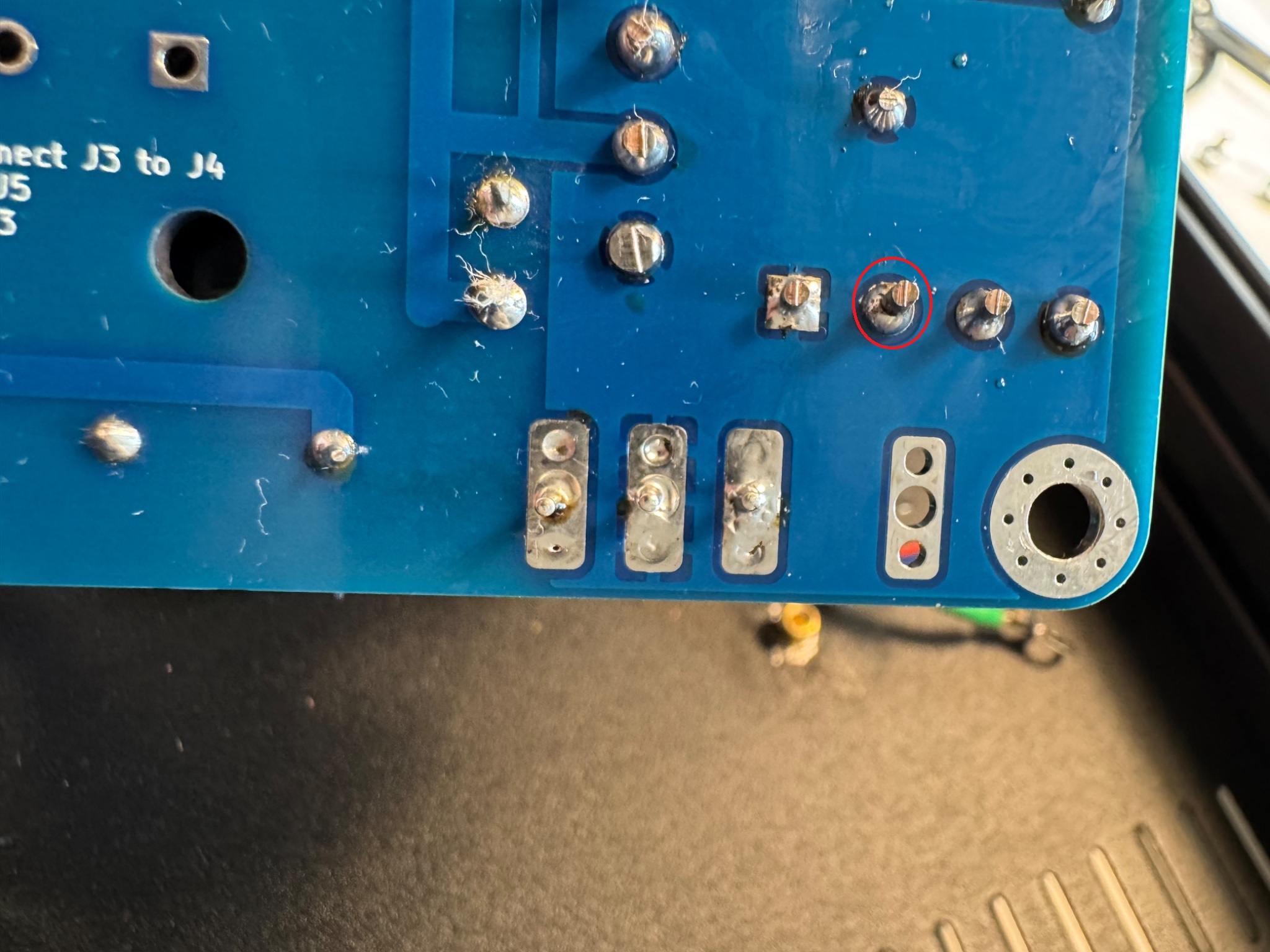

@rthatcher
Revisited my soldering of umbilical cord to XLR and it was a bit sloppy (working too late!) but i did not see a clear short. Added a little electical tape to the + / - pins for additional separation.
Test of umbilical to from female XLR plug to bare wires on PSU side showed 0.0 to 0.1 Ohm and continuity for concordant pins/wires (eg, #2 pin to +/red wire) and OL for other combinations.
After inserting wires into box on PSU board and testing with DMM probe via screws on top of box, the concordant wires / pins read 0.0 to 0.1 Ohms. Discordant pin/wire pairs readings were often unstable, but some readings of OL on repeat testing.
The soldering on the box looks good to me. See pic.
Next?

You should measure first between the pins of one end of the completely disconnected umbilical, there should be endless resistance.
Than, measure between the same pins of both ends, there should be zero ohms.
Also to check: pin one of the psu to pin one of the umbilical one end to pin one of the umbilical other end to pin one of the Pearl. Repeat it for every pin. And of course, after the smoke event, check the psu voltages.

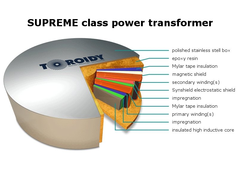

Hi All,
before making a next step (and not wanting to make a mistake... again...) a maybe dumb question: How close can two 20VA donuts be placed together? They are fully encapsulated, shielded, etc. ("supreme audio grade", see pic below). I would place them side by side - any issues to expect?
Many thanks!
see here, how to glue them best
Ok, progress, and next question.
Following rthatcher’s suggestions (and others), my umbilical cord generally checked out and my wiring to the various pins on XLR were correct.
So i tested the PSU with live mains using a cheap variac tonight and got both LEDs lit and about 25-26 V in each rail.
Dies this suggest no damage to parts on the board?
Should i proceed to next set of tests with the P3 elements?
Thanks to all for your input!
Agreed. Assuming voltages at XLR out from PSU are as expected, move on the RIAA box side of the umbilical cord. Is it soldered to phono boards? Simple test is take DMM and measure ohms from “+” on both sides - PSU board out and phono board in. Move on to - and GND. This test should make sure the pin connections are correct at the XLR. Also test for shorts between them. So measure between +/gnd, -/gnd, +/-

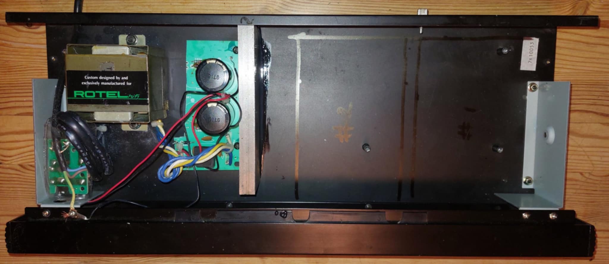

Made a start on the conversion of the Rotel into a Pearl 3. I've chopped the main board down to retain 2 x bulk caps and a couple of resistors. After the bridge there's +/- 30vdc which reduces to +/- 18.6vdc after the resistors that I've kept. That's where I'm planning to take the supply to the boards. I've installed a 12mm thick steel block as a partition between the tranny and the boards to dampen interference. The boards will fit snugly in the rest of the enclosure. It'll be fairly tight but doable. Planning to make a start on building the boards tomorrow...

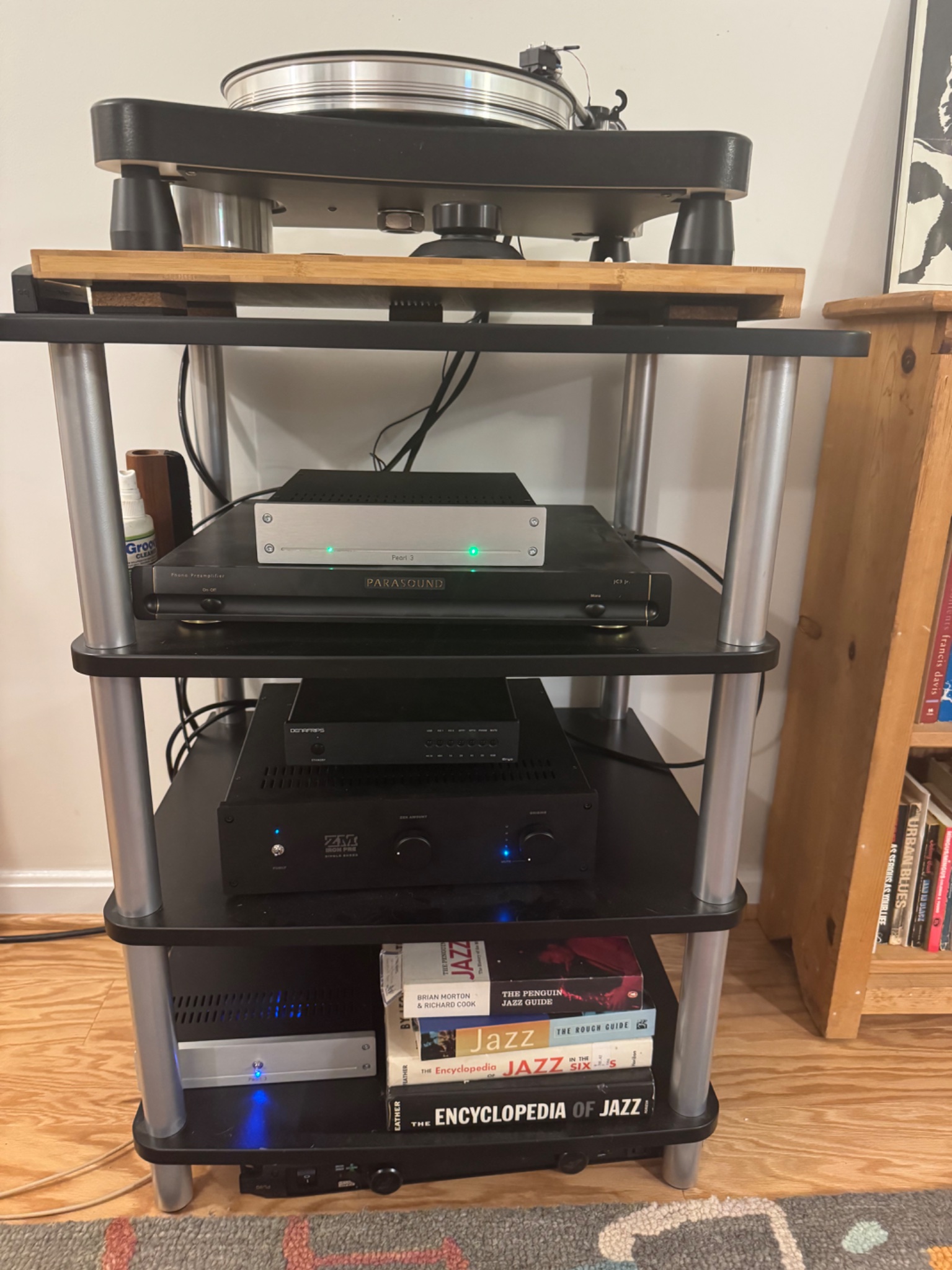

It lives — and sounds lovely out of the blocks!
Still need to tweak R27 to get it in spec (currently ~2.4V / 10mA). Will it sound even better then?
The green LEDs that came with need a change to Pass blue.
Thanks to all for your much needed help/support, in addition to Wayne’s huge generosity.
So much fun, when the smoke clears.
Chuck
