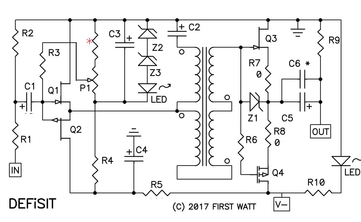

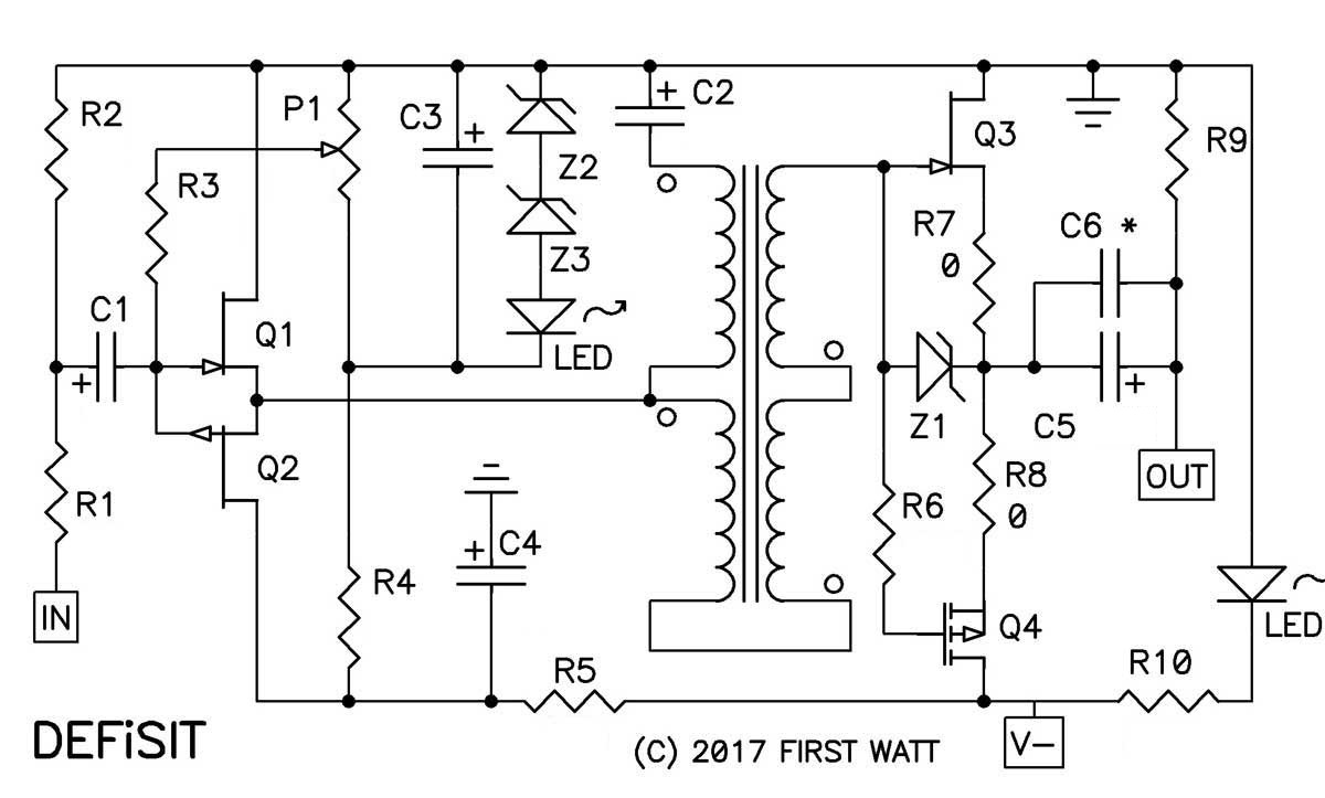

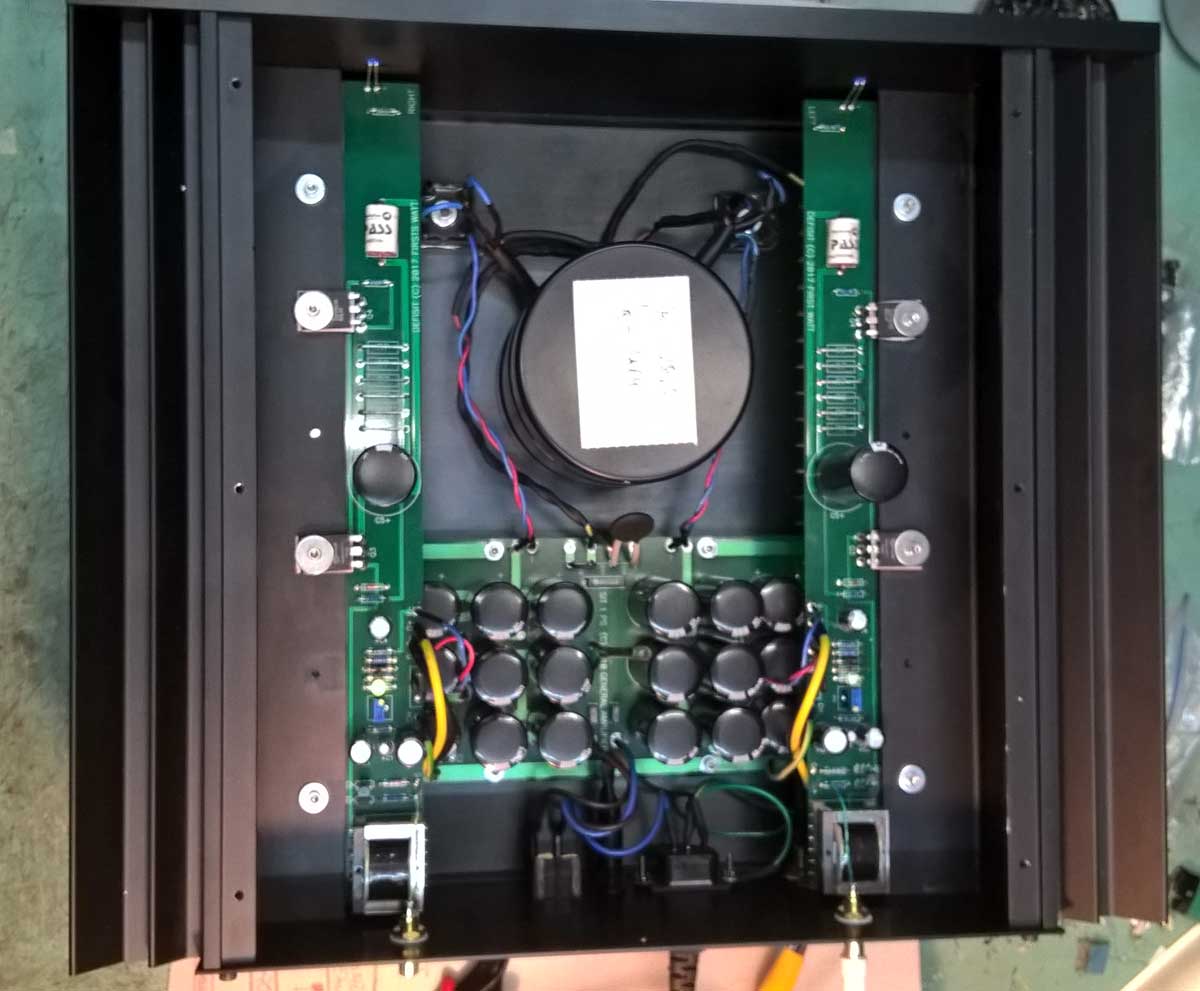

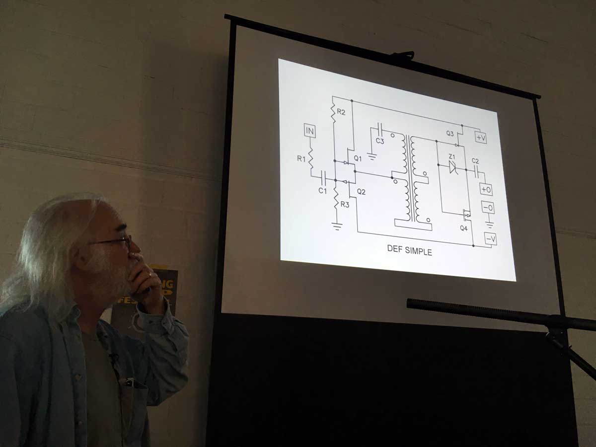

now – few pics from recent BAF....... Papalecture , DEFiSIT simple , DEFiSIT no values , Real MCKay one and two , little more detailed schm.

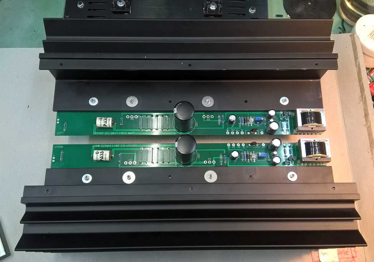

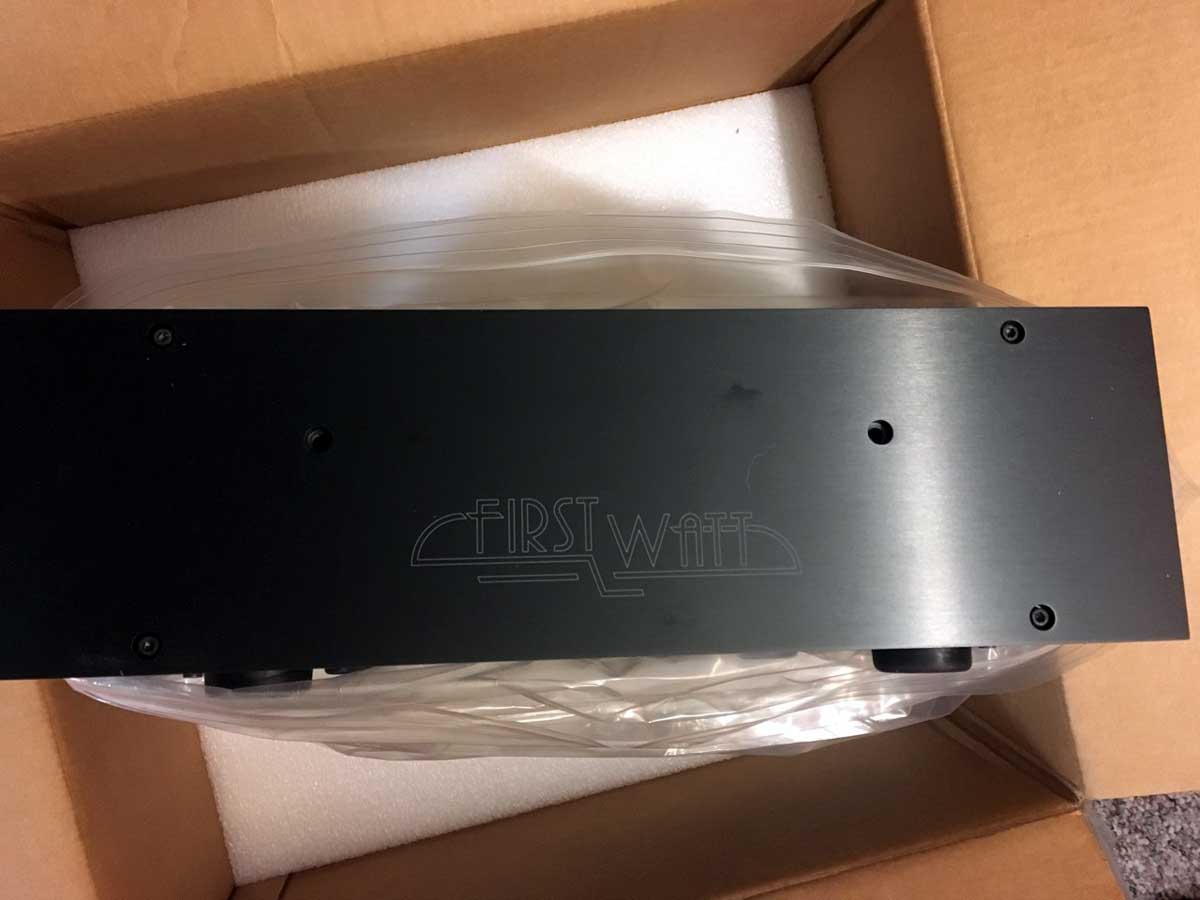

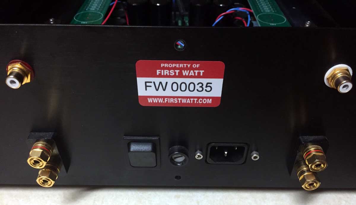

as agreed ....... what was really agreed is DEFiSIT kit , in most beaten FW case , as we know that Papa is using them for all sort of prototyping .....
well , he tricked me - case isn't beaten at all ..... :mad:
:D

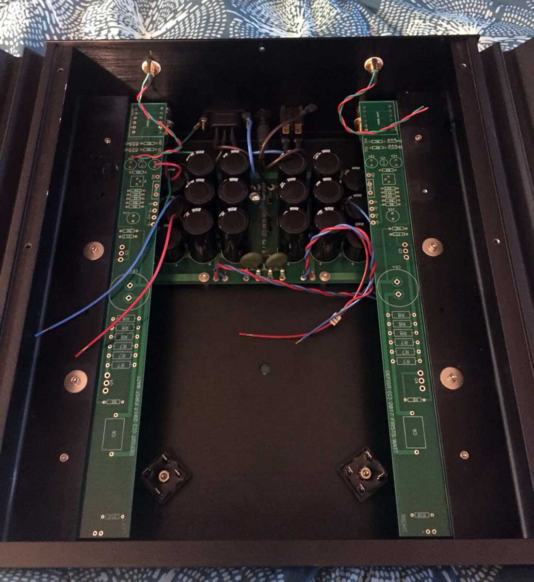

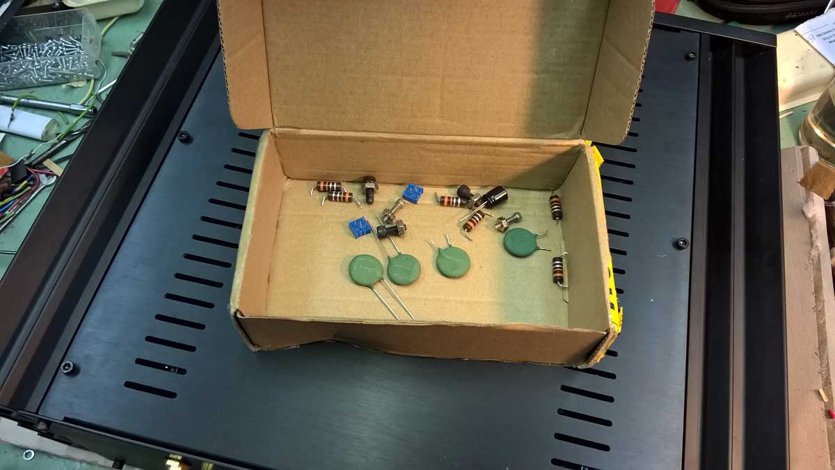

with lid opened (Pony Express rider is handy with Allen keys ) and itsybitsies in bubblie
Official Court Jester
Joined 2003
as I said - Kiddoe is handy with Allen key ;
per my instructions - everything is dissmantled in pieces , for better usage of suitcase space and for lesser amount of Customs curiosity , at arrival home ;
approach resulted fruitfully - Roentgen in Customs is still cleverer than operators :)

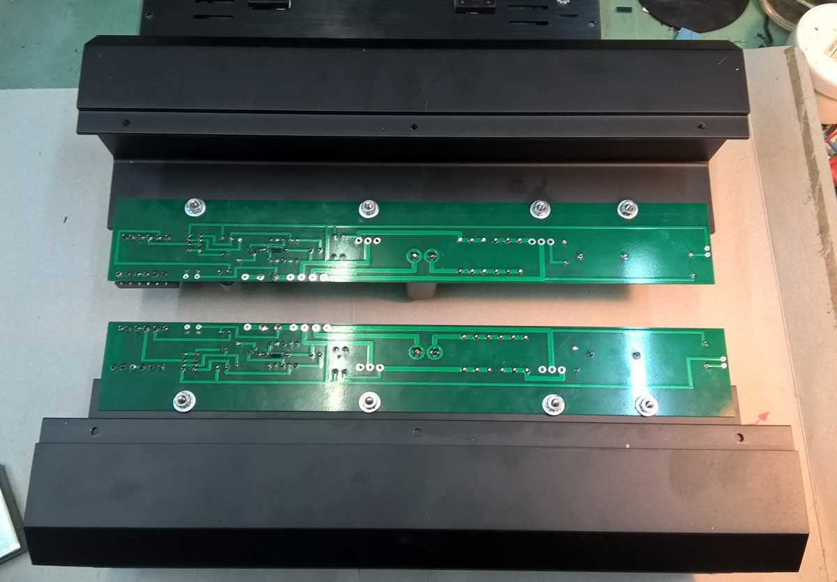

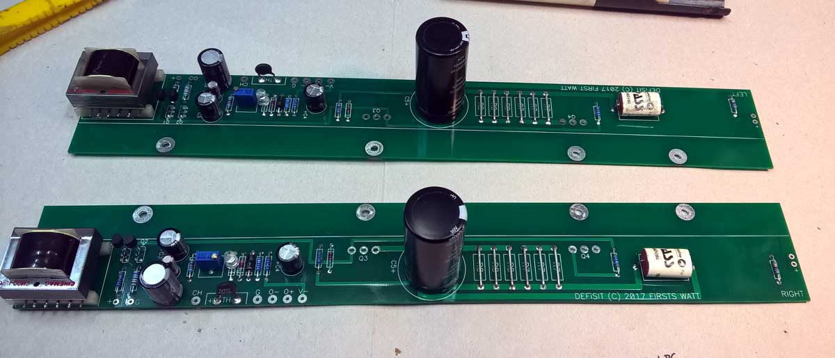

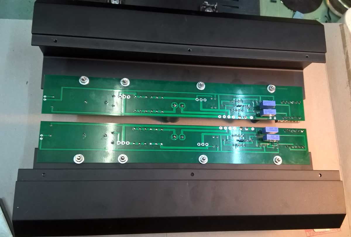

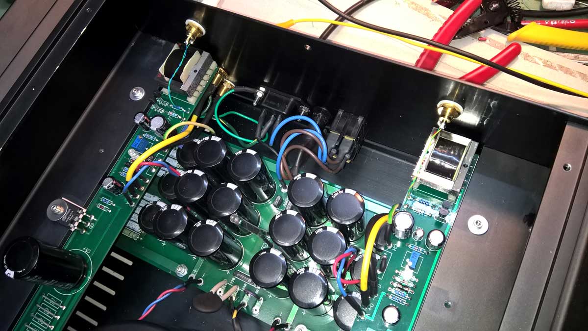

few days ago I started assembly/disassembly/assembly ;
Reminder : Assembly of Japanese bicycle require great peace of mind.

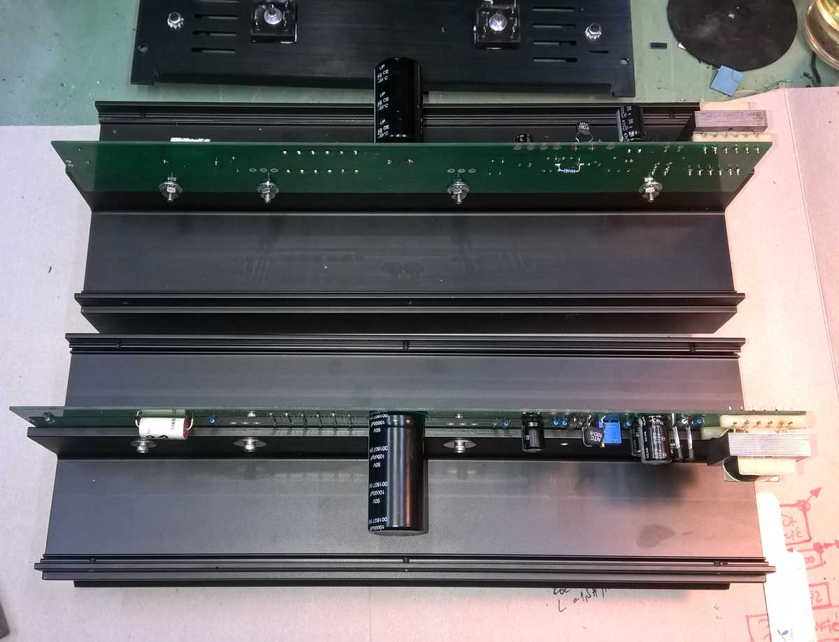

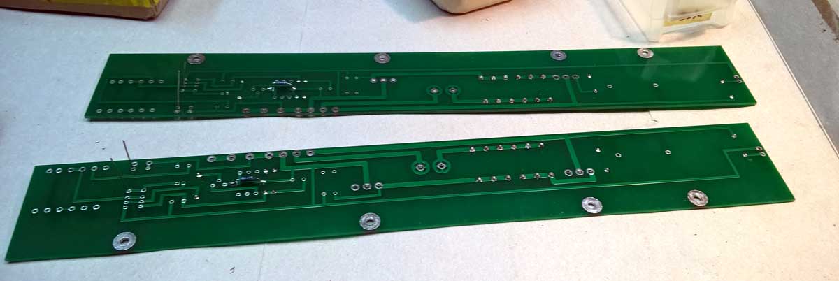

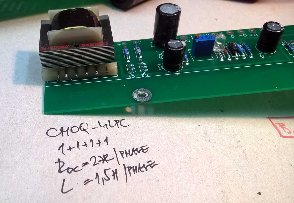

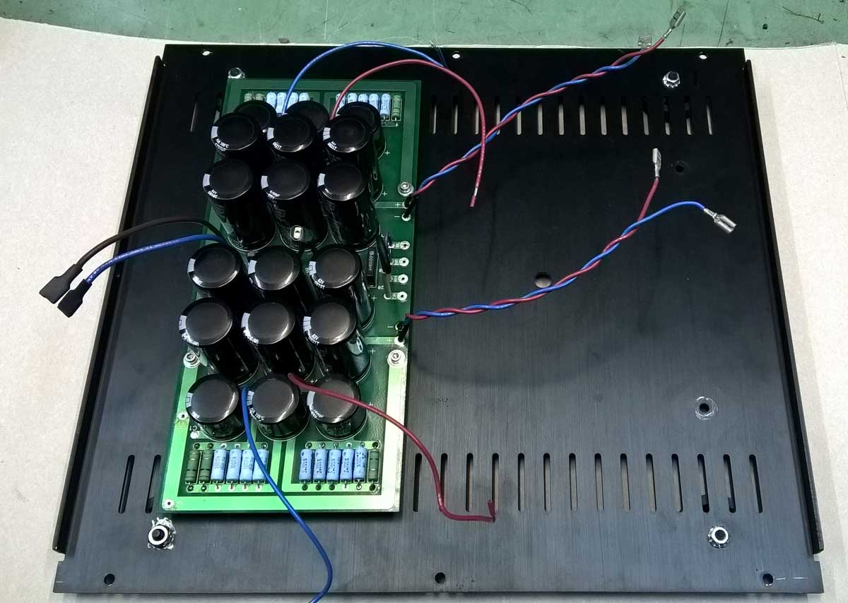

PSU pcb is obviously (same as in BAF specimen) from (early?) testing/production of SIT-1 ; and - Pa obviously used that pcb for some tests , and few power resistors in CRCRC are not same in channels (yup , dual mono PSU) ...... lucky me (again) , if not brain , I have great piece of mind , so I spotted that ...... also one cap per channel used in other purposes , now connected to other ones

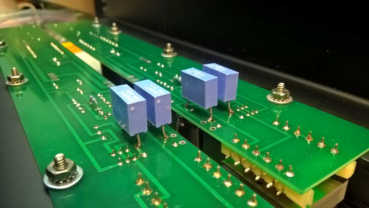

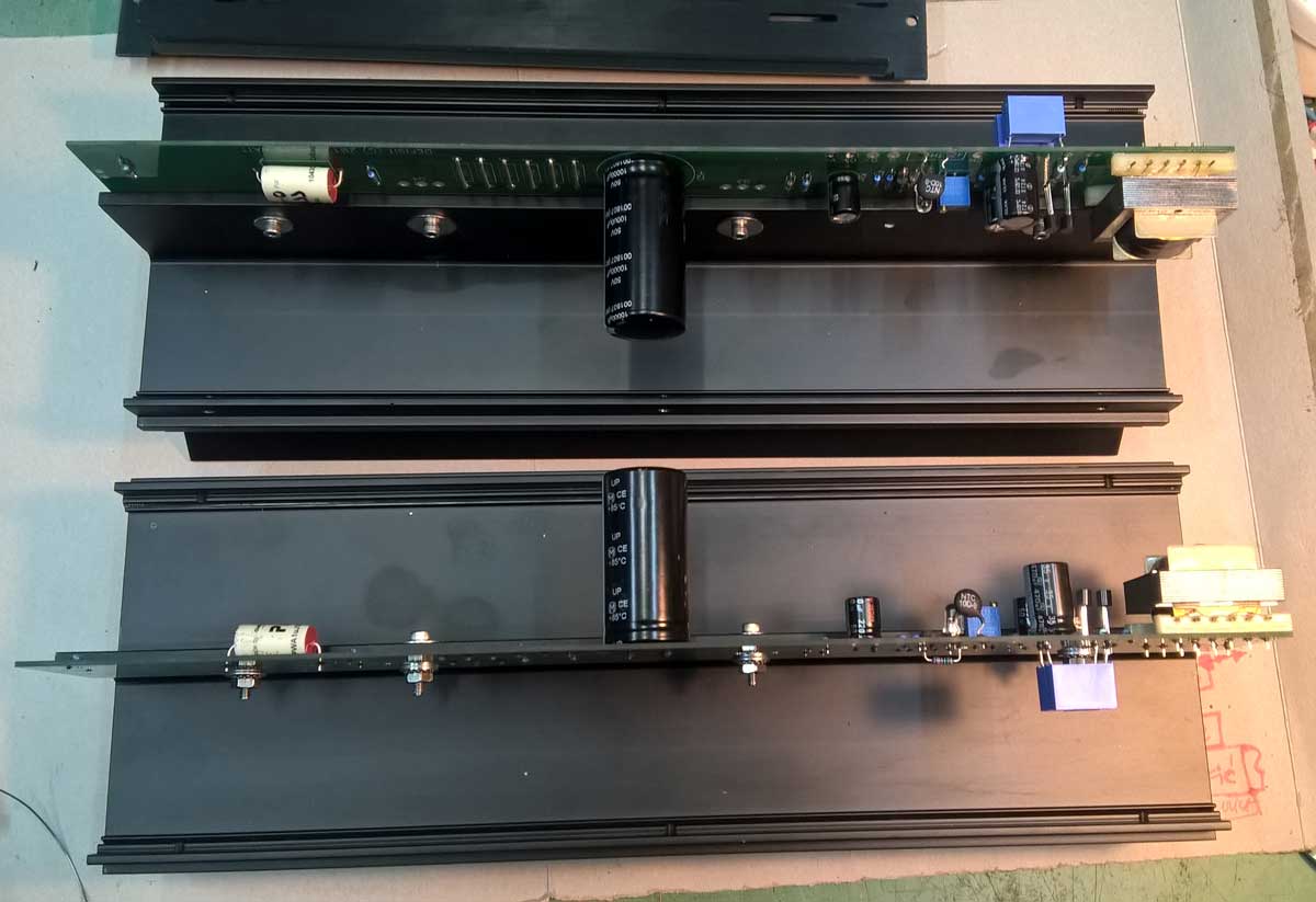

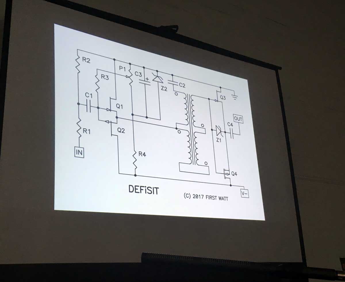

I'm not Fearless Amplifier Builder , as Papa certainly is ..... and I'm anyway used to make unnecessary changes to his circuits , so some trace cuttin' and one additional resistor , change of trimpot value , multiturn just because I'm Chicken :D

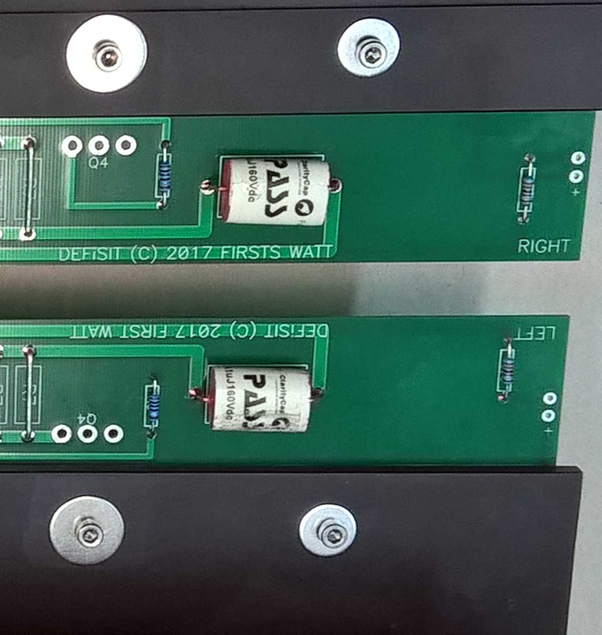

just from habit - my fave Philips 1uF MKC , as bypass on C1 and C2 position
did I wrote that Papa sent all caps in bubblie ?
....... more precisely - all parts , except small metal films :hypno1:
I also changed C2 to (also) my fave (125C , so industrial?) ELNA 470uF/35V

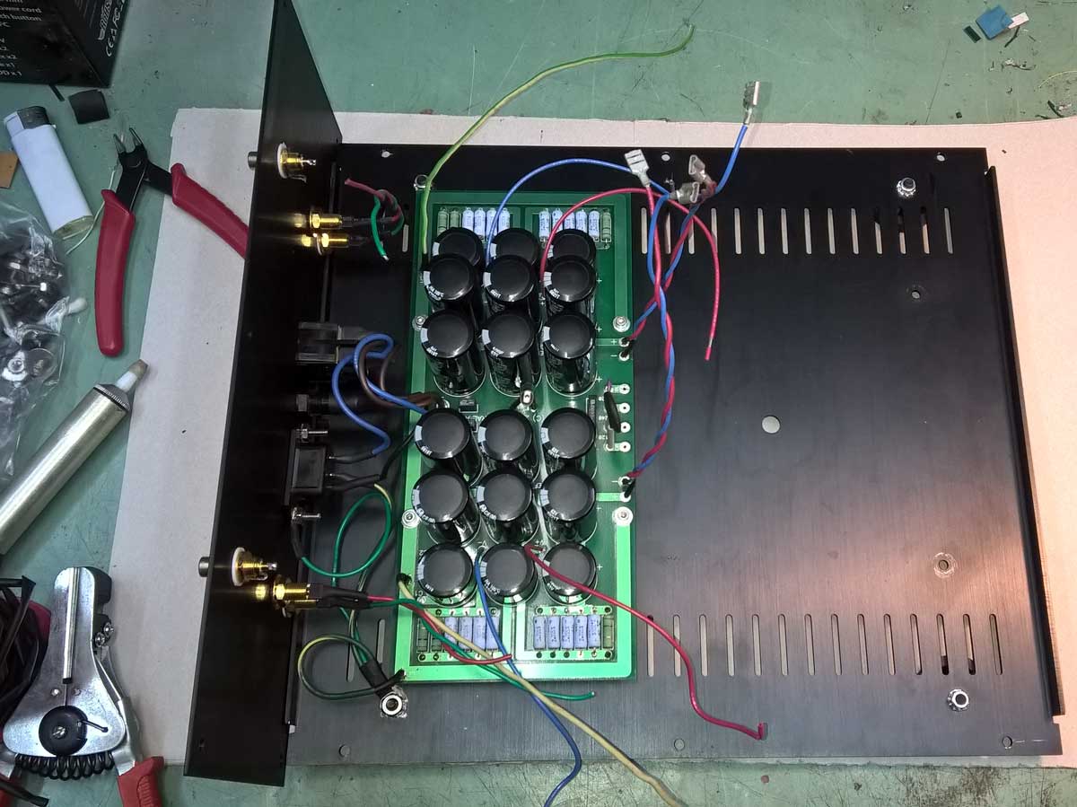

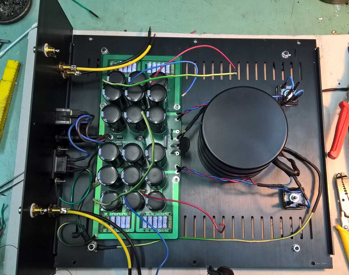

Ok , Donut time ;
He sent me schmtc , but he didn't wrote about rails value ; after several emails (yup, me bugging again) , I finally got that name of the game is PapaSit's sweet spot ...... so set voltage and SIT will sit in proper current
:rofl:
Donuts- I have them zillion years , never had some use for them , until now
potted , shielded ; had to drill bottom Donut all through (careful with that Axe, Eugene .... it's easy to make a short , so drill bigger hole in shield pan on top)
50Vct , so CT going to GND on PSU pcb , while start and end of secondary are connected to just two diodes of Graetz bridge , routing neg to neg PSU input

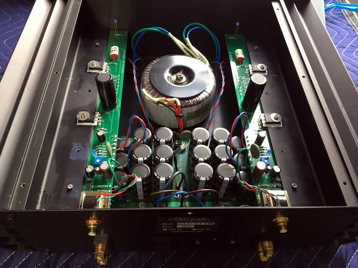

gene/dummy load/CRO routine done , everything as prescribed
nothing unusual , so no pics of that

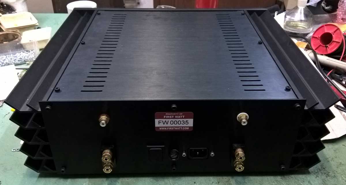

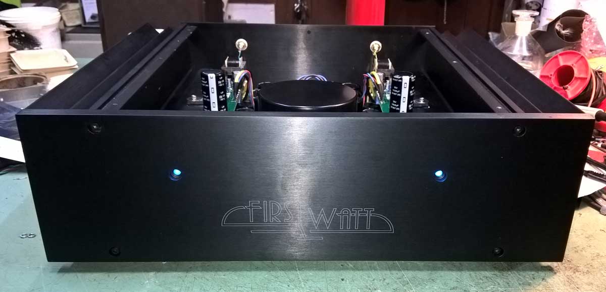

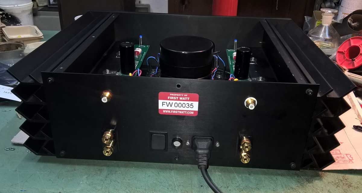

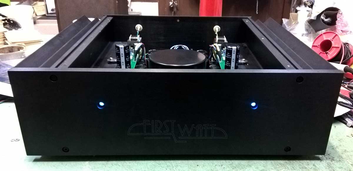

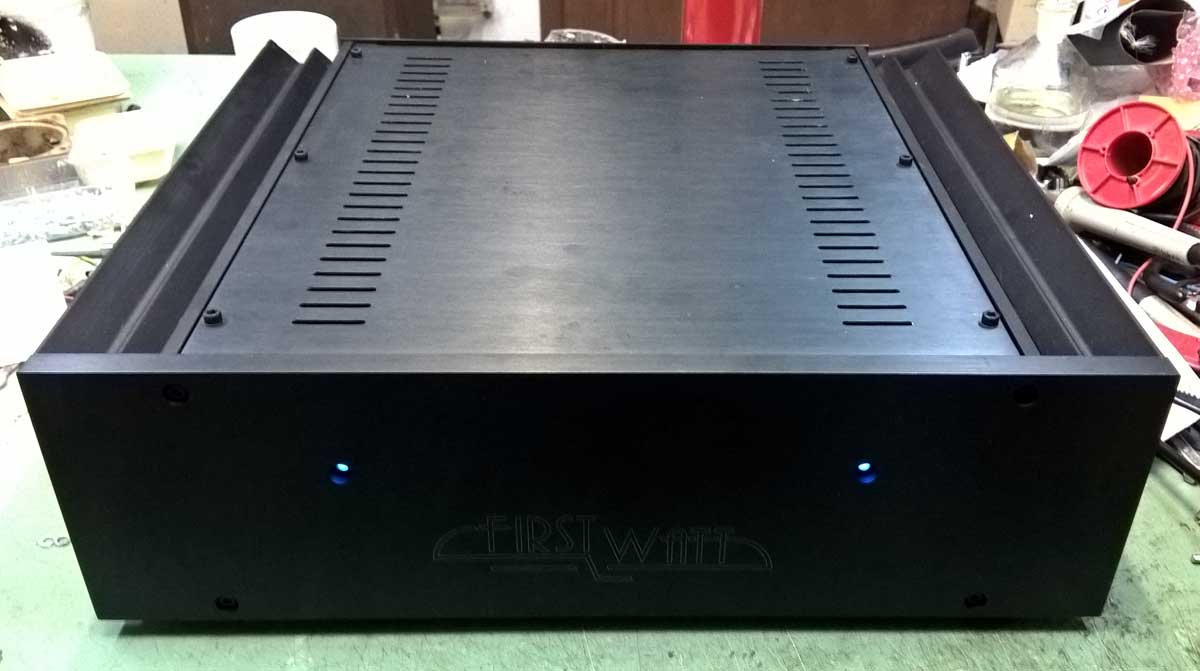

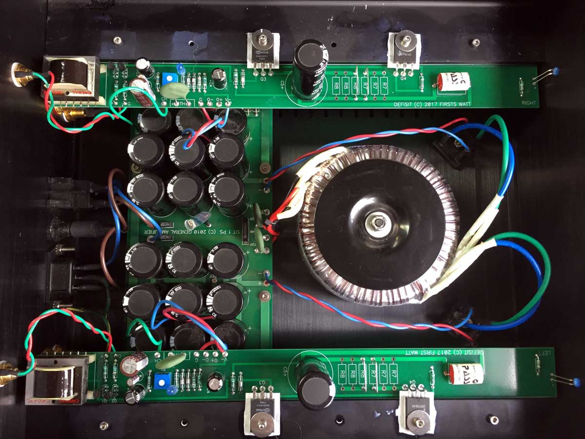

cooking time , final pics
tomorrow first listening hours :)
