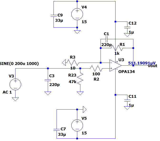

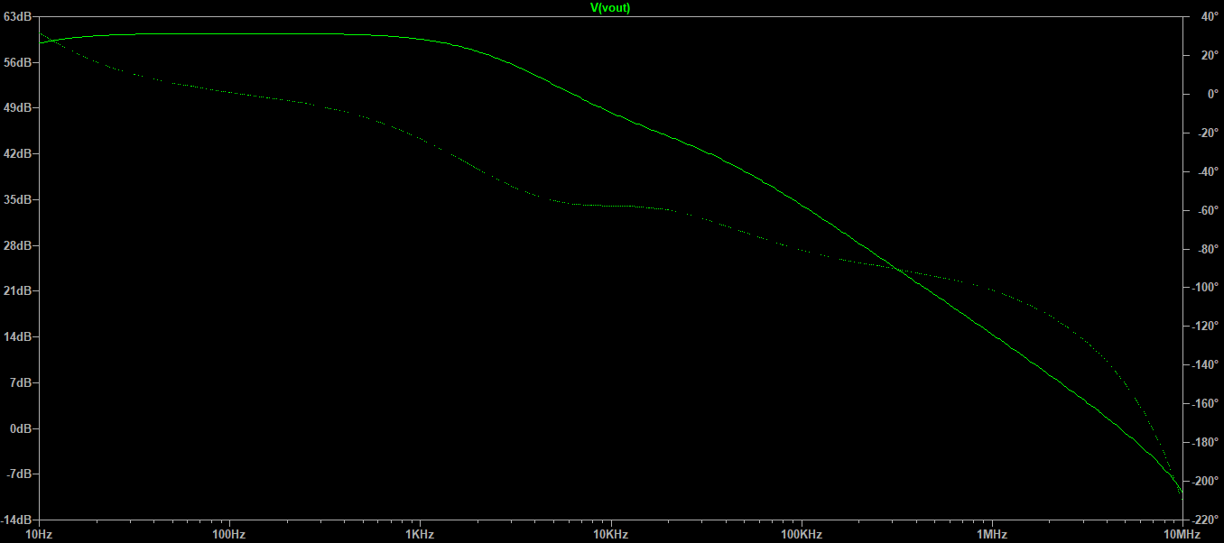

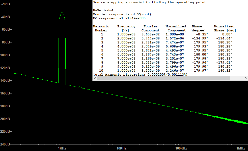

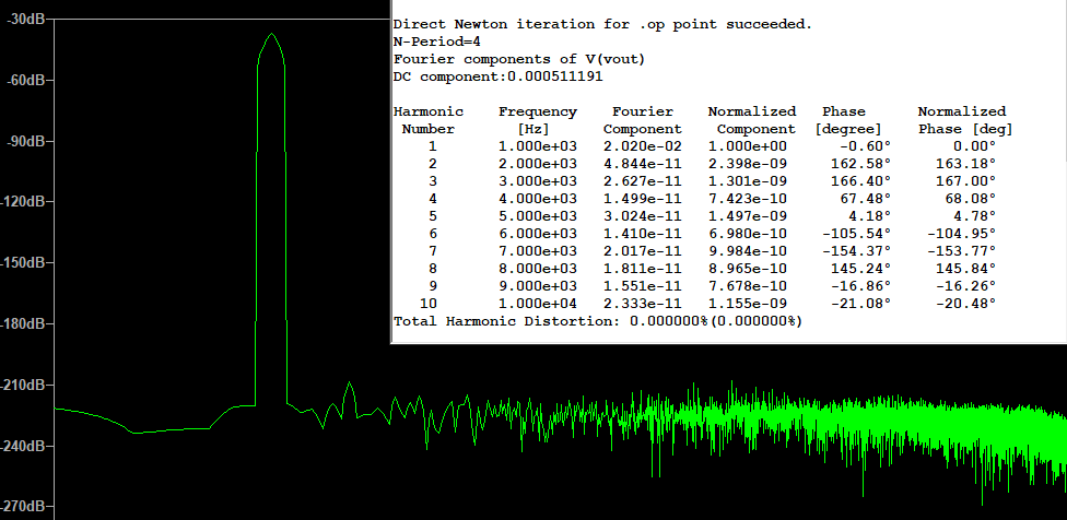

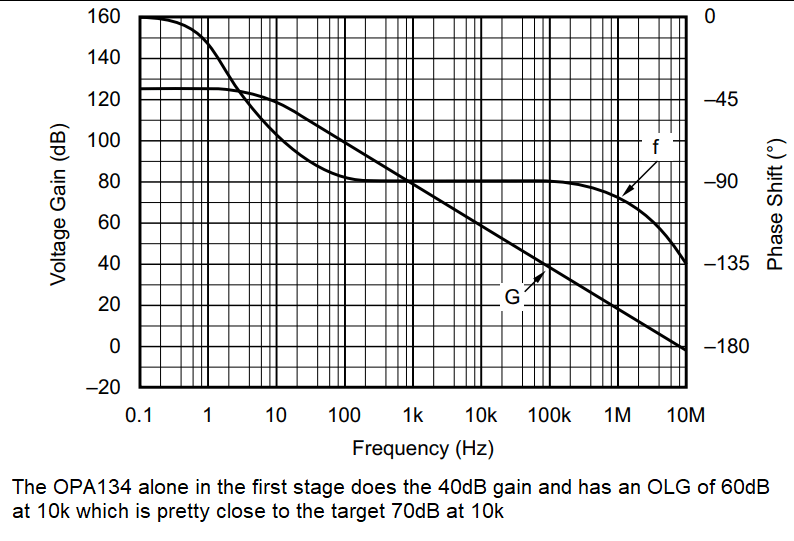

Pearl 3 is a very enjoyable phono preamp, nice voicing, not too resolving as to make one hear the imperfections of the cartridge, tone arm and turn table and also not too vague as to have a veil. Here's a comparison to direct OPA134 pickup.
Pearl 3 fourier 1k above
Pearl 3 OLG 1k above
bare OPA134 pickup fourier 1k above
OPA134 OLG above, load 2k
OPA134 bare pickup above
