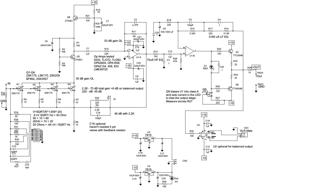

So I don't think you need to worry too much about Pearl 3's PSRR.
Supply noise is negligible; it is completely dominated ("swamped") by cartridge noise.

So MM cartridges with 5mv output needs better PSRR to get same relation between cartridge noise and PSU noise......
Three orders of magnitude. (numerically 1E-7 / 5.6E-11 = 1780x). PREAMPGAIN varies less than that across the bandwidth. It is a foolish play to bet against Wayne.
If there are three orders of magnitude margin designed into the power supply filtering built into the Pearl 3 why did you design a external power supply with multiple layers of filtration to use with it? Given a separation between the transformer(s) bridge rectifiers and the pre-amplifier is a good idea. Now you are using affective logic (foolish play) to argue against your own work.

the correct way to measure PSRR is to remove the input capacitor. I am measuring the cap multiplier in isolation. before you run the test do a calibration run.I am looking at your PSRR plots and thinking that you are testing the input stage of the Pearl 3 pre without the 7815 regulator between your bench power supply and the input stage capacitance multiplier.
The reduced PSRR of the Pearl 3 is eye opening.
I wouldn't say it is eye-opening, it's just there ... because Pearl 2 uses 3.3mF and Pearl 3 uses 220uF plus a 100 ohm resistor (R21) on the base of Q8.
Jack, maybe consider simulating with a Jacked-around .MODEL of the ZTX851, setting "VAF" (-1 * Early_voltage) to 267 instead of 158. Since our actual measurement of Early voltage is 267 not 158. See post #291 of this thread. With higher ZTX851 Early voltage, the input stage's noise filter circuit (which includes Q8) will get better. And perhaps this may embolden daydreamer designers to wonder "could we drop in a different Q8 chosen for extremely high Early voltage?". Or perhaps not.

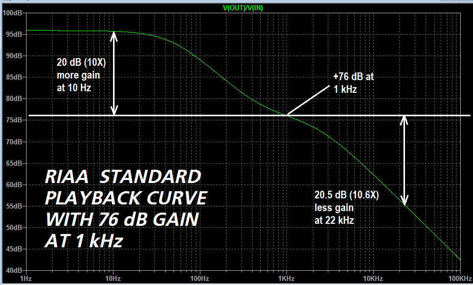

Here's what an ideal RIAA-conforming playback curve looks like, when the gain is set to 76 dB. There's one order of magnitude higher gain at 10 Hertz, and one order of magnitude lower gain at 22 kilohertz. For simplicity I've omitted the lowest LF pole / warp filter / DC offset nuller.

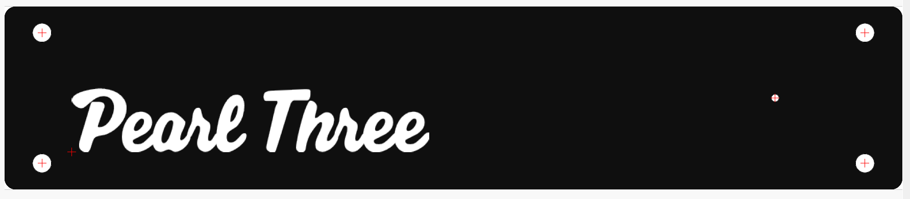

Here's a faceplate concept I've been playing with. Made in front panel designer, using a font that's free for non-commercial use. Except numerals, which are not free. I might see if Gianluca can make one for me.
