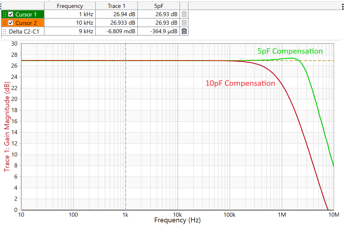

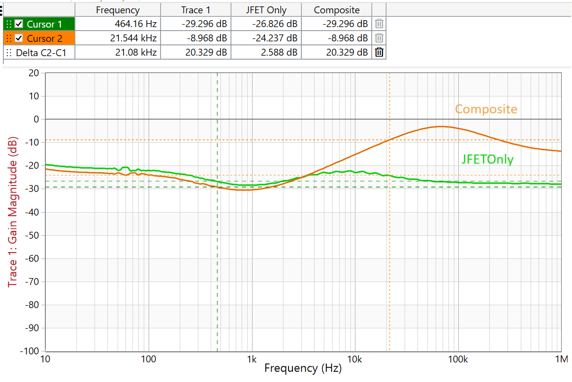

I should be outside raking leaves, but... I show the PSRR for the JFET only, and the composite amplifier. Gain is 27dB.
Also shown is the effect of the compensation capacitor on U1a. In this case LM4562

Jack, that zero line does that signify 'no ripple/noise breakthrough' being infinite PSRR?I should be outside raking leaves, but... I show the PSRR for the JFET only, and the composite amplifier. Gain is 27dB.

The Zero Line represents the signal impinged upon the positive rail transmitted in its entirety. Adjust for 27dB of gain and PSRR is ~57dB @1kHz.
I used 2SK170GR running @2.6mA, 26mS

To create the data in the charts below, I used Q5 to drive a 1.5k resistor rather than the 4x LSK170s. The Pearl 2 uses 3.2mF caps whereas the Pearl 3 uses 220uF. I repeated the trials many times and would certainly appreciate anyone else repeating.

I am looking at your PSRR plots and thinking that you are testing the input stage of the Pearl 3 pre without the 7815 regulator between your bench power supply and the input stage capacitance multiplier.
The reduced PSRR of the Pearl 3 is eye opening.
Also thinking that CH 2 of the Bode 100 samples the input stage voltage at the collector of the bottom ZTX851.
Please correct me where/if I go wrong.
https://www.omicron-lab.com/fileadmin/assets/Bode_100/ApplicationNotes/PSRR/App_Note_PSRR_2_0.pdf
I am planning to assemble a couple of breadboards; one with 7815 and 7915 regulators on board, the other with the P3 input stage to drive a 1.5k resistor in place of the JFETS. Then measure with belt (regulator), suspenders (capacitance multiplier) and both together.

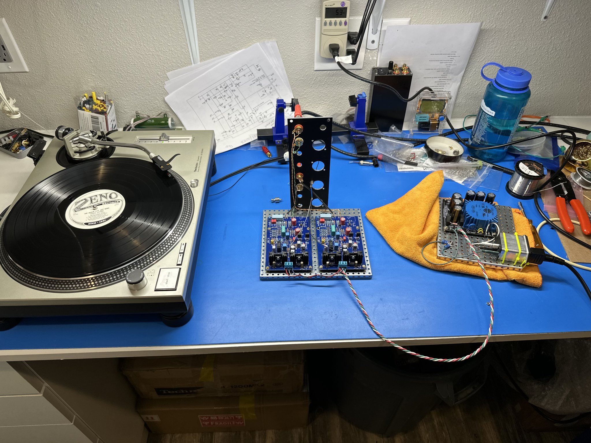

Hi Jim, out of curiosity what cartridge are you using on the Technics? Looks to be an Ortofon, but which model? ThxAdventures from the bench. This sounds fantastic, even in the not-even-close-to-optimal lab “chassis” made from some random panels in my closet.
In that photo the -1200 has Ortofon OM10 mounted.
Main system currently has AT-OC9 Moving Coil, which is working wonderfully at this very moment with Pearl 3. Also have been playing with the new AT-VM95SH which is a fantastic cartridge and punches so far above it’s price class it’s crazy.

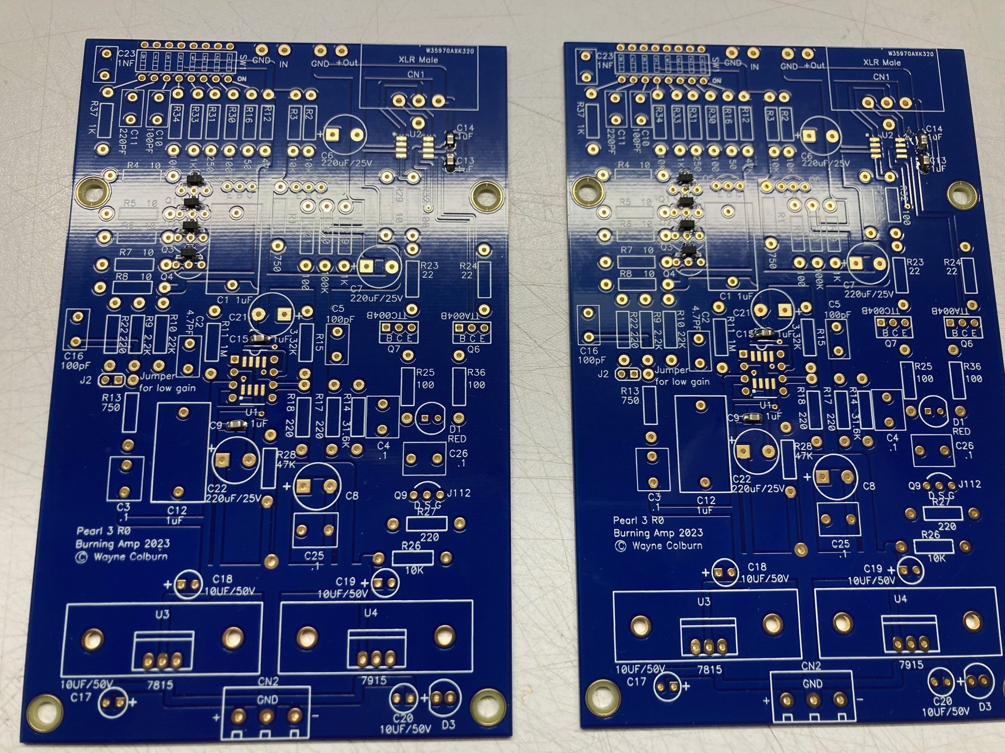

Got the little guys soldered. Helpful tip from @6L6 was to check the voltage drop from gate to source and gate to drain of each little guy, to make sure they got soldered correctly & not cooked. A good exercise, I got 0.680V gate to drain, 0.691V gate to source across all 4 on 1 board; 0.679V and 0.690V across the other 4 on the other board.
I can’t take credit for that as I was chatting about testing soldering continuity a week ago with @thomasnadeau , and he remembered that Jfet will measure as diodes from Source to Gate and from Drain to Gate…
So on this PCB you can set your DMM to diode test, place the red probe on the through-hole pad for gate, and black probe on through hole pad for Drain, and then black to the pad for Source. In each instance if it shows about 0.7v from D-G and then S-G, you’ve verified that 1) the SMD have continuity to the pcb, and 2) you don’t have blown jfet. Cool!
