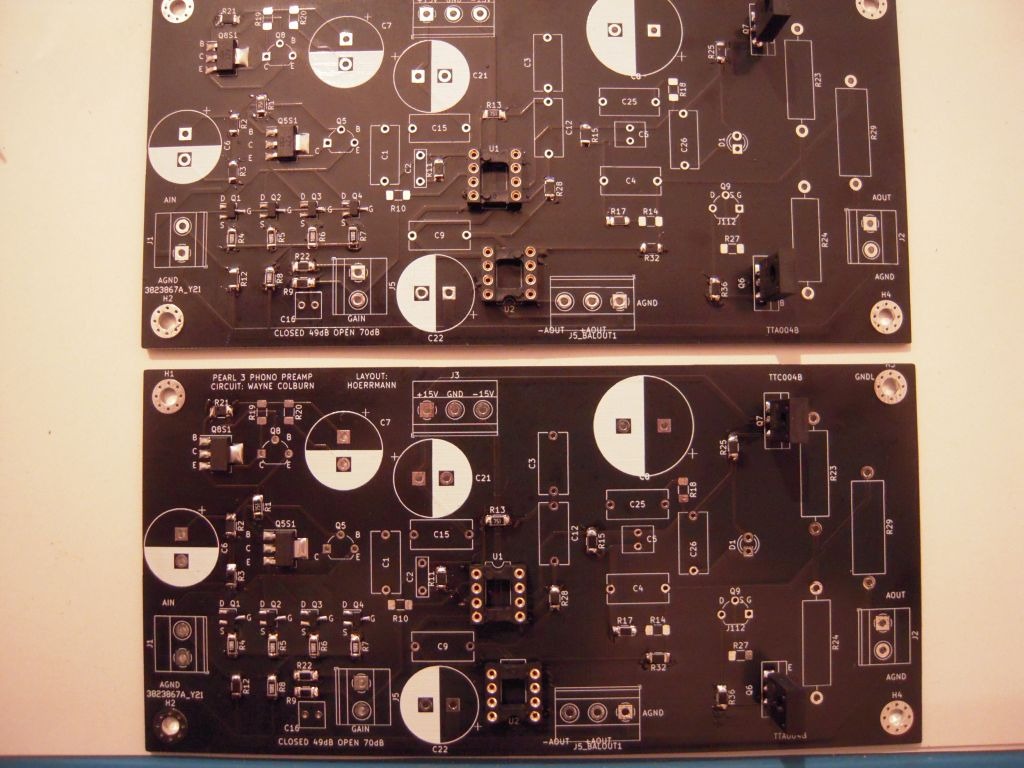

Hello PEARL 3 - builders,

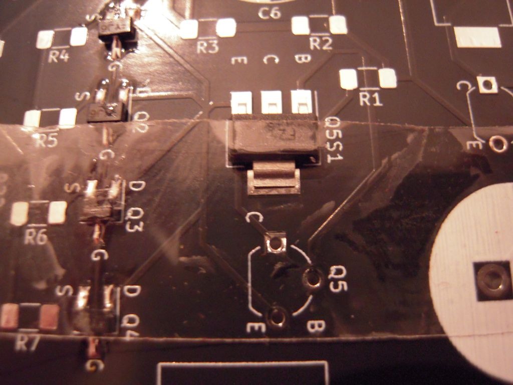

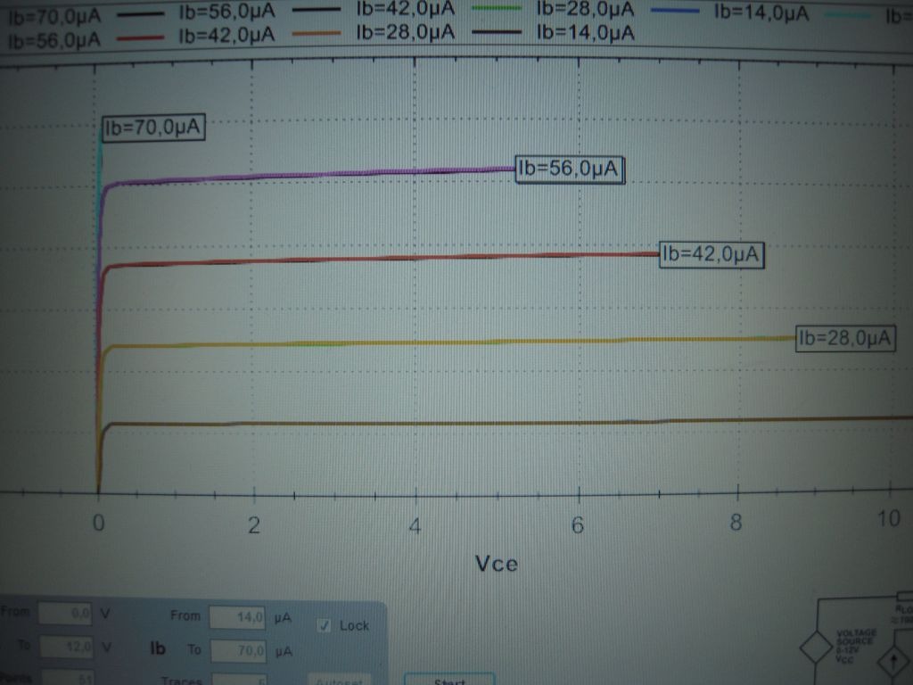

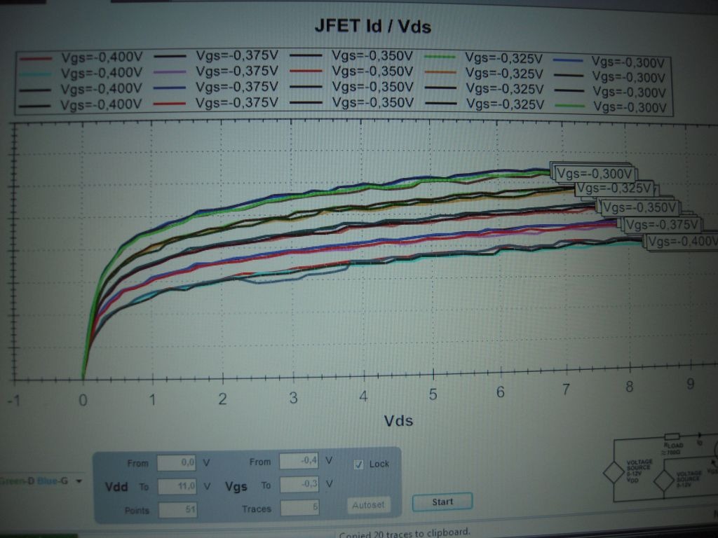

I've got my pcbs (selfmade) today and started to stuff them. Last few days I matched an octett of ONSEMI 2SK2394 (super low noise JFets, high Yfs; small Ciss). I needed around 70 JFets to find this octett.

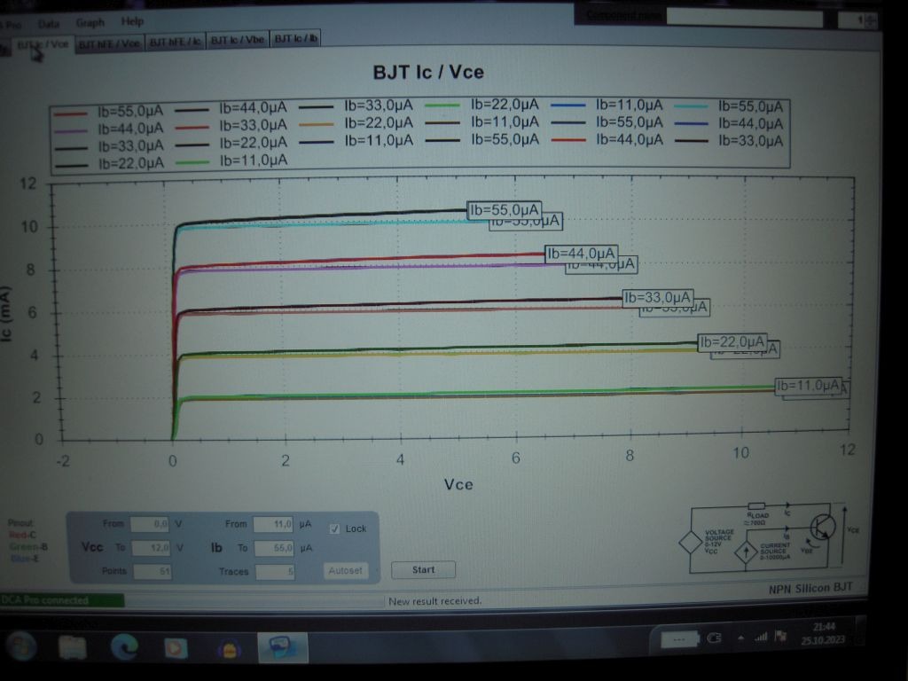

I also matched two pairs of ZETEX FZT851 (Q5/Q8) for left/right channel equality... On my boards I have the possibility to use through hole- and SMD-
BJTs in the Q5/Q8-position. Necessary? - No!
I used the well proven 'adhesive-tape-technology' to solder the SMD-transistors. I think 6L6 showed this technic as the first?
Waiting for a lot of parts. Will continue slowly, but continously. 🤔
If available, I will also buy a pair of original boards from the store.
And I will also try a version with TOSHIBA 2SK209 GR -JFets. Seems to become a project?
Have fun!
