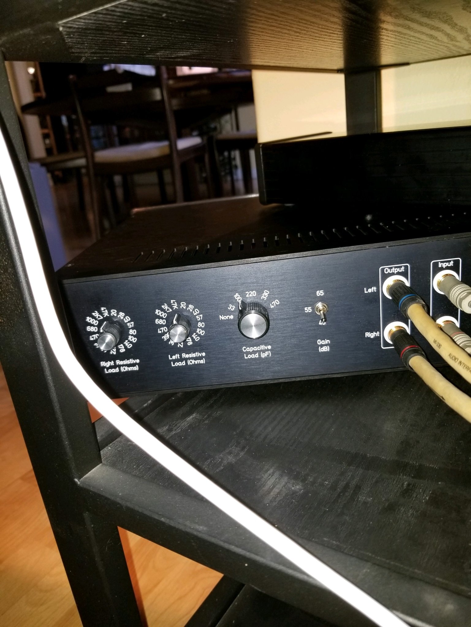

BTW, You Know Who... take a bow... take claim to the build if you want... not my build, I just, ahem... enjoy the hell of it.. Thanks. My only concern was that the knobs and switches are on the back panel.... sort of a very unassuming box until you look at the rear.
BTW, the Grado's moving iron design is impervious to load capacitance. That factory told me so... I kept it at 100 pF because that's where I've kept Grados for like 20 years ( previous CJ PV9 is set that way by default ). Maybe I ought to try 'none'...
My old xp-15 and current Xono clone work with at 0.25mV ZYX cart. So the P3 at high gain should be a-ok, too. Same gain spec at the Xono and XP15
^ great to hear.
BTW, I posted that picture of the back panel because, let's face it, that work for the P3 is done. Just reuse that design. It works very well.
For the cheapskates go with the DIP design... but for those of us who really like the convenience, and better BOM, use THAT design. It looks, and works, very nice.

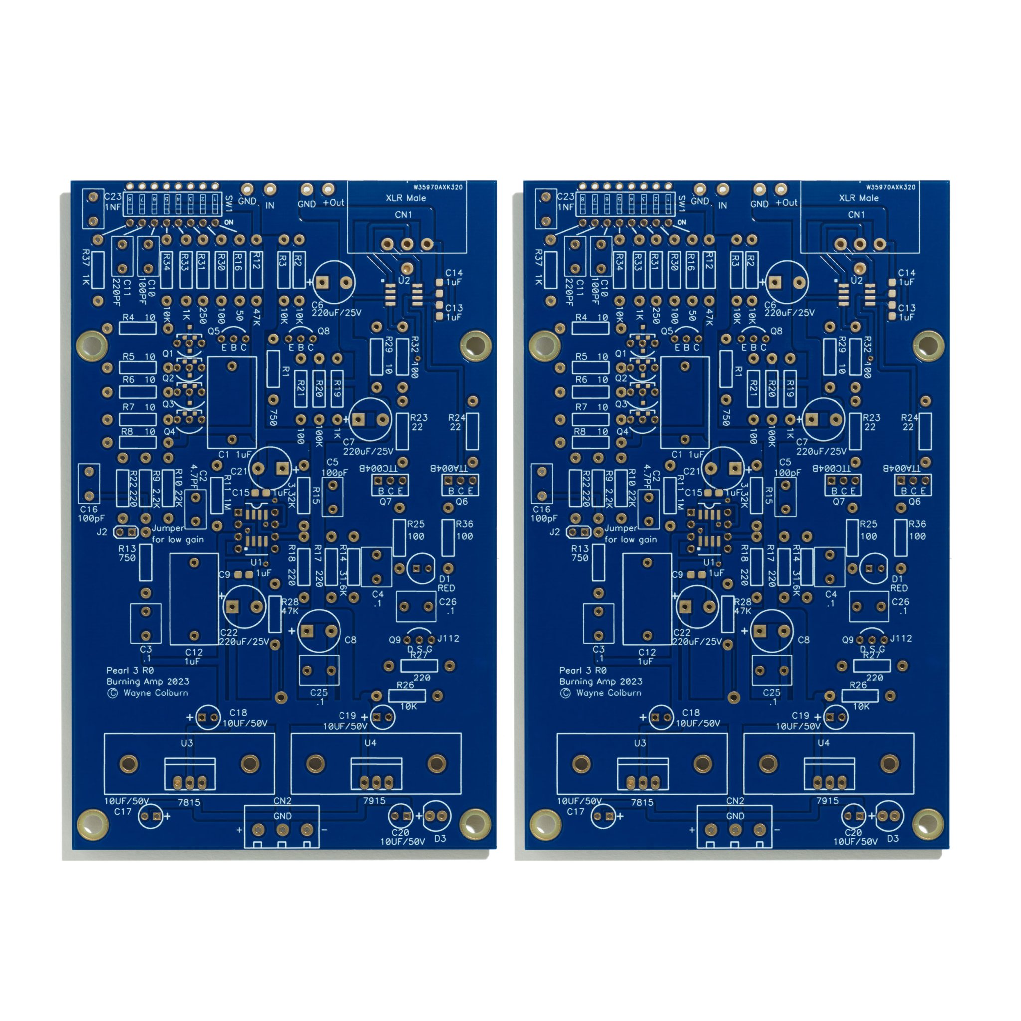

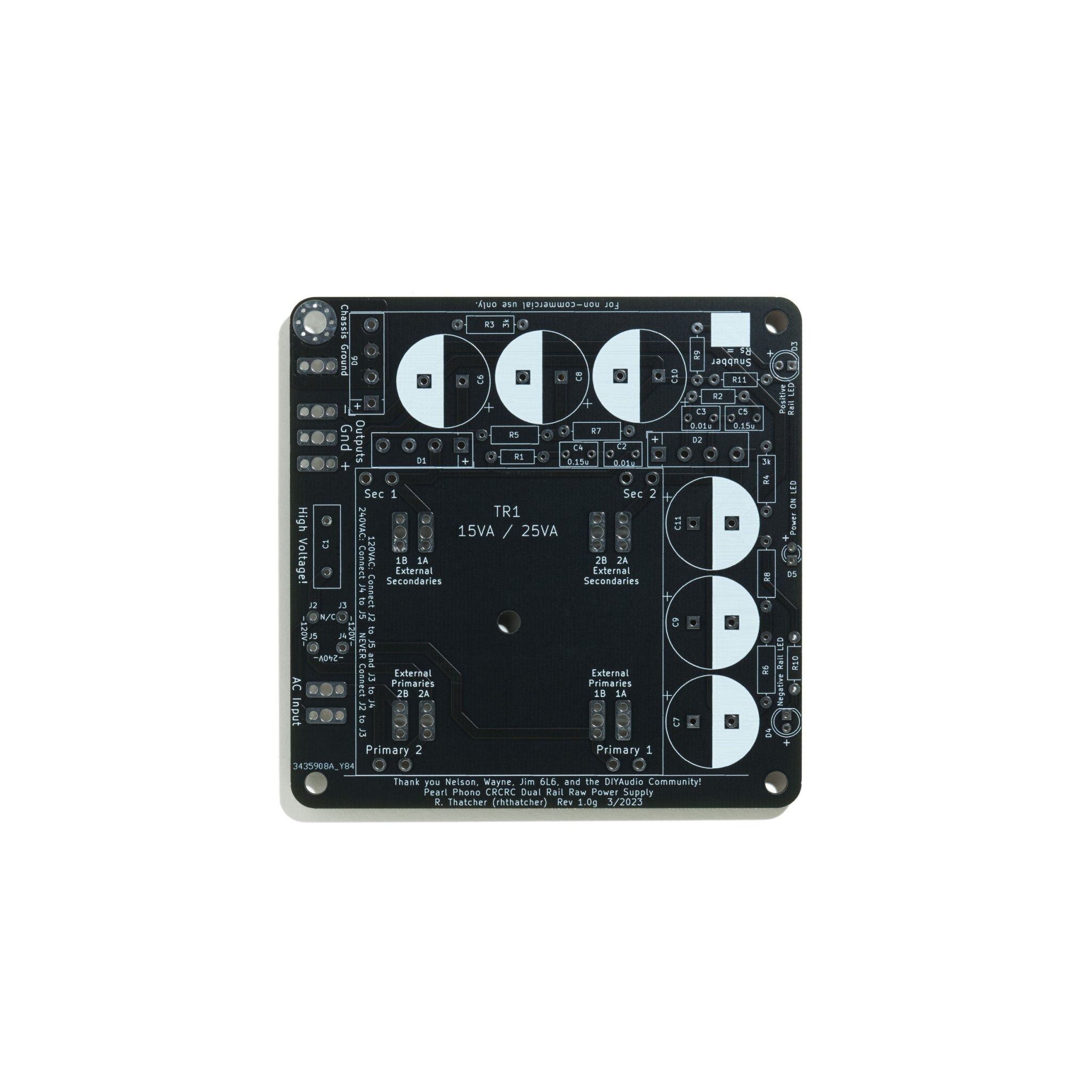

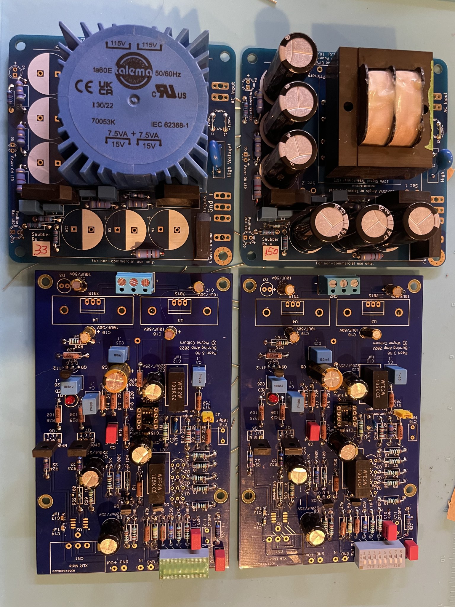

Some relevant art. (I understand production PSU PCBs will be blue.)
Looks incredible!!

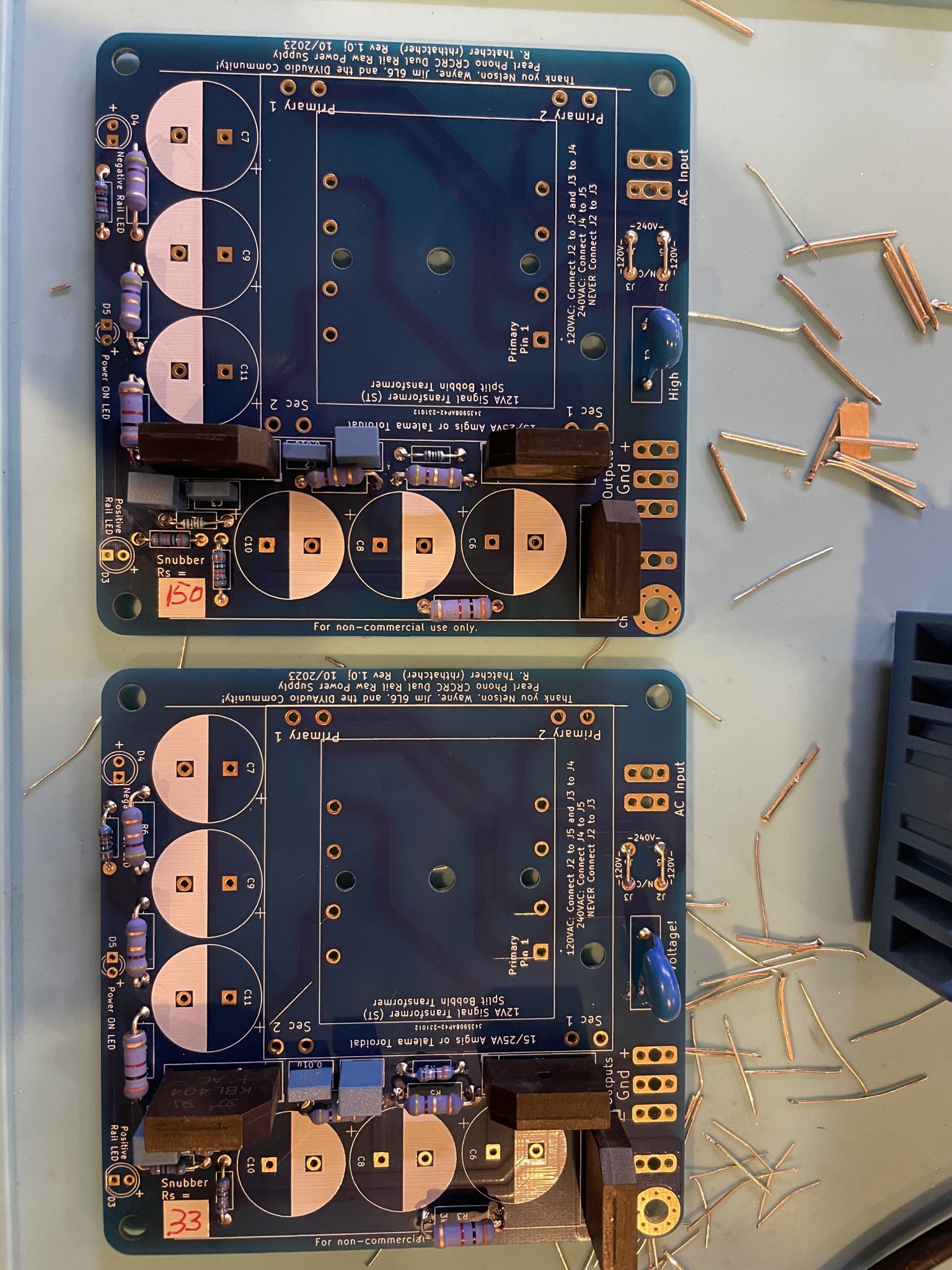

Not quite the final PSU board, but very close. Newest revision has room for an alternate transformer. So cool.

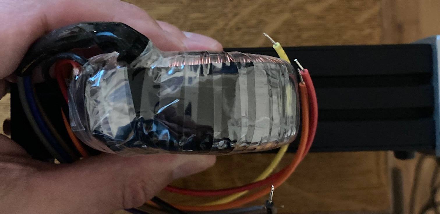

The contenders for transformer testing. First stop will be the Quasimodo jig.

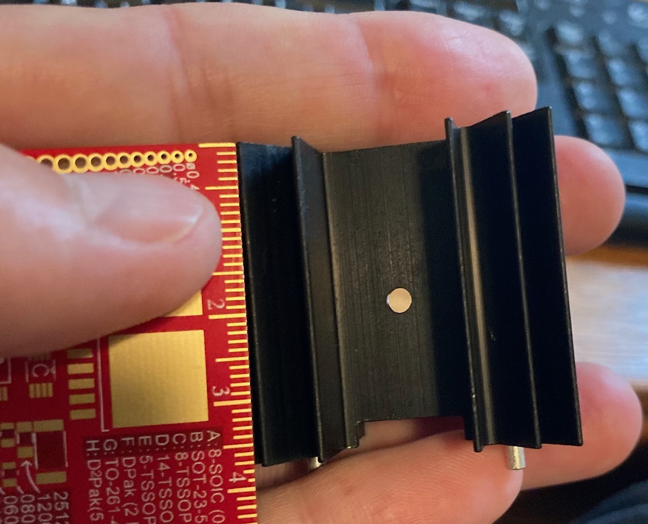

Hey what height of heat sinks were people going to use? The ones I have, which I thought were a standard short size, are 37mm tall and won't give one room for the PCB and it's standoffs inside a 1U case.
1"
531002b02500g
https://www.digikey.com/en/products...1216358?s=N4IgTCBcDaIKwGYCMAGFYBG65oOYgF0BfIA

Regarding the chassis….
Jim 6L6 and I are working with Gianluca at Modushop on a couple of design options that will be prototyped. We’re starting with 1U height galaxy with a 2 box solution (RIAA and PSU) and a one box solution. All with custom faceplates are back plates. We should have first pass drawings for review shortly. Stay tuned.
I think the future plan will be that you can reach out to modushop and order a Pearl 3 chassis kit. This is similar to the concept for ordering the IronPre chassis.
While the Modushop chassis is being made I plan to temporarily test in a spare linestage chassis that I have. It’s a one box unit with a wall in it.

Will there be two PSU-boards in a kit?
One for each channel?
