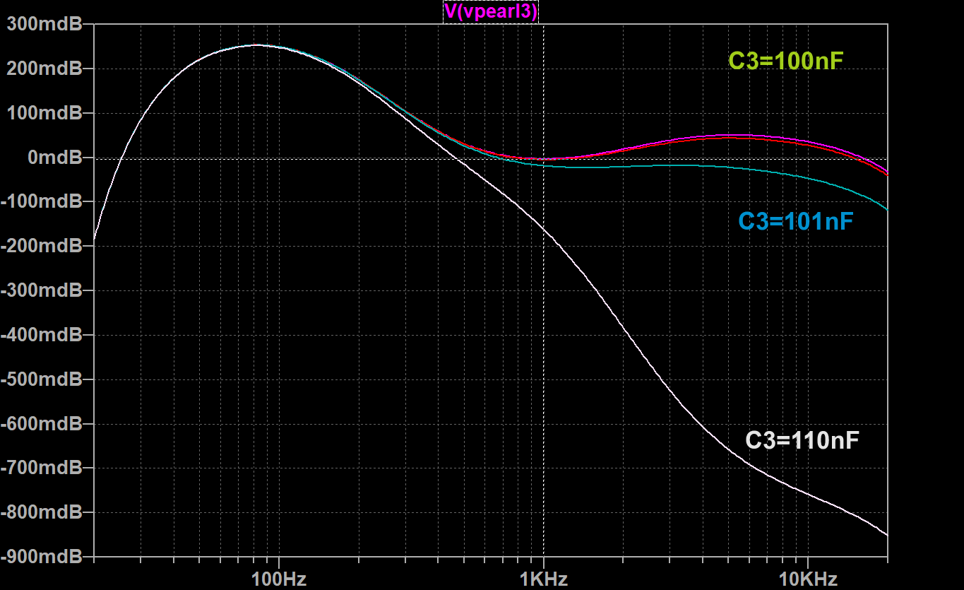

I twisted myself a bit in post 179 -- it turns out that if the Pearl3 is "hot", i.e. rising output relative to the RIAA curve, the devil may be in the compensation for the first operational amplifier which is 4.7pF. You can just stack another capacitor on top of the 4.7pF to tame the response. Elsewise, should look as Wayne has shown.
The hf roll off is indeed best done with the 4.7 pF around the 1M Ohm resistor. I think it was a 5 pF as measured.

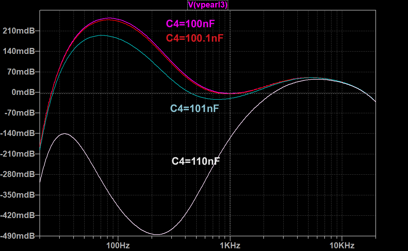

I am sorry, C2 is the compensation capacitor around the first operational amplifier. YMMV For purposes of simulation I optimized it for 0dB at 1kHz. In real life 4.7pF. C0G usually but in ham-radio land, as Wayne suggested, just twist a few inches of wire to attain the correct value.
Here is how changing C4 affects the compliance to the RIAA curve for t3, again it's just a simulation.
C410C479D1G5TA7200. This is a Kemet NPO COG 4.7 pF in stock at Digikey that will work for C2.
