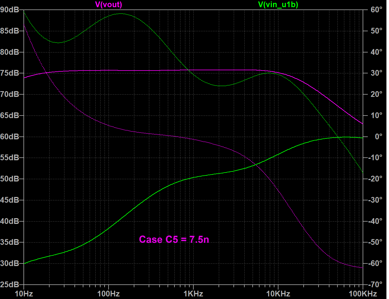

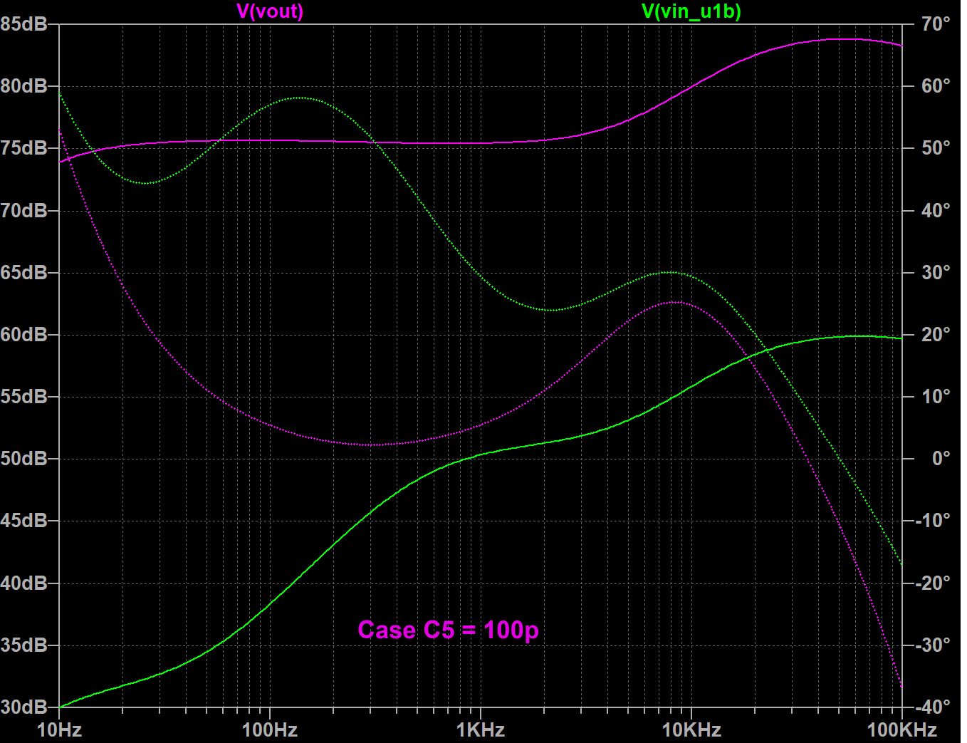

Ordinarily, the T5 combination would be set by C5 x R15 = 75us (assuming that the impedance of R18+C8 is very low.)
In this design, R13 x C3 are used to set T5, and C5 is set to a nominal 100pF (T=3.3us) Is the phase relationship then correct?
Here's a simulation with C5 = 100pF and 7.5nF
