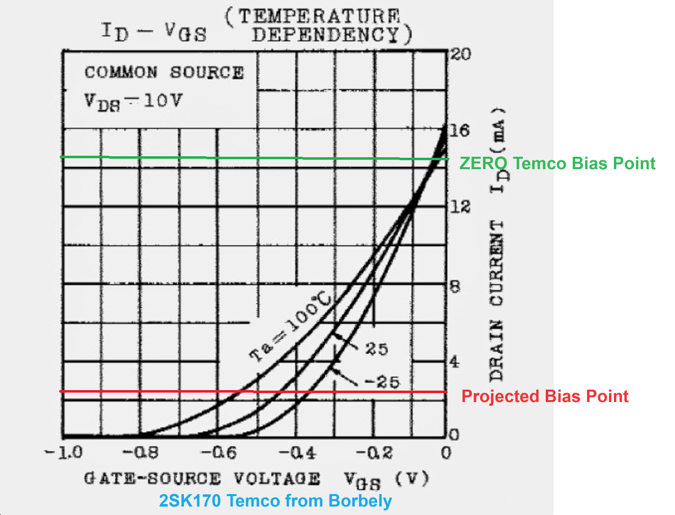

I never noted a problem with temperature in my working Pearl 2, nor in the Minnie-Pearl. I have seen issues using JFET's in ULN amplifiers with 8 paralleled BF862's.
Erno Borbely had a chart from the 2sk170 datasheet which illustrated the optimal current for thermal stability -- that must have been a generation ago. (Borbely, JFETs the New Frontier Part 1). Not going to help us here.
You could use 3M copper tape to bind the 4 JFETs, attach to a small mass which will lend some hysteresis to the change in temperature.
(If you have ever made a DIY logarithmic amplifier, you probably used an NTC resistor to compensate for temperature changes)

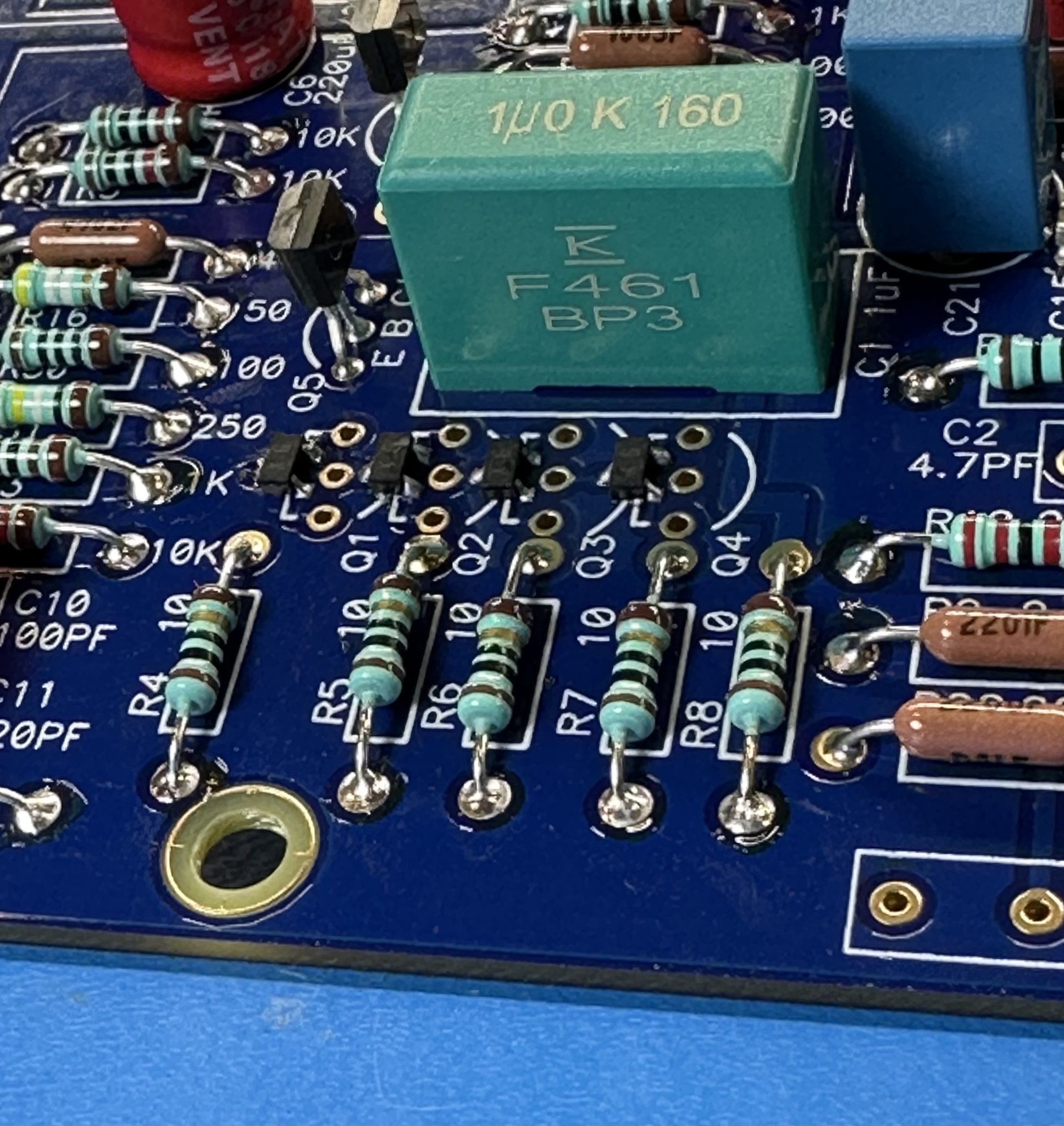

Toshiba 2SK209GR input Jfets. Yep, they are small. They are also in-production new Toshiba, quiet, perfect for the circuit and about $0.25/ea, not approximately $8.00-10.00/ea…
Yes, this would be a perfect application to use Toshiba 2SK170, if you have them. If not, don’t worry about it. 🙂

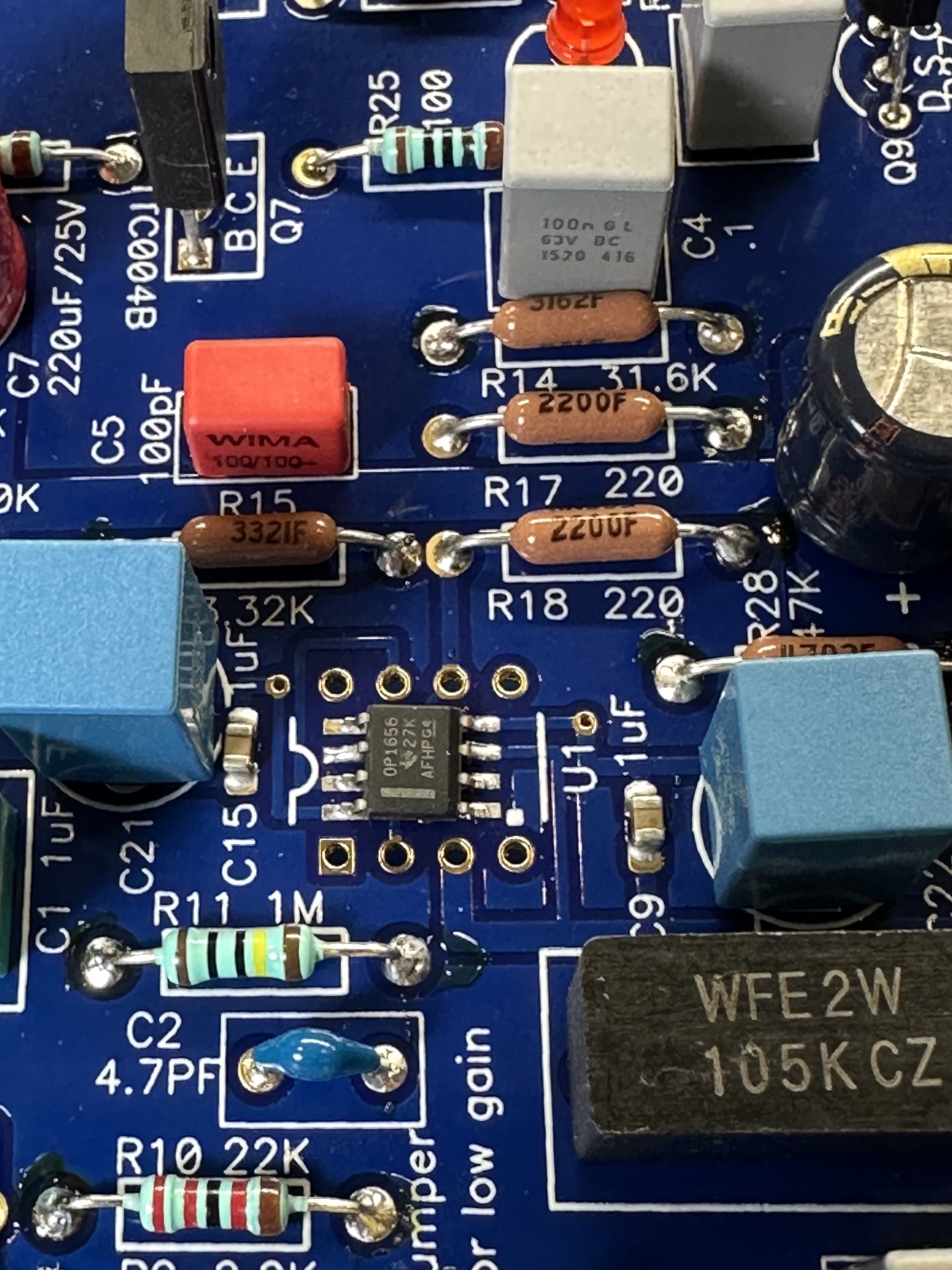

This is OPA1656. You can use a DIP-8 dual opamp instead of the SMD in this position. The decoupling SMD capacitors are ceramic 1uF in 0805 size. I’m using film 0.47uF in the C21, C22 positions because I had them on hand. The silk is marked for electrolytic 220uF/25V, But this is an extremely non-critical value.

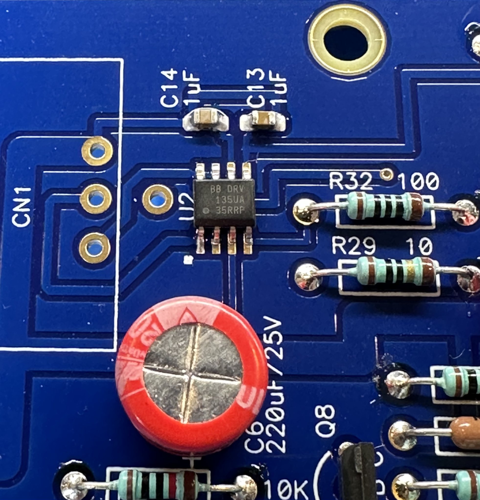

This is the DRV135 balanced line driver IC. They are SMD only. Capacitors are the same 0805 1uF ceramic as in the other opamp position.
If you don’t need/want XLR output you may leave this empty.

But when you parallel JFETs you want then closely matched?
Then you need a batch of 2SK209GR to select from?

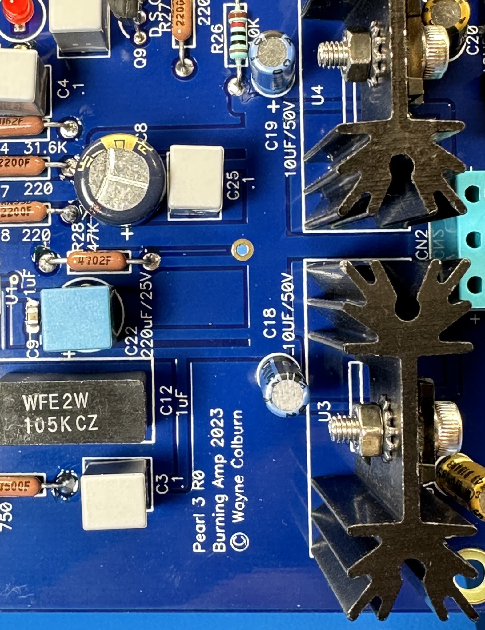

A few more photos to help the early builders -

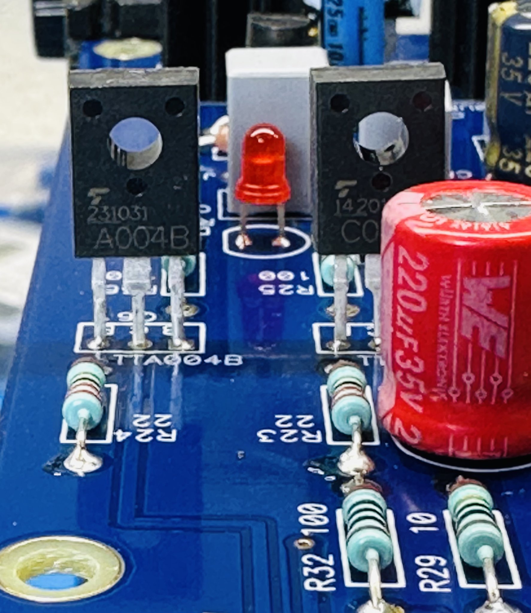

The TTA004 and TTC004 face their names on the silkscreen. Pinout is marked as well.

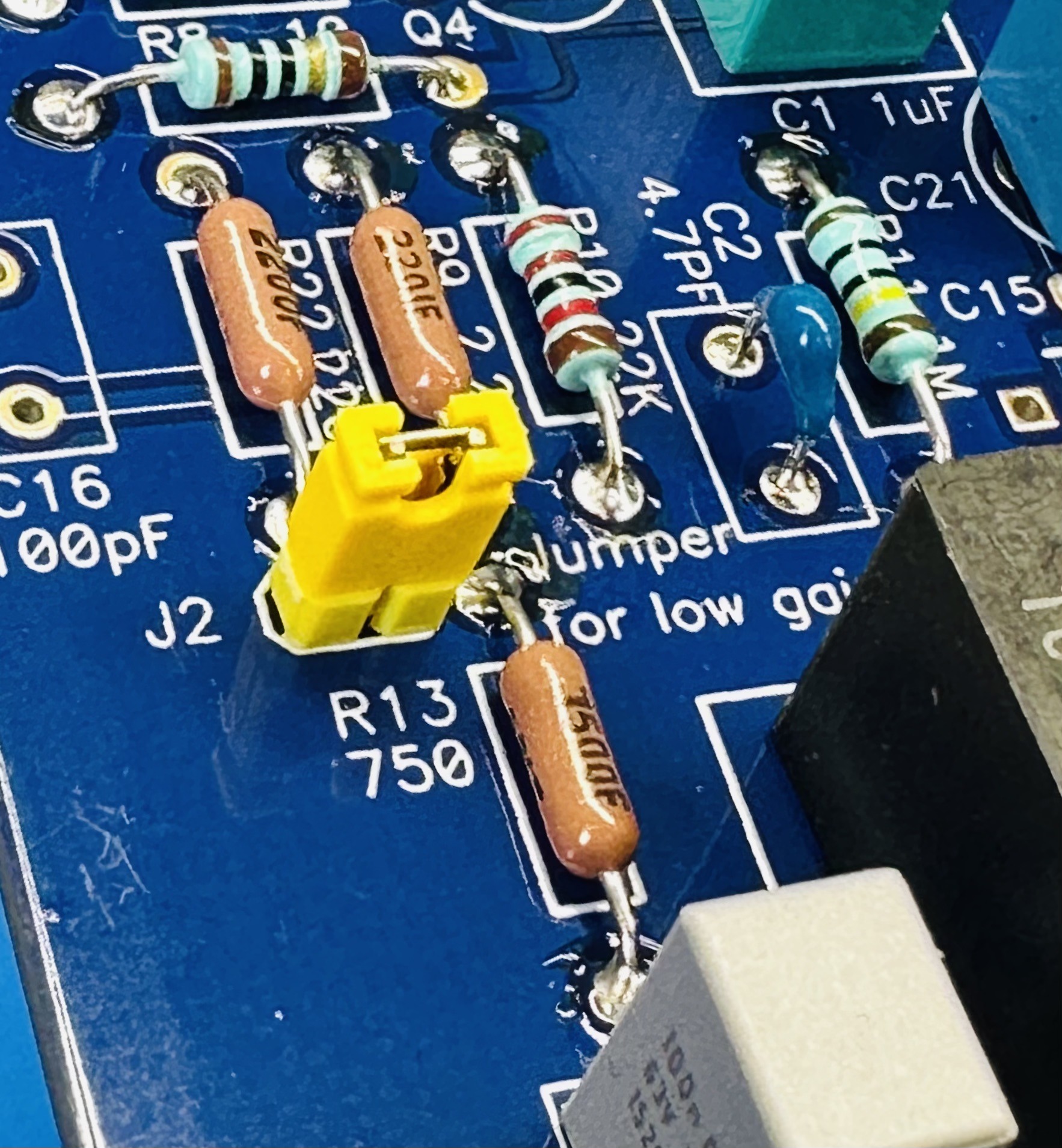

The jumper is installed here. Open for high gain (MC) closed for low gain (MM).
The unmarked hole in the center of the PCB is the main signal ground, attach to the turntable ground post on the chassis.
