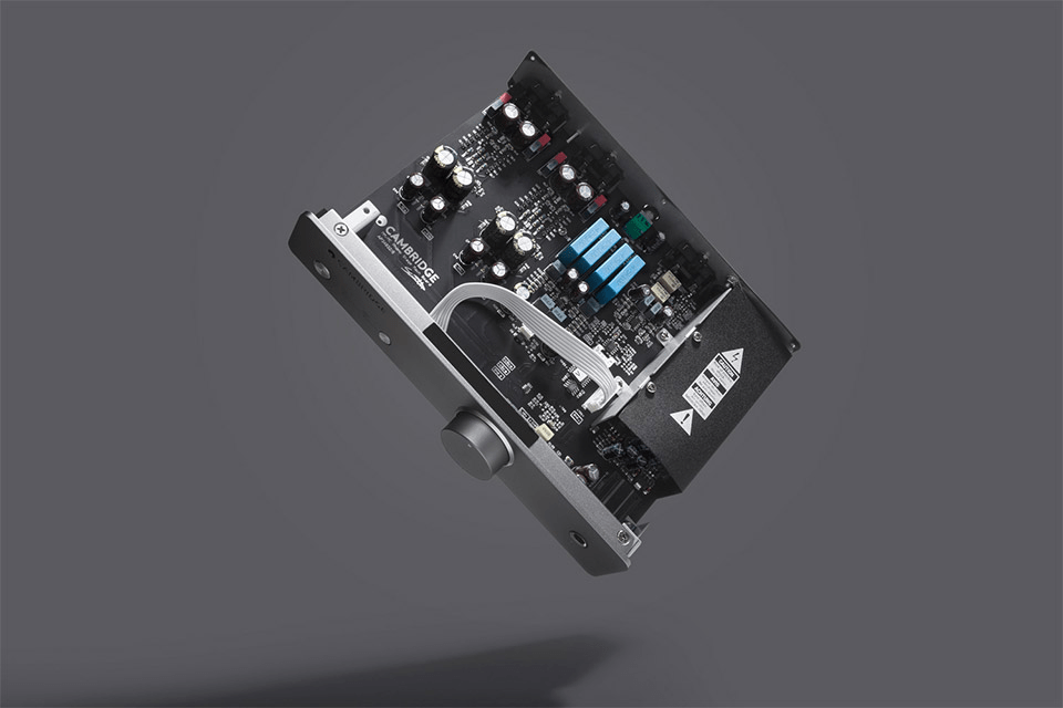

A look inside the MM/MC Cambridge Riaa:
Seems to be built around opamps also but it has no 4 x 2sk170 as input circuit?
Looks like an onboard small SMPS. Probably with good filtering and screened a little bit from rest of circuit.
I see no dip-switches for load of cartridge.

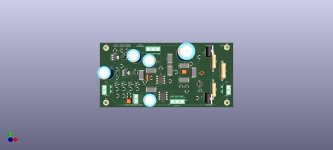

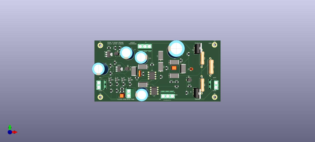

I assume such a complicated shunt regulator should be just a little more silent than standard voltage regulators? .....assuming that the P3 power consumption does not exceed that of the ZM Gemini......
complicated not, just big pcb area
power capability - present pcb allowing, say, 200 or so mA of programmed current
several times that, appropriate pcb design and augmenting few parts
as is, feeding 3 stereo Pearls 3
shunt regs are my Fetish (one of many), but I'm not twisting anyone's hand to think as Mighty Moi

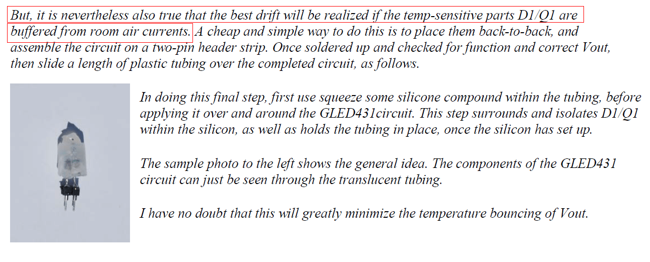

One additional thought for a chassis is totally sealed or at least keep air currents away from the input stage.
You can watch the drift by blowing on the input transistors.
Walt Jung says the same thing about his "GLED431" ultra low noise voltage reference: keep air currents away.
