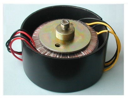

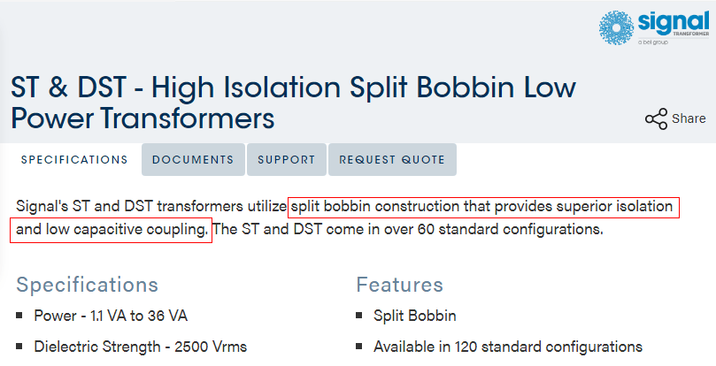

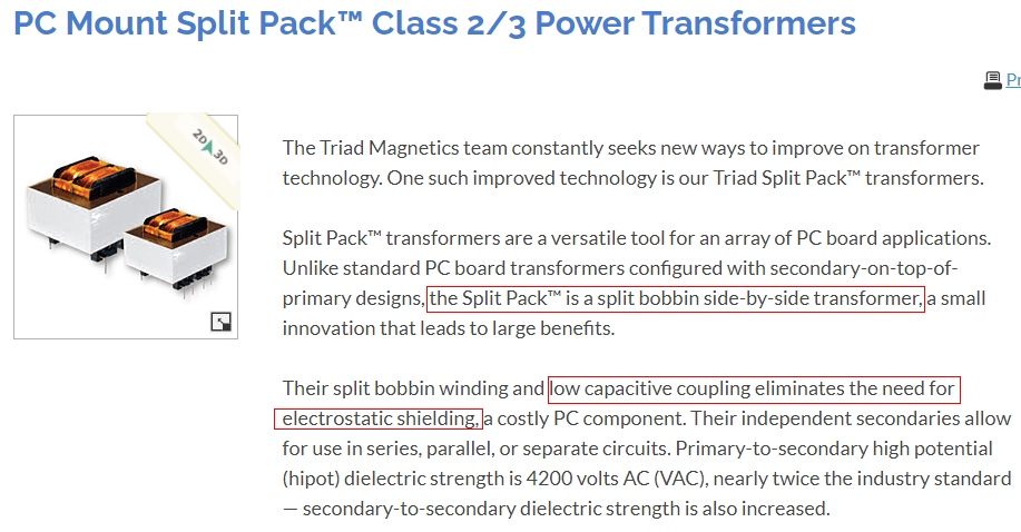

It may well be true, that an ultra high gain phonostage like Pearl 3 would greatly benefit from putting the transformer and AC-to-DC components, into a separate chassis with plenty of electrostatic and electromagnetic shielding. Then locate this separate PSU chassis a few meters away from the microvolt preamp (Pearl 3), with a shielded cable between.
It may be of additional benefit, to also choose a non-toroidal transformer for this application. Regrettably, toroids have quite high primary-to-secondary capacitive coupling, which squirts HF and RF noise from the mains into the secondary. John Curl has often recommended split bobbin transformers on this website, examples below, because split bobbin transformers have extremely low primary-to-secondary capacitance. After all the primary and secondary are wound upon, you guessed it, separate bobbins. Here is one of John's posts on the subject; you can also use the Forum Advanced Search to find quite a few more messages authored by member "john curl" which contain the word "bobbin". Take a look and decide whether you think he's onto something ... remembering that John's been doing world class phonostages for decades; he was awarded the very first US Patent on a Moving Coil pre-preamp (US 4,035,737 in July 1977).
Determined and ambitious hobbyists might choose to go still further, and fully enclose the split bobbin power transformer within a steel can, perhaps one of the round ones sold by Antek for their (not split bobbin!!) transformers, or perhaps a rectangular shielding box made out of mu-metal. The shield can/box prevents the transformer from radiating noise into the rest of the PSU chassis, and also prevents the rest of the PSU chassis wiring from radiating noise into the transformer.

John does like the split bobbins or C core type. Toroidal types tend to have very wide bandwidth also.
They can couple noise in and out well. I still like a toroid sonically for some reason, maybe the wrong split bobbin types.
My Pearl 3 is in a single box and pretty quiet with an Avemco 25 VA toroid off on one side. This being diy I expect two transformers in a secondary box with high speed diodes and a couple of farads of polypropylene caps.

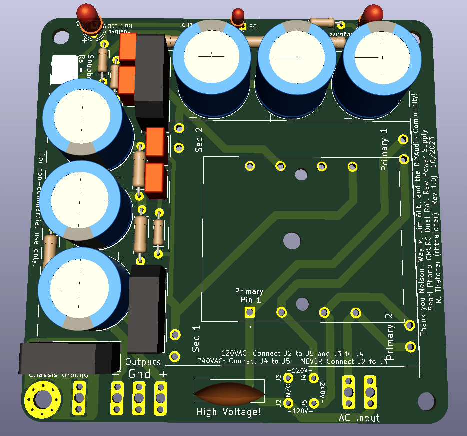

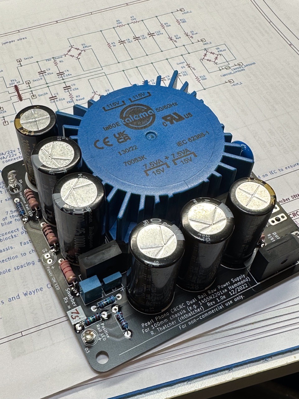

@rhthatcher Has made a great little PCB with CRCRC filtering for the raw supply. Ive got a few to try, as well as some other solutions… this is going to be fun!

How about a CRCRC with options for 15/25VA 15+15V Tamura/Talema toroidal OR ST 12VA 14+14V Split Bobbin?

The Toroidy transformers many used for building Iron Pre (incl. myself) turned out to be very quiet (with both magnetic / electrostatic shield). But such a sensitive phono preamp calls for the transformer it its own chassis (at least one also did that for IronPre)?
The Gemini-part of the ironPre boards could be used for this project (instead of the 7815/7915?). I assume such a complicated shunt regulator should be just a little more silent than standard voltage regulators? .....assuming that the P3 power consumption does not exceed that of the ZM Gemini......
