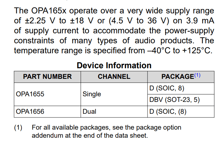

Yup, I still can read the schemathic. My question was about the one chosen for the showed board. More clear my spaghettienglish?

The lower voltage is due to the opamps and the 15 Volt regulators are lower noise.
You can put in 18 Volt regulators if the opamps will handle it. There is still plenty of voltage swing on the output.
